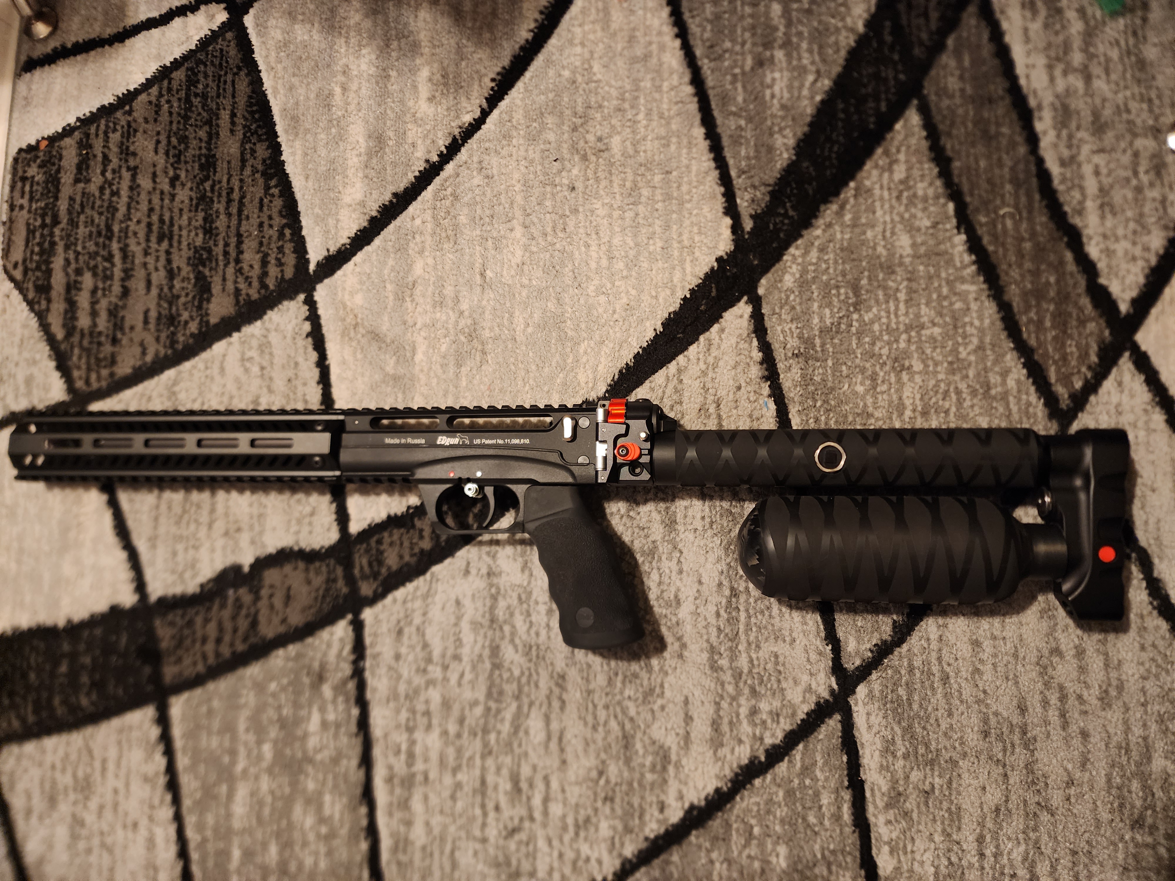

I have decided to sell my .22 caliber Diana Bandit. I bought it new with the idea to build a custom carbine. Buck Rail had all of the components I wanted to make the transformation so soon after receiving the pistol, I bought the kit to build the carbine. What’s cool about it is that there was no modifications to the pistol other than taking off the original stock and sights, then bolting on the new kit parts. Really simple but made this thing more fun to shoot. After shooting it, I saw that the power curve did not lend itself to accuracy over a string of shots. So I added and Altaros regulator. That made things more consistent and the gun is deadly accurate at 25yds for 20 shots. It is exceptionally light weight (just under 4lbs.) and the perfect close quarters pesting tool you could ask for. It comes as pictured with all of the original components as well as the completed carbine kit. Here’s a list of the cost involved with building this:
Diana Bandit .22 $ 199.00
Buck Rail Lower $ 32.00
Buck Rail Side Folder $ 54.00
Minimalist Butt Stock $ 50.00
Front Rail Handguard $ 20.00
Dovetail to Pic Rail $ 10.00
Reflex Sight $ 32.00
Altaros Regulator $ 99.00
Carm Magazines (2) $ 40.00
Total Build Cost $536.00
Build price does not include original shipping costs on any of these items…
Full disclosure... There is a gouge and a couple of scratches from attempting to remove the moderator base. :cry:That is the only blemish.
I’ll let the entire package go for $350.00 shipped CONUS. Drop me a note if you have any questions.

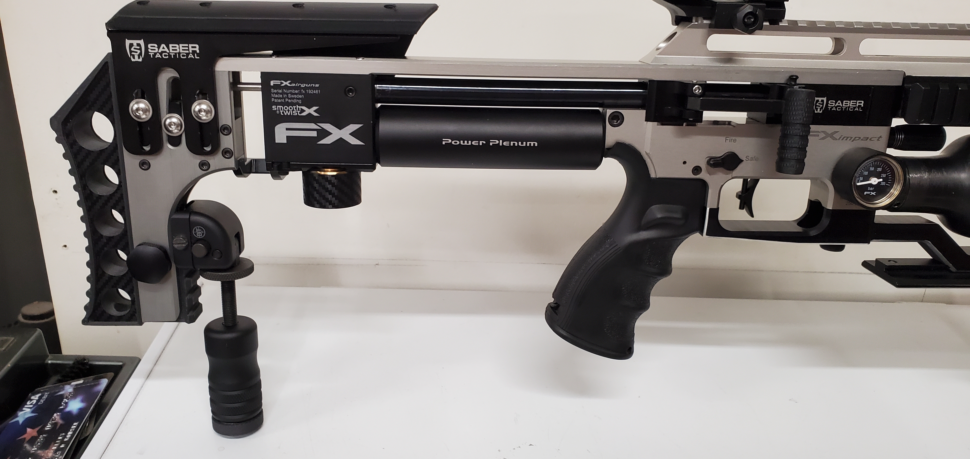

Plenum Size Does Matter !!
I know this has been discussed before, but kinda shocked that adding just a 20cc plenum to my .25 caliber RAW HM1000x gave me 1011 fps with 34 grain JSB's (77 fpe) using OEM spring.
The set-point has always been set at about 150 bar, but w/o the additional plenum ... same set-up maxed out at 930 fps.
The additional plenum had been on another lesser caliber gun, but felt it belonged on the higher powered gun.
Going to lower regulator set-point to about 140 bar with the idea of getting the gun to max out at around 940 fps. Trying to tune to about 910 fps for efficiency/low ES, knowing the gun can generally shoot 1 MOA at said velocity.

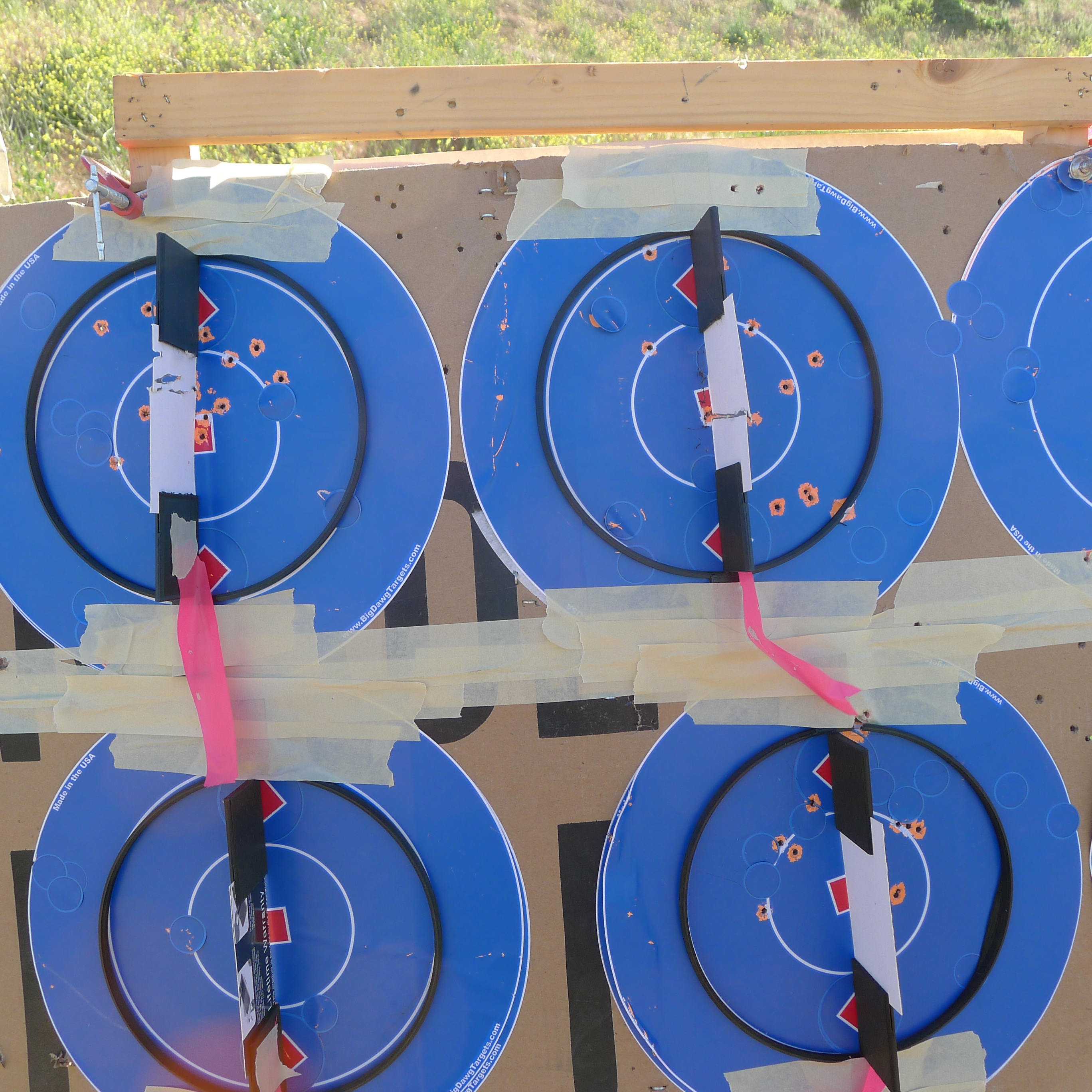

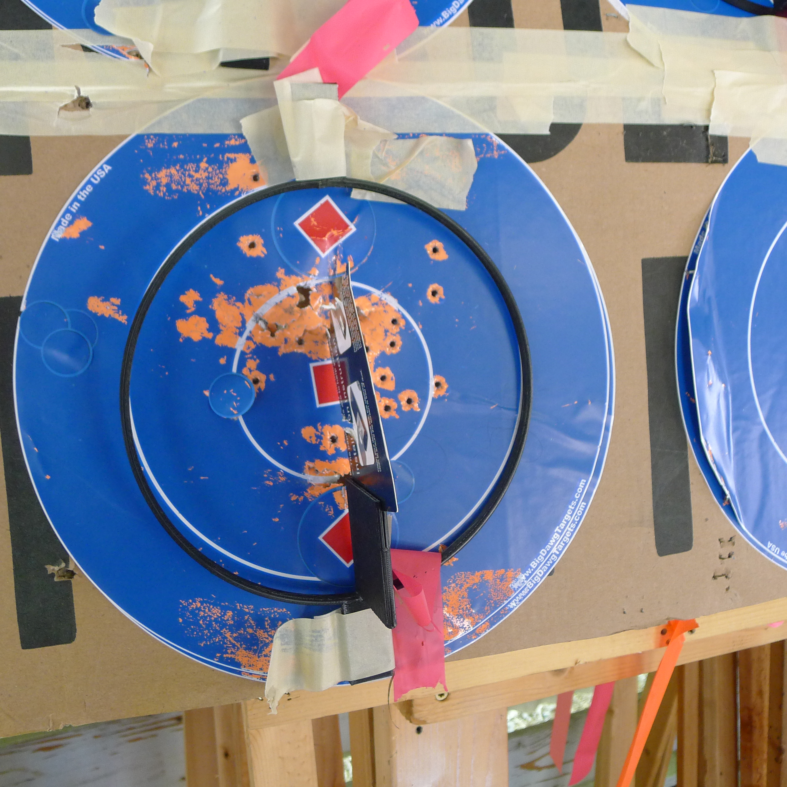

I was shooting my Prescioussss,HW50S .177 and this happened.
So I step outside at the edge of the evening as the air cools a bit to put a few rounds down range. I'm shooting at this Birchwood casey swinging spoons target at 25 yds. I usually shoot for group but I'm bit low on energy these days and I'm gonna be out of light soon. Anyhows. Things r going as expected "7 for 7" when the scopes windage cap fell off the scope. So I put it back on and snugged it up. And I'm thinking, " I wonder if that is going to change my POI". Lo and behold my next shot was a miss. Just to be sure I took another shot. miss. I had to adjust my windage 6-8 clicks to get poi back on target. The scope is a Hawke AMX 2-7 X 32. Do you think that would be the case with all scopes. Just changing the tension on a scope cap.

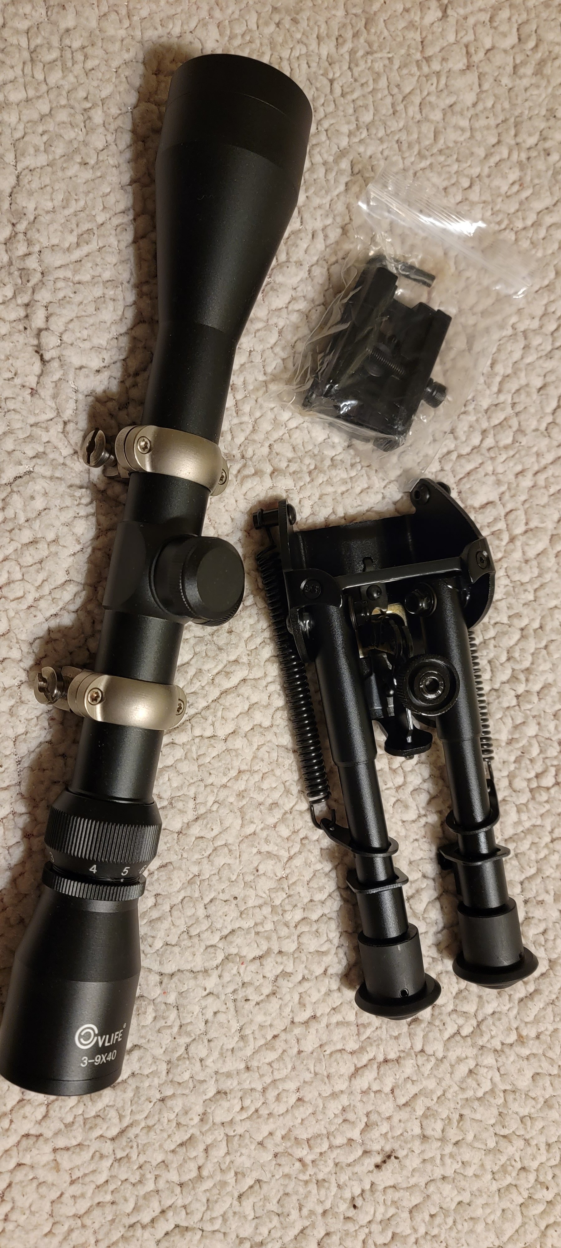

PCP Pistol  NLA 4 - Pistols and Equipment for sale
Hello everyone,
This package includes everything listed, pistols, scopes, rings, bipods, and other accessories. I have two (2) notations so please read and if you have any questions send me an email.
1) Those of you that know me also know that everything I have is absolutely like brand new and well taken care of. All items have all of the original factory manuals, equipment, supplies, etc. along with the factory boxes.
2) I will not sell any item individually and sold as a complete package only.
3) The quantity for each item is shown to the right of the description.
I have these listed on my website so the Package can be purchased with a credit card; www.uncletomsplace.net
I am asking $1,450.00 with Free shipping to lower 48 states. If you have a questions or want to make an offer please contact me.
Thank you,
ThomasT

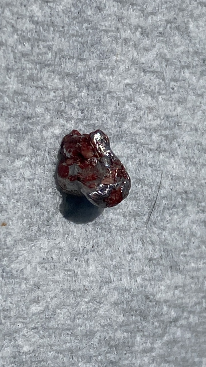

Several months ago we had a woodchuck take up home in the backyard. He had burrowed under an old slab of concrete that I’m sure was once a patio. I was told by the better half he was cute and OFF limits. It really wasn’t a big deal. I was planning on doing a deck over that old patio anyway and chucky really wasn’t bothering anything. Fast forward to now. Deck is done and my wife caught ole chucky on the patio table eating all her plants 😂😂. She put a bounty on his head now. Lmao. She took a pic of him on the table. I will have to have her send it so I can post it here. Anyone else’s sig other ever have a change of heart about backyard “pets”?

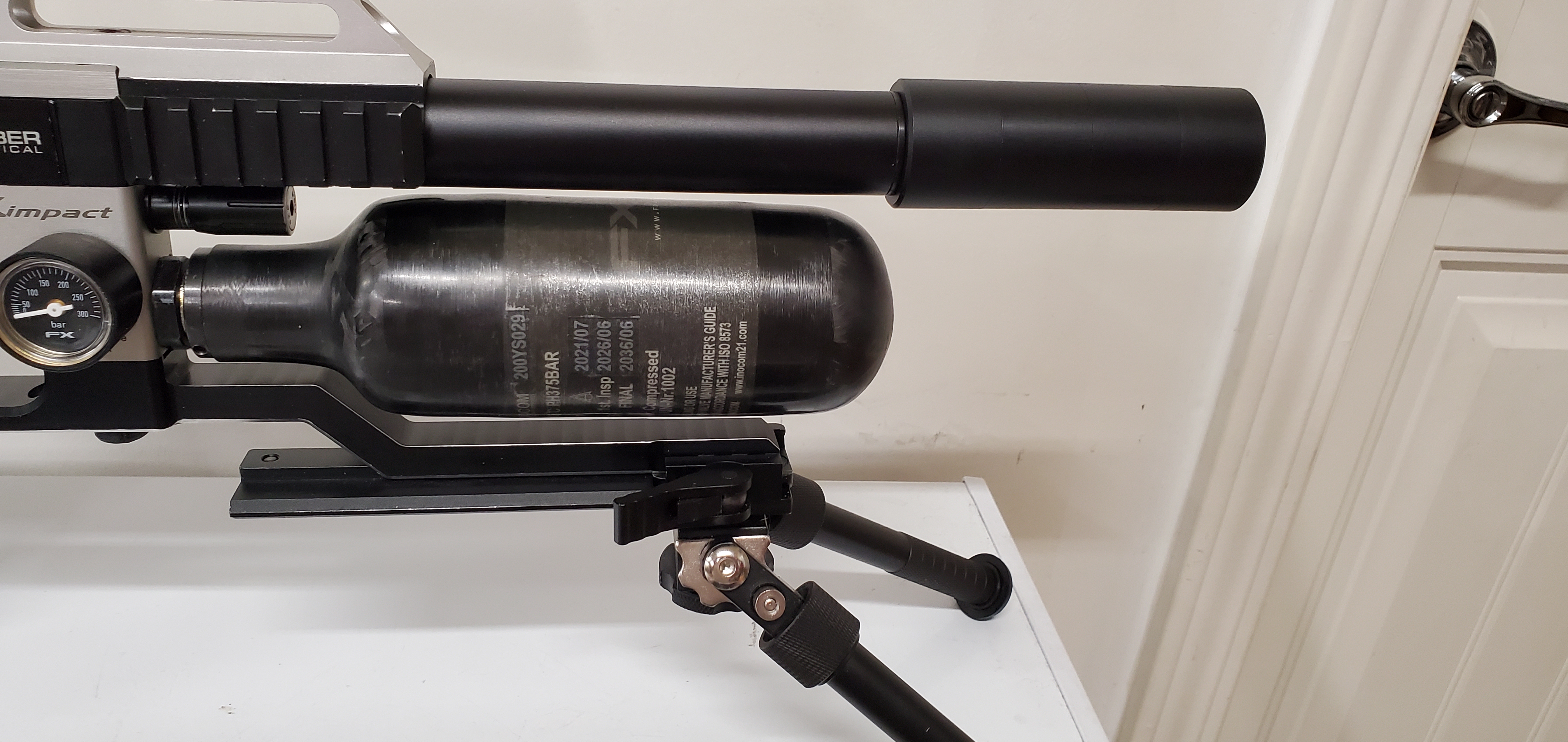

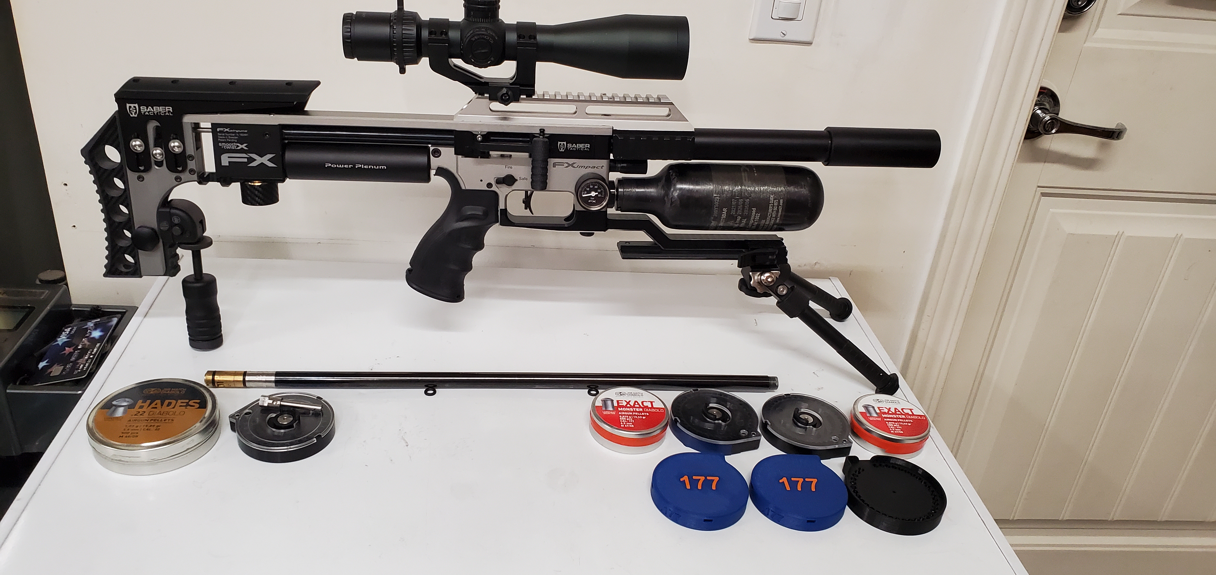

FX Impact MKII slow leak...Found it!!!
Found my leak!
Look at your atmospheric blead hole on the right side of your Impact.
Small leak over a few weeks is a thing to troubleshoot. A bit of soap an water is cheap and affective.
C39 19790 O-ring 10x1,5 NBR90
A bit of a challenge, but most can do it with patience.
