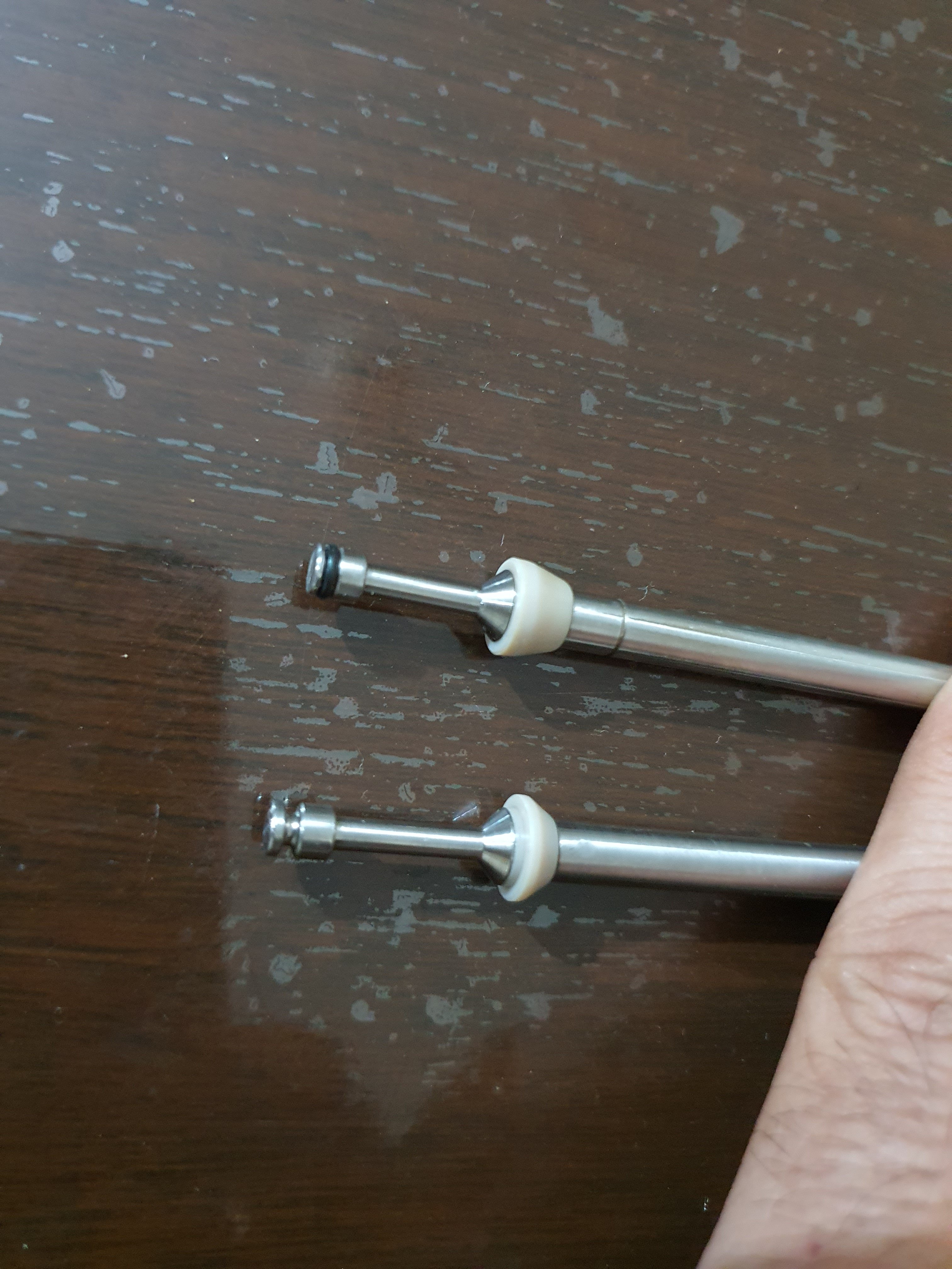

SOLD AEA HP Carbine .25 - $425 Shipped!

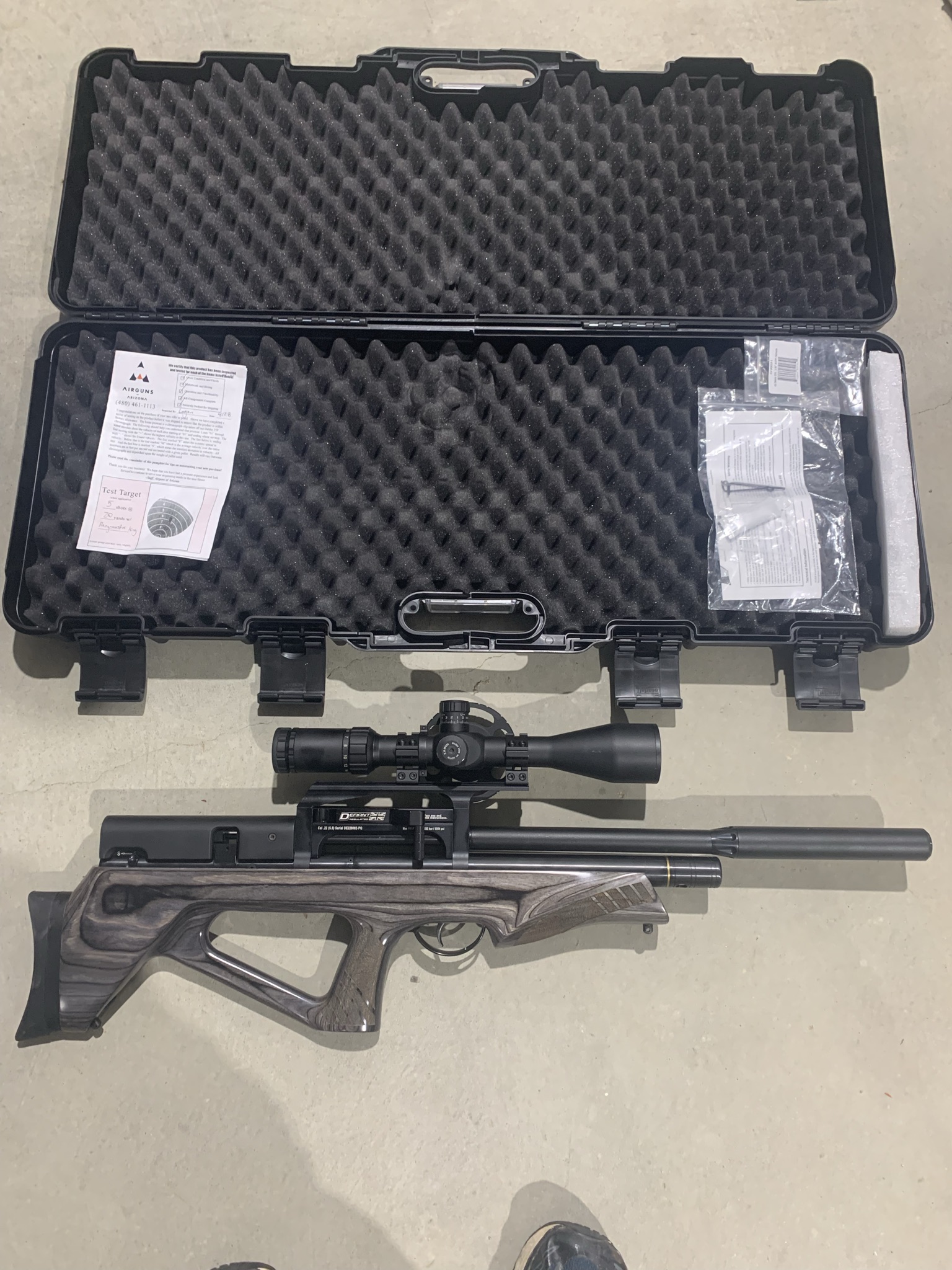

My stepson gave me this AEA HP Carbine in .25 cal to repair, tune and sell. It has some light scuffs but, as you can see in the linked video, is fully functional. It comes with 2 magazines, fill probe, DonnyFL adapter, magnetic stock catch, 2 spare valve pins and one spare bolt/probe. It's held air for 4 days, so no leaks. I'm asking $475 $425 shipped to the lower 48 states, payment via PayPal F&F. Sorry, no trades. Here's a video of it running a full magazine:

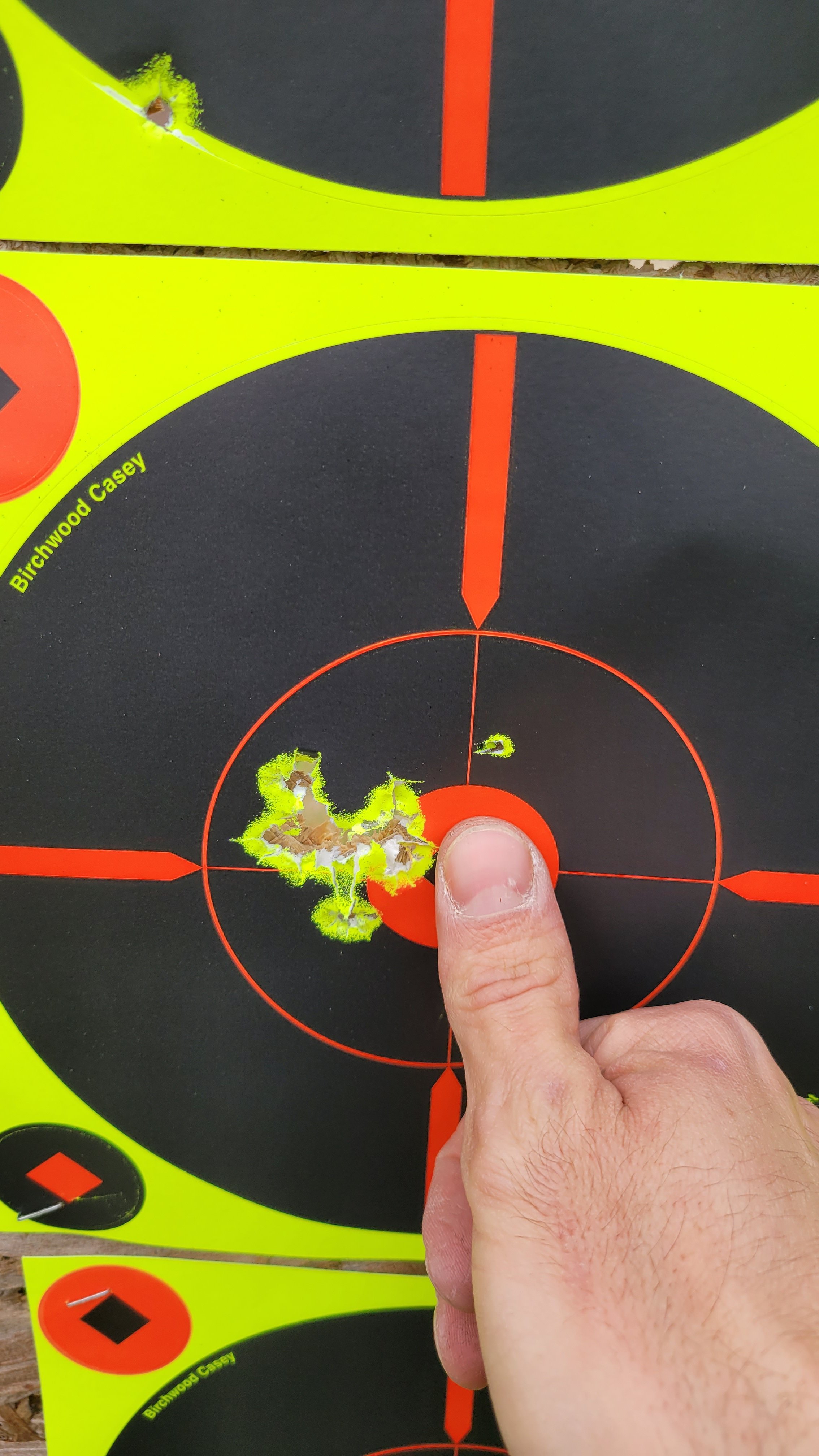

That’s more like it
I have been super frustrated with my new HW 95 .177 cal. I tried all the usual pellets that shoot best in my other HW rifles, No luck. I could not get it to shoot acceptable. After about 1000 high-quality soft lead pellets, I decided what if I got to lose. I cleaned all the soft lead residue out of the bore and tried crossman premier 7.9’s That’s more like it. This is 10 shots at 50 yards with Iron sights. Aside from that one flyer that’s about as good as I have done.

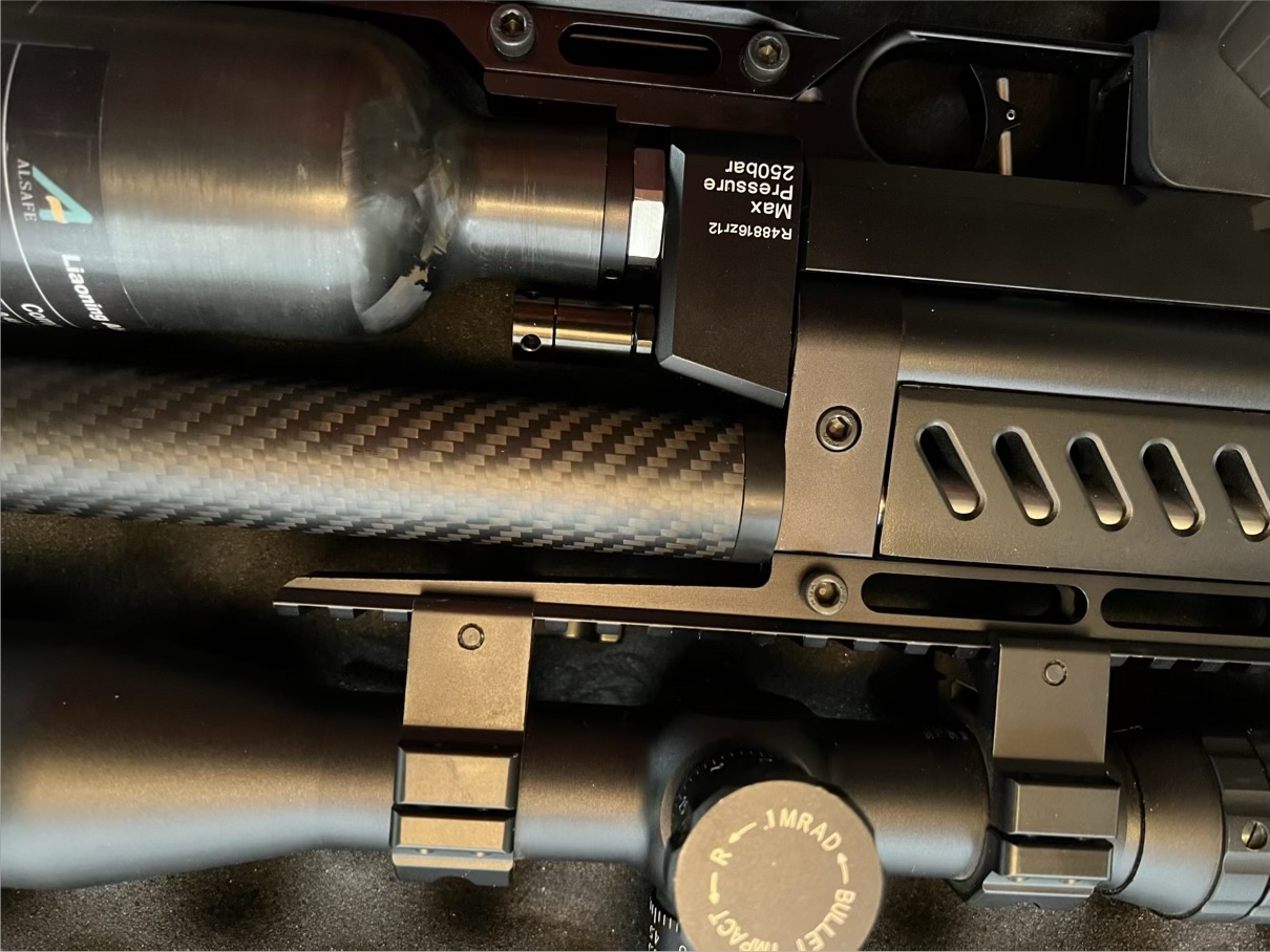

1. Carbon fiber bottle - 420cc - bottle has a M18x1.5 thread - manufacture date Jan 2022 - like new. Tried on my Leshiy 2 but was a little too long - $125 NLA

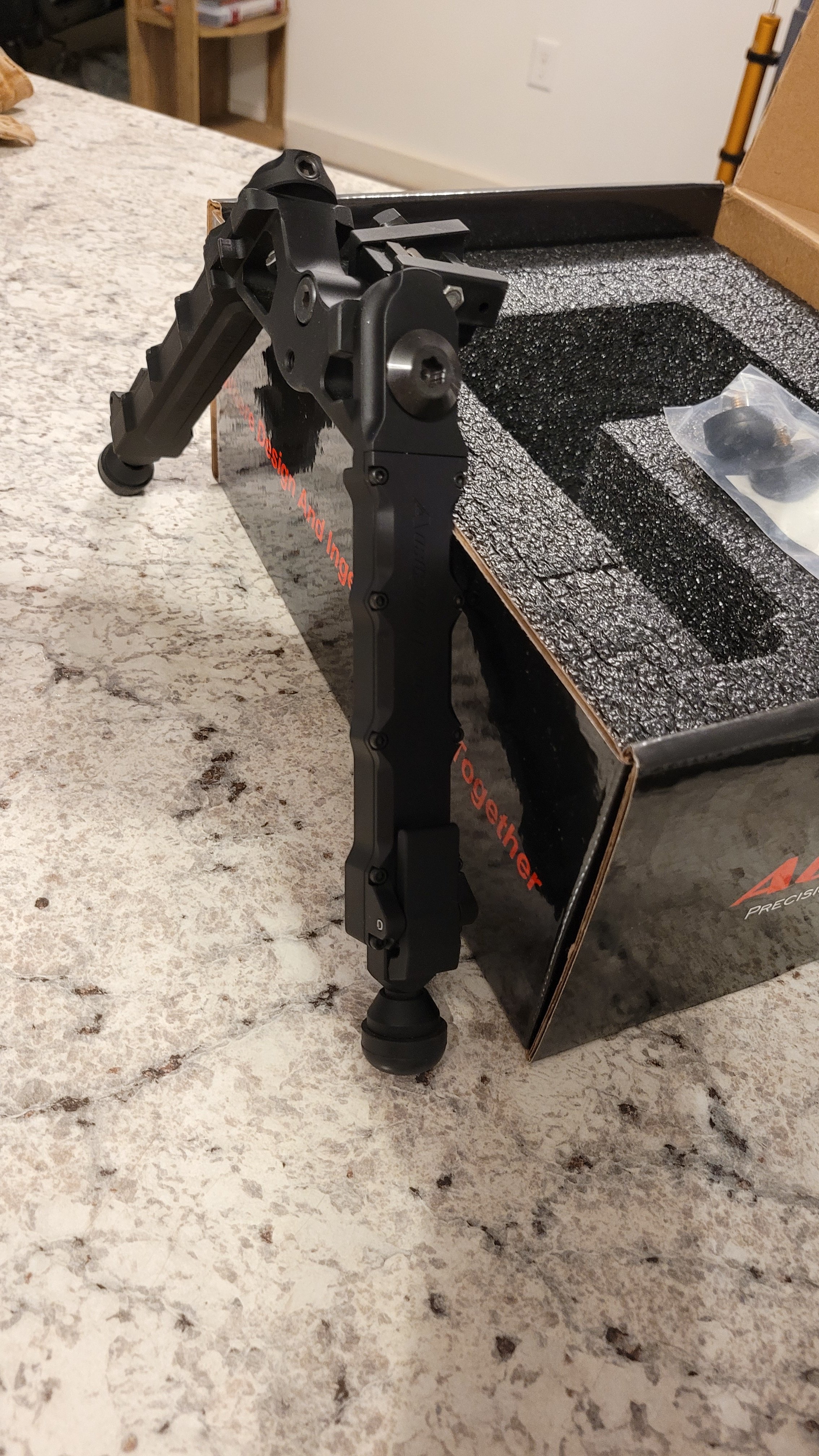

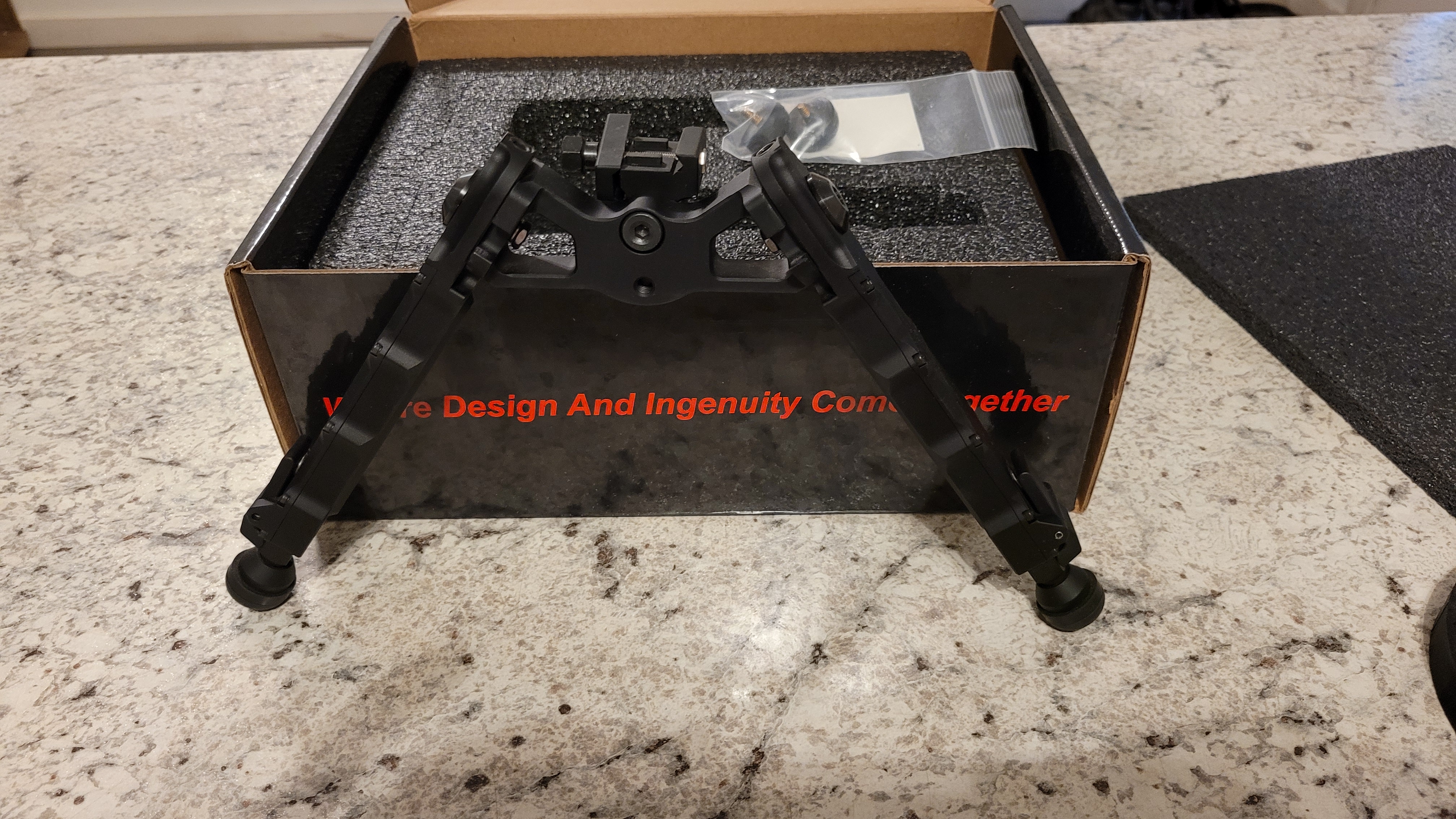

2. UUQ Bipods - $60 shipped each-SOLD

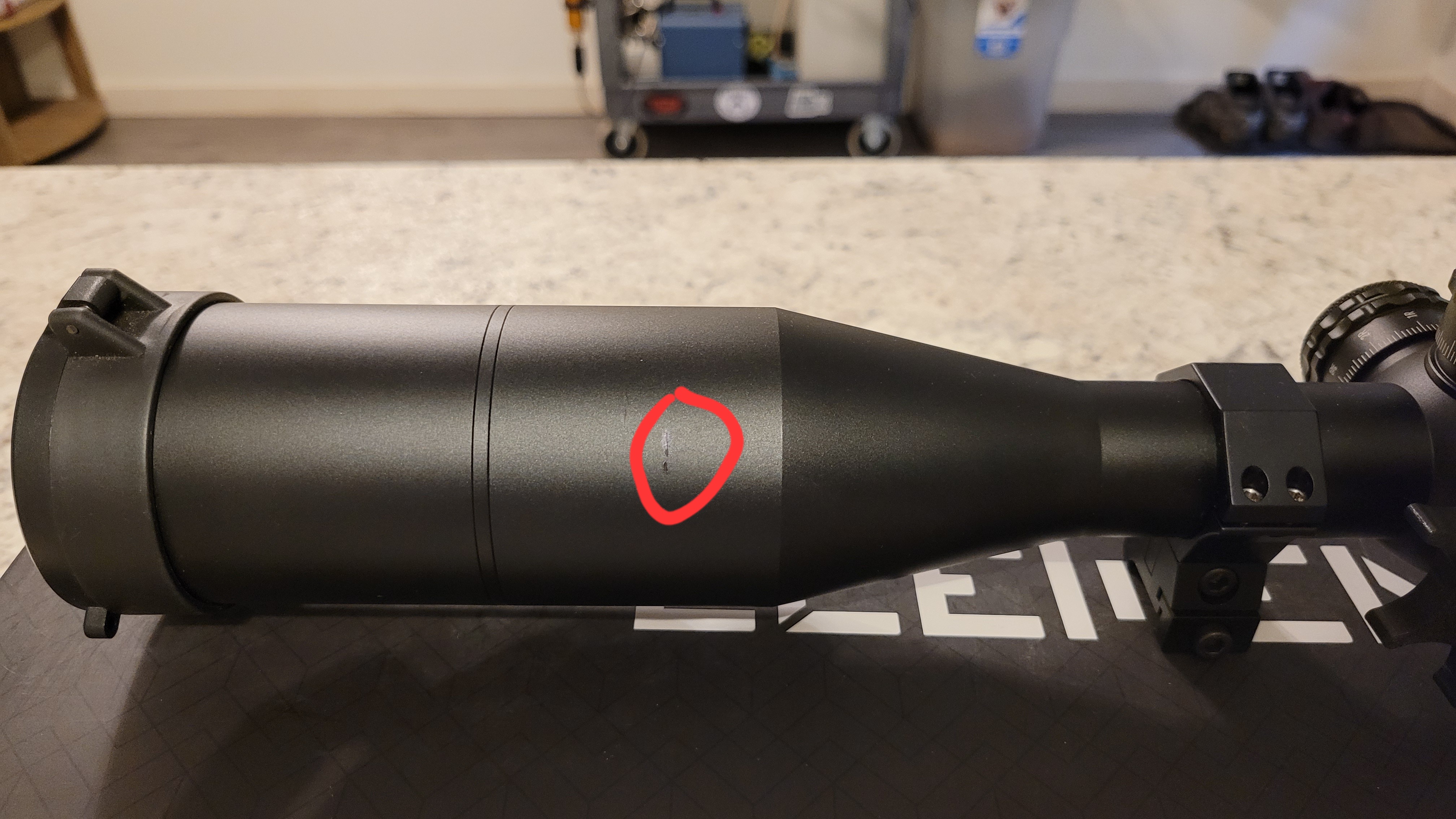

I've got a Riton X-1 Conquer and a Cabela's Covenant 4 4-16x44 scope. Both are SFP. I have the box for both
Both scopes are in great condition without marks of issues. I have linked the descriptions below. While not 100% certain I believe the Cabela's Covenant Tactical scopes are made the same place as the Vortex Diamondbacks. If you search I think you will come to the same conclusion.
I am looking for a lightweight scope in the 3-12 power range. It can NOT have a duplex reticle (or single aiming point) this is my only criteria.
I am also looking for a small moderator 1/2-20 for an under 20fpe .22 caliber rifle.
I will sell either of the scopes for $150 plus whatever shipping is from 21009. PP F&F or Venmo or Money Order please.

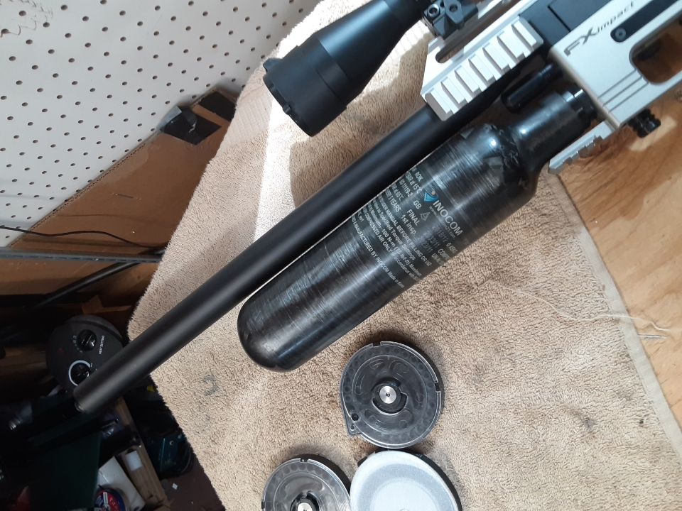

SOLD Very nice FX Impact MkII Bronze 0.22 600mm (Superior Liner) w/ M3 Upgrades
Hello AGN,
I'm looking to sell a very nice 600mm 0.22 caliber FX Impact MkII Bronze w/ 1 magazine, shroud thread protector, some nice M3 upgrades and factory FX hard case. This Impact is an excellent shooter and is currently set up to shoot the JSB 18.13g pellets through the 600mm Superior liner at ~900fps with excellent accuracy. Rifle is in excellent condition as shown in the photos; it holds air and functions perfectly. The shroud has been carefully wrapped with a carbon fiber vinyl wrap that can be easily removed if you don't want it.
[This rifle currently has the standard 480cc bottle on it but I do have the smaller 300cc bottle if you prefer a more compact/lighter setup.]
This is a MkII that comes with the following upgrades / extras:
  • FX Impact M3 600mm Barrel w/ Superior Liner & Dual Transfer Port (Pellet or Slug)
  • FX Impact M3 Ambidextrous Cocking Block
  • FX Impact M3 Oversized Cocking Handle
  • FX Impact M3 20 MOA Scope Rail
  • FX Impact M3 16 Position Power Wheel
  • FX Impact M3 Skeletonized Buttpad
  • Stainless steel bolt kit (already installed)
  • Bottle/barrel band
Price is $1500 + 1/2 actual shipping
Local pickup is available in the SF Bay Area - otherwise, payment by Paypal Friends & Family is preferred (or add 3.5% if using PP Goods & Services). I haven't been very active lately but have been on this forum for a long time and have abundant feedback as both a seller & buyer so know that you're dealing with a reputable trader.

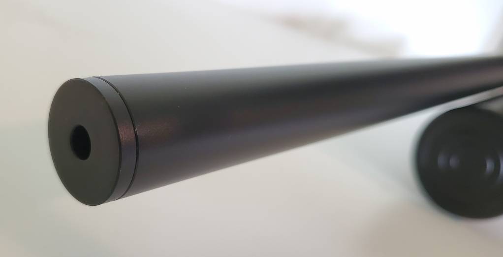

  • Huma Modular Air Mod40-4/0 (4 sections total) Standard 0.30/0.25 Caliber Moderator w/ M14x1.25 Threads (will thread directly onto a Leshiy2 barrel); CF vinyl wrap can be easily removed if you don't want it: $125 shipped NLA
  • DonnyFL Tanto 0.25/0.22 LDC w/ 1/2 UNFx20 threads: $80 shipped [SOLD]
  • DonnyFL Tatsu 0.25/0.22 LDC w/ 1/2 UNFx20 threads: $100 shipped [SOLD]

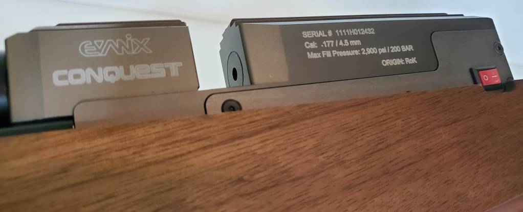

Keeping records ?
Watching an old TV show last night.
First guy - "How many guns do you have ?"
Second guy - "About ten."
First guy - "Do you have the serial numbers written down anywhere ?"
Second guy - "Yes, I do ."
I don't have the serial numbers of my air guns, written anywhere. Photos of all of them, Some photos show the serial numbers, but no details written on paper.
Do any of you keep written, recorded info on your air guns ?
I did when I had firearms, but "so far" not the air guns.
Maybe it might not be a bad idea !?
Mike
