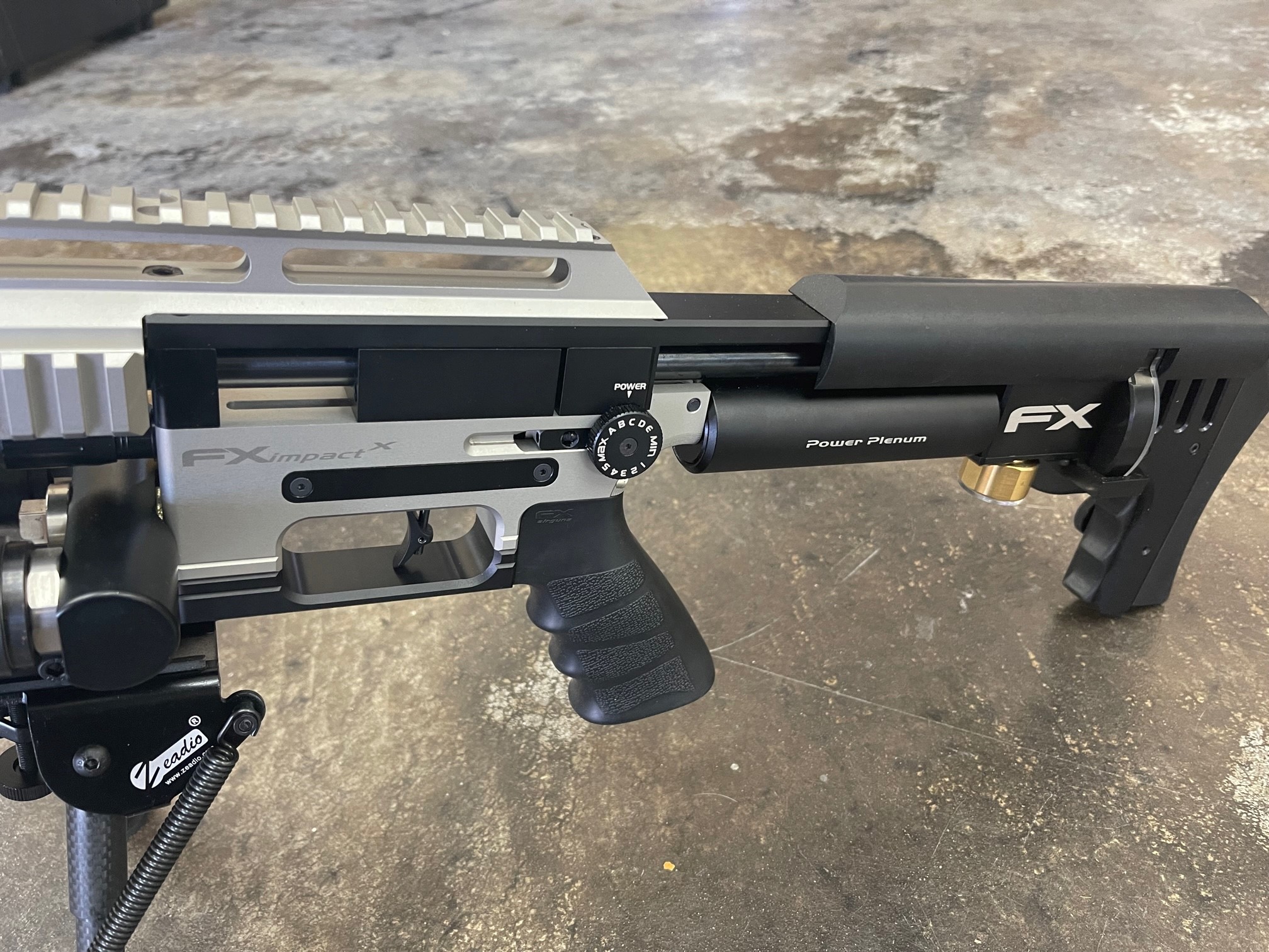

Fx impact M3 700mm Blast of air to the face
Hello all. So I have finally decided that I want a high end air rifle, so I purchased a brand new fx impact m3 700mm .22 from pyramid air. Wow this thing is awesome. So I started shooting it and it shoots great. I have about 200 pellets through it or there about. I have noticed that all of a sudden I'm getting what I can only describe as a blast of air on my cheek when shooting it and seems much louder than when I first shot it. I have not taken anything apart except for lowering the first regulator pressure as it was around 165bar when I first received it. It is currently around 135bar and 95 bar for the second regulator (have not touched that one). Seems that they shot it for the 10 shots for $10 using 11.9 gr pellets at 1090 fps average for the 10 shots. This thing is awesome to shoot but i don't enjoy the blast of air that kind of stings. Any advice? Should I contact them and send it in? I have only had it for about 5 days including today. I looked in the barrel where the pellet probe goes into and the (breech seal?) seems to still be there.

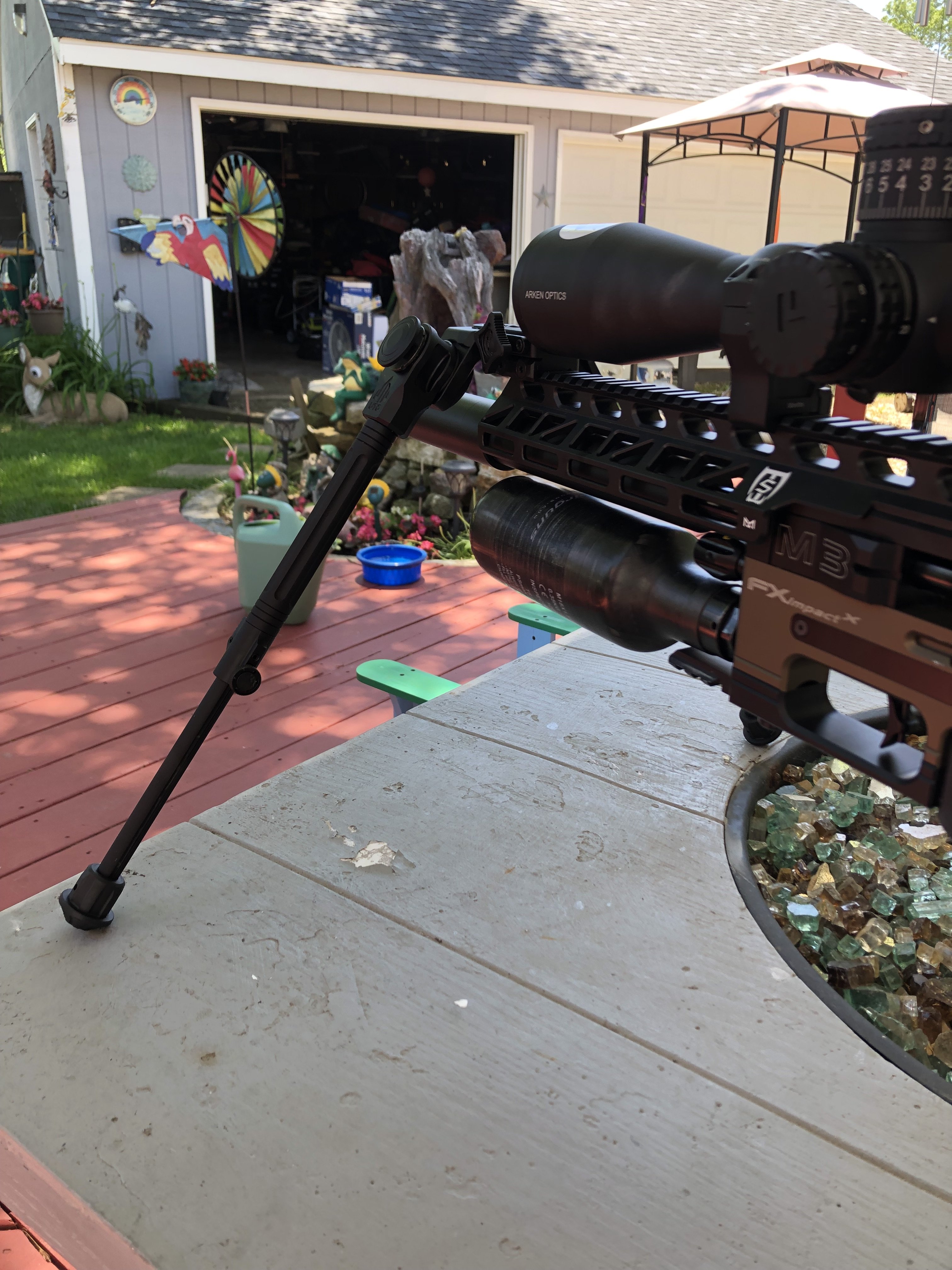

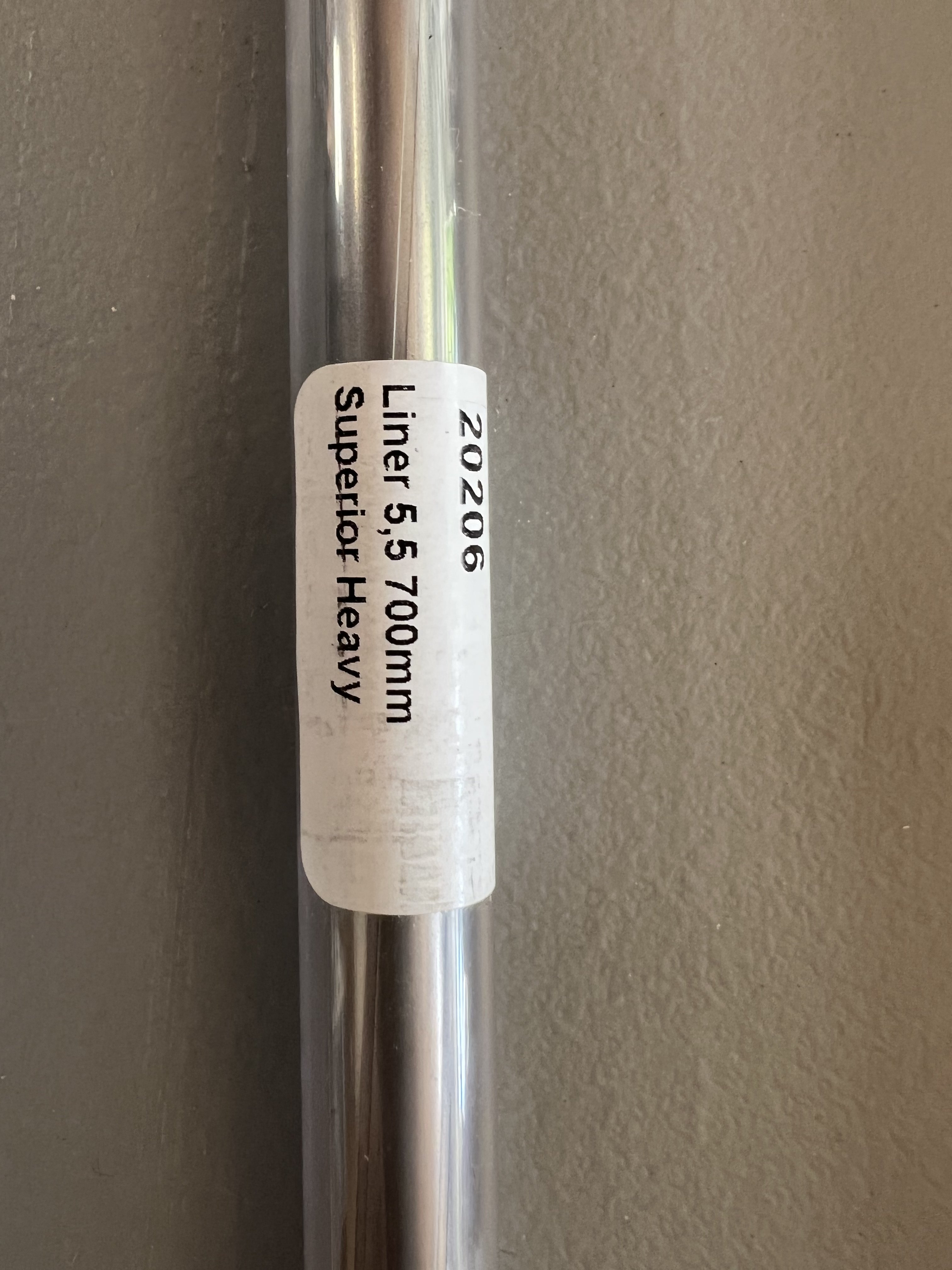

Huge Diff. In Wind between .22 MRD 25.4’s and FX Hybrid Slugs
I Have to believe that I didn‘t have my .22 MRD’s going Fast Enough this past weekend… Wind was really pronounced 15 mph, variable and gusty. A very Bad day for hoping to achieve any consistency with an air rifle.
Tried shooting 1st time at 100 yds anyways with new Crown Mk II / 600mm rifle. Reg was at 135 Bar., TX Port Large and Hammer at 18-19 (after setting cam for max travel) was slinging the MRD’s at 910 fps. Dial on 23 was only into 930ish. Rifle was Also shooting the FX Hybrid 22gr Slugs at the Same Velocity per dial as the MRD’s. I was able to select Trans. Port in Medium and dial down to 5-6 for about 900 fps for Exact Hvy 18.1’s.
Results were that the 18.1 Exacts held about 3-4 Inches on a little steel plate at 100y. I was figuring that the MRD pellet was going to blow the little ones way…but No Way. Those redesigns going 905-910 fps were a Disaster in the winds. Terrible 5-6 Inch grouping with even some Missed Shots!! Just awfully Bad.
Real Display of just How Good & Impressive the Ballistic Coefficient of those FX Hybrid Slugs in 22 gr. came when trying them on a whim at the Same 905-910 fps at same steel disc at 100 yds. My God did they fly well in those bad, shifty Winds! Of 5 shot in one string 4 of them all piled into about 1 Inch and the 5th was only another 1/2 - 3/4 away.
I have literally Not even shot 400 pellets or 30 slugs through this gun yet and I am just loving the intimate association with building and observing its accuracy and behaviors with different Ammo and Velocities. This has got to be the Ultimate rig for gun loving fiddler types (if you don’t want the chassis configuration of the other “super-gun” they make.)
I think will go up to 145 on Reg. and try to get to 950-960 with those MRD’s in the 600mm Superior Pellet Liner. I won’t be chasing them beyond that I dont think.
Again, though, just Flabbergasted at how Straight those FX Hybrids flew down that blustery 100 yd range with all the bushes around swaying and bending to arrive at a 1” cluster of 4 hits. Impressive. Bet I would have had a difficult time trying to do that with a bolt action .22 shooting some hi-grade Eley…
Any helpful input in the MRD .22’s in 25.4 grain encouraged. (Or other comments in general of course.)
