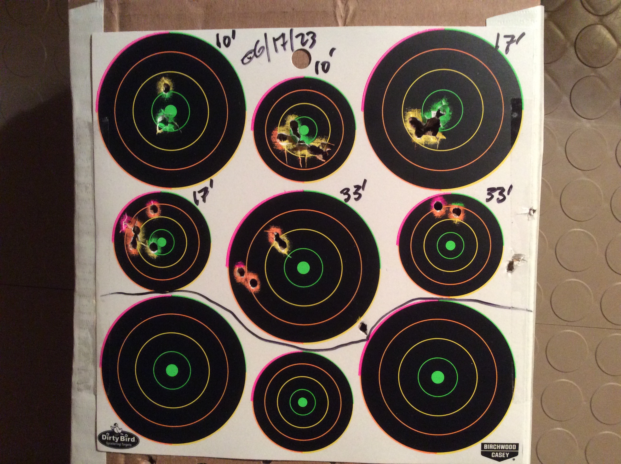

Benjamin  Marauder accuracy issues!!
Hi All, I have A Gen. 1 .22 cal Marauder rifle. It has always drilled tacks. I replaced the barrel a couple years ago with a Walther Lothar barrel (after a friend buried several pellets in the stock barrel. Once again, was always a tack driver. More recently, the trigger broke and I replaced it with a solid steel trigger that will never break (unlike the fragile and cheap stock triggers). It was still shooting very accurately after the switch out. I didn’t like how I had so much play in the trigger, so after a few weeks I decided to adjust the sensitivity and accidentally broke the sear (same cheap material as the stock trigger). I think it was because the rifle was charged (I didn’t degass it this time) and as I was unscrewing the assembly, it caused the seat to fracture. So I ordered a new sear, put it all back together again, and now every shot is way off center in every direction. Sometimes left, sometimes right, sometimes up, sometimes down. My sight is a Sightmark Wraith that has always zeroed perfectly with only a couple of clicks but isn’t able to zero at all now.
Did I damage something when I first pulled the trigger assembly off? Did I put the assembly together wrong somehow? Could the digital sight be going haywire? I’m really at a loss here….
