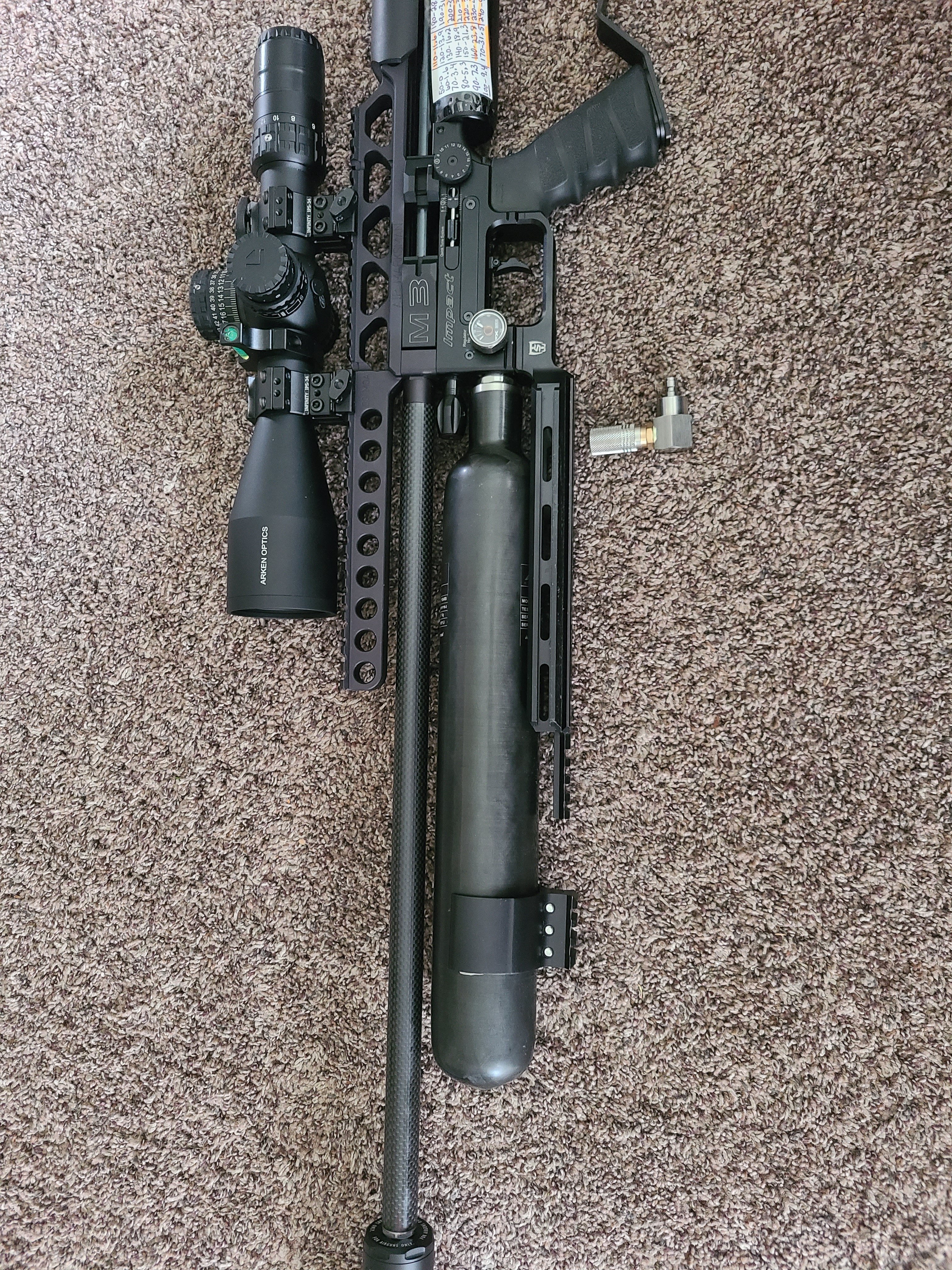

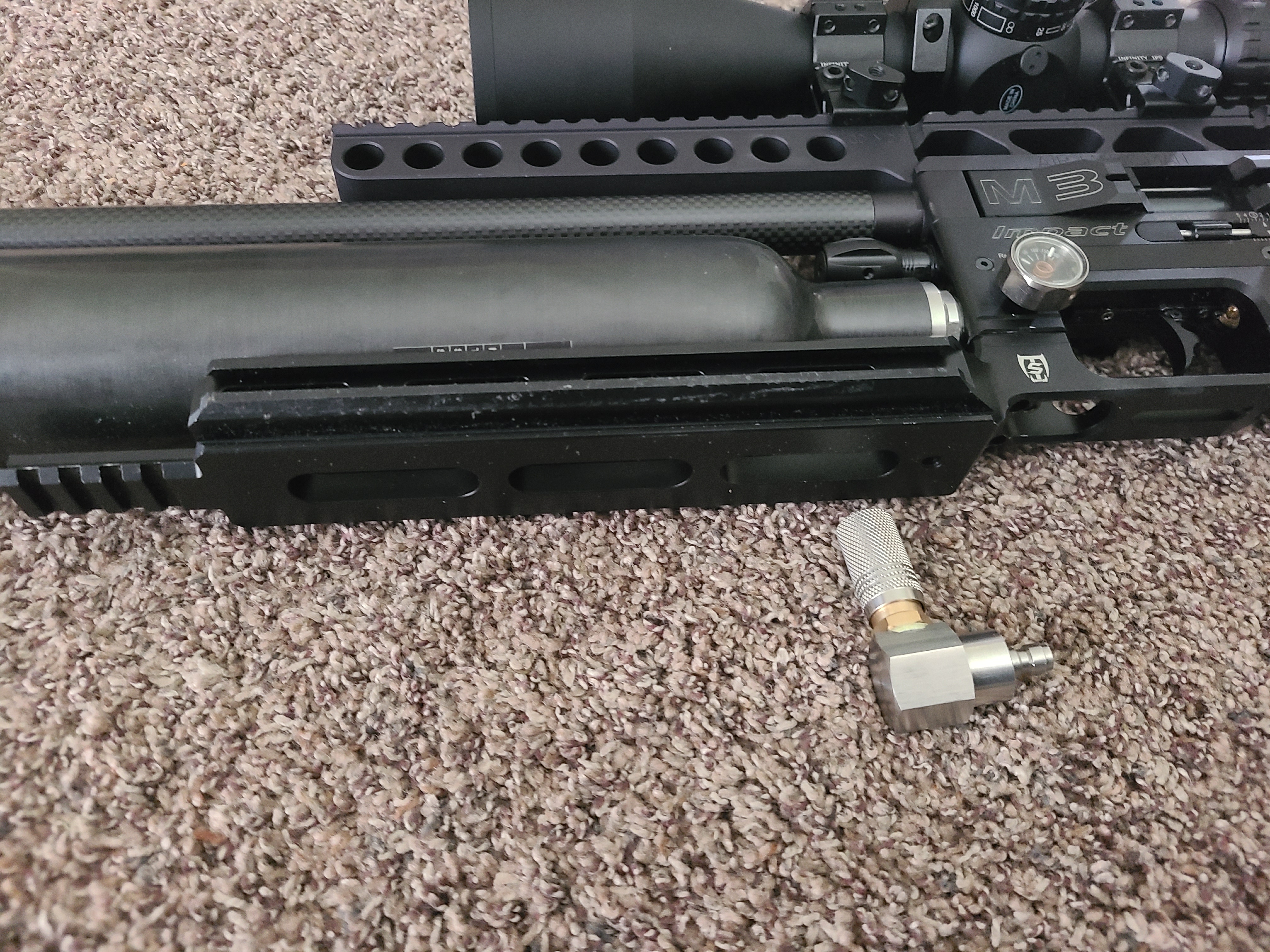

PCP Rifle  WTS Fx impact m3 .25 bronze for sale
Have my fx impact m3 .25 cal 500mm for sale. Has a few upgrades huma power tuning kit, pin probe, springs and hammer with donnyFL tanto, nsa slugs and Zan slugs with it. Scope not included. Prefer local here in Fresno, ca $1,400 obo no trades

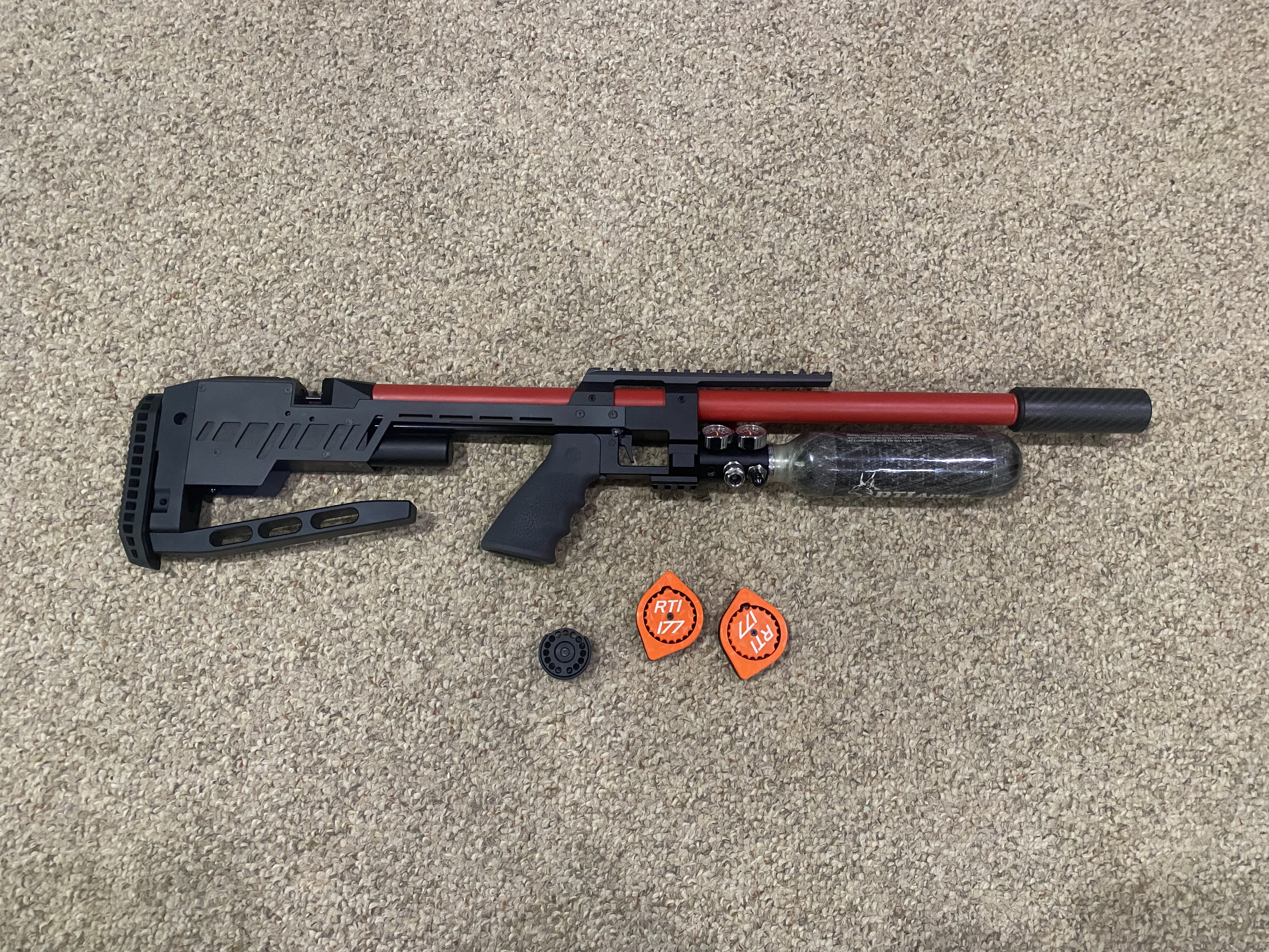

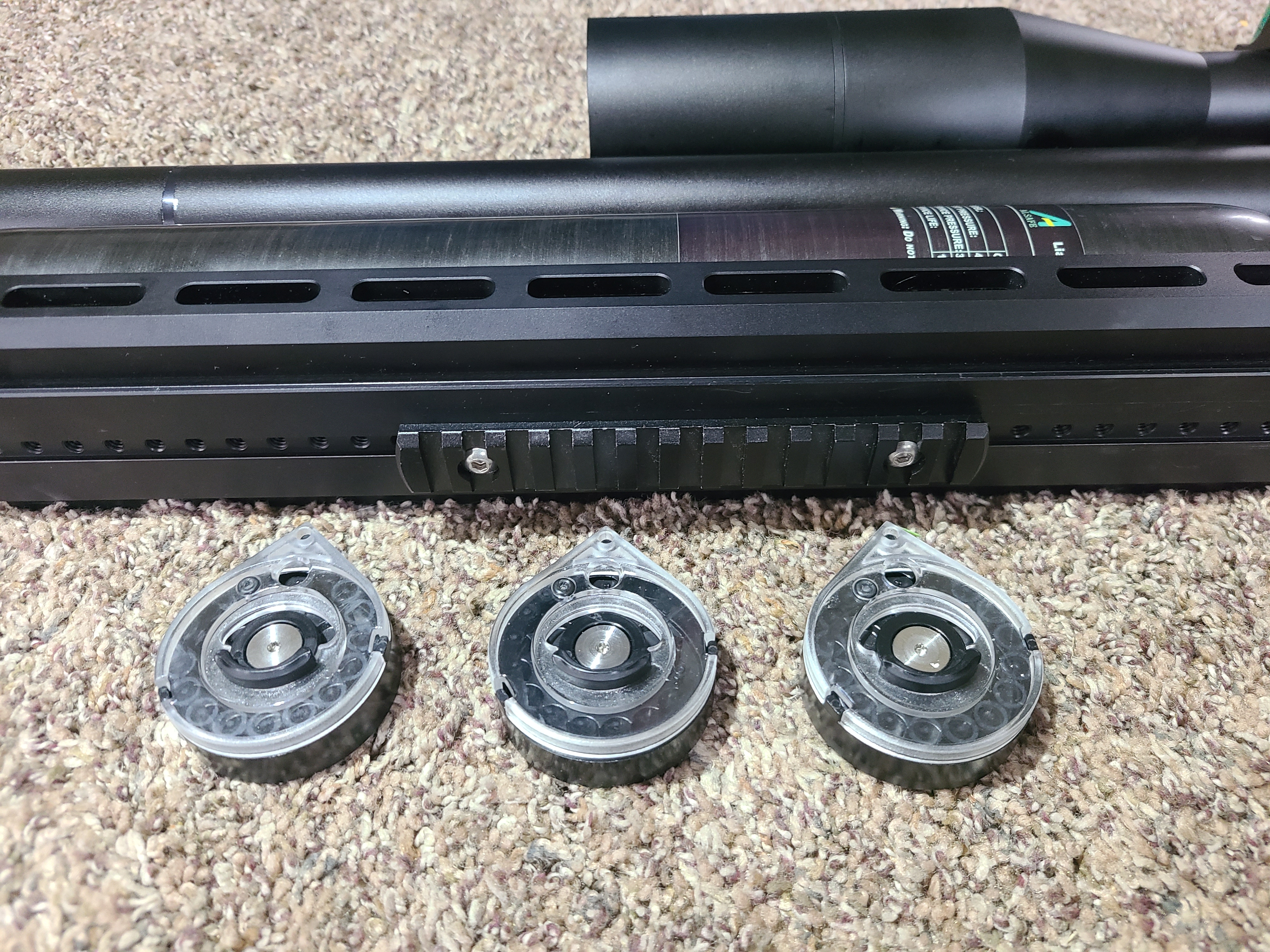

PCP Rifle  SOLD WTS- P15 bullpup (price drop!!)
.22 cal P15 bullpup. Was slinging cphp 14.3s around 900fps very accurately when I bought this from another member.
Since then I’ve discovered it also likes H&N 21 grain slugs .218 size @ about 830 fps which is how it’s currently set to shoot.
Has air-fective shroud on it.
Super lite and super quiet!
This is by far the quietest air rifle I’ve ever been around!
The projectile flying through the air is louder than the shot cycle…
Comes with 3 CARM mags and 1 oem mag, also a CARM single shot tray.
I’ve had my fun with it. Time to try something different.
Asking $340 obo shipped inside the conus.

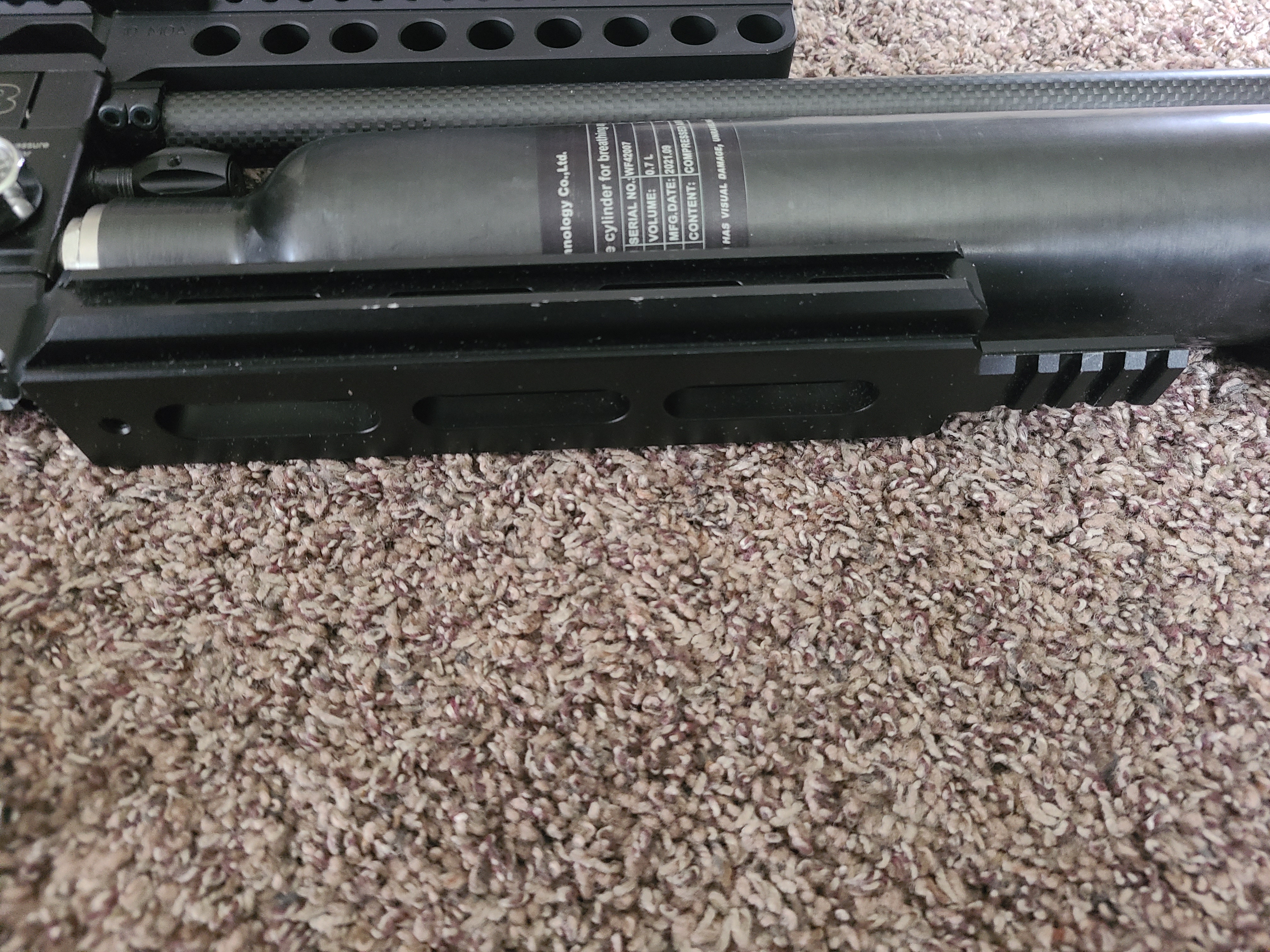

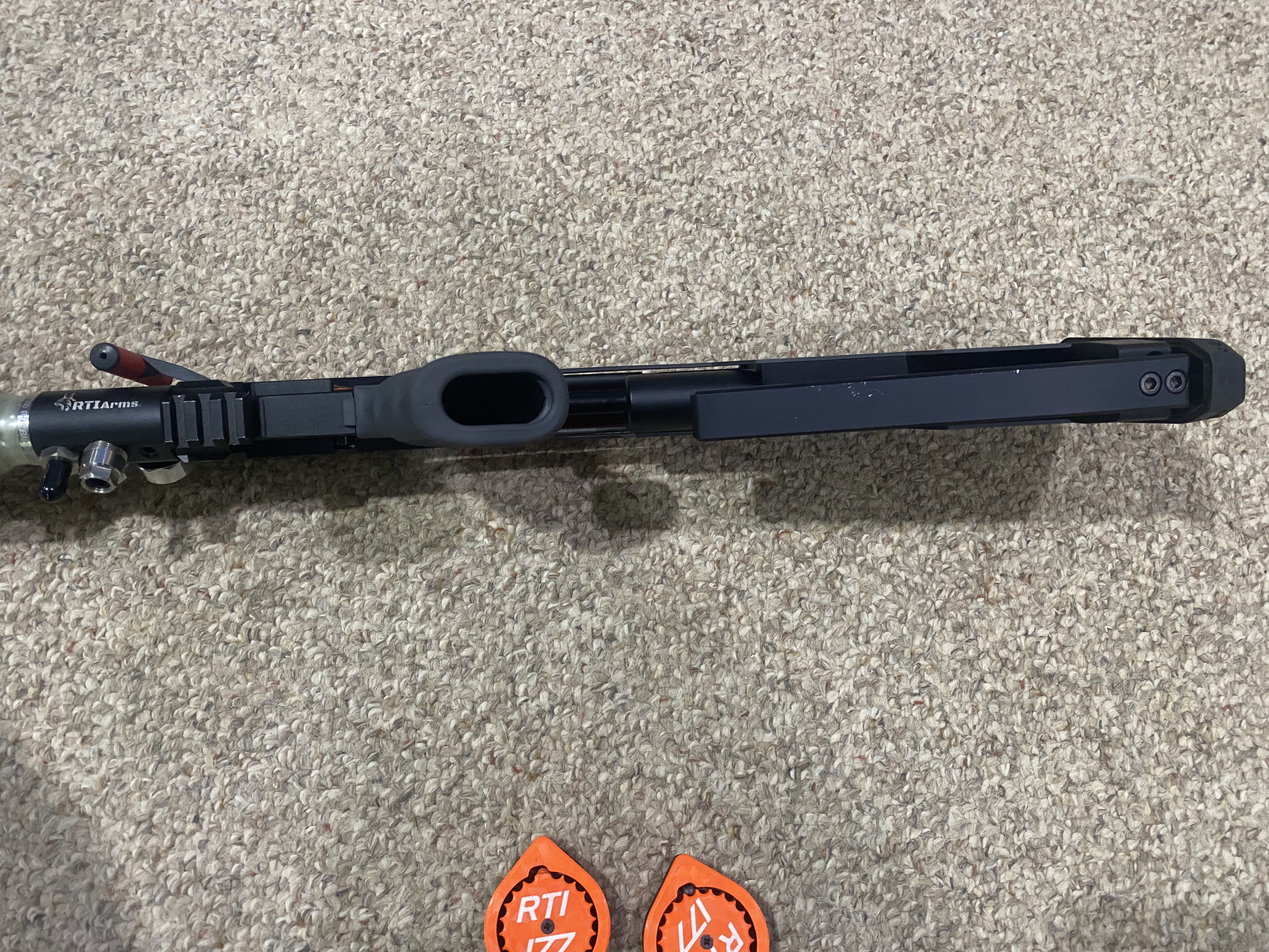

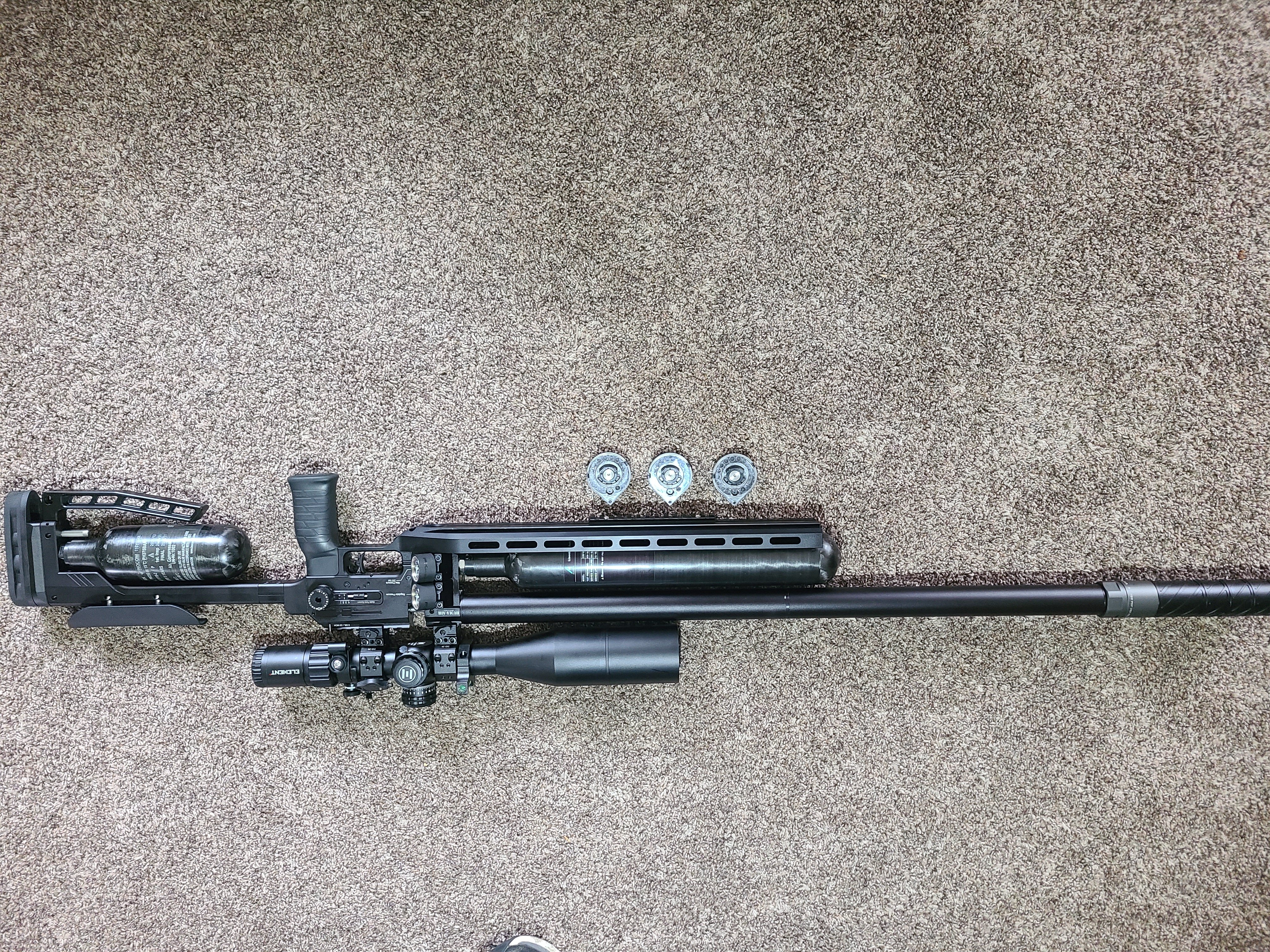

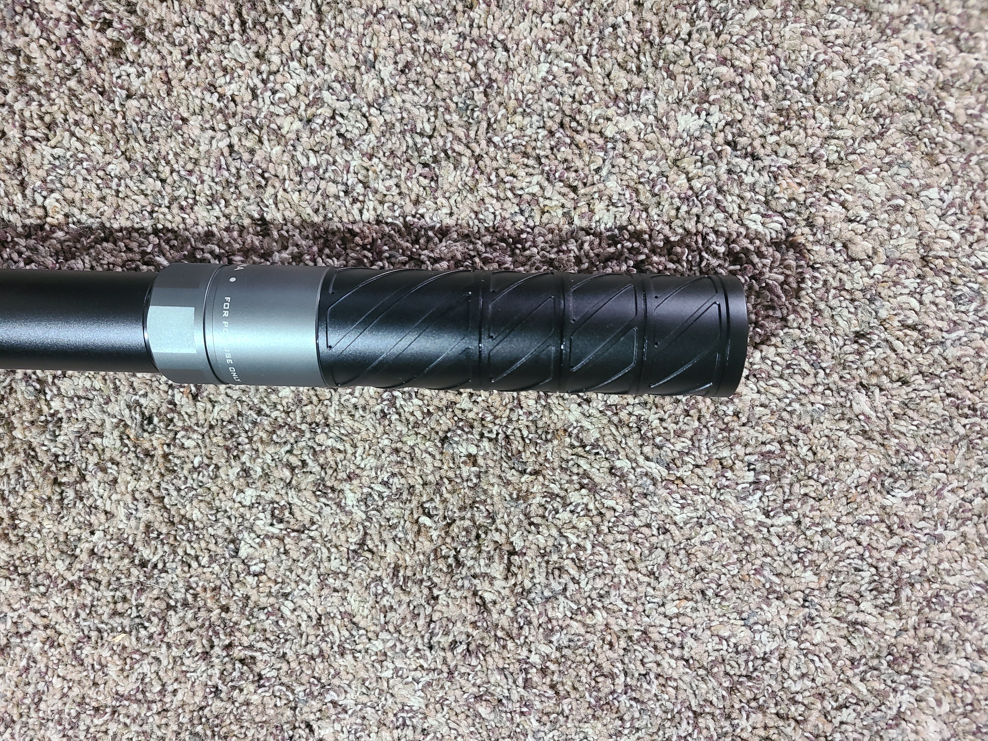

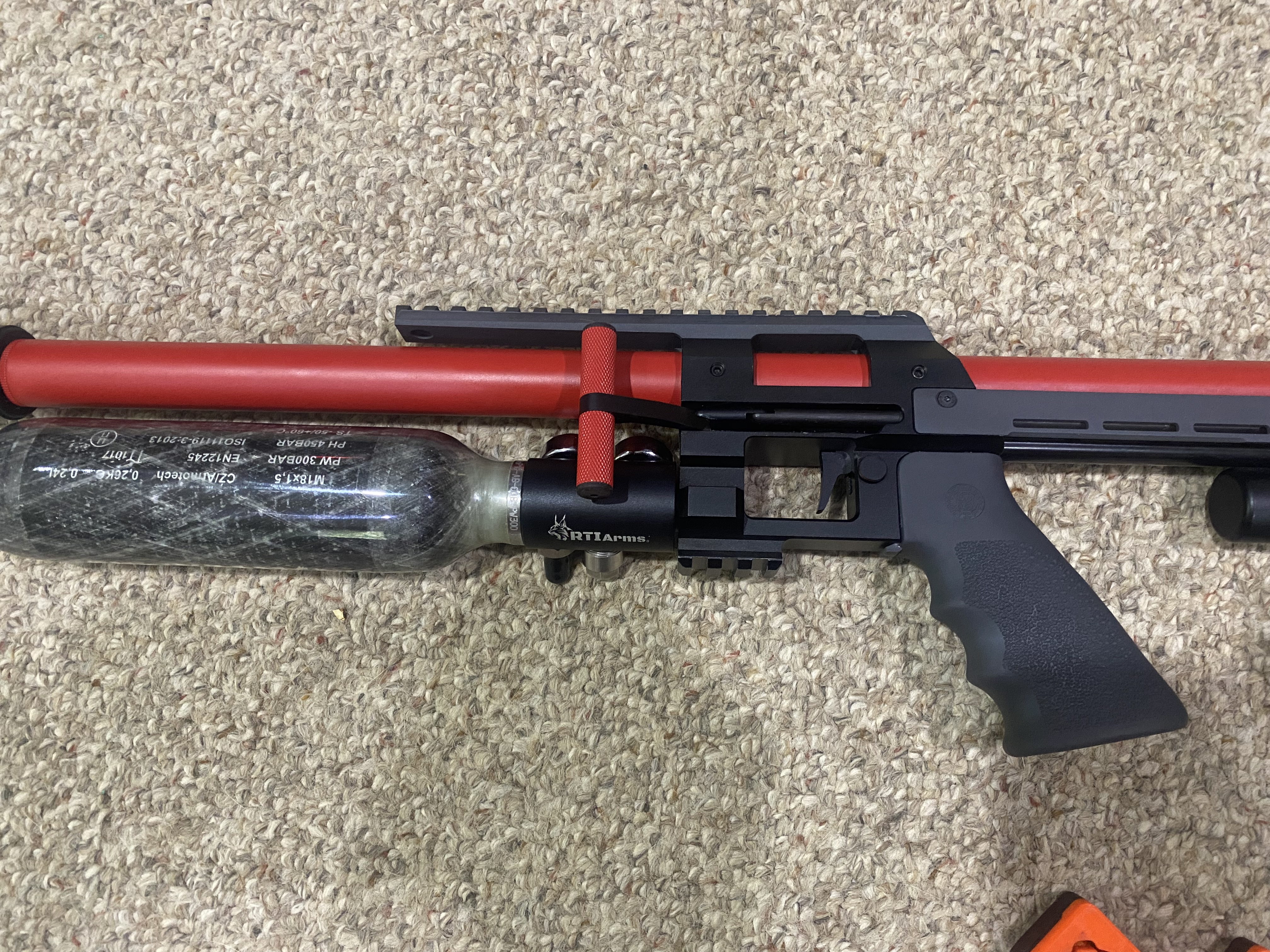

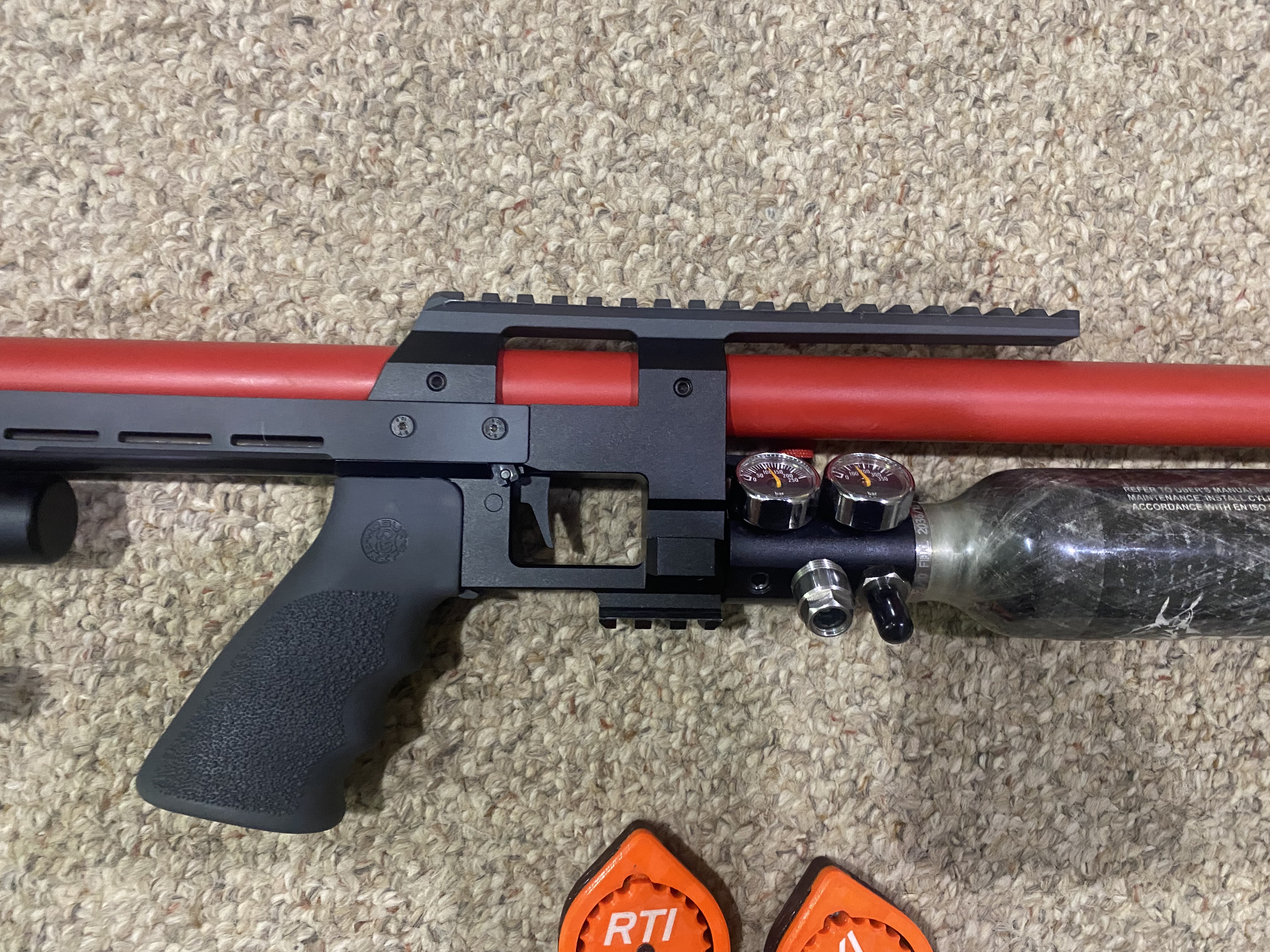

RTI  Mora .357 issues

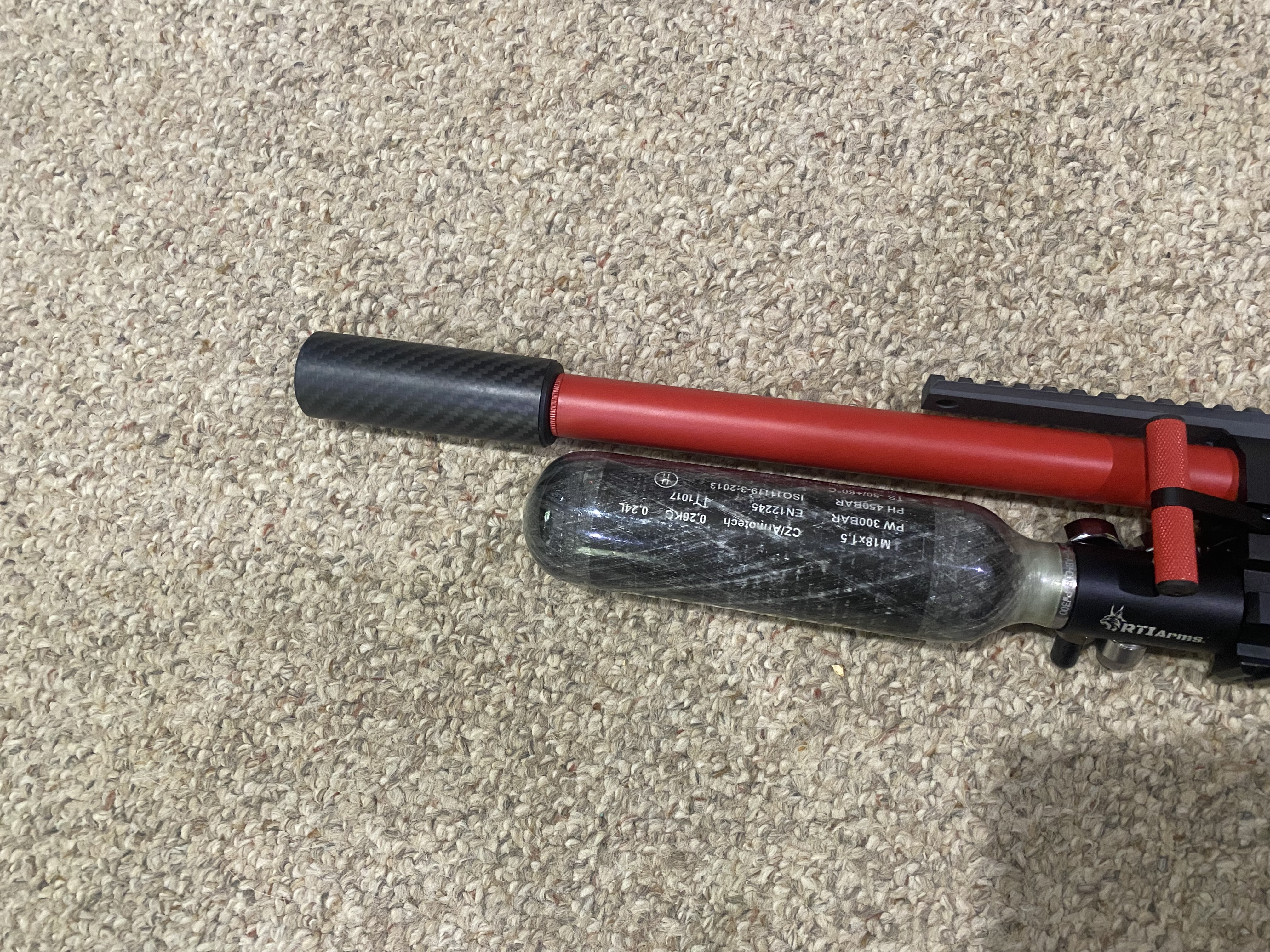

I recently received an RTI Mora .357 sniper that I had ordered. First impressions, it’s a beautiful gun, feels great in the hands, very light and smooth cocking and great trigger, also very quiet. Out of the box from Talon Tunes it was shooting 100gr zan slugs at around 215 fpe.
Issues I am having: pellets and slugs are clipping inside of the air stripper in the shroud, throwing accuracy way off. I have tried 3 different weighted Zan slugs, 2 different weights of NSA slugs, some home cast slugs and JSB pellets. I opened up the air stripper a little which helped accuracy without the provided hush 50 silencer attached, but now clips with the silencer attached. I’ve spent some time shooting without the silencer. When I go to air up the gun and then return to shooting, the point of impact changes and I have to zero it again, this happens everytime. During one of my shooting sessions, the shroud base that clamps to the barrel blew back and I got blasted with air. Now the trigger is slowly moving further and further back into the handle. Currently have about 400 rounds shot through it. The gun did not come with the cheek rest or a user manual which I have read others complain about as well. Not exactly what I expected from a gun in this price range, but they are a new release and I guess there will be bugs to work out. Currently working with Talon Tunes to see what we do from here.
Just wanted to share my findings and see what others might be experiencing.

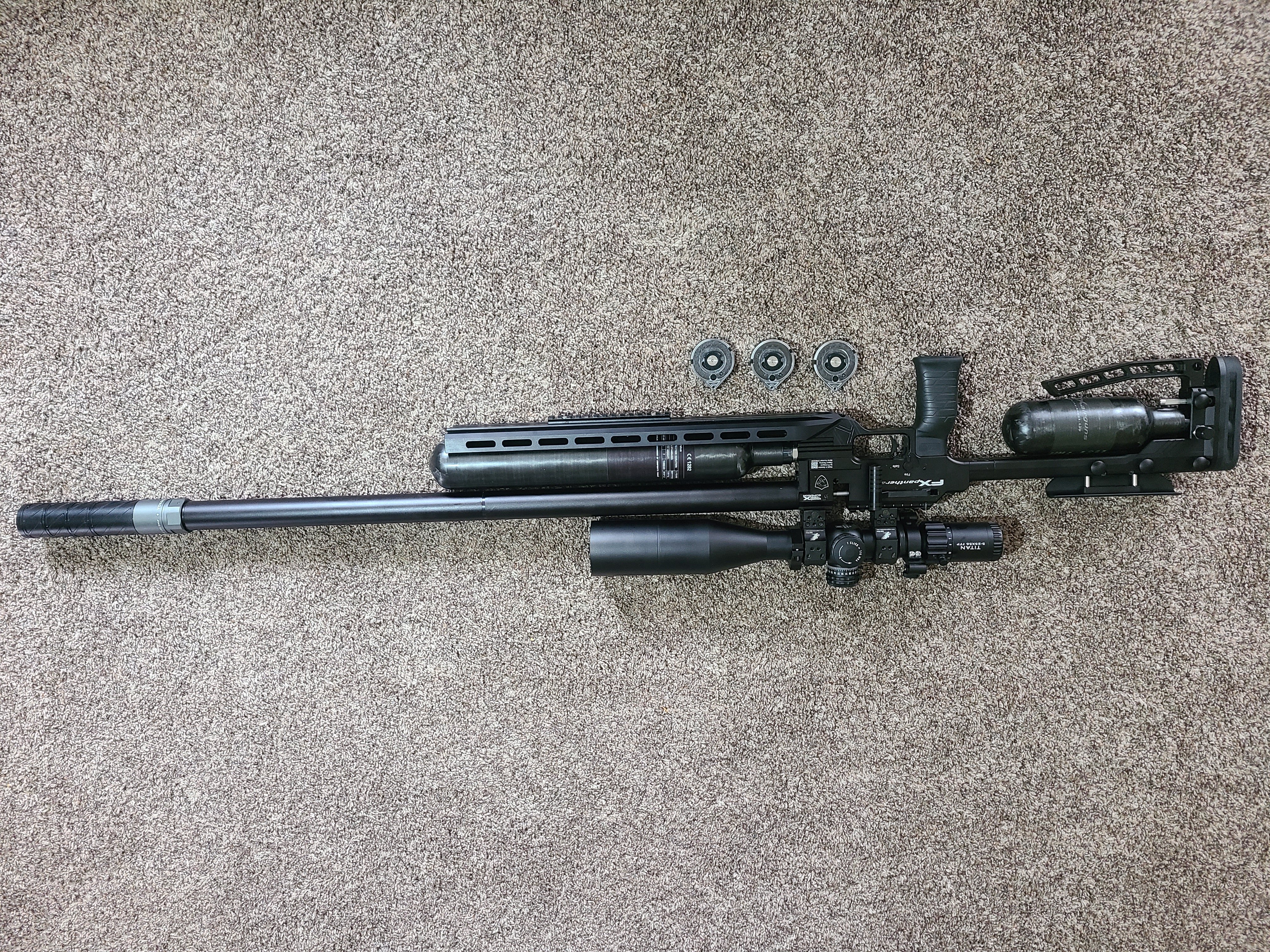

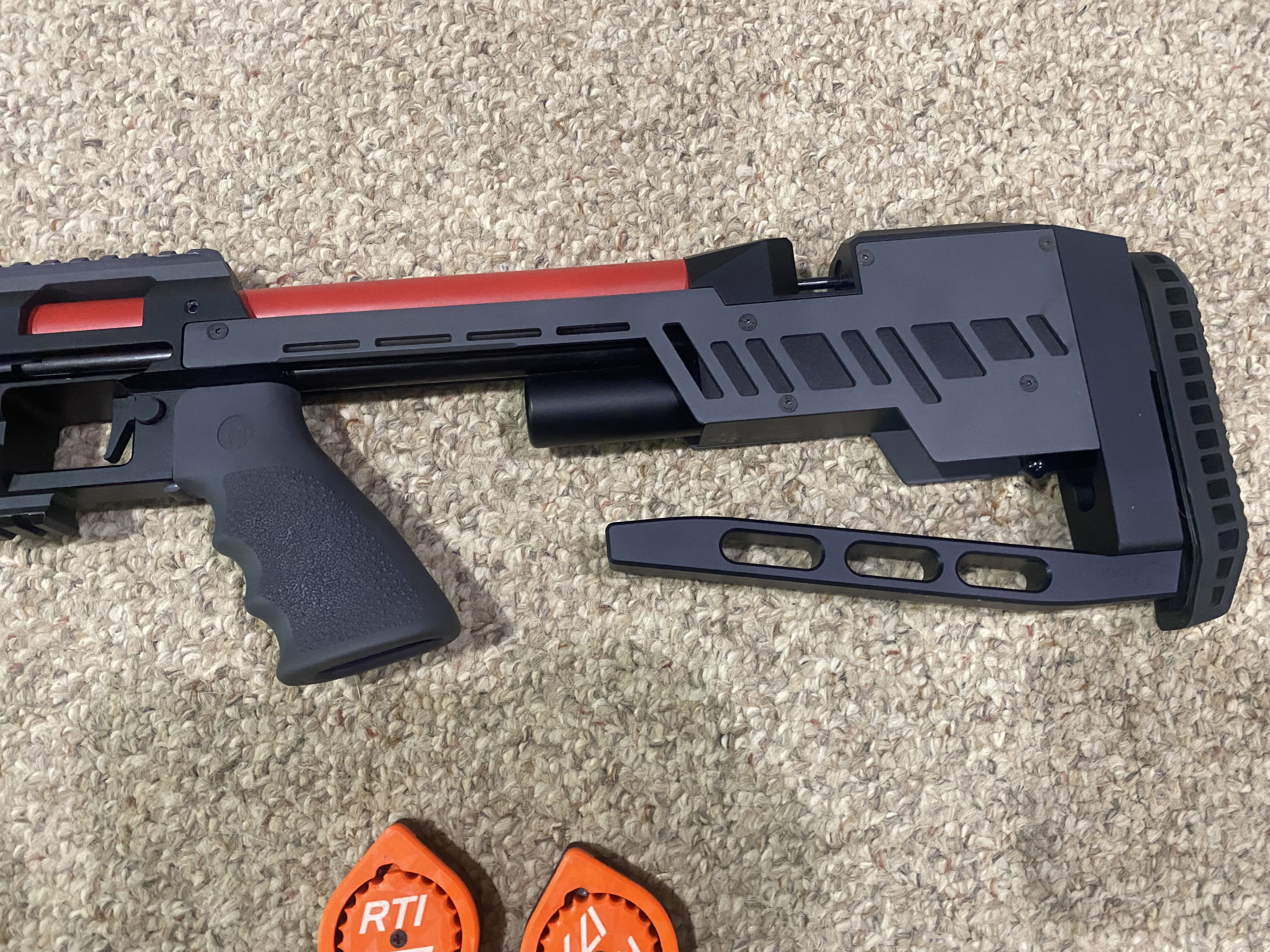

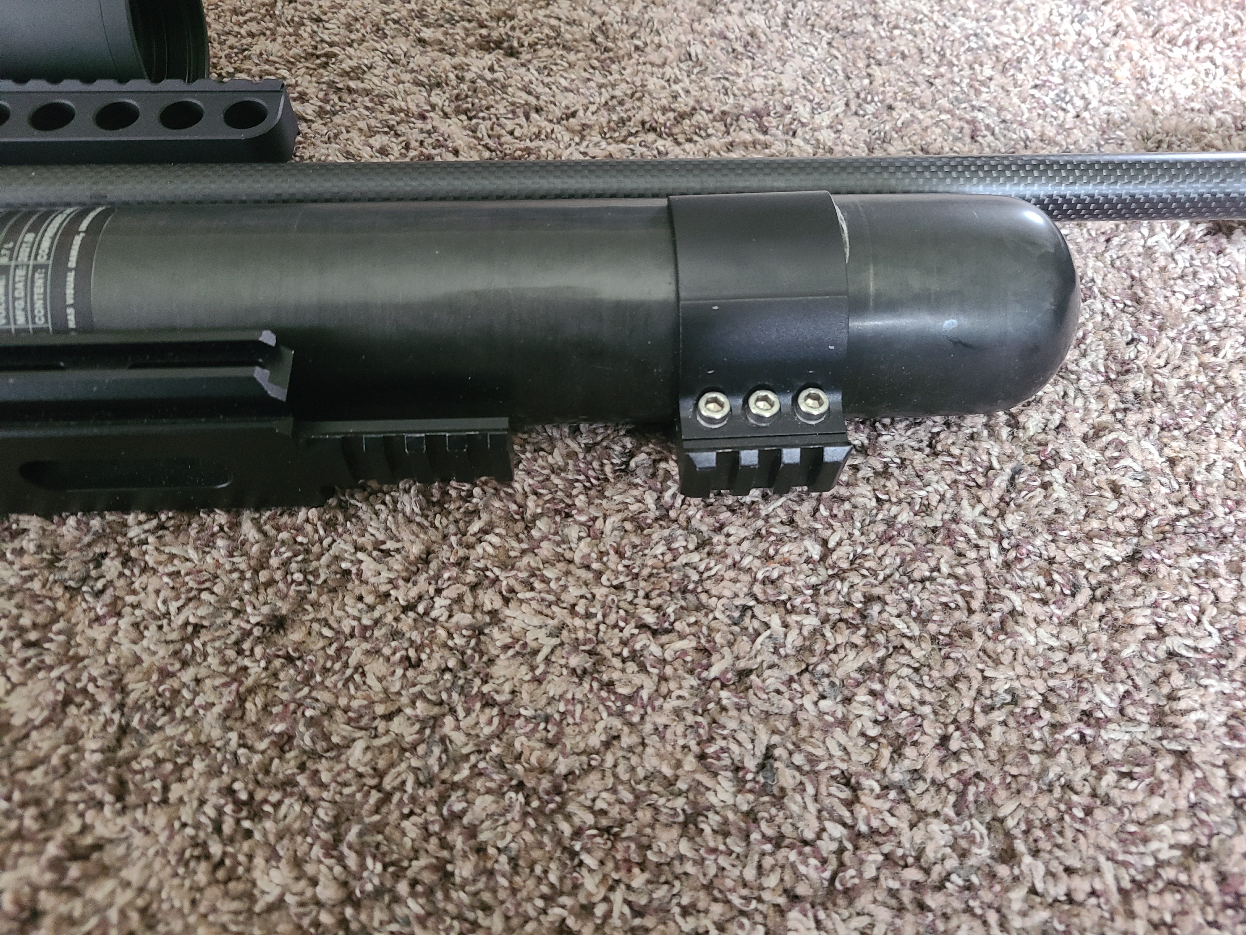

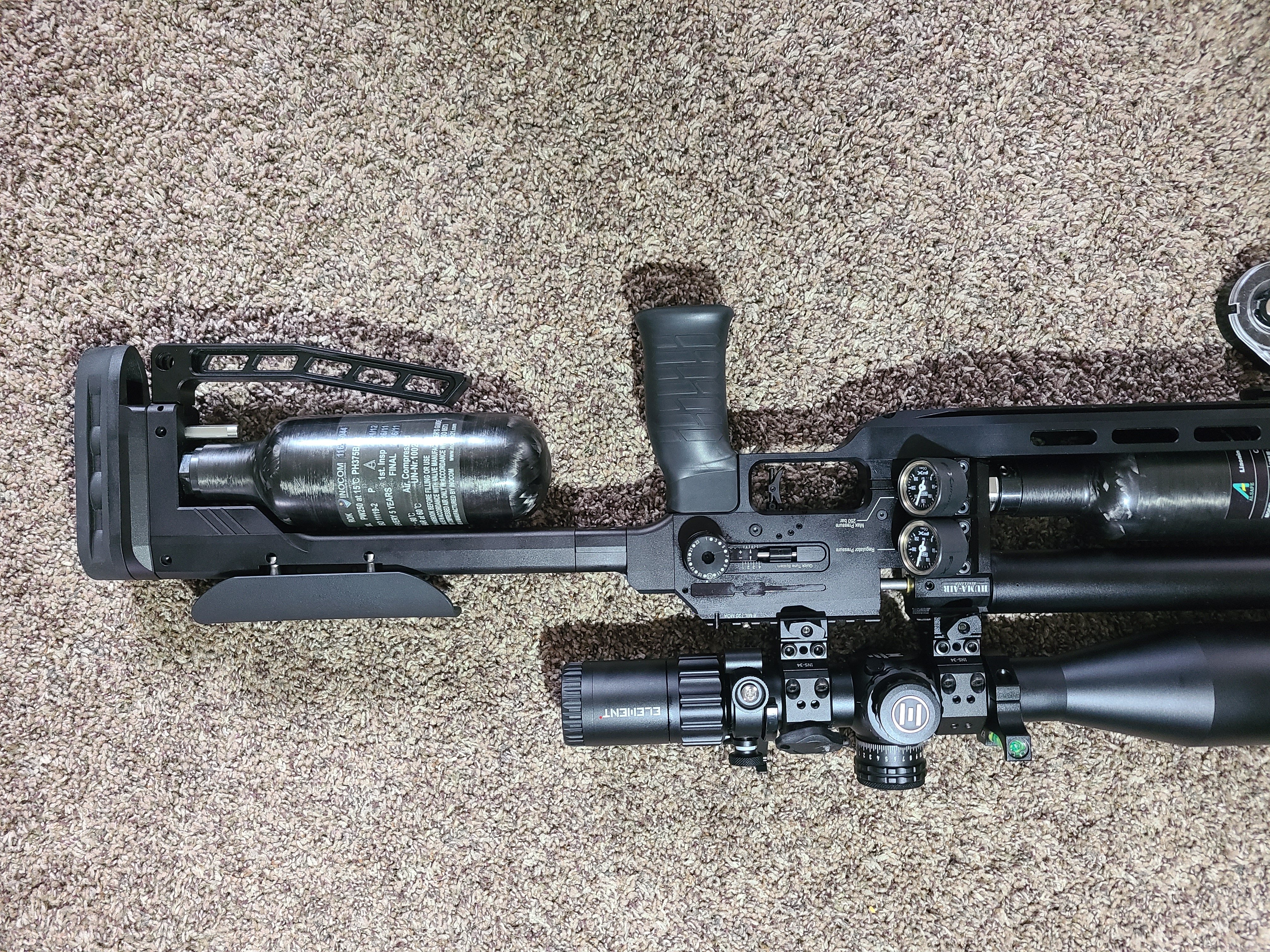

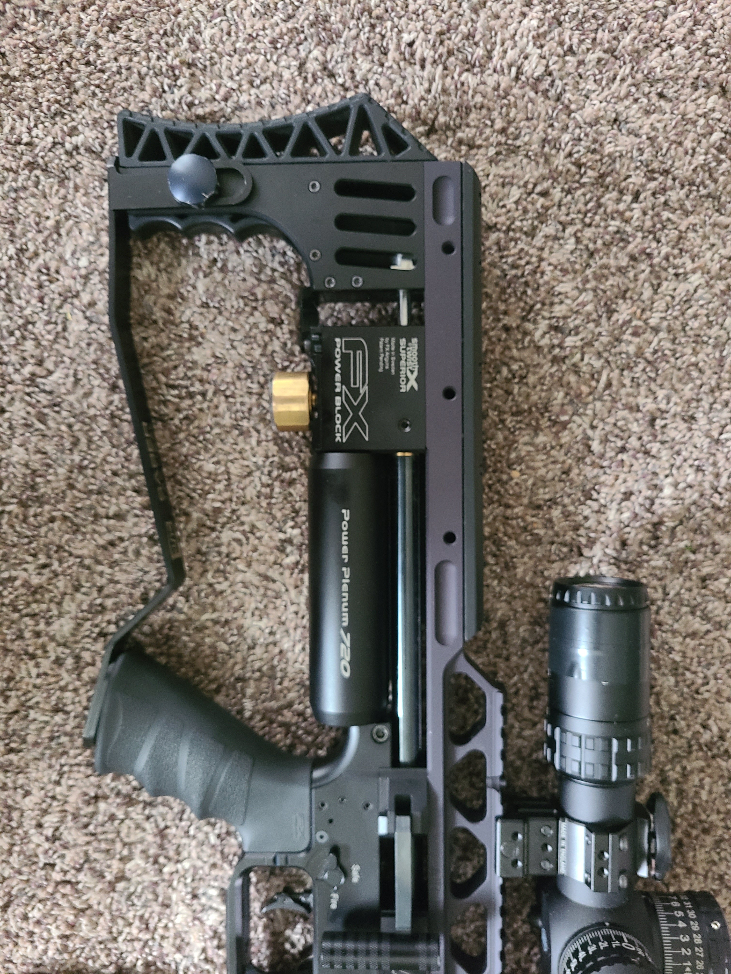

PCP Rifle  NLA SOLD FX Hunter Compact .22 with original hard case and papers, in MINT condition
SOLD, NO LONGER AVAILABLE
480cc carbon fiber bottle mounted on front. Below that is a Saber Tactical ARCA rail (protects bottle). Upscale AR Folding stock with FX folding adapter. ALSO includes OE buttstock.
Saber Tactical ARCA rail, Zulus 5-20 Day-Night Vision scope, FAB Defense combo forward grip and bipod, Eylar hard case, 38" and DonnyFL quick connect on muzzle are not included at price of $1700 but if you are interested in those items, I am sure we can come to an agreement
So, to be clear, $1700 gets you this Mint FX Hunter Compact in .22 with original and folding buttstock and OE FX hard case for it. Image shown is actual image of this item.
At LEAST 3 magazines included. FX Folding stock adapter and buffer tube and castle nut included as well as FX Drop don adapter.
Located in Fairfield County CT. Local pickup is available.
No sales tax.
Payment with Zelle at this price. If you want to use PayPal, add 4.5% to cover my fees,
Must me 21 or older to purchase. I only ship within Continental USA. I will not sell or ship to residents of NYC 5 boroughs, New Jersey, Washington DC, Los Angeles or anywhere else where possession/ownership of this is prohibited by law/ordinance.
This gun does not and has never leaked. Perfect like new conditioned. Already tuned for JSB 25.39gn pellets.
Buyer pays actual shipping cost. UPS Ground preferred.
I am selling because I want the Hunter Compact in .30 and have one on the way to me.

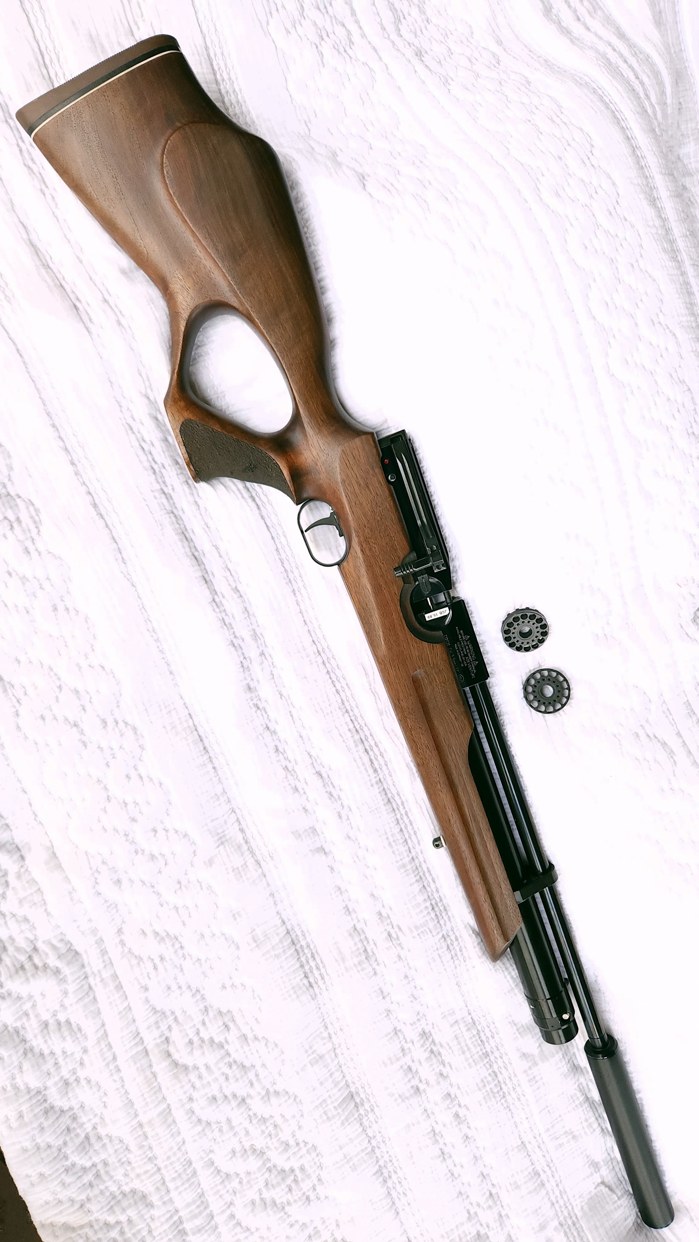

HW/Weihrauch  Acquired a HW30 Delux last week ... Fresh ARH seal, Piston sleeve & fitted guide .. WHOA SMOOTH !!!
I know as a tuner I've been here before, tho been Years since doing an R7 / HW30 and this time around it was personal !! ... Lol
Tearing it apart did a ball hone job on inner tube surfaces placing a nice cross hatch on compression bore & also deburring the cocking slot & holes that the seal must pass over when fitting said seal and final assembly. Cleaned it up and fitted a new ARH seal for nice light fit ( These low power guns need a loose fit to have any chance at OEM power output )
Polished tail of piston and checked latch rod run out in the lathe which did need a tad of straightening out. Next up using 3/4" ACETAL rod made up a spring guide that was a light slip fit to the OEM spring & then opened up washer a tad to fit this now obviously larger diameter spring guide. Made a thin Top lat for piston end of spring. The spring ends gets dress flatter on the belt sander with a small bevel at coils end so it does not dig in while rotating.
Inside the piston ( Spring bore ) gets a thick plastic water bottle liner cut to butt ends and flush out just shy of end once seated having butt gap 180* from cocking slot. The plastic liner on outside gets scratched up heavily with 80 grit and then we'll call glued in with heavy tar which will hold it in place. Tar is ONLY between liner and inner wall of piston !!!! As a lighter spring grease will be used ultimately.
Out on the Yoke end of main tube a little bit of stoning of surface where the thin thrust washers reside ( Factory surface on this one was ROUGH )
Using a flat stone & WD-40 just kissing the high spots around washer placement will smooth up the cocking further.
The cocking linkages lower surface that contacts tube was also stoned flat & polished up with 600 wet.dry. The tube forward of cocking slot deburred and also smoothed up.
The slot itself cleaned up and the sides of the slot stoned and 600 smoothed up full length.
At this juncture we get out the lubes and get the primary action reassembled. Barrel pivot and washers, lower cocking linkage get heavy moly grease, Piston bore and behind seal my proprietary moly/graphite/oil blend, as well within tube at piston skirt to bore. Lucas Red-N-Sticky on spring & guide. Gets assembled setting it aside for the moment.
Trigger next .... No need to disassemble as these Rekord units really just need correct adjusting of the Intermediate link screw ( Torx head No touch it screw ) spring preload screw behind trigger blade & bending of the tab stop forward of blade. All done we have a short 1st stage, No creep & VERY crisp break with light tension on trigger blade .. Perfection !
Reinstall the trigger block after placing some moly grease on sear, and other catch /release linkages with white grease on safety plunger & spring ( grease on spring stops the Twang of releasing safety and some noise upon firing )
We're done and get action back into stock with loc-tite on screws.
Cock & release moving piston up & down bore @ 10 times or so to distribute lube from piston to the comp chamber walls. Next cocking is live fire with a jsb 8.4 ... THUMP hardly having action move and making ZERO mechanical noise from spring, piston, linkages etc ... just a sublime light bump & thump being just what we wanted. :D
For those reading along ... yes some very detailed info shared as my days doing spring gun tuning for hire is or has wound down after 10+ years of commercial service work.
If you understand what said ? ..... Apply it to your next home grown springer tune ... you'll like it ;)(y)
Low dollar super fun!
