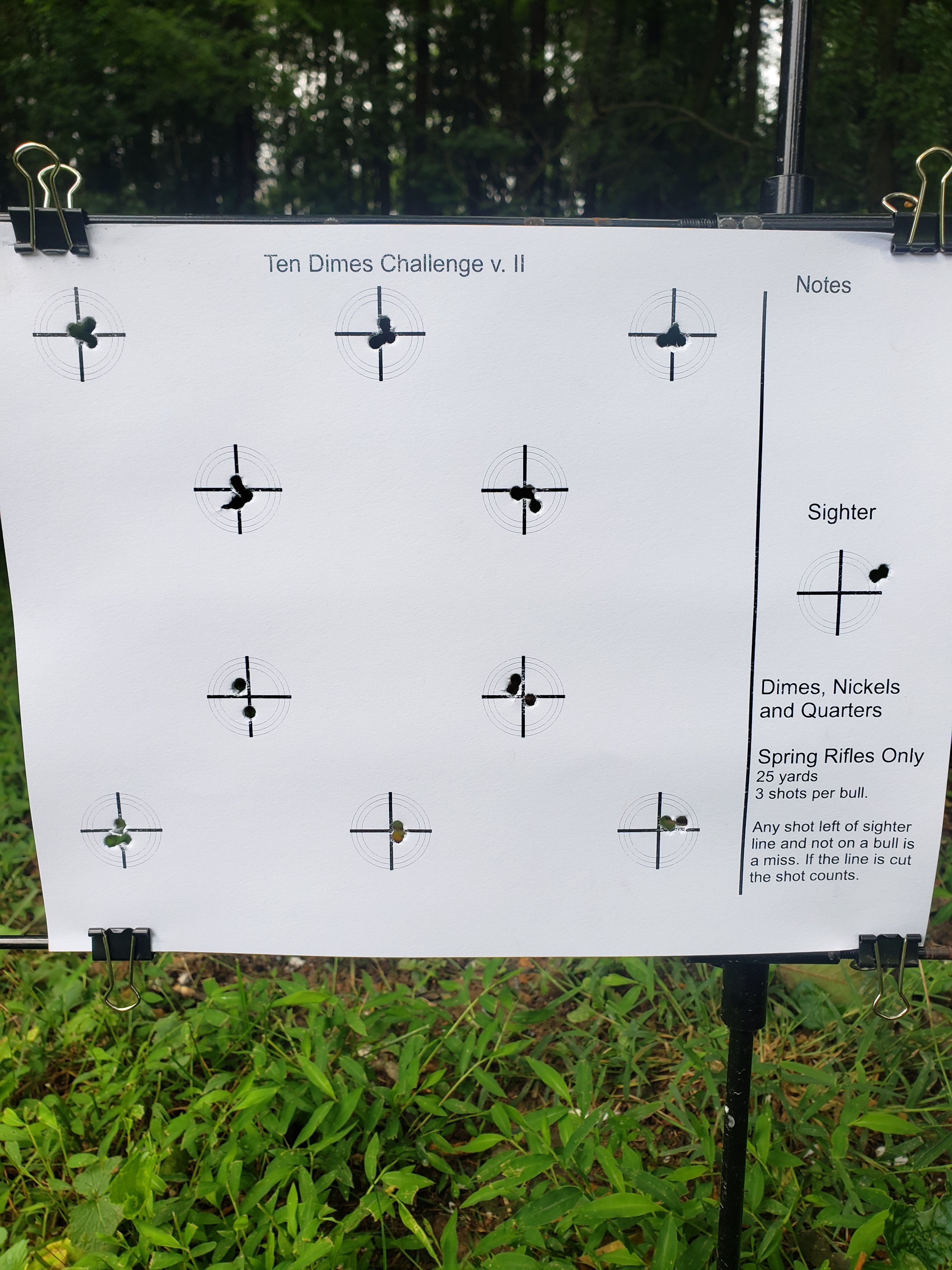

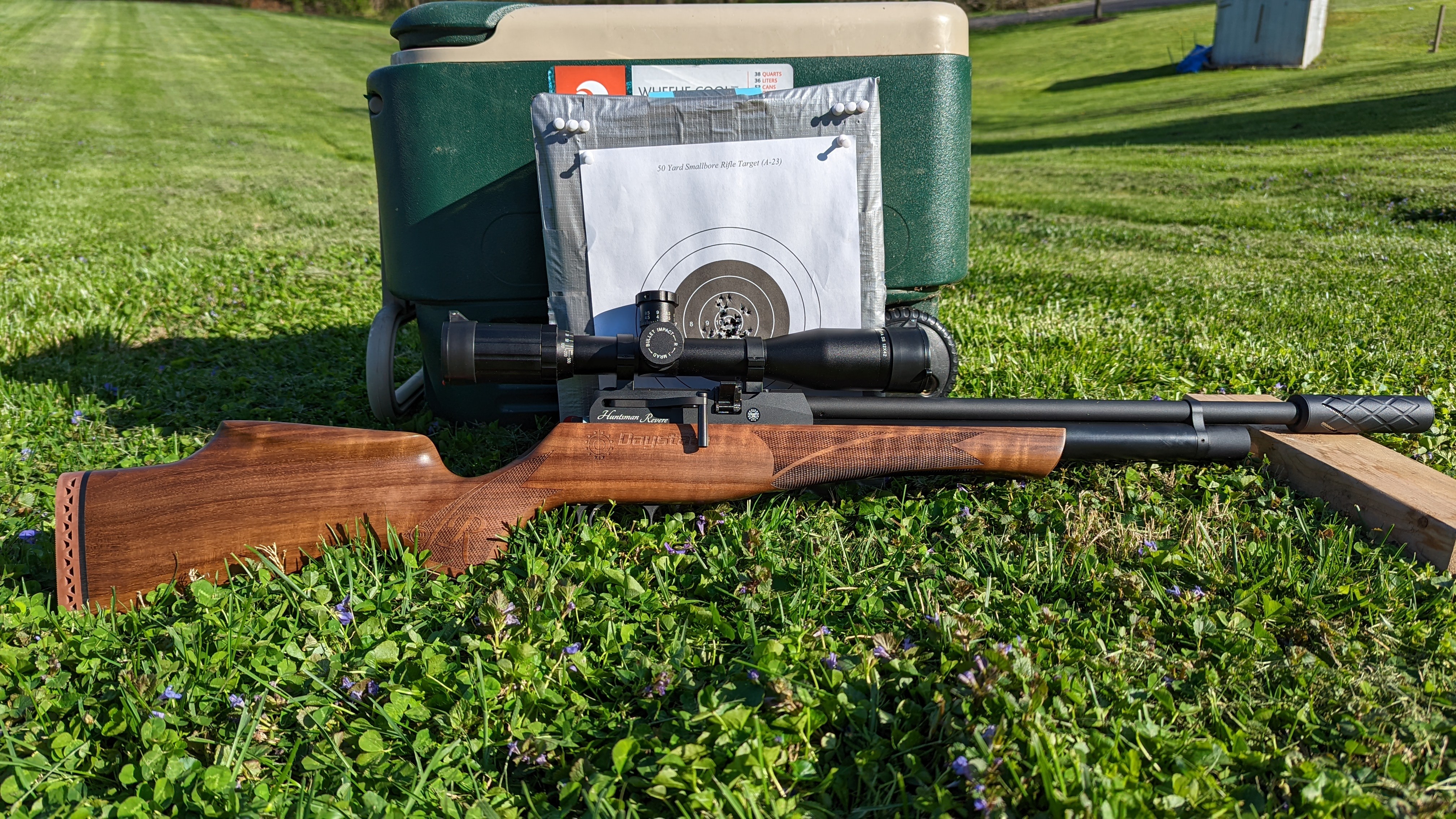

Freshly short stroked TX200, 10 Dimes at 30m. I think it may be a winner.
Made a post yesterday about short stroking my TX200 and today I got the chance to actually test it out without unpredictable wind wreaking havoc. Well, I think I'm going to leave well enough alone here. There was only one questionable shot out of 30 (AND IT WAS #30 OF COURSE!) and even that one was only barely touching the line. I got excited and aimed my crosshairs over the pellet hole instead of the bullseye so that is on me. Anyway, I am super excited to keep seeing what this "new" girl can really do!
#30, The drunk pellet of the bunch kissing the line:
EDIT: Decided to try again. Missed one high. I'll get this stupid game eventually!

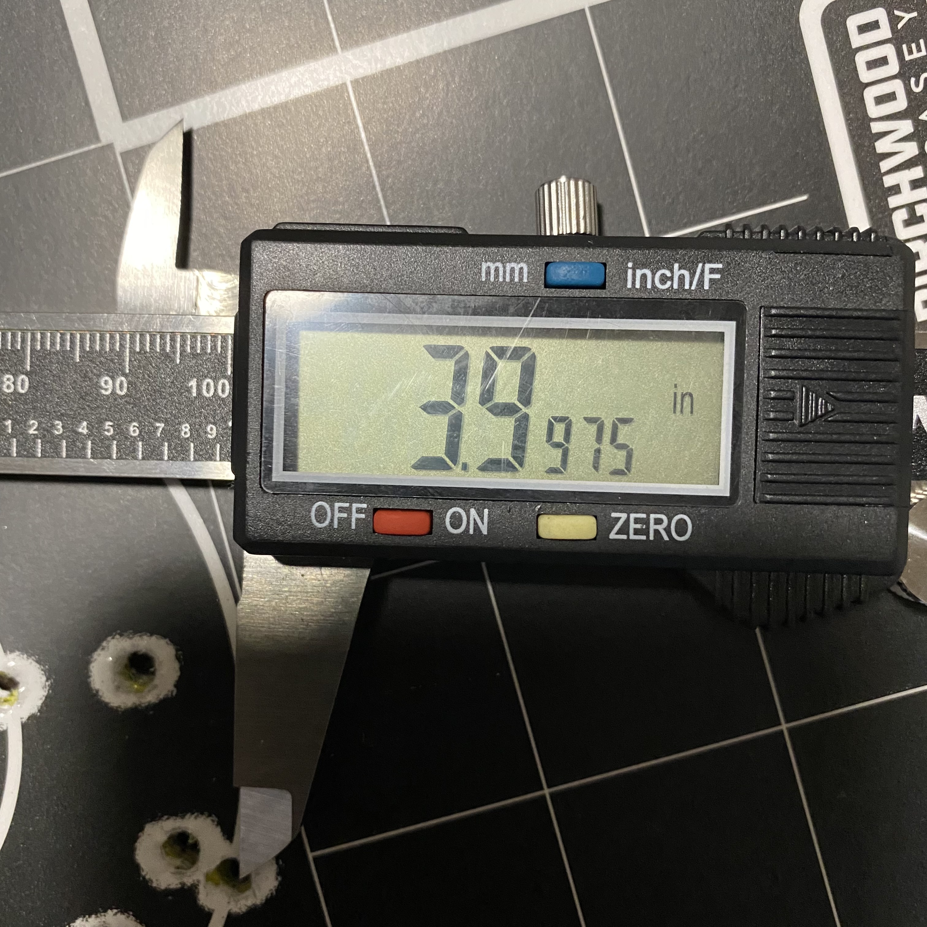

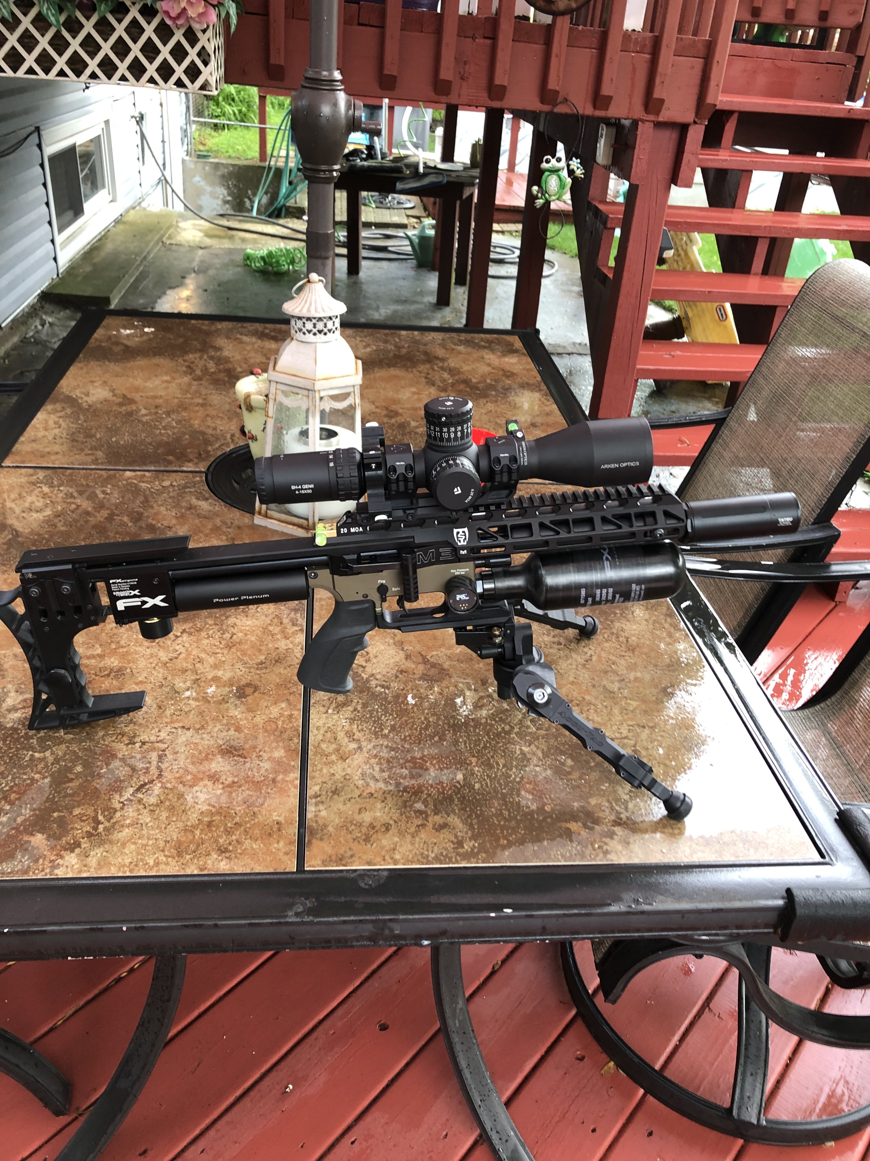

.25 cal Impact M3 grouping
First time at the indoor range with my brand new Impact 25 cal 700mm barrel. My set up is as follows for my question. STX barrel set with the slug port open. DonnyFL moderator.
1. 250 bar fill
2. Reg 1 @160 bar
3. Reg 2 @100 bar
Macro 15
Micro 4
29 gr NSA slugs. Slugs were lightly lubed with WD40 silicone spray the day prior. The chronograph string is as follows after 26 shots at 50 yards.
High-974 fps
Low-935 fps
Average-956
Spread-39
Std Dev-14.9
The group started on the bottom and steadily climbed and basically settled at the top with the raged hole happening at about 940 fps. I’m very new with the impact and very much aware that it’s basically infinitely adjustable and I’m very welcoming of ideas.
I’m very curious as to why the POI changed steadily in a vertical direction while making zero adjustment to the aim point, shooting off an accutac bipod, using a rear bag for support. Is it simply a matter of the gun breaking in? Did the silicone lube potentially cause this?

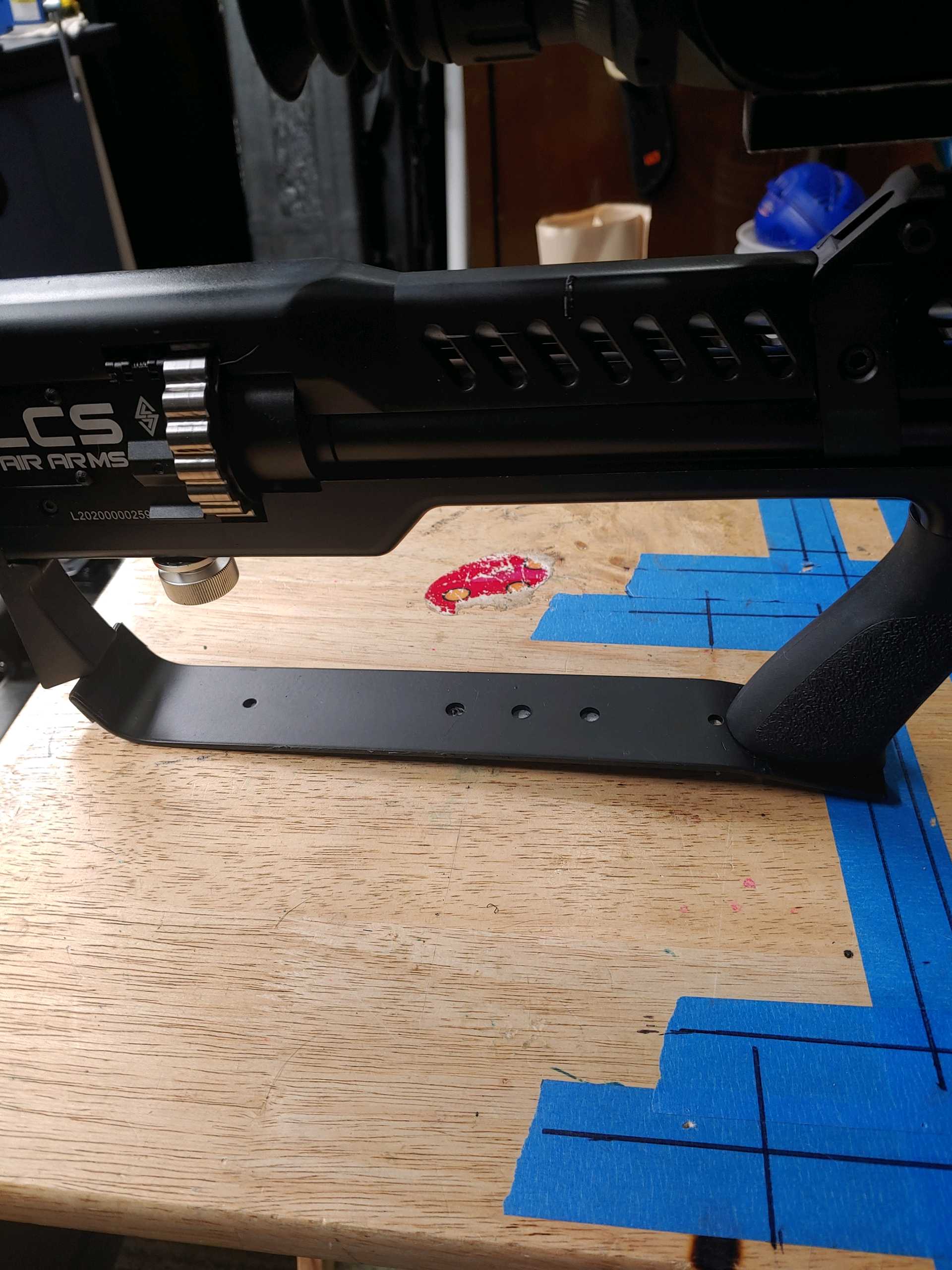

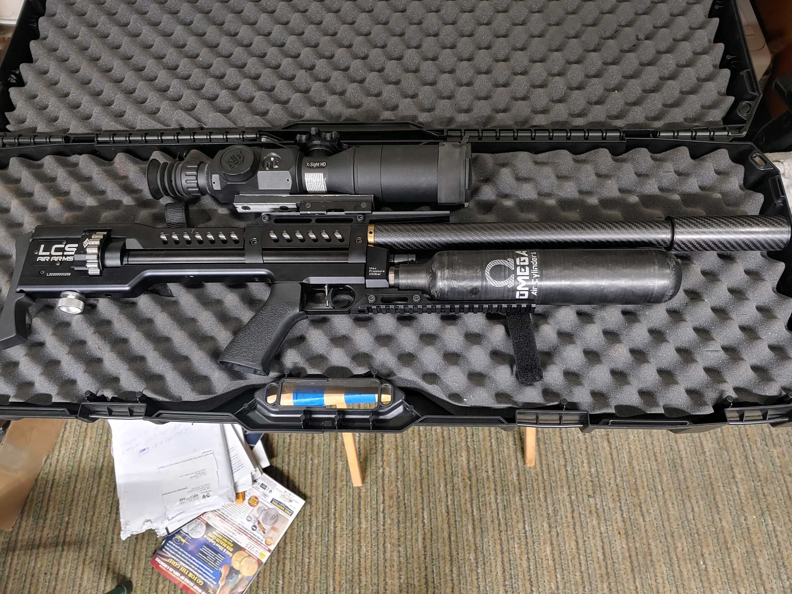

SOLD LCS SK19 .22
LCS SK19 in .22 caliber. I bought it from AOA 2 years ago and recently had it sent in and had some internal upgrades done. It's in great condition and have never had a issue with it leaking. It has the 580cc bottle. I installed a barrel band, bought from another member on AGN, that makes installing the barrel back on after cleaning and getting the spacing off the magazine , every time, no problem.I made a bag support so it can be shot off a back bag. It's accurate and fun to shoot, I just am parting with it to buy another air rifle. 1500 and buyer pays shipping to wherever you live on which carrier you choose. My location is Missouri. Money order or cash...I have many videos of me shooting it on You tube if you want to see how it shoots. It will be in the original plastic case in the picture. My ATN scope currently mounted is not included.

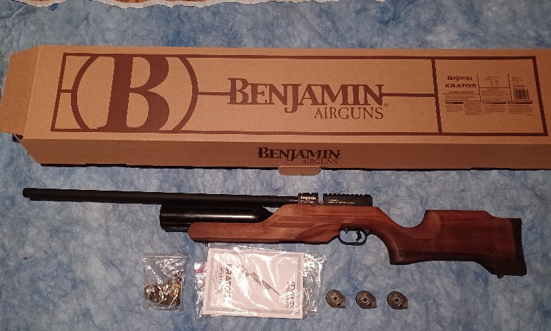

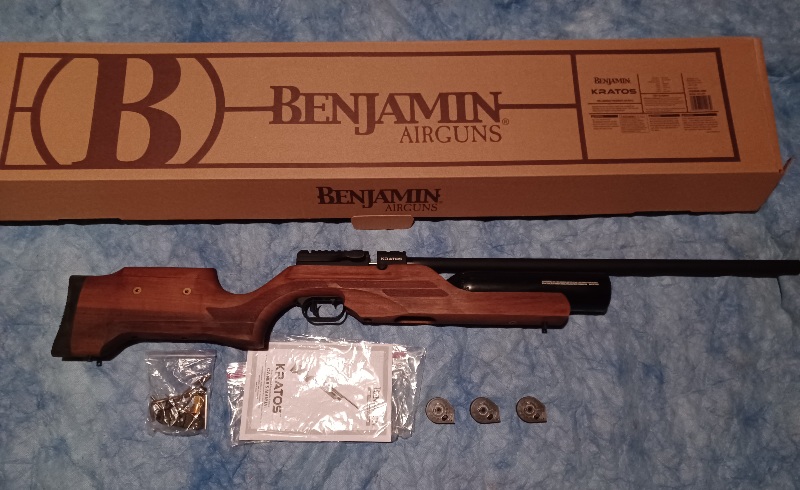

SOLD "SPF" Benjamin Kratos converted to 177 $350 shipped "SPF"
Benjamin kratos in very good condition. Changed from 25 caliber to 177 to improve shot count. Gets 120+ shots on a fill from 3000 psi down to 2000 psi. Around 950 fps with cphp pellets on half power adjuster, does 900 or so with 10.65 pellets with the power adjuster open fully.
Comes in original box with accessories and 3 14 shot magazines.
$350 shipped PAYPAL to CONUS only

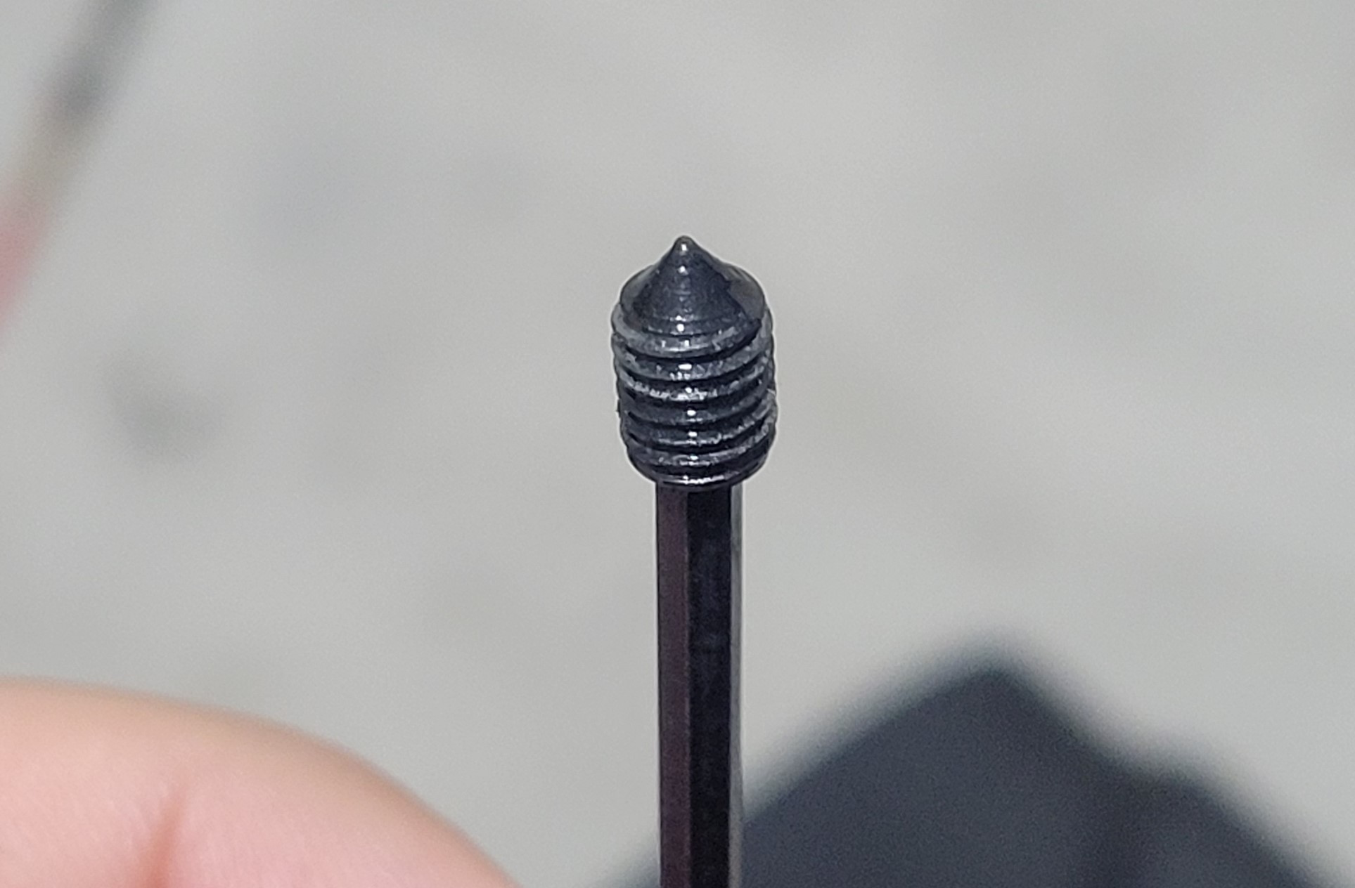

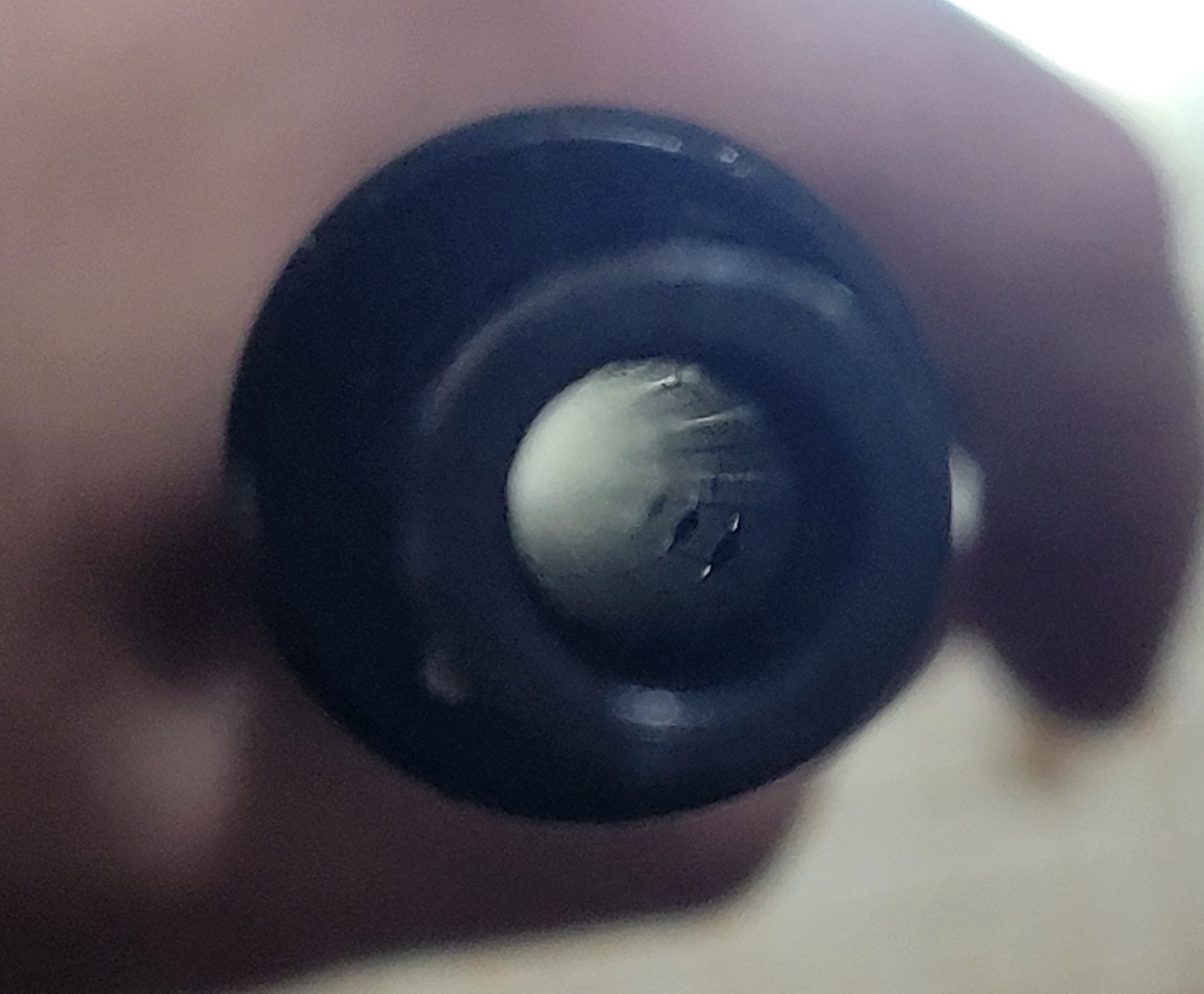

Im afriad i hurt my wildcat bt
Howdy felluhs!

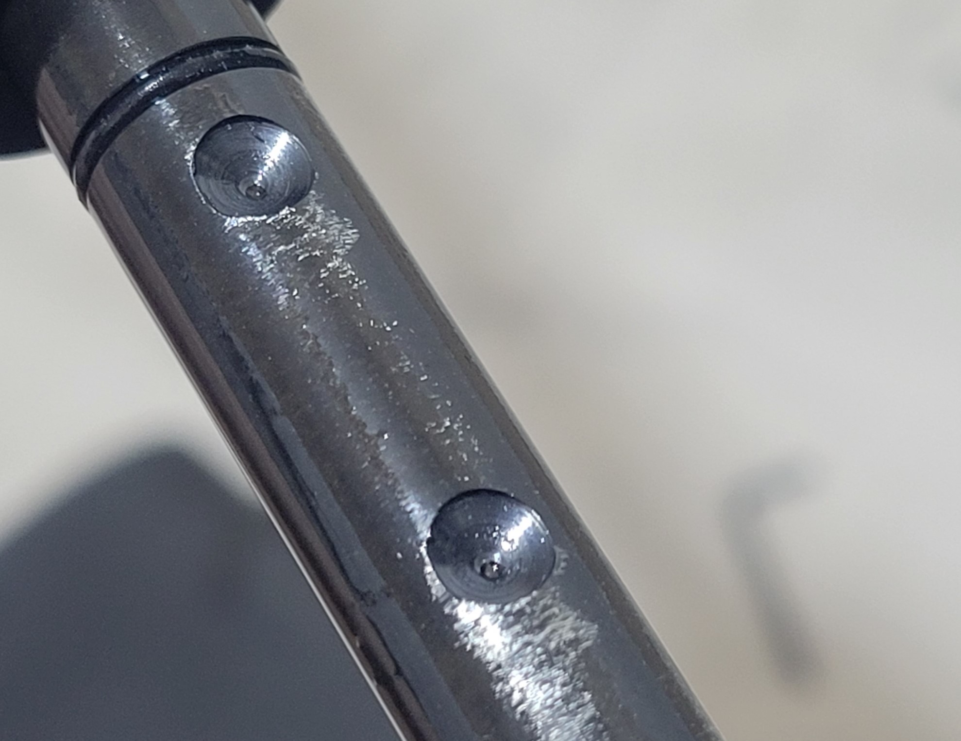

So I'm trying to learn to tune my wildcat bt by myself but I'm afraid I may have caused damage.
So I was setting my second reg pressure to 150, but was being an idiot and wasn't paying attention to my bottle pressure. So when I refilled the bottle it turns out my 2nd reg was maxed out to atleast 200 bar. I immediately shot out all the air and properly set the second reg. Do you guys think I caused any damage? My gun seems to be working OK right now. Just shooting alittle weak bit I assume that's because I haven't set my hammer tension yet. What do you guys think? I certainly won't be doing that again, lesson learned

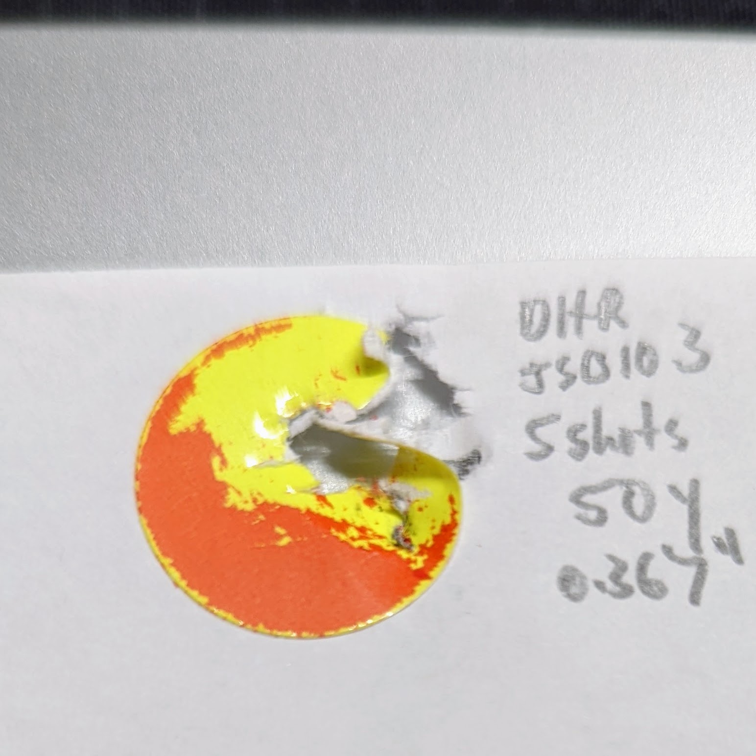

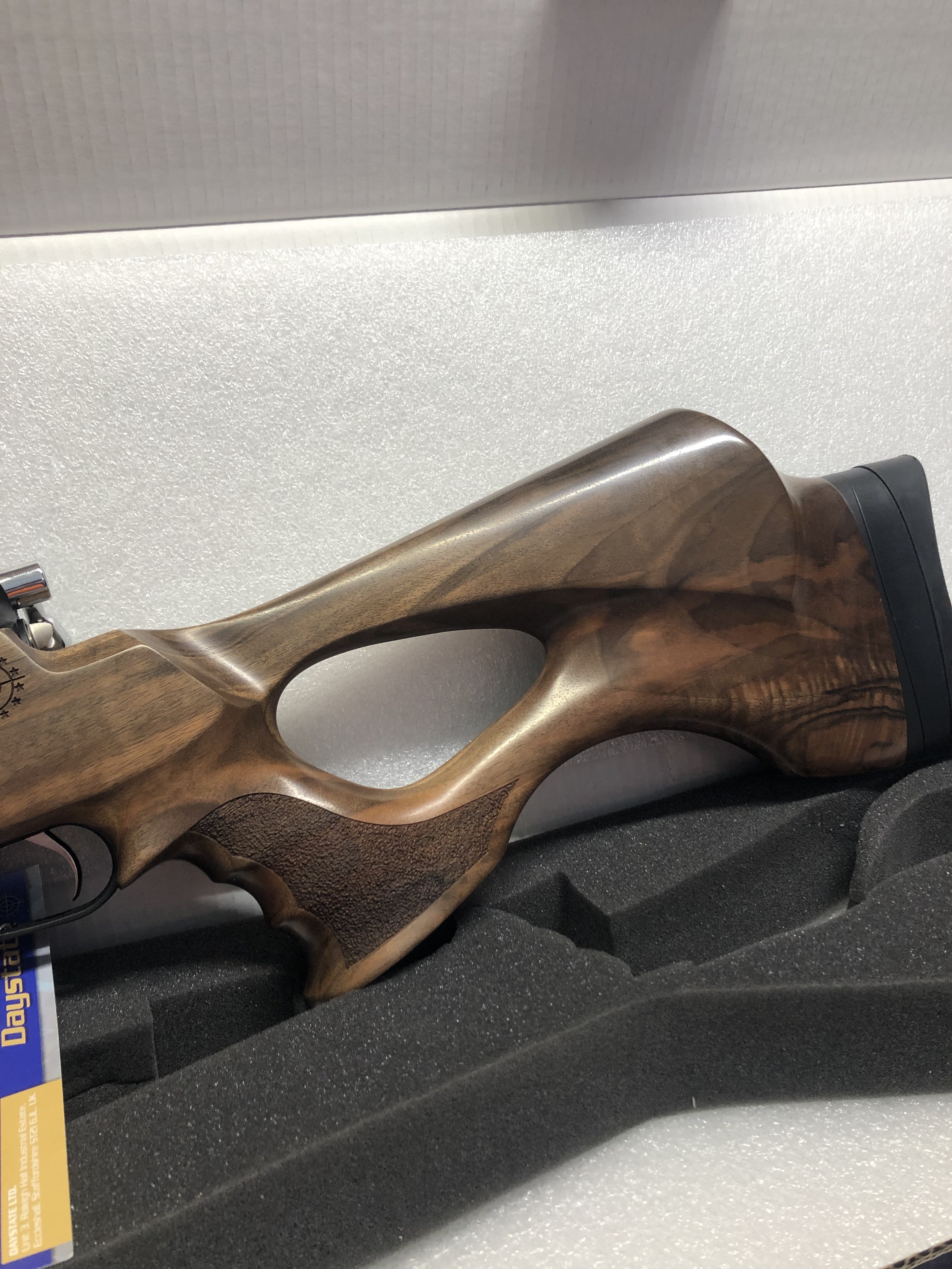

SOLD Daystate Huntsman Revere .177

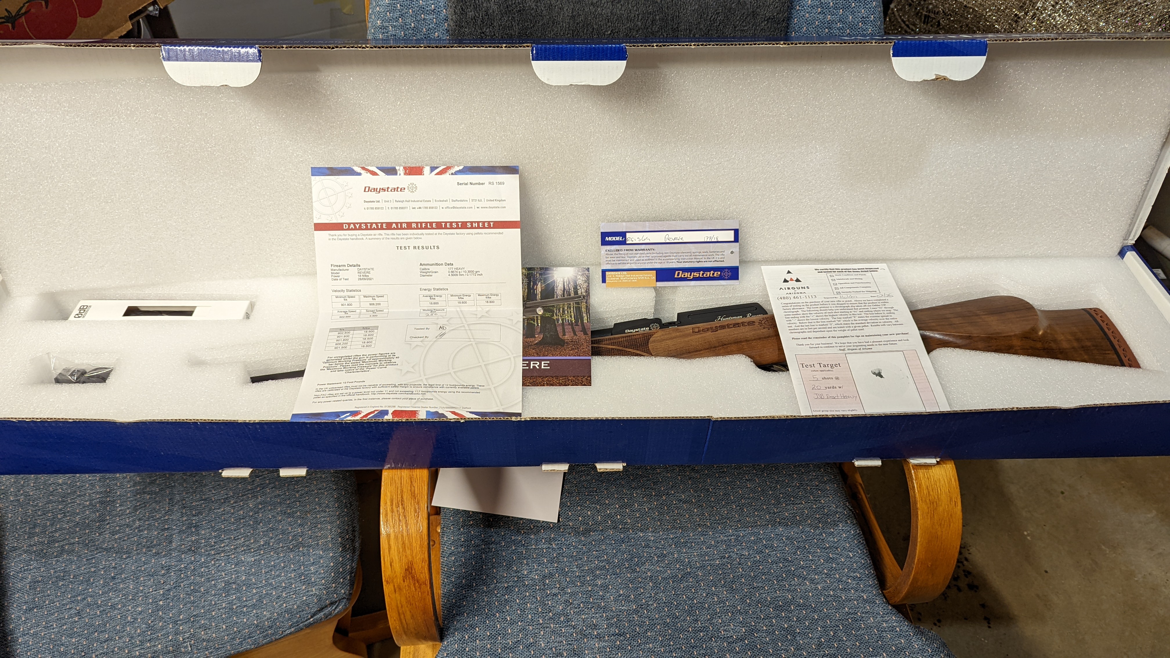

Daystate Huntsman Revere in .177, excellent condition. Very accurate, see photos below of groups shot at 50 yards indoors with JSB 10.34. Have 6 tins through it, completely reliable & no leaks. Have a bunch of close up photos of different areas I can send on request
One magazine, single shot tray, Carm single shot loader, two fill probes. Original box & all Daystate & AOA paperwork.
Scope & rings shown in pictures are not included.
$1150 shipped (CONUS only) for the rifle & accessories noted above. Not interested in trades at this time.
Paypal or USPS money order.

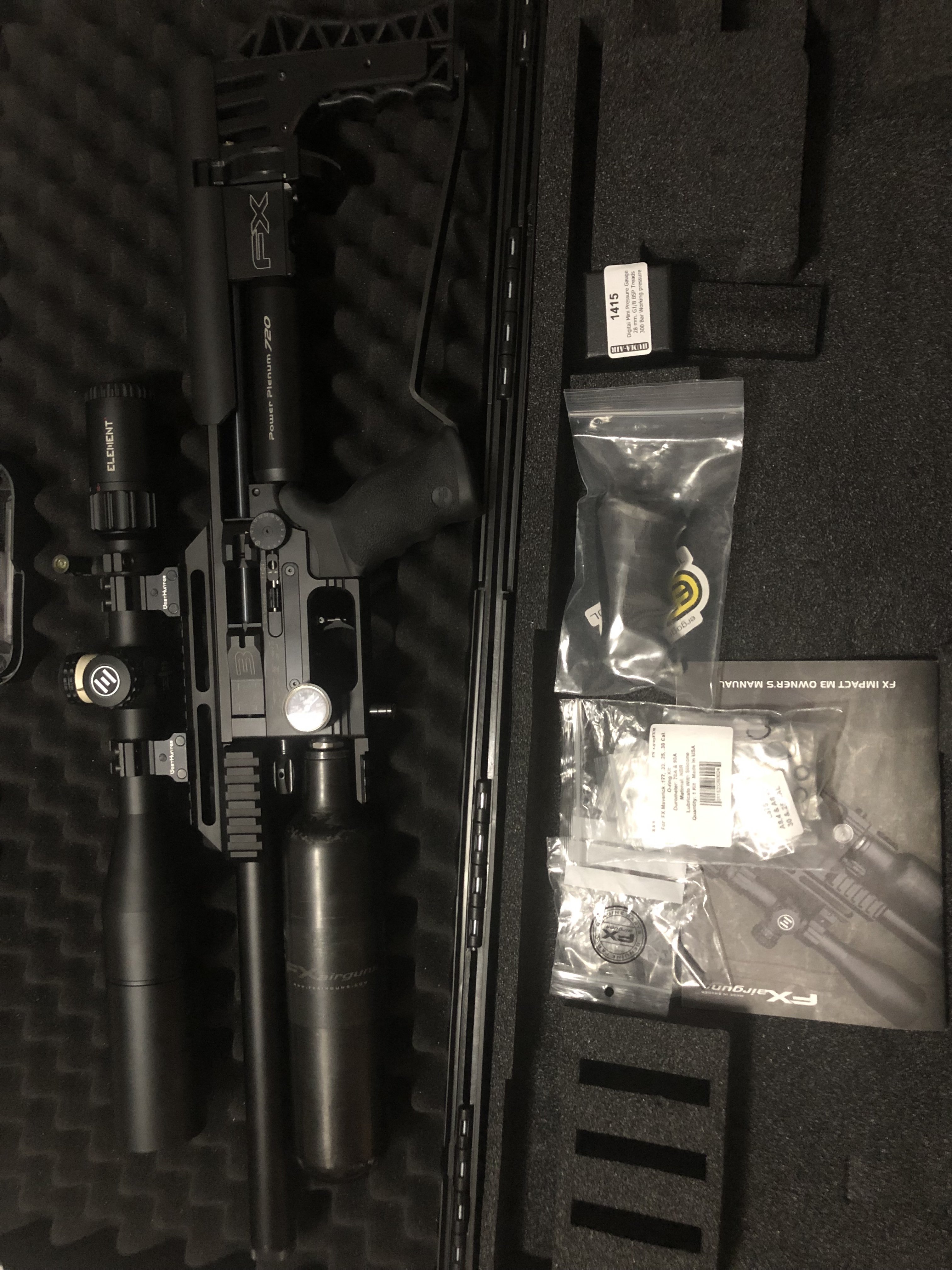

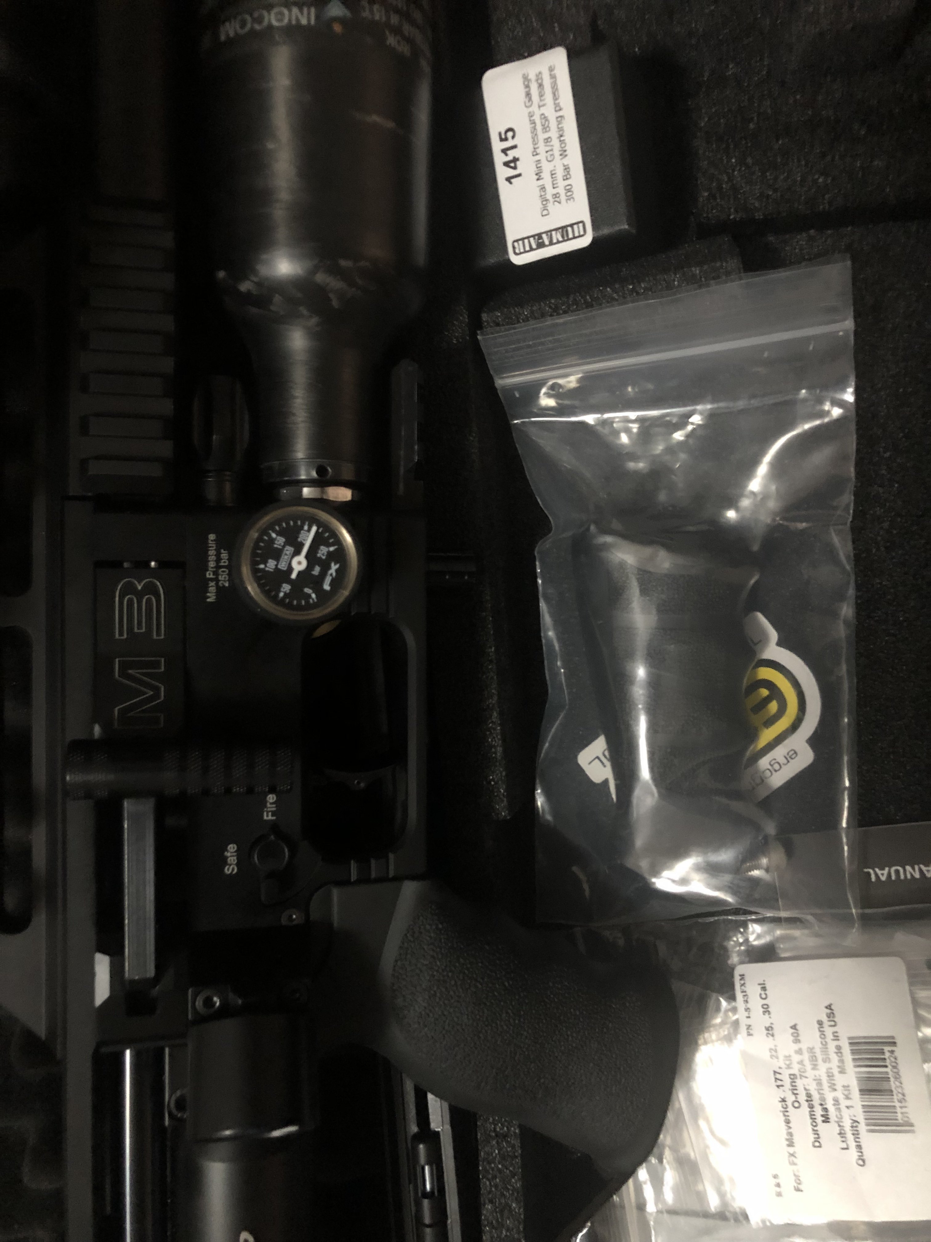

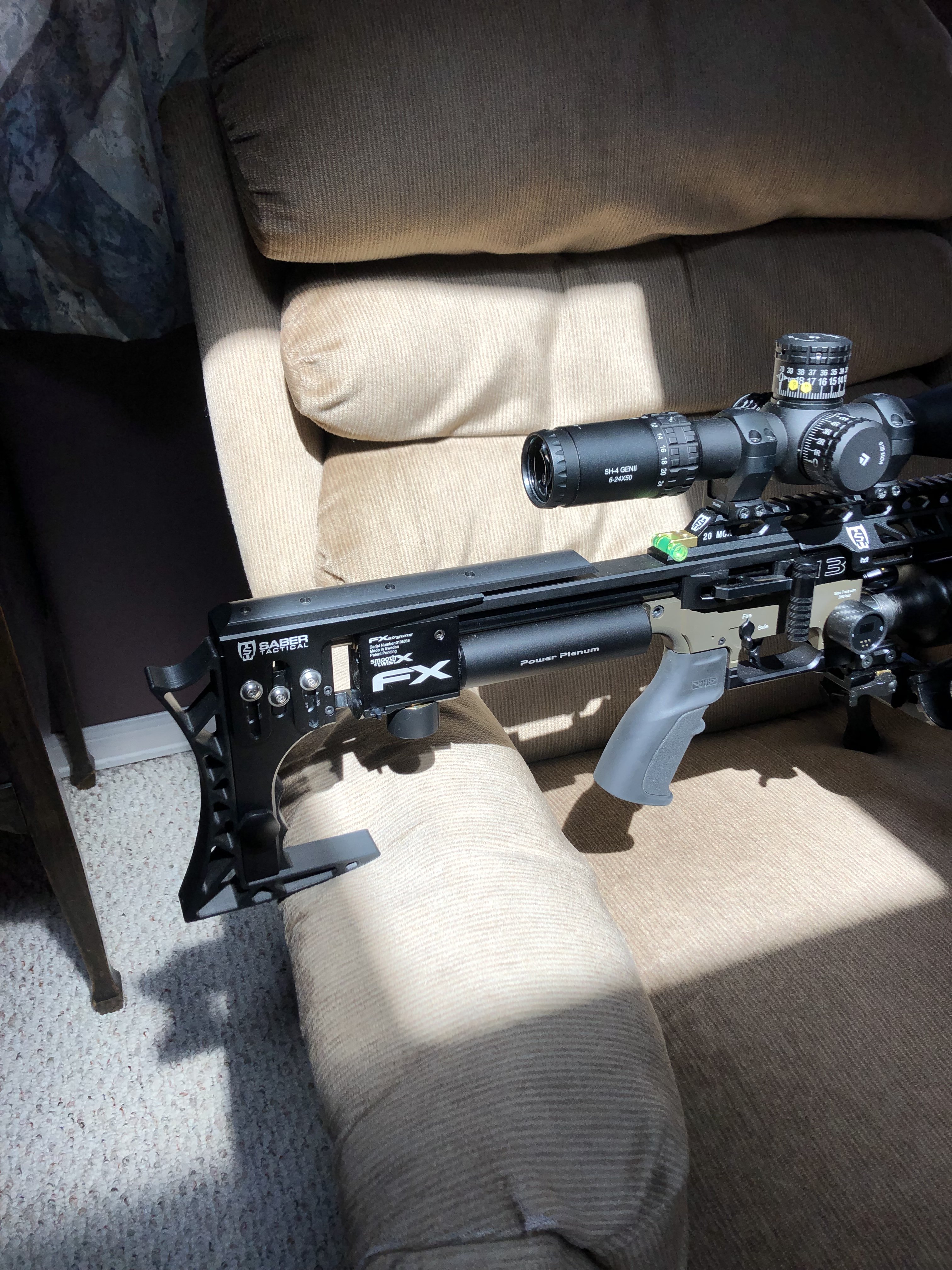

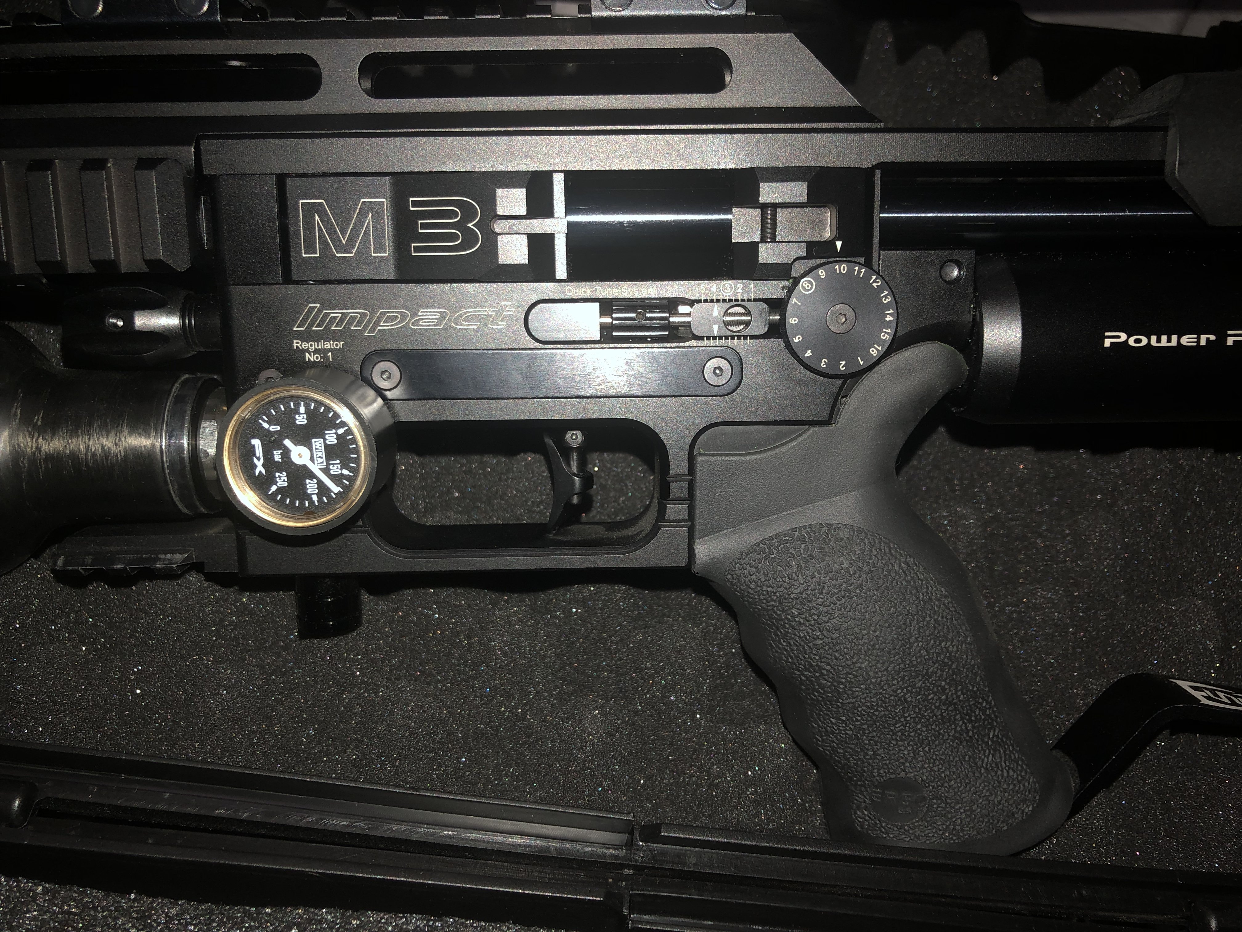

NLA fx impact m3 .22 with extras
Nice fx impact m3 .22 caliber. Has 600mm standard superior liner and 480cc bottle. Has huma digital gauge for 2nd regulator and wika gauges for the other 2. Has saber tactical cheek piece and bag rider. Has Ernest Rowe large transfer port and carbon fiber sleeve. Also has a oring kit.Comes with 1 magazine and owners manual. And ergo grip.No paperwork, I bought it from a fellow member back in February this year. Shoots amazing, I just don’t use it. Currently shooting jsb 15.9 at around 1000 fps. Sell for $2000 PayPal. I will pay the fees and the buyer will pay for shipping. Text is faster 828-455-4459

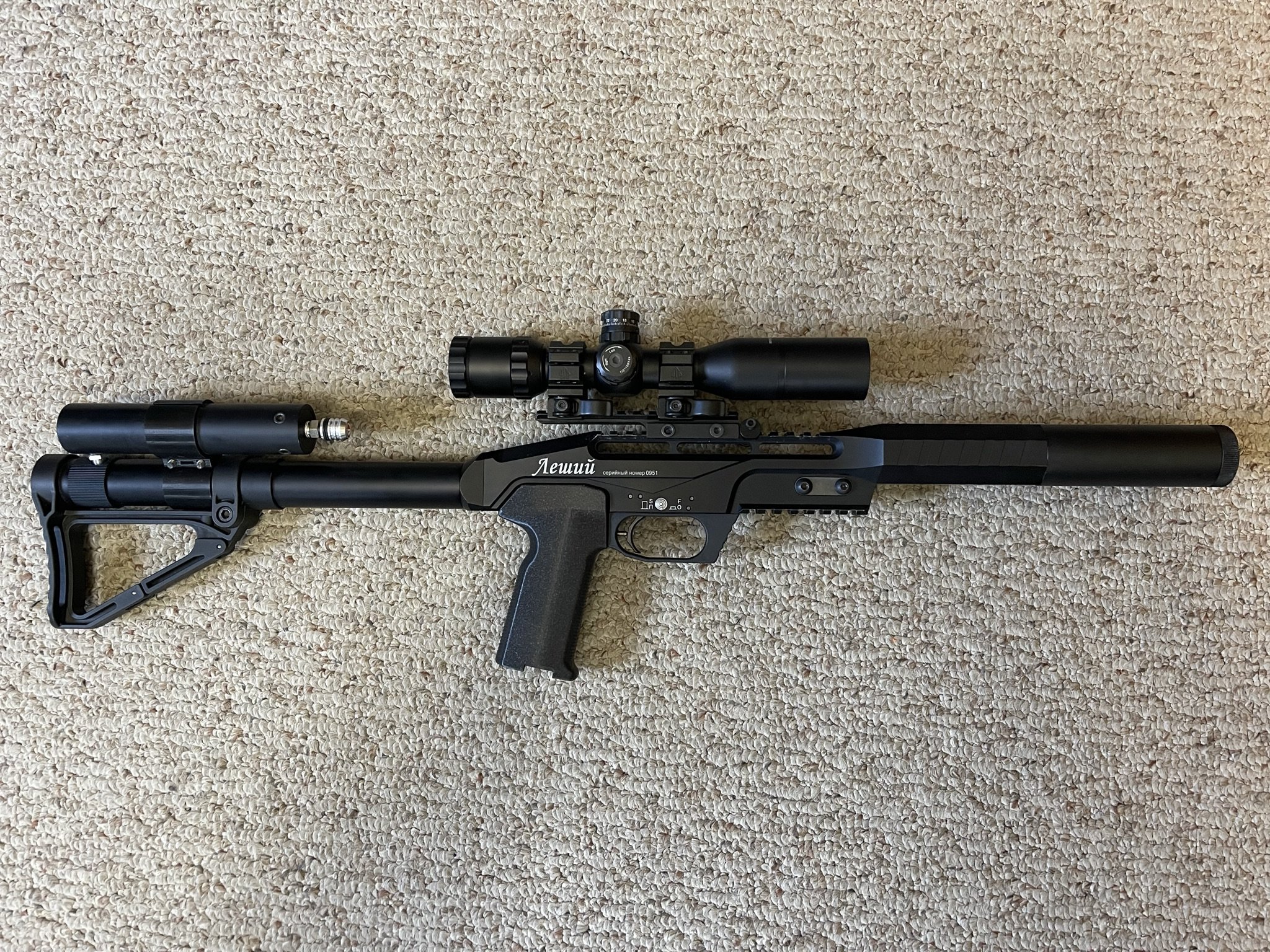

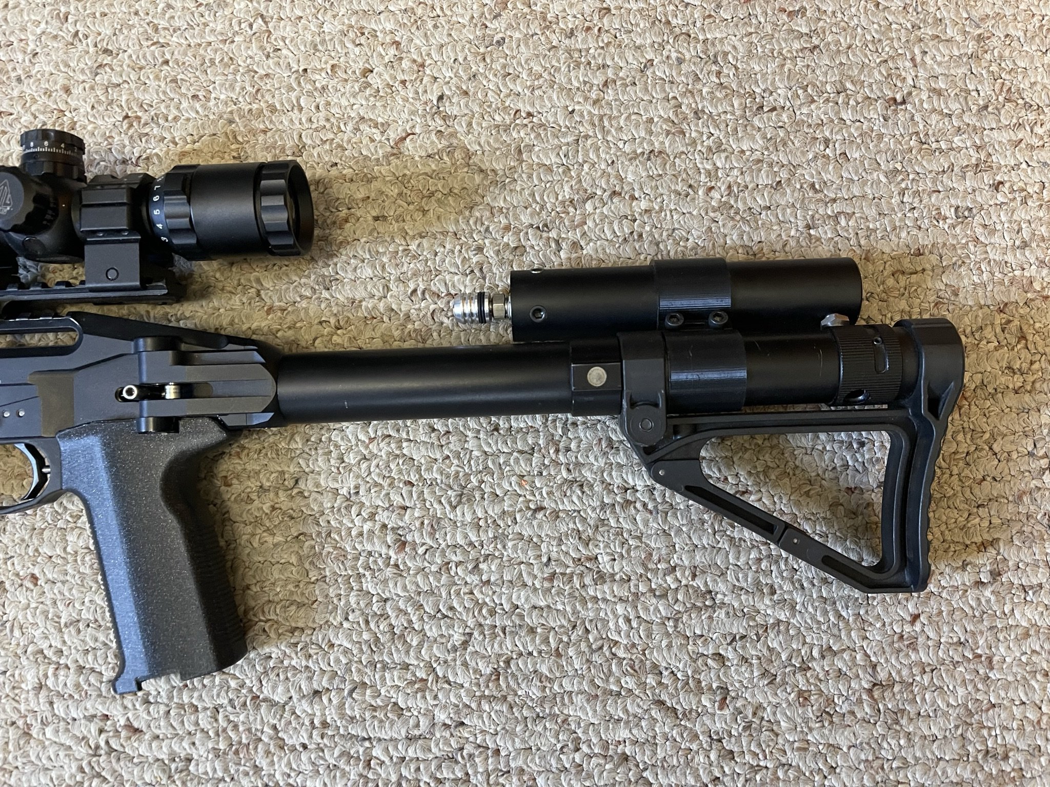

Selling my Leshiy Classic with the following:
.177 250mm, .25 250mm and .357 350mm Barrel's (Will include a small amount of .357 pellets that I have left)
Extension with original baffles, DonnyFL baffles and a 3d printed set of baffles for the .357 barrel.
Huma regulator installed and original regulator included.
Additional external air reservoir with a 3d printed bracket. Aligns great, no leaks, adds nicely to the shot count of the gun.
Includes significant about of o-rings to fix any leak, though I have not had any leaks since I've own the rifle. (see pics)
Also has a 3d Printed grip, along with an OEM walnut and synthetic grips as well.
Scope is a UTG 3-12 SWAT scope.
Leshiy was also modified to have a "two stage" trigger - works great, breaks clean.
Looking to sell to get into a rifle more appropriate for Hunter Field Target.
Asking 1450.00 - Would prefer not to split up. I'd be willing to split shipping, you cover PP fees or send FF.
I am open to a phone call to discuss any questions.
Trades: Pulsar, Wolverine, other HFT ready gun.
thanks,
eric

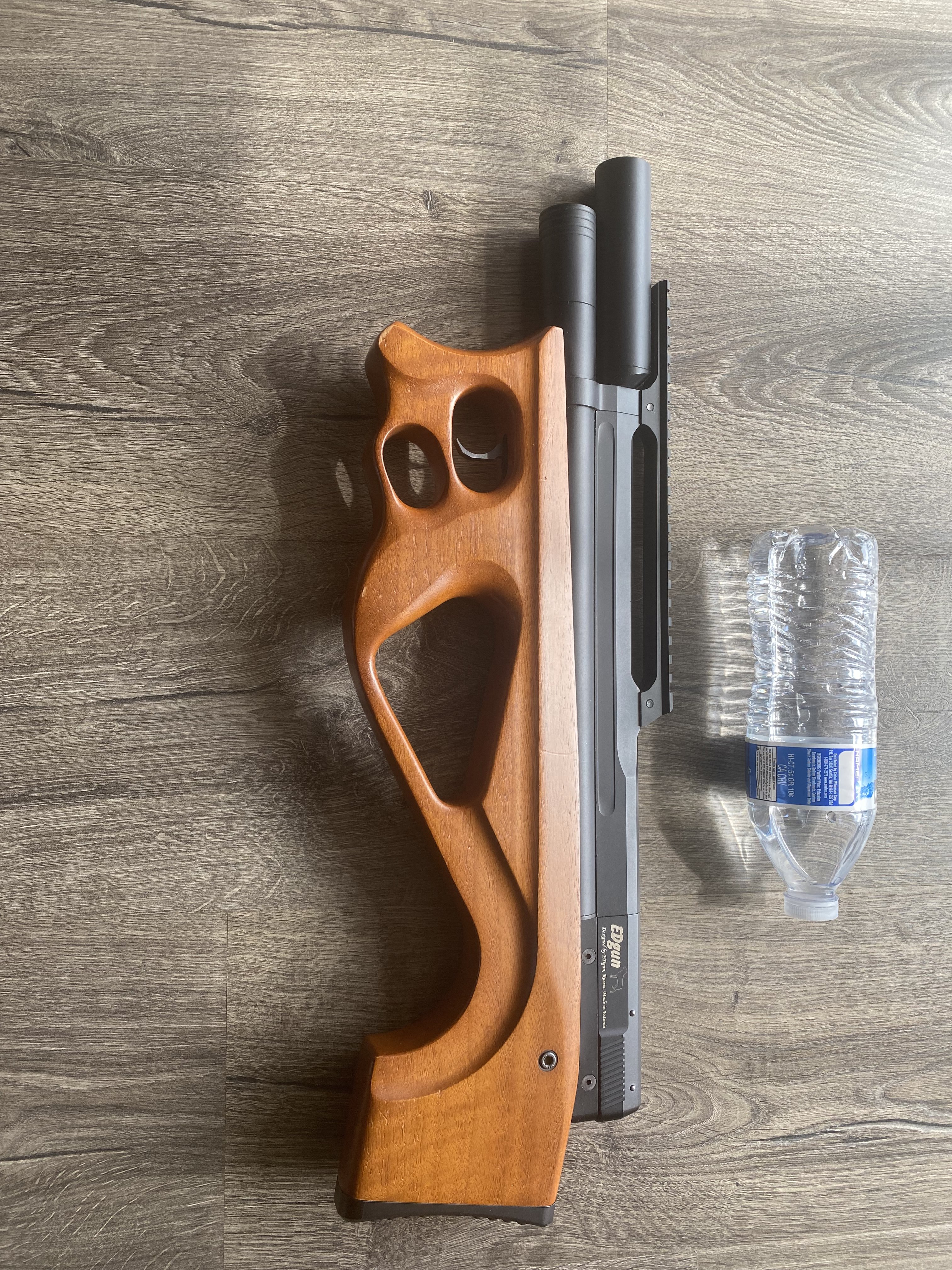

SOLD Sweet ultra compact!! Edgun lelya!

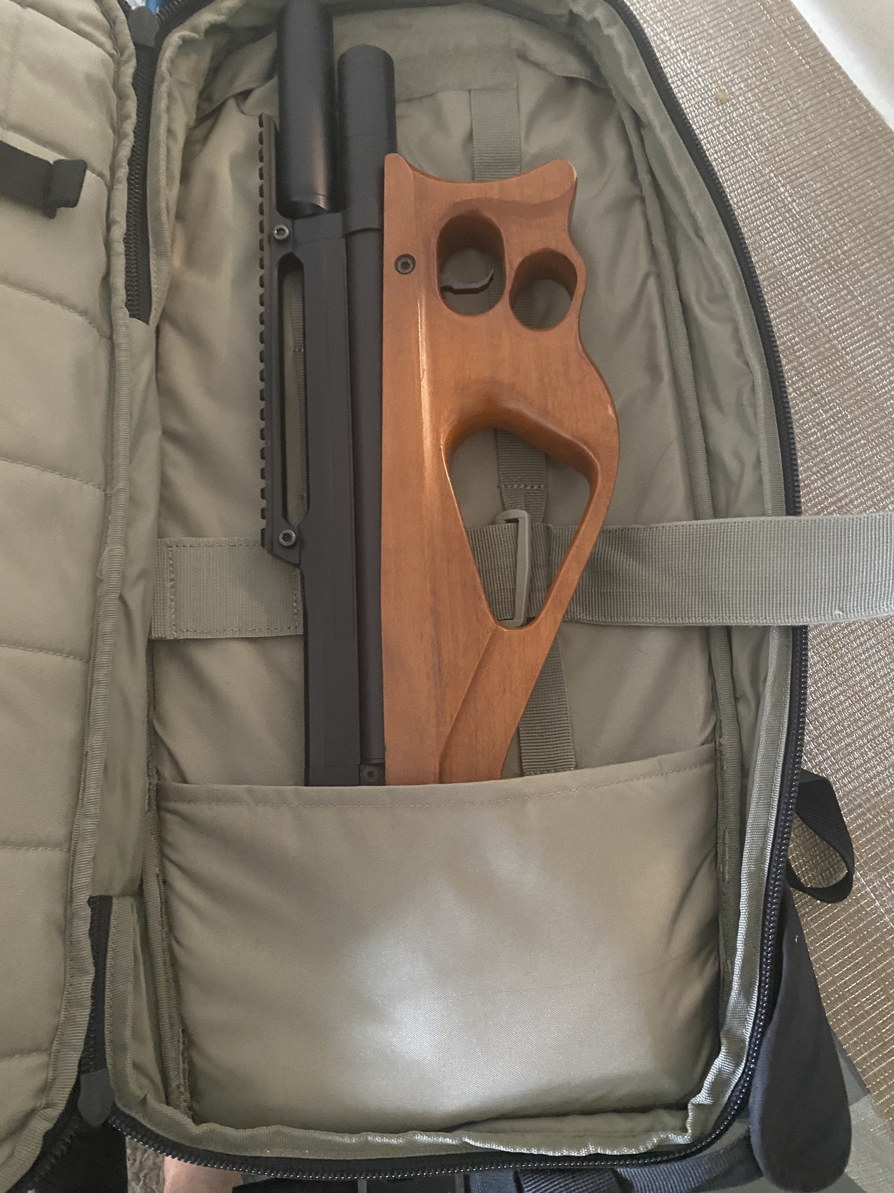

20 cal edgun lelya . Very compact . Sweet woodswalker small game hunter or super fun plinker . I put items in picture for size reference. This gun is ultra compact and very accurate and extremely lightweight. Please only serious inquiries. No tire kickers please . I recently made sales in bladeforums with 100 percent positive feedback. I ship fast as I know what it’s like to be in anticipation of a new rifle . 800 obo . Meaning I will entertain offers tht are reasonable. There’s videos of this little rifle hitting paintballs at 100 yards . Pretty unbelievable for such a small compact rifle

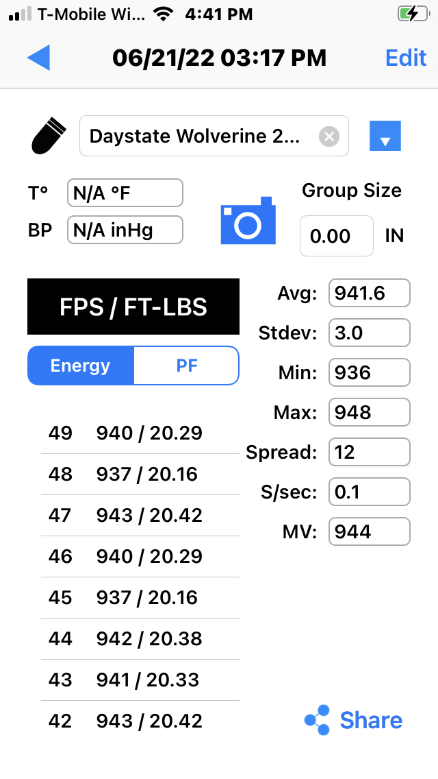

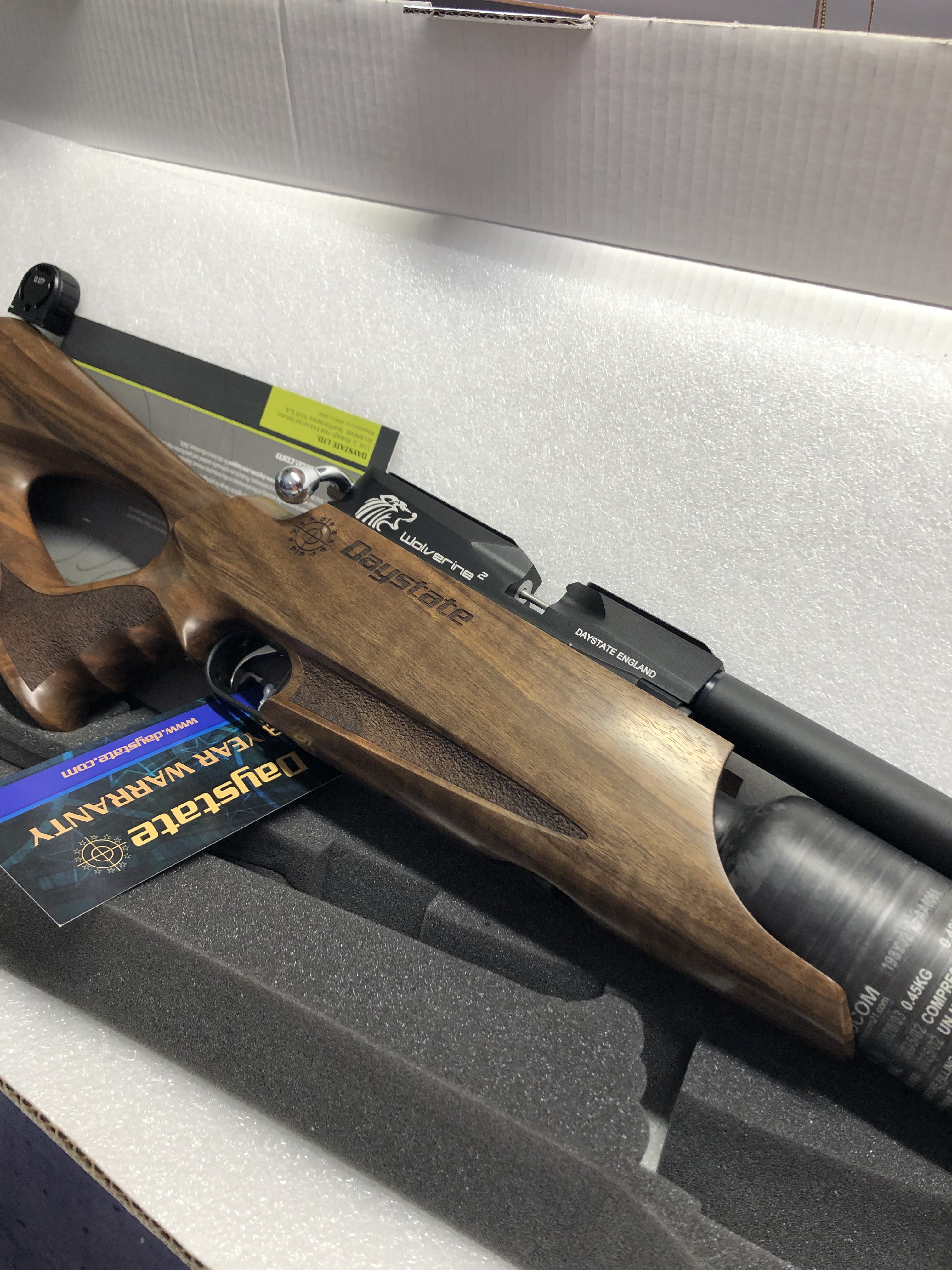

NLA LNIB TEST SHOT DAYSTATE WOLVERINE 2 HI-LITE 177

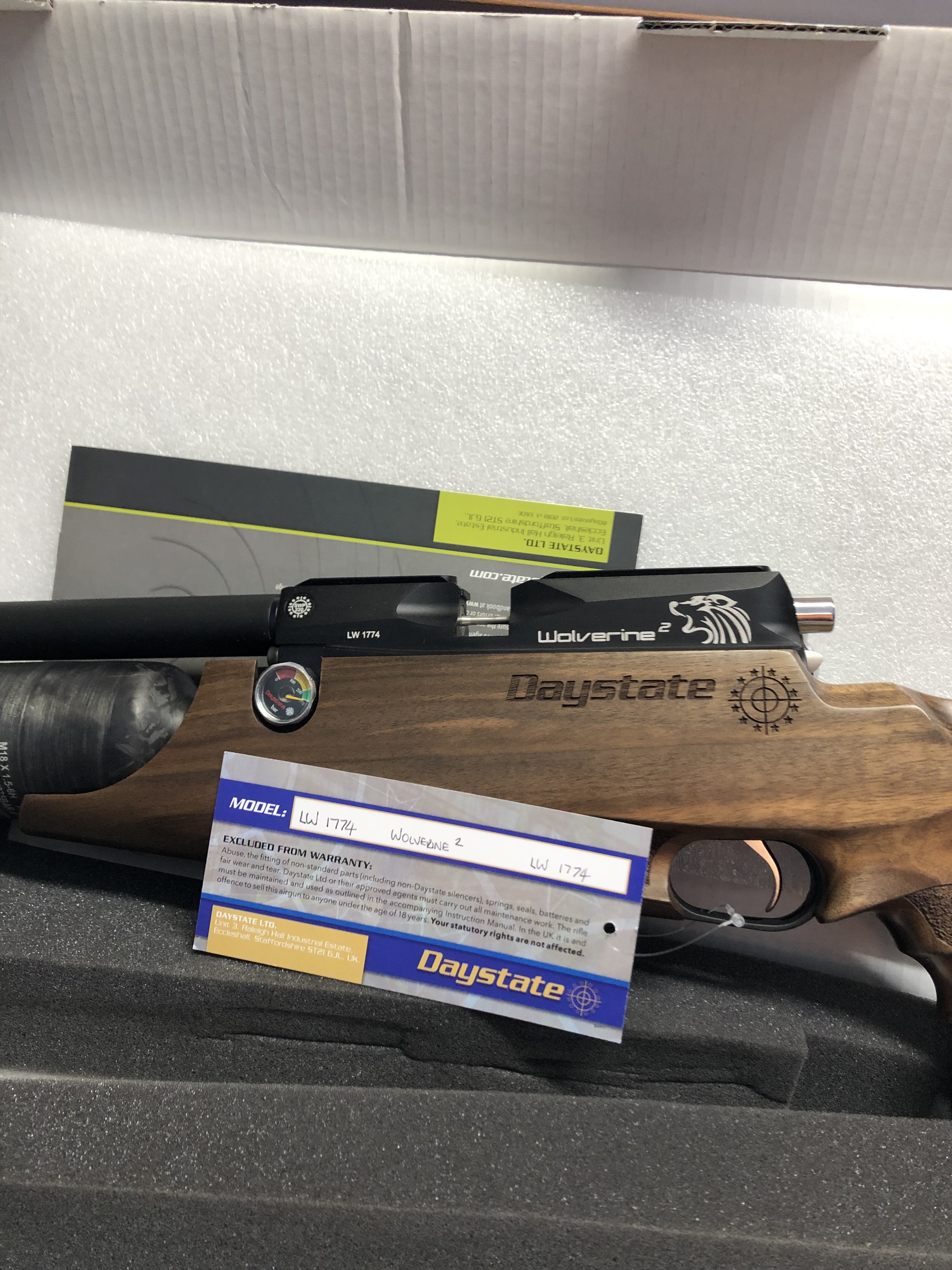

GRADE 2 WALNUT 177 DAYSTATE WOLVERINE 2 HI-LITE 177 CAL GATE MAGAZINE OF COURSE- single tray foster extension it’s all new THIS IS A UNREGULATED GUN THAT SHOOTS LIKE ITS REGULATED LASER ACCURATE WITH 10.34 AT 930 ISH 150 SHOTS THROUGH IT, WOOD IS AMAZING AND SHOOTS FANTASTIC TARGET IS 3 INCH AT 45 YARDS 50 SHOTS CANT TELL YOU A SHOT COUNT BUT ITS 110 EASY. PRICE IS FIRM AS GUN IS LIKE NEW SHOT CHRONY AND TARGETS IS ONLY TIME GUN HAD BEEN SHOT - RAIL FOR BIPOD INSTALLED ATLAS RAIL THE BOLT IS LIKE PULLING NOTHING ITS BUTTER SMOOTH DAYSTATE MAKES FINEST STUFF VERY VERY SMOOTH TRIGGERIS ID SAY 10 OUNCES 1450 SHIPPED
