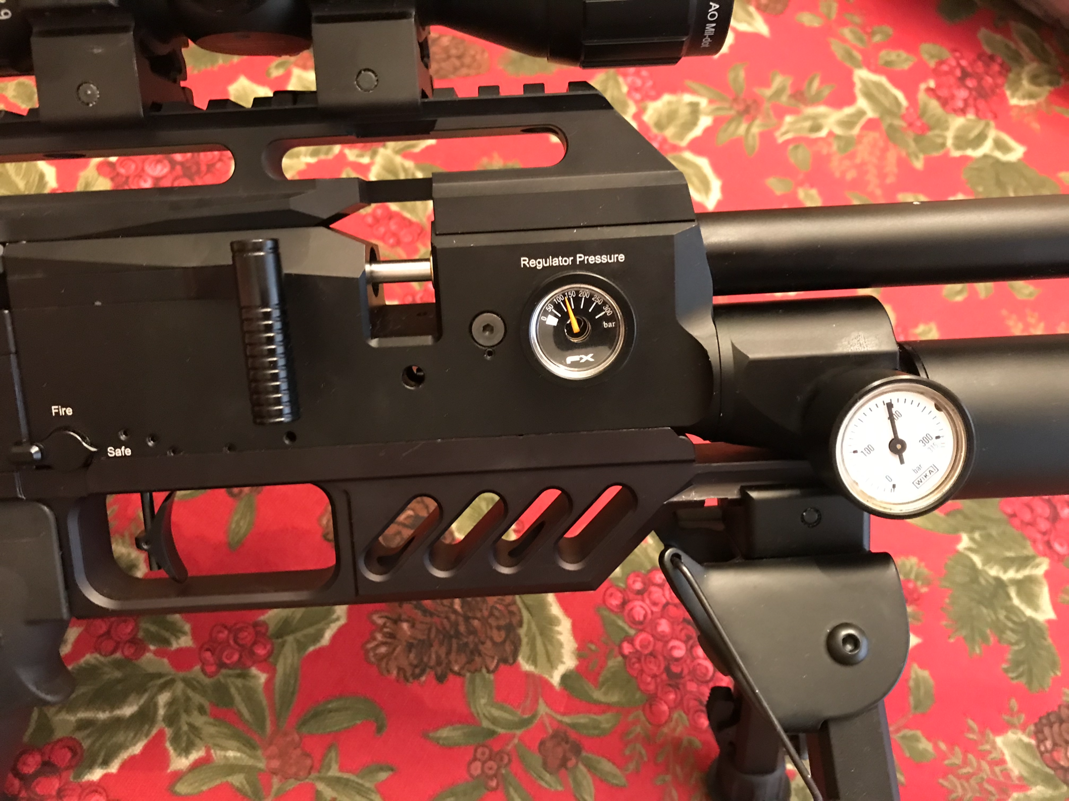

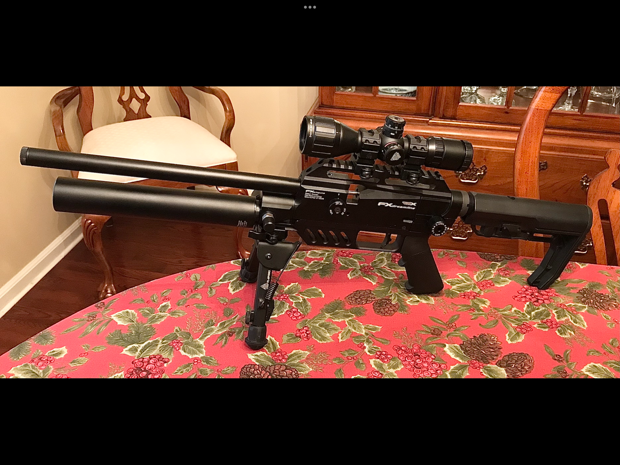

The gun had some air in it, so I put a sight on it, and loaded up the magazine with some 18.1gr. JSB Match pellets. Took four rounds to align the sight. Even though the gun is a little forward heavy, it's pretty easy to hold (free hand shooting) on target. I put two magazines through the gun with zero problems. I watched the pressure gauges...as far as I could see the damned little faced things.
It's actually fairly quiet outta the box. Another surprise. I expected with the shorter shroud, that it might be louder, not so. Both at the 890fps (Airguns of Arizona) setting and my 800fps setting. But I tried on a single section of a Huma M40 Suppressor. That made it just that much more pleasant, while keeping the overall length...short. Yes, before you ask, the regulator is set at 100bar...near as I can tell !
I connected my MagnetoSpeed V3, Chronograph, checked where the Airguns of Arizona guys had it shooting. I messed with the "speed wheel" a little then found that I could set the desired 800(ish)fps pretty easily.
While I didn't notice any "leaking", per the regulator gauge, I did notice that during both magazines that the pellet speed, "picked UP" a few fps, before settling down. It acted the same way during both magazine shooting.

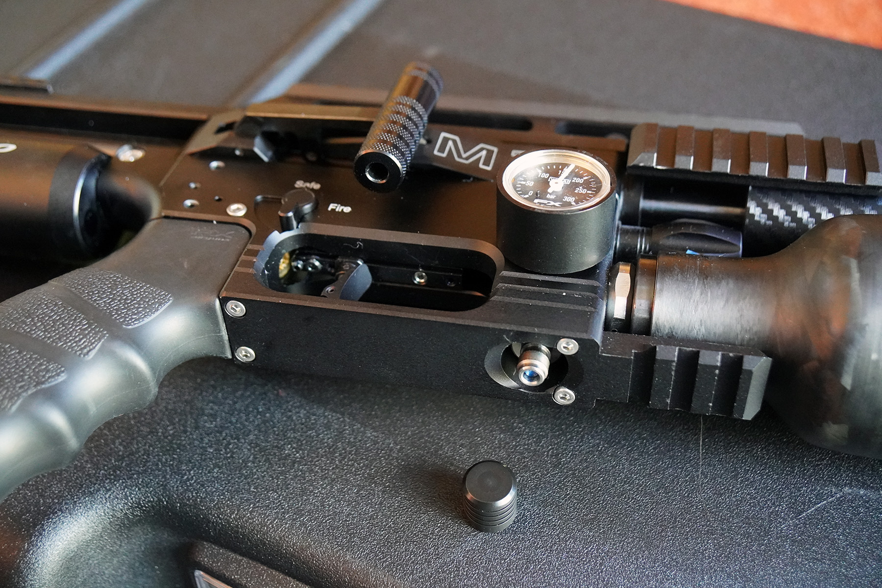

I did a little more visual on the gun. Then went in for a little trigger adjustment. Outta the box, the fist stage pull was a bit long and sort of stiff. So I adjusted the length of pull easy enough, but the spring pressure will be a bit tougher. The trigger post is, fore and aft, moveable. Unfortunately, whoever put these parts together, they put the post "over" the spring pressure adjusting set screw. No big deal, just move it back for now. Hmm, no luck. That screw turned out to be VERY tight. I'm a bit hesitant in trying too hard, as I don't want to strip the Allen head socket. I'll look for a larger Allen wrench, and try again. The wrench that came with the gun is too loose.
If you pull slowly on the trigger, it's a bit of a long pull, past the "wall", so that got adjusted too. While better, it either needs a little more adjustment.
The trigger mechanism is very strange on this gun. It seems to work, so that's all I'll say about that !

I read people exclaiming that "THIS (their new gun !) gun is built like a tank" ! Even though, I think that many of these folks have never seen a...tank ! Having "bolted" together parts makes a very weak assembly, when put under unnatural loads.. THIS...(as is the Delta Wolf) gun has all of its main parts housed in one...single piece of heavy walled material. This supports all of its guts AND most of the barrel, at least in the short version, very securely. Which DOES...make this gun, built very sturdy, and should take the accidental dropping off the tailgate of your truck, happen without any structural damage.
Again, it's nice that most all of the parts under pressure are housed in one single piece of machined material, as noted above. That ol "Aircraft Aluminum" phrase...that means ZERO if you know anything about Aircraft ! There's moving parts in the buttpad part of the stock, but...most of its main working parts are very well supported.

What else... In swapping the cocking lever over, I found the extra long, round "bar"...whatever it's name is...in the way, in its original position. So I left it standing tall, rather than being down by the trigger, after the swap.
As you might expect, the cocking action is nice and smooth, with no hard or difficult spots in the movement, even with its short lever arm.
One very nice thing...even though it's very well protected, it's got an actual barrel on it..! NOT one of those wimpy, thin walled, easy to bend pieces of tubing that another infamous brand uses, that everyone feels the need to crutch with a carbon fiber sleeve.
Another nice, modern day item, the air cylinder has a valve it it, so it can be removed without dumping all of its air pressure, as desired.
