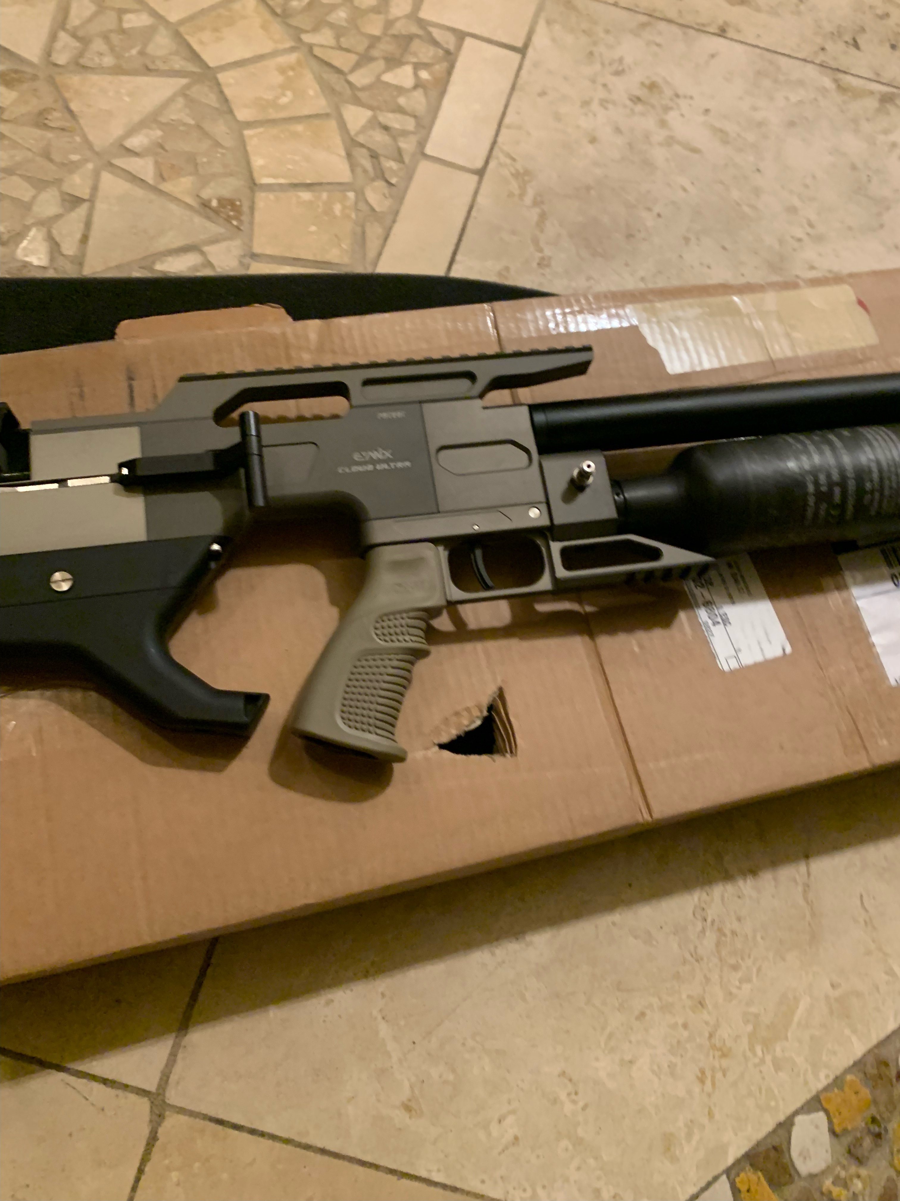

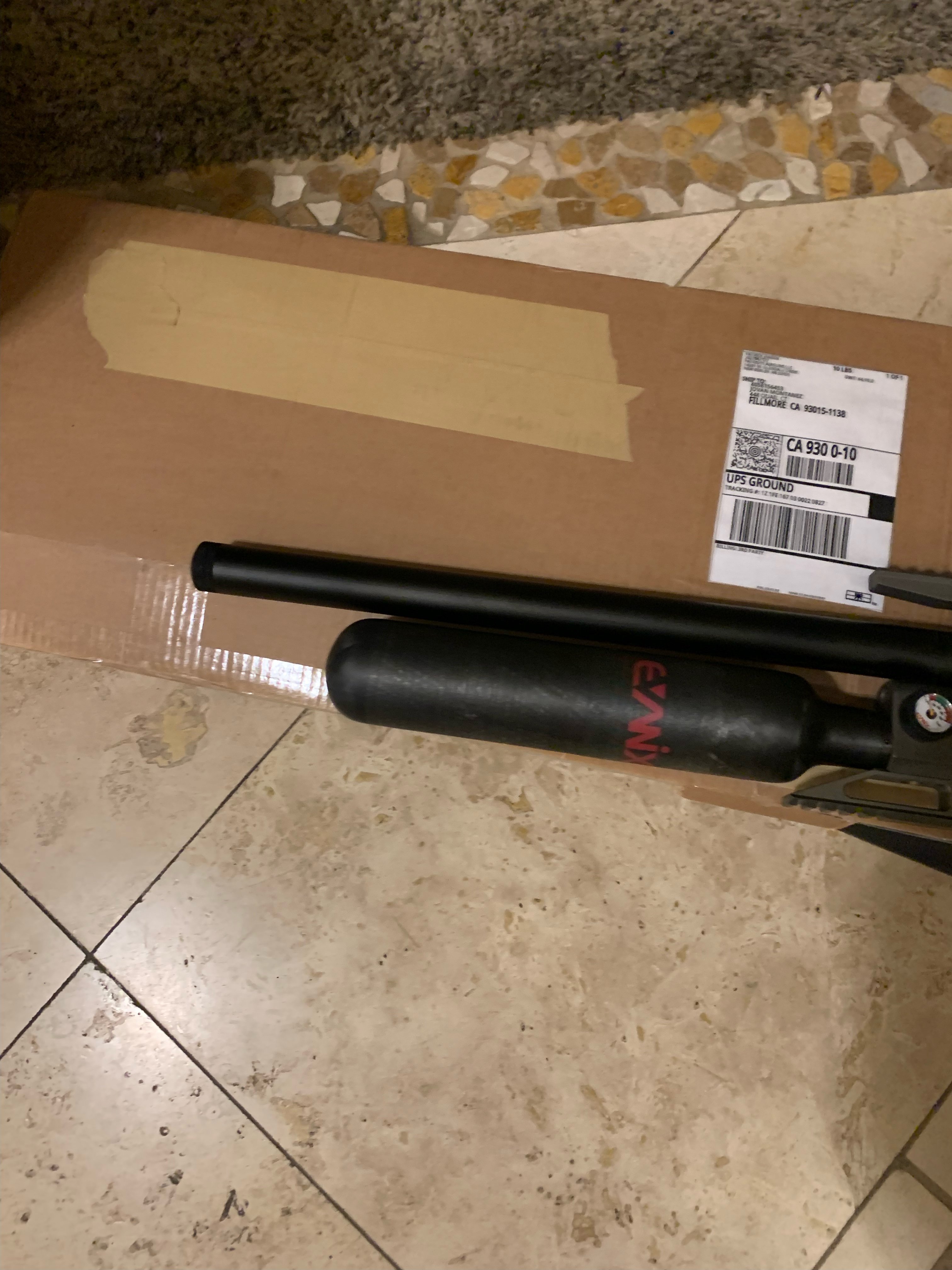

PCP Rifle  SOLD M3 700 .30 Slugger $1675 shipped.
Hey AGNners,
I have a 700mm .30 M3 I’m selling with a superior heavy liner, front reg delete, but still have front regulator in case you want to reinstall, carbon fiber liner and carbon fiber shroud.
Has a scratch on the cocking block that was there when I purchased from prior owner. See picks for details.
Rear reg is currently set at 130 and it’s shooting 50.15 JSB knockouts at 950. The thing is accurate. Also has new foam case insert.
Price is $1675 shipped CONUS. PayPal F&F. Let me know if you have any questions.
