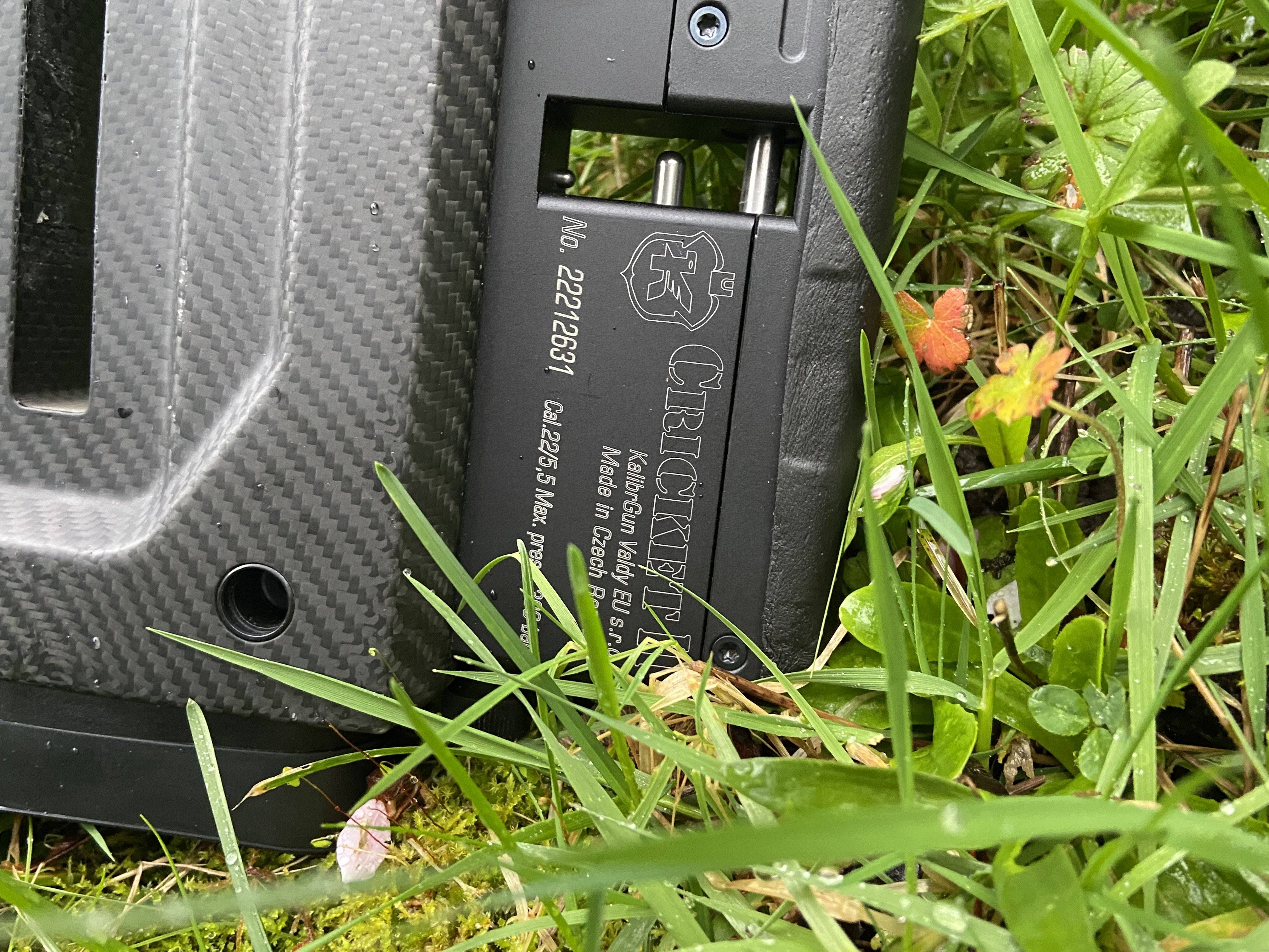

SOLD - Kalibergun Cricket II Tactical 45 Laminated Stock .22 caliber. This gun was tuned for 18.1g JSB/JTS by Derrick Wall and is a tack driver. Condition is another 9 - 10. All 3 magazines are included. The DFL Tanto moderator can be added for $100. No case included. $$$ plus exact shipping to your location.
