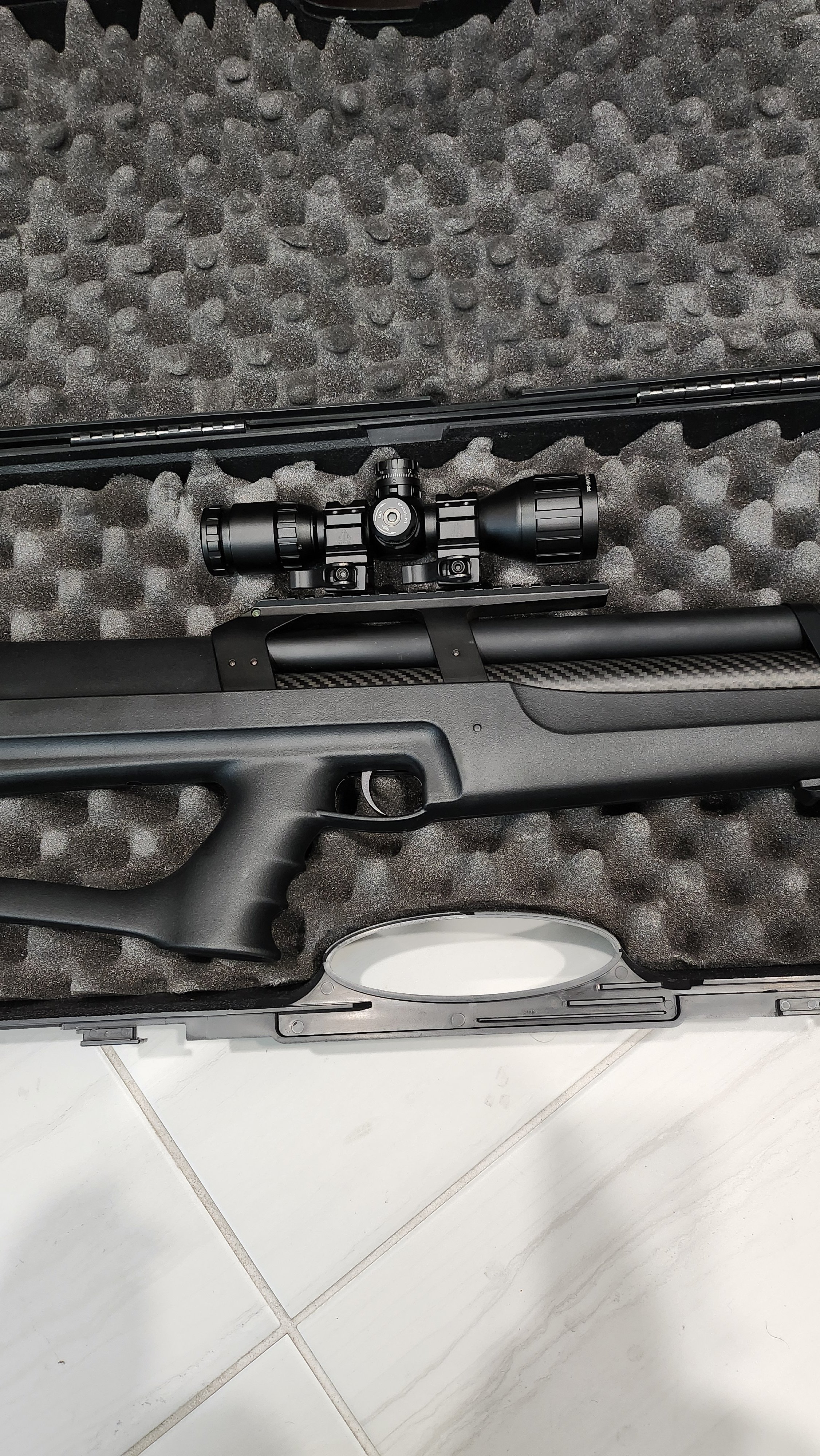

PCP Rifle  WTS FX Impact MK2
Hello everyone, today up for grabs I have an FX Impact MK2 .25 cal that is pretty much in brand new condition!
This rifle has been babied its whole life and barely used.
When not being used it is stored at working PSI so all the seals and everything are in excellent condition with absolutely 0 issues.
Comes with Atlas Bipod.
Over $2,400 into this gun.
Asking only $950+ shipping
Paypal F&F preferred.
NO "tire kickers" please!
If you have any questions feel free to reach out to me.
Thanks and take care!

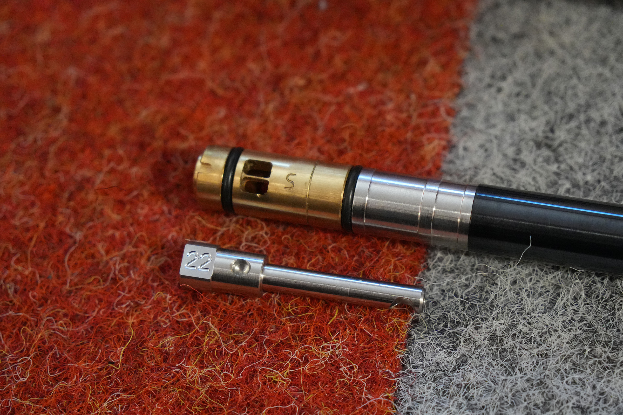

Knowing that I'd want to tinker, I included what Airforce calls their Ring Loc kit in my order. It's basically as simple as a set of transfer ports of various sizes. And yes, the tps can be swapped without degassing or even removing the bottle, very easy. $50 well spent, more on that in a minute.
I've read all about spin loc versus not spin loc tanks with these Airforce guns, and finally learned what that means. The spin loc is a little ring that rotates in the rear of the gun to allow bottle attachment without having to spin the bottle onto fixed threads in the gun frame. Airforce includes a wrench specifically for this. I understand early guns didn't have gauges or fill ports (cuz they would have hit the frame when threaded on) but the current production guns DO have gauges and fill ports (foster), because of the spin loc system.
For some of the negatives.....there are some plastic parts that I'd really have preferred to have be metal. Namely the power wheel, and the collar next to it, as well as the sliding breech cover. The biggest negative ive encountered so far was that the auto-safety quit functioning around shot 50. And it created a somewhat dangerous situation. I was loaded and cocked and the safety would not slide forward to disengage to allow me to fire the shot. And the gun can also not be de-cocked when the safety is on. So I removed the air bottle (spin Loc is pretty sweet) and headed back to the gunroom to tear down the trigger.
The trigger components were finished better than I expected, no deep machining marks like I've seen on sears in much more expensive airguns. It took me a lot longer than it should have to get the gun shootable, as I kept arriving at the same point with each rebuild, non-functional safety, which means non-functional gun with how it's designed. I finally decided to just omit the auto-safety and was back to shooting within 10 minutes. I was rewarded with a less frustrating experience, since the auto-safety was annoying even when it was functional for those first few shots, but also a much better feeling trigger without those auto-safety components in there.
Before even taking a shot I concluded that the transfer port that came in the gun was MUCH too big for a .20. The sizes included in the ring loc are: .232, .166, .145, .123 and an .070. Airforce says the 0.07 is meant to be customized to a preferred size, but I decided to shoot with it as-is. 0.166 is what came installed in the gun.
Being unregulated, we're hunting for the middle of the bell curve of fps, and that seemed to be mostly 2400-1900, depending on hammer tension. So most of these fps ranges were what the gun produces around 2000-2100psi.
With the 0.070 transfer port, and the .20/13.73, I saw 590fps with no hammer spring preload dialed in, and 680 with max hammer spring preload. So a range of about 10.5-14fpe. Gun was nearly silent here, just a click.
With the 0.123 transfer port, I was seeing 980fps with the .20/13.73 with no hammer spring preload dialed in, and up to 960fos with the .20/18.9 with max hammer spring preload. So a range of about 29-39fpe.
With the 0.145 transfer port I was too fast for either JSB pellet, and was hitting 1024fps with what I'm calling 10/10 on the power wheel, with the .20/18.9 NSA. So about 44fpe.
(10/10 on the power wheel is referencing 10 on both the horizontal and vertical scale. It goes up to I think 12 on the horizontal scale. The horizontal seems more of a macro adjustment, and the vertical scale a micro adjustment. So with the 0.145 tp, there'd be even more than 44fpe available from the .20/18.9).
I didn't even try the 0.166 or 0.232 and don't think I'll need to with the .20 barrel.

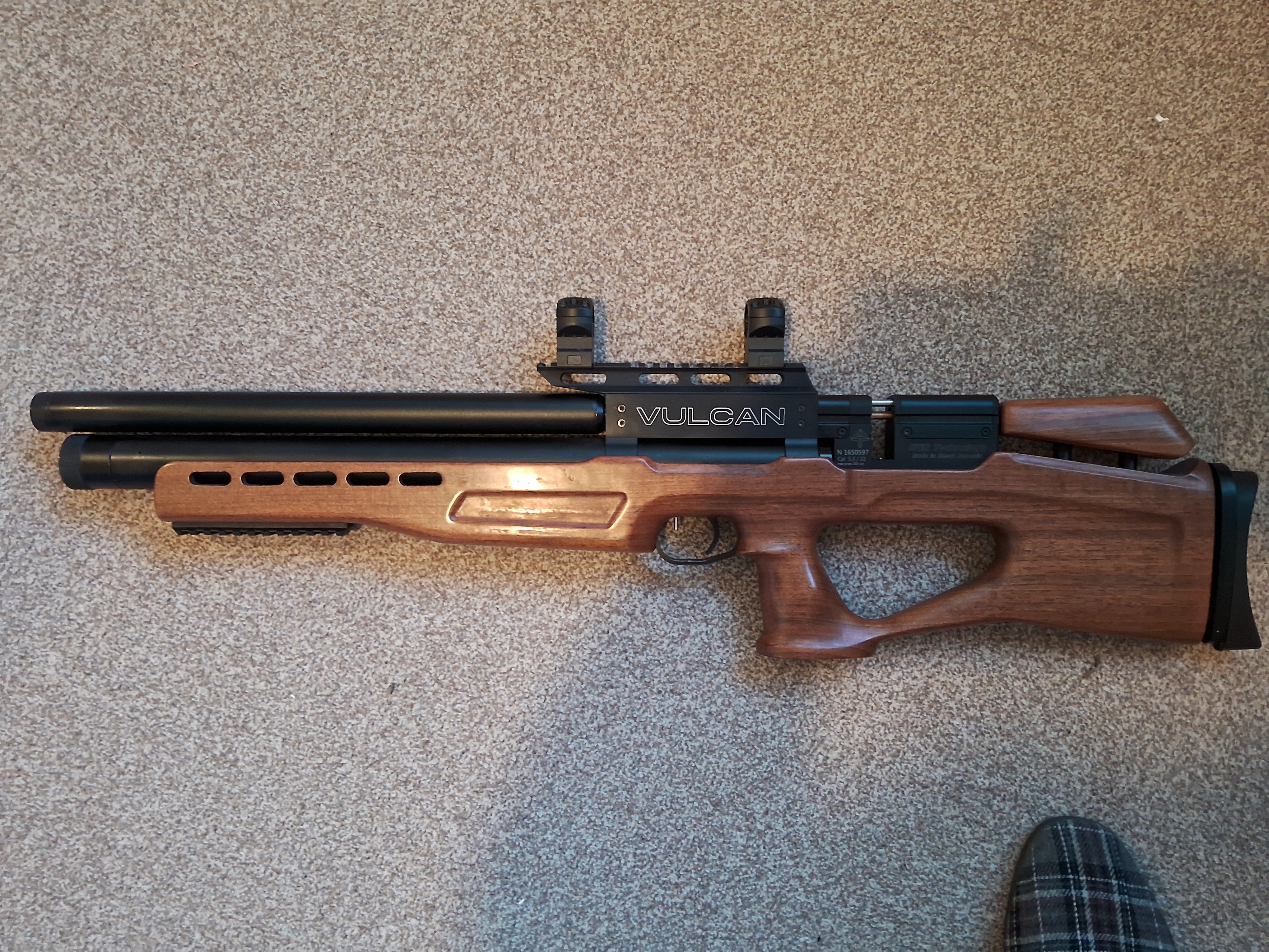

Airgun Technologies  Vulcan 3 700 .25 vs.... Any other?
Being retired I had the time for making the following exercise:
Which of my PCP's are able to have killing power at diverse distance and accuracy to be reliable.
A .30 Cal Vulcan 3 HP should have more killing power at 200 yards.... Doubtless, but would be to much for must of what I hunt frequently.
Non of my other PCP' have the accuracy nor the power at 200 yards that the Vulcan 3 700 mm .25 Cal has.
To shoot closer than 130 yards there are MANY rifles that could be better, yes...... BUT ....
What is the rational to choose a more limited rifle over a better performer ???
Many would say that not all are interested in shooting so far.... And that is truth.... BUT...
Why choosing a less capable product for the same price ???

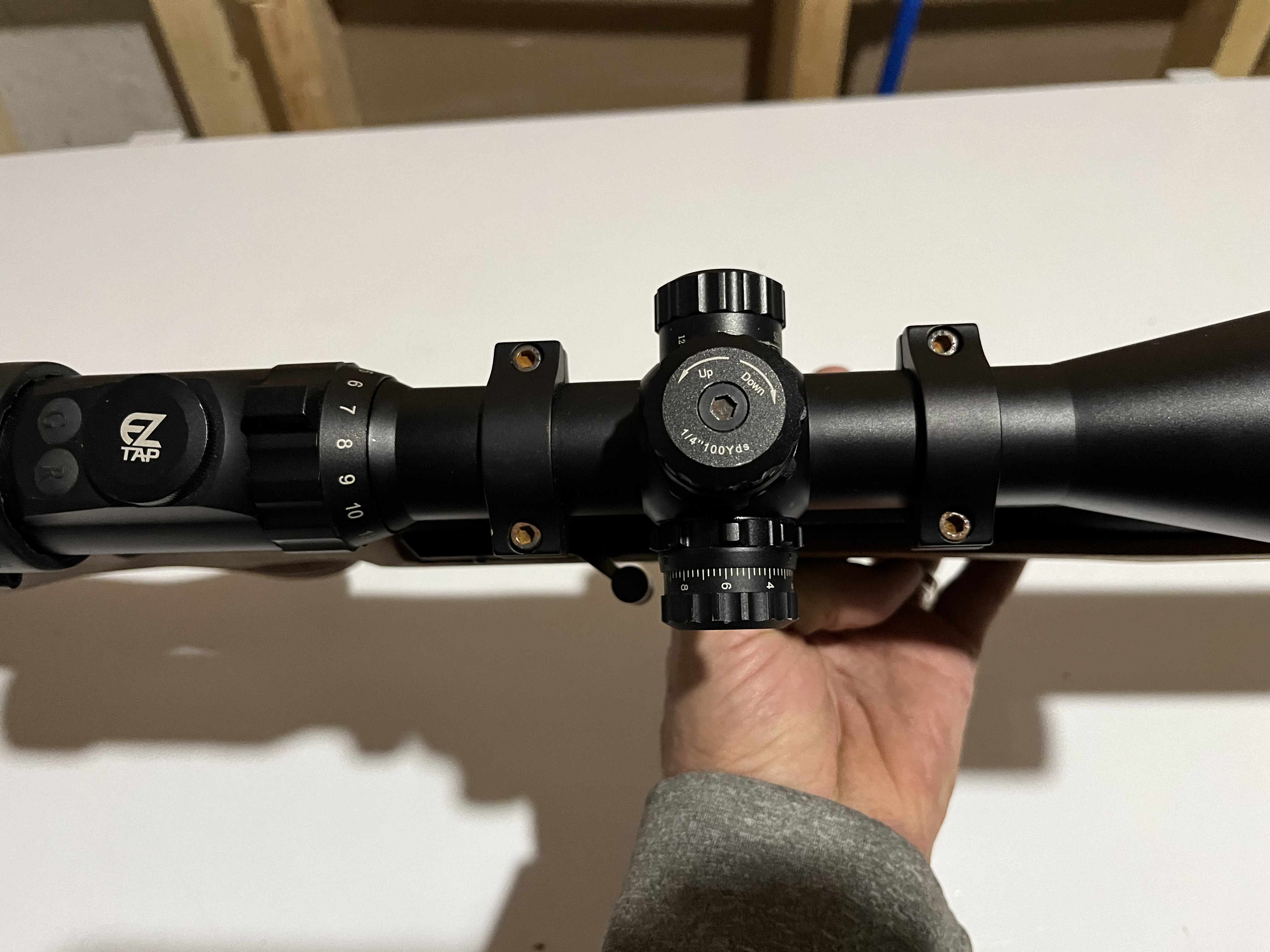

Is my scope broken?
When trying to change my POI upwards, the elevation turret clicks, but nothing happens - if anything the POI goes down.
Looking through the scope when making the adjustments, I can see the crosshairs move up and down in the lower part of it's adjustment, but then gets to the point where it is clicking, but no longer moving the cross hairs.
It's a 57 yard shot, so that should fall under the normal adjustment range of a scope, right?
