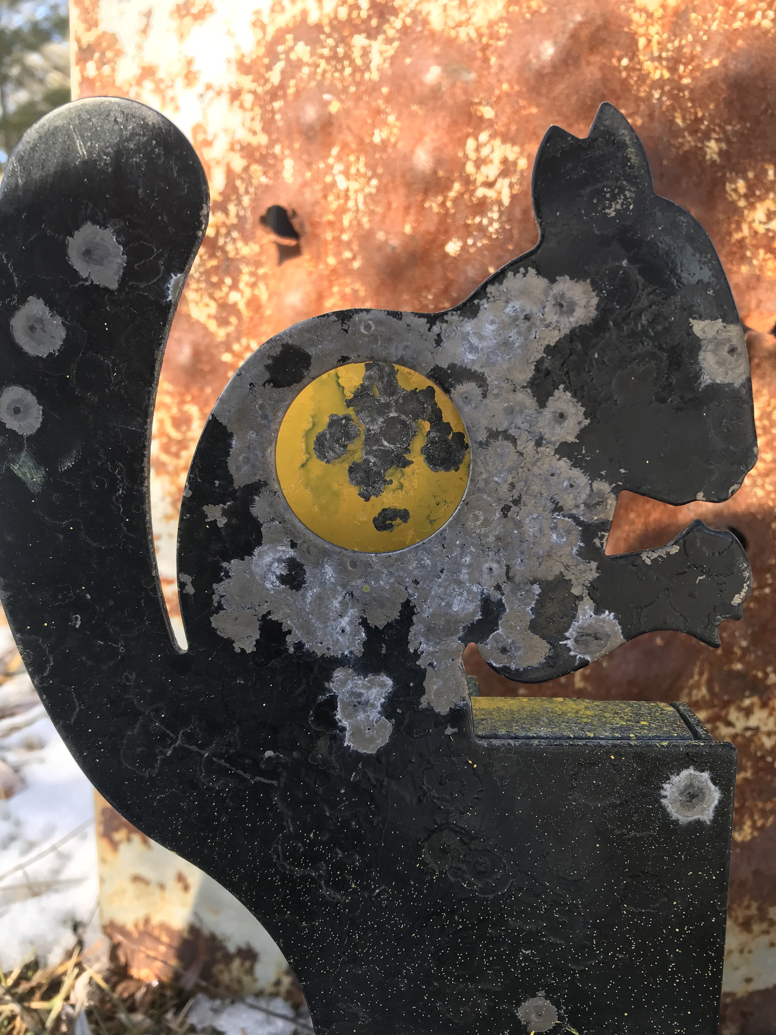

Targets  SOLD Cat’s Meow Field Target for sale
I am selling a new Cat’s Meow field target. Set for up to 20 fpe. It comes with 2) reducers of your size choice.
It is in MHO the best target on the market. Price is $130 plus shipping. I can make other targets of your choice of style. Any questions please message me.
