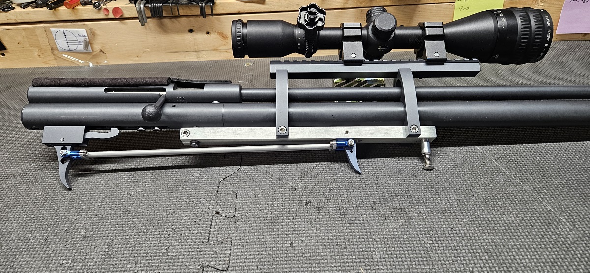

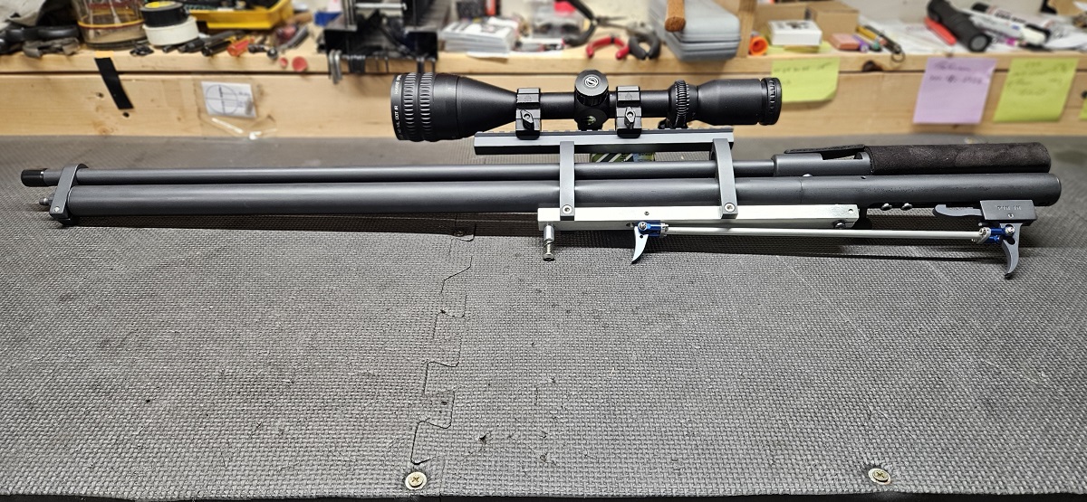

PCP Rifle  SOLD PCP rifles
Can ship now! My boxes came in finally came in, Selling off more unused items due to recent brain cancer diagnosis.
1.I have an Aea challenger pro in .25 with a custom tank cover with rails and foregrip, barrel band and DonnyFL sumo with an extra chamber, muzzle break and air stripper, $600 shipped, airtight
0
2.hatsan bull boss wood in .22(unfired) with an QE barrel adapter and buckrail moderator, $300 shipped, brand new never fired (SPF)
NO optics or bipods Included....
The aea is like new and the bull boss is unfired. I tried the the airgun thing and didn't like it. I'm in NE OH about 40 mins from the PA line, Open to offers message me for more pics. X posted on multiple sites

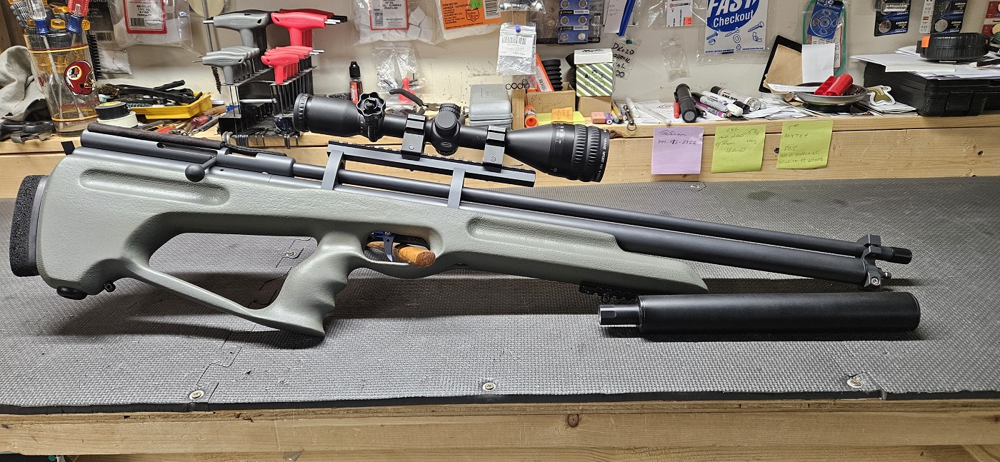

PCP Rifle  SOLD PCP air rifles
1.I have an Aea challenger pro in .25 with a custom tank cover with rails and foregrip, barrel band and DonnyFL fat boy with an extra chamber, muzzle break and air stripper, $600 shipped, airtight
0
