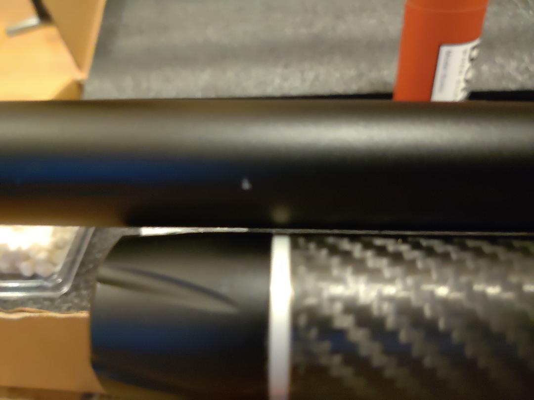

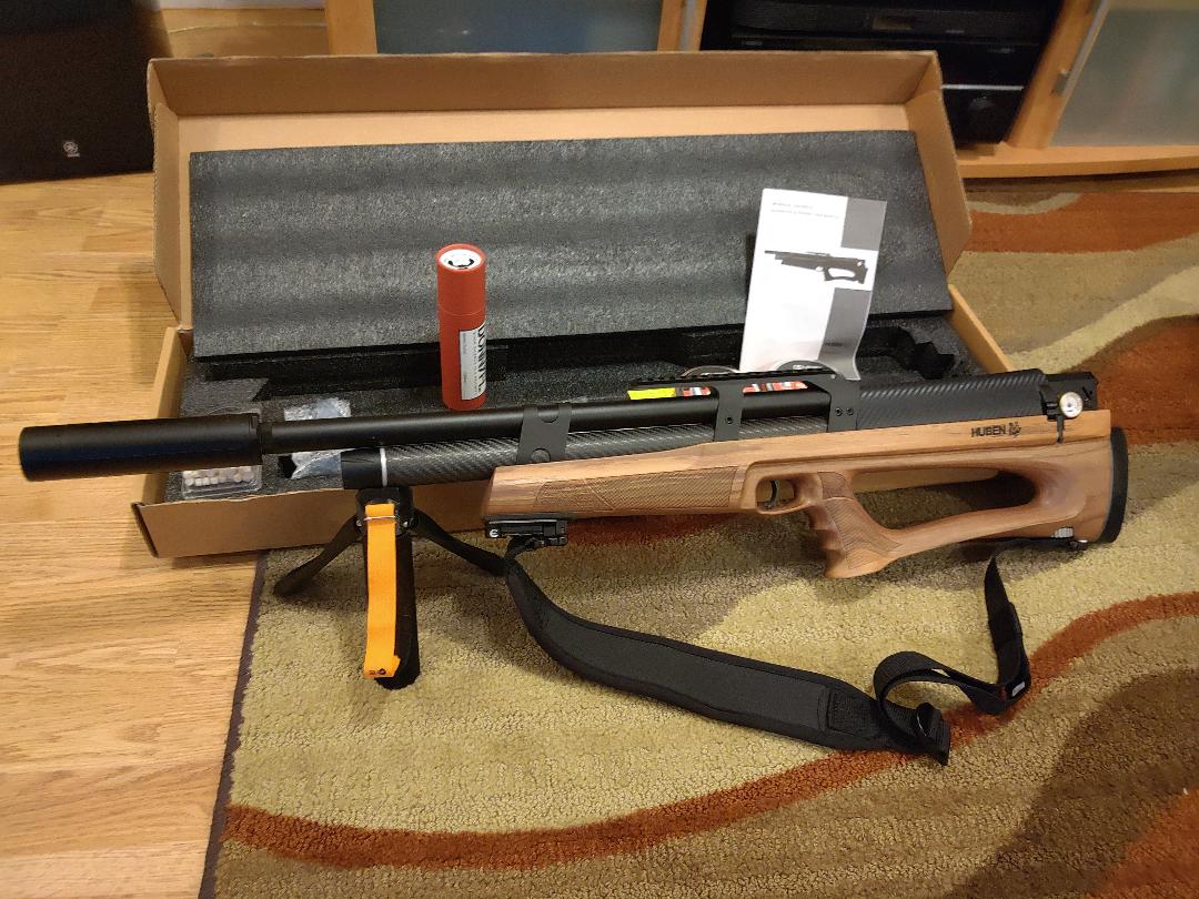

PCP Rifle  SOLD 23’ Huben K1 .25 with both wood & synth stocks & EXTRAS
Everything you see in pics comes with K1, small nick in anodized finish on shroud {pic attached}. I did that in first 5 min of owning by trying to insert fill probe on wrong side.
2023 Huben K1 with wood stock and synthetic stock. Still has clear covers on gauges. Added CF vinyl to cheek rest
Uncle mikes sling studs with sling and caldwell sling stud pic adaptor for bipod
.DFL mod adaptor with .25/30 DFL Sumo Mod.
A pack of cleaning pellets
a new in box loading gate https://www.ebay.com/itm/265609649976
2 full tins of JSB king heavy Diablo 33.95 pellets

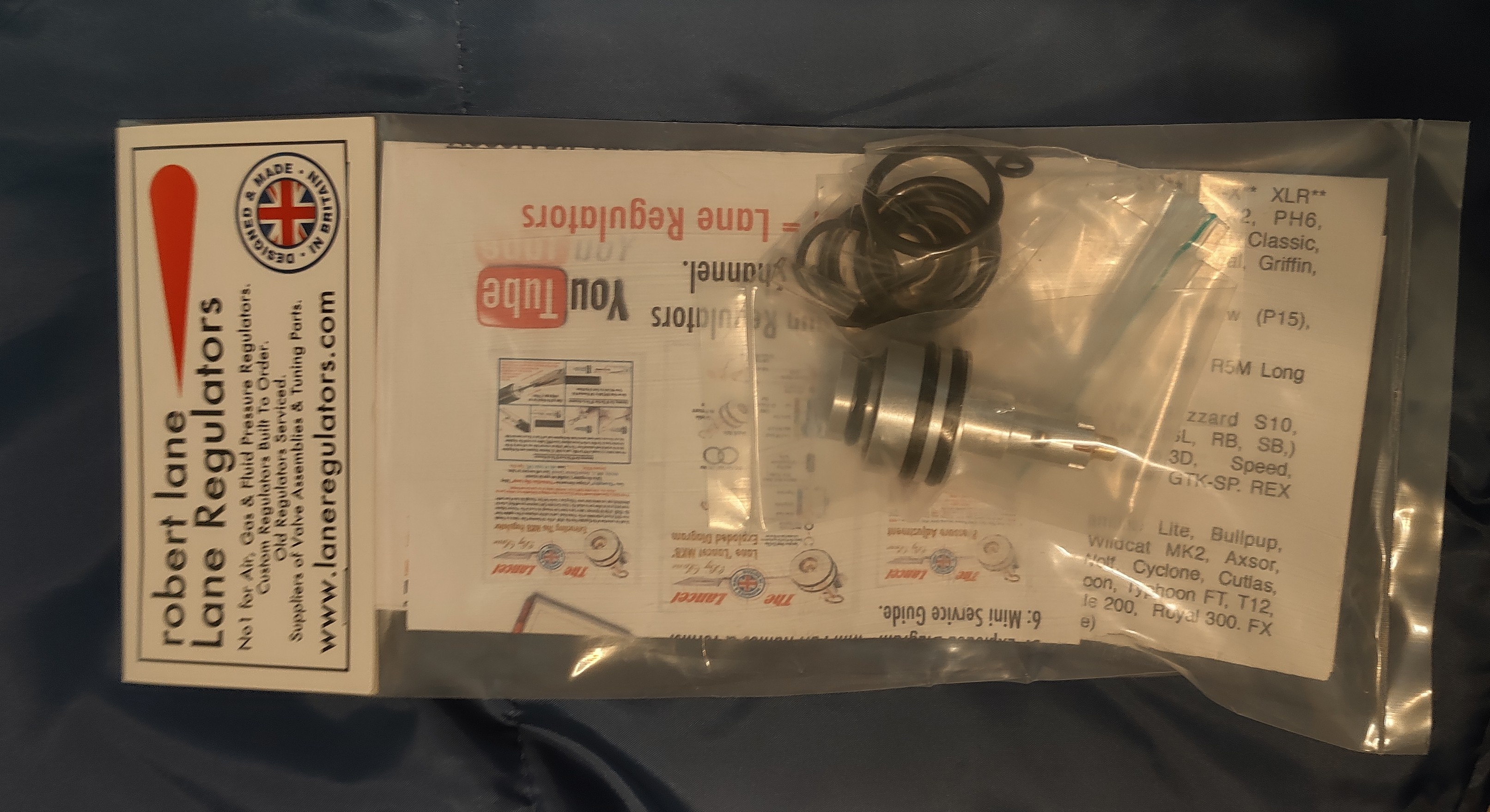

New unopened robby lane regulator

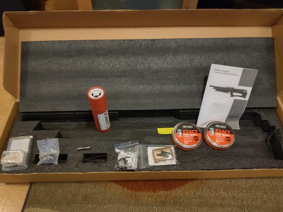

original box with original Orings/probe/manual/allen keys
$2700 all in not including taxes and shipping.

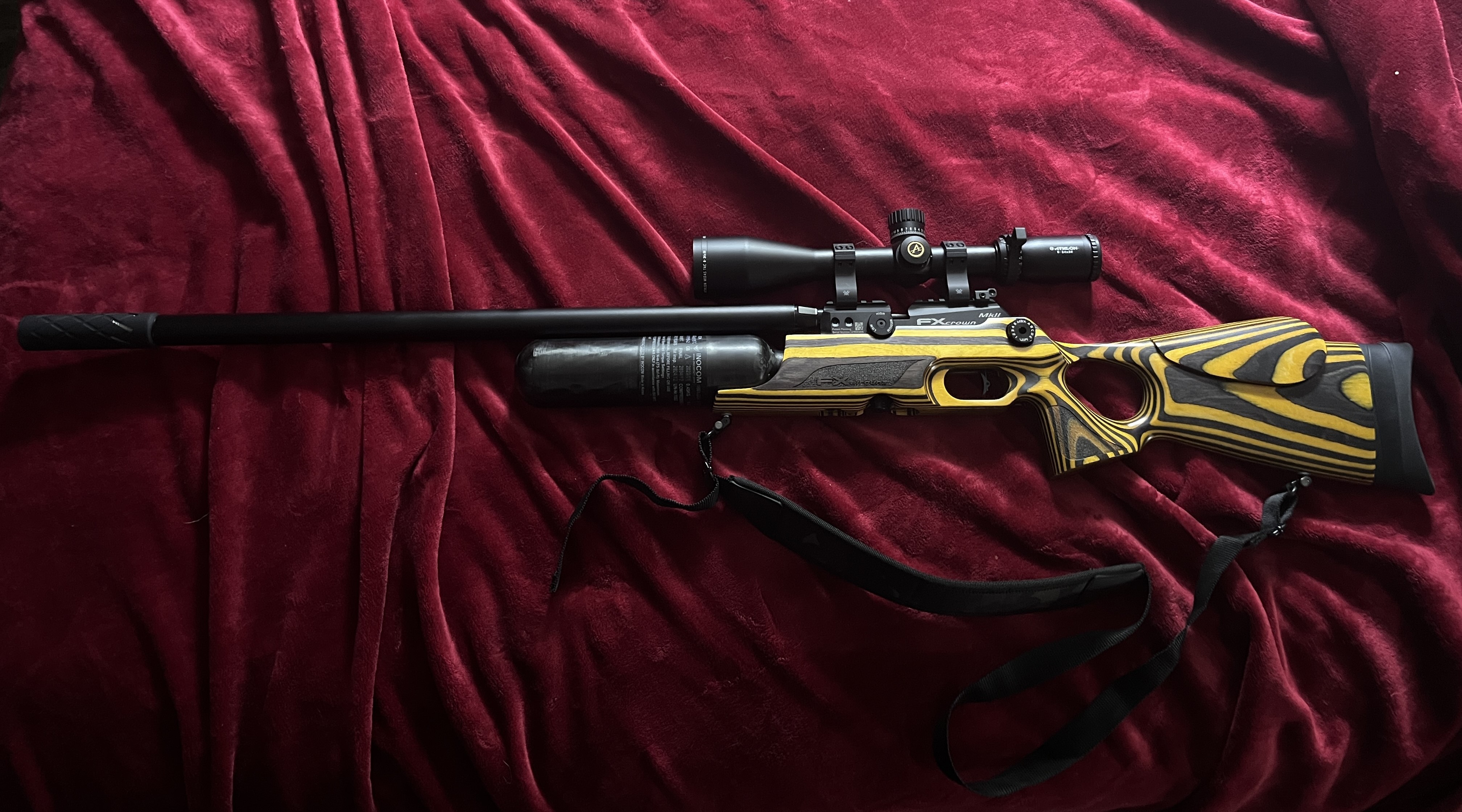

PCP Rifle  SOLD FX Crown MKII .25 (600mm) Yellow Jacket
I am selling my FX Crown MKII .25 with 600mm barrel.
Odb silencer
Athlon Optics Midas Tac HD 6-24x50 FFP MOA reticle
FX chronograph v1

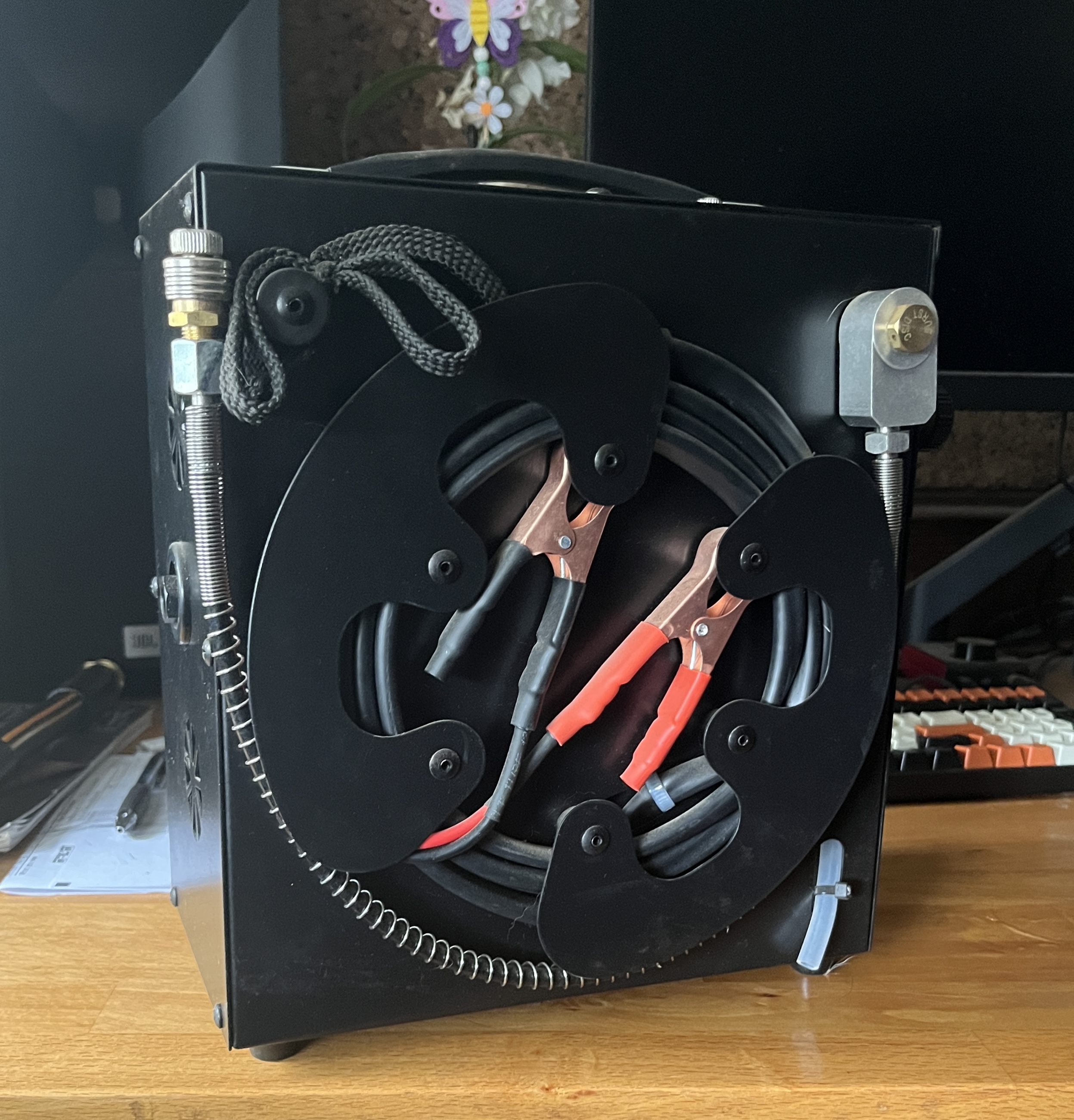

JTS comp1 compressor
2 magazines and the gun will ship in the original box.
I am hoping to keep it all together. I am asking $2500 for the setup. Seeing as this will be large and heavy, I would ask that we work together on shipping. If it is reasonable, I will cover it. I am in California though, so if you are in Maine, we could work together to make it fair :)
