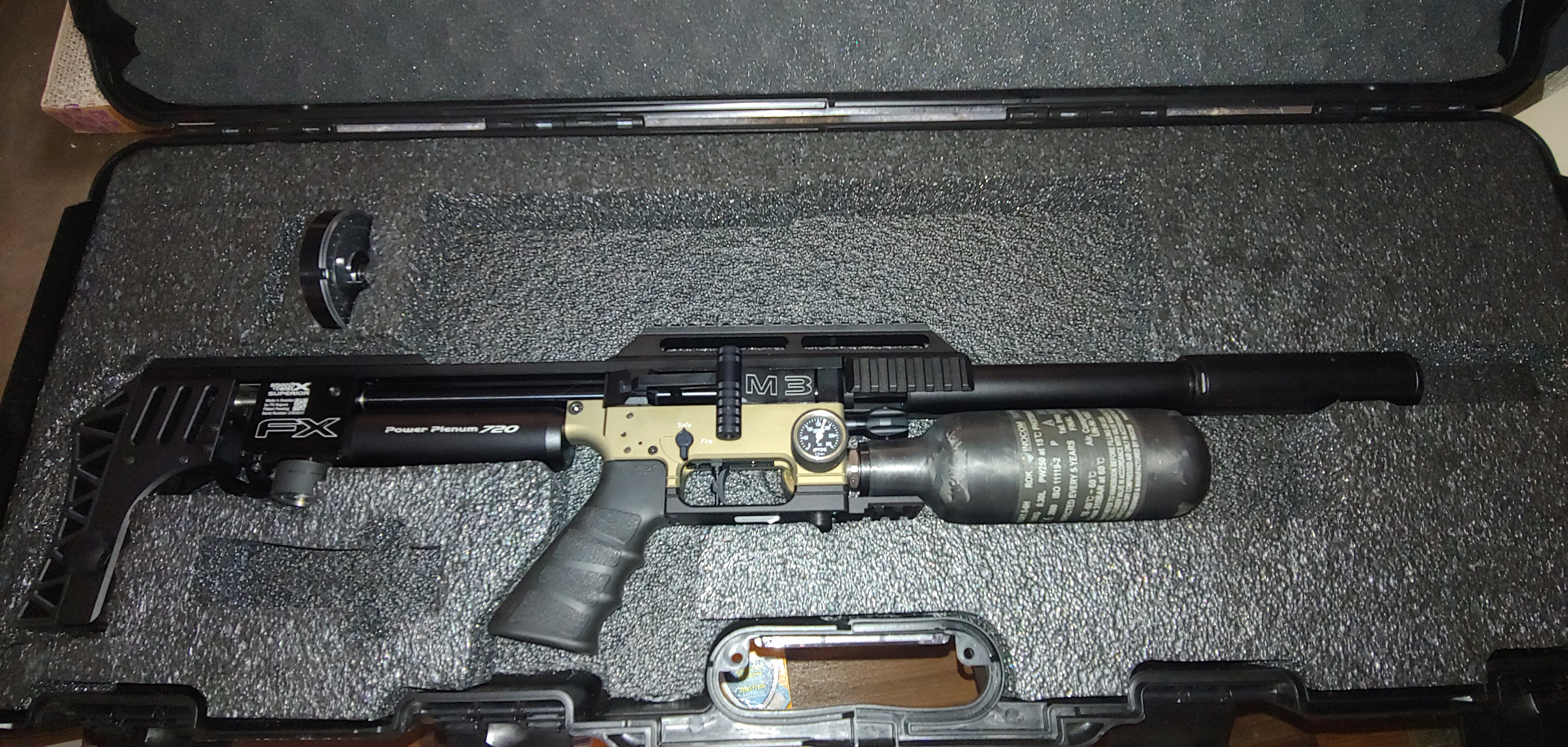

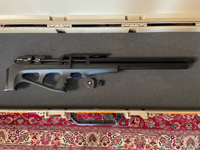

SOLD FX Wildcat MK1 .25 with Air compressor and bottle- SOLD
I just recieved my new airgun after a considerable wait so am letting go of my previous squirreling rifle. I have an FX Wildcat MK1 with a Donny Sumo, air compressor (I have 2), bottle and pellets up for grabs. I switched to a .30 for hunting is the reason I am selling. This was used for hunting so the round count is low as I am not a target shooter. Shoots very well and accurate with aftermarket Huma reg. I tested last weekend and it's shooting JSB 16.5 at between 917-930 FPS. Asking 900 for total package. Must pick up in Oxford, KS for whole package which will include 3 tins of JSB .25 pellets. I can be reached via forum or text at 316 six 33 8636. Thanks for looking. Luck!
