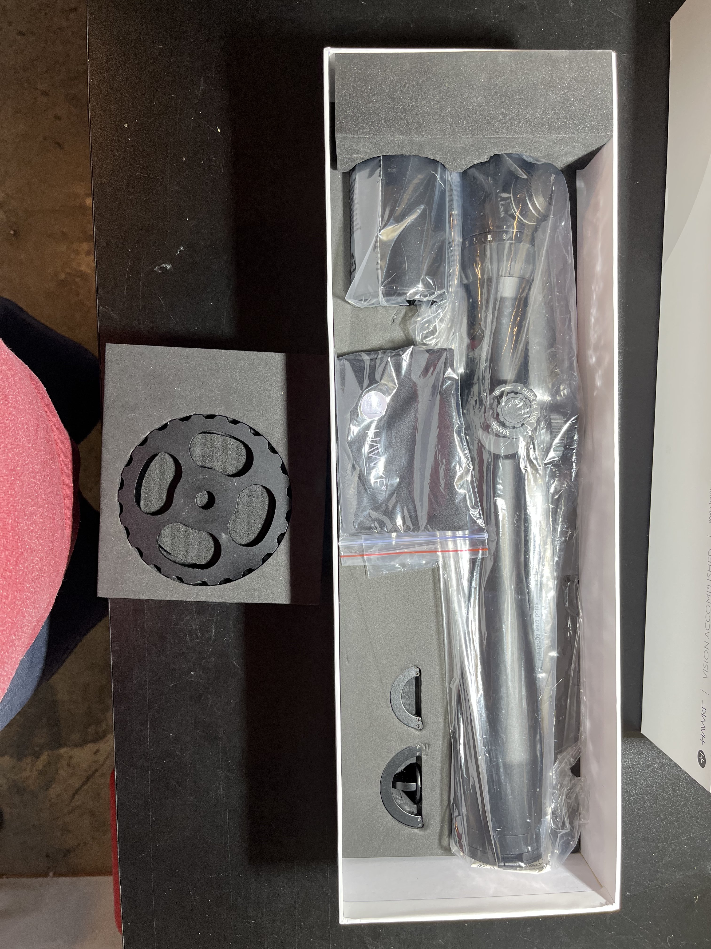

SOLD Element Helix 6-24x50, SFP
LNIB - Element Helix 6-24x50, SFP scope. It has the EHR-1C MOA reticle. No scratches, marks or dings. Comes with all original accessories, manual, box, etc.
$315 OBO and will ship free within CONUS. Not interested in trades. PayPal F&F or buyer pays insurance. Venmo is also an option. PM with any questions and thanks for looking.

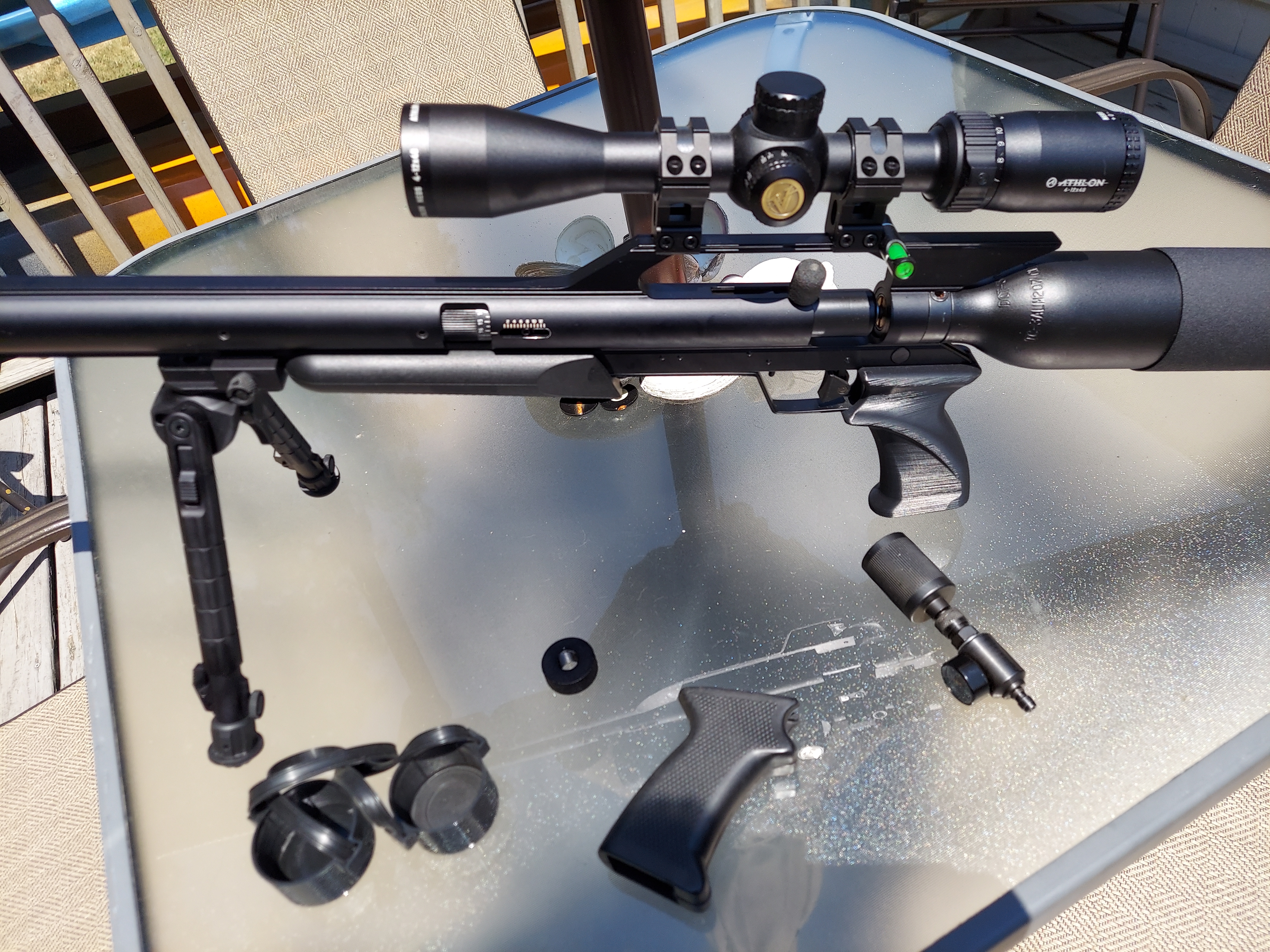

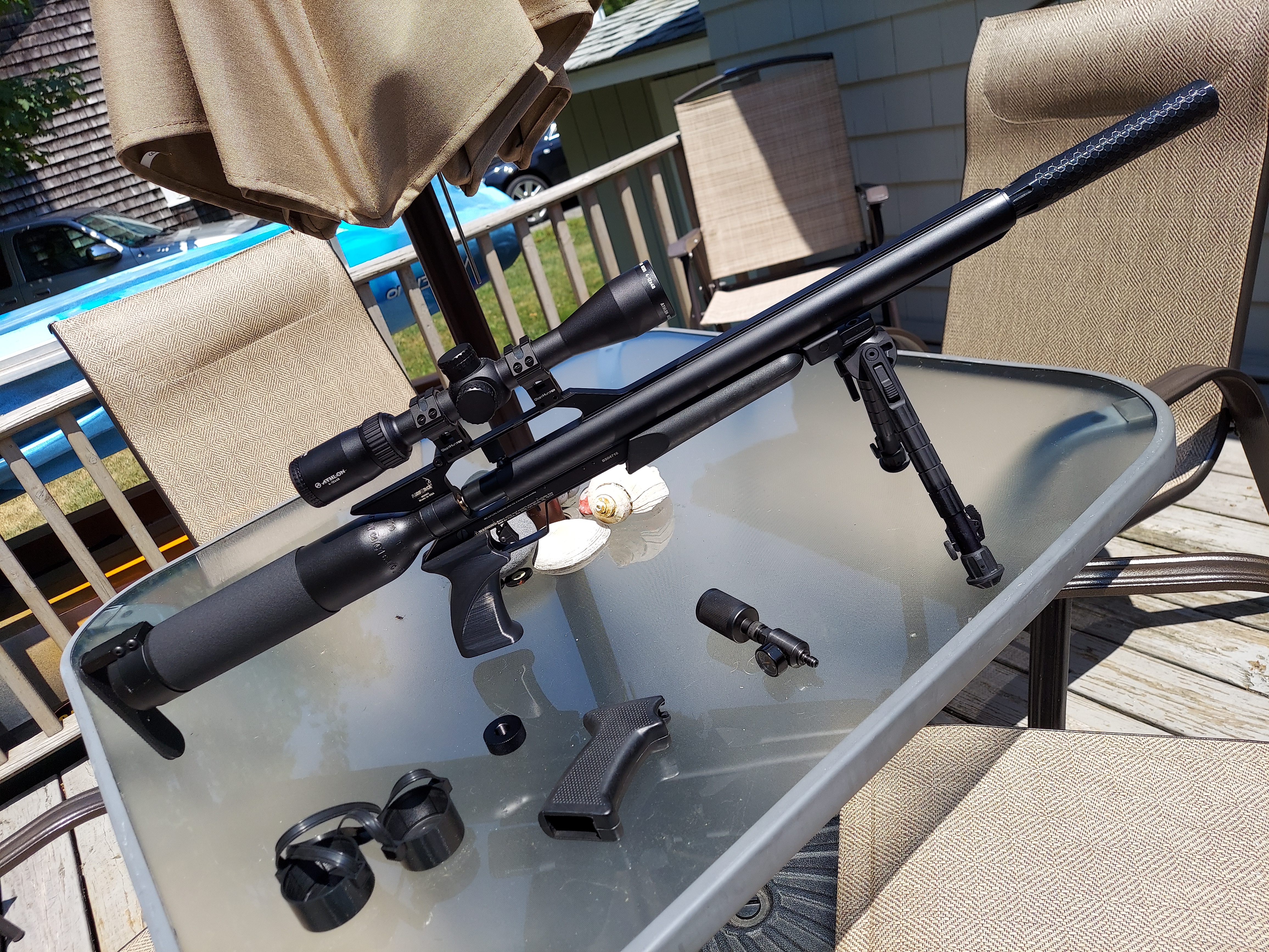

SOLD WTS Benjamin Armada .25 w/scope and bipod final price reduction.
Selling my .25 Armada. Like new only 4 mags thru it. Shoots Jsb .25 lights out. Just sits in the closet. Purchased new earlier this year on an impulse. Bought a wildcat and just don’t use it. Nothing wrong with it. Will come shipped in the original box with everything it came with. Center point 4-16x50 scope and bipod included. Asking $500 shipped PayPal f&f or you cover the fees please. OR $400 shipped gun only(no scope or bipod) Pm here or text to work out the details. Voice call or video chat ok with me to prove I’m real. Have bought and sold a few times here and can provide references if you would like. Thanks for looking! Phill
