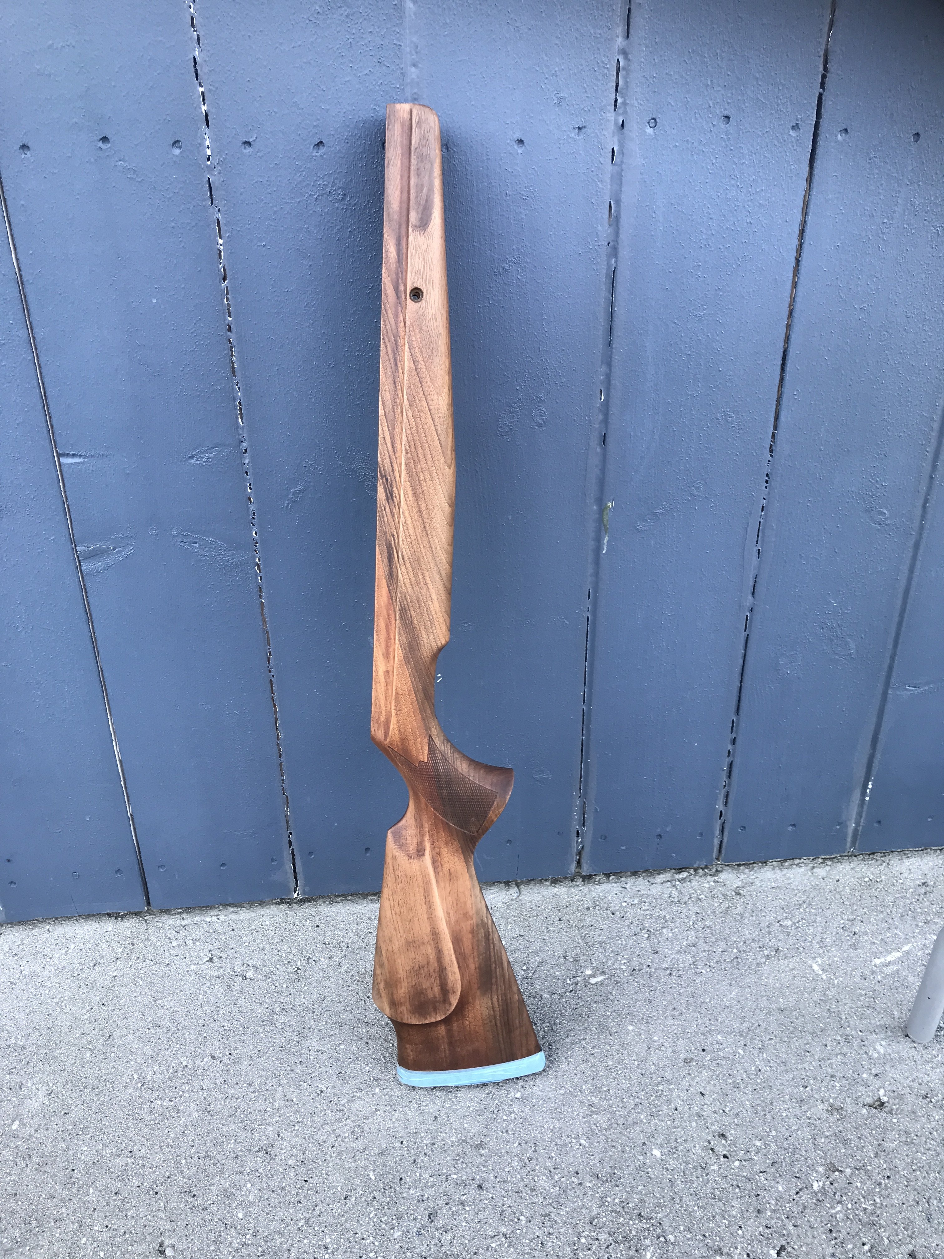

SOLD Saber Buttstock (Great condition)
$210 shipped CONUS
This buttstock has never left the house, no scratches or chips....it has never touched concrete or dirt.
