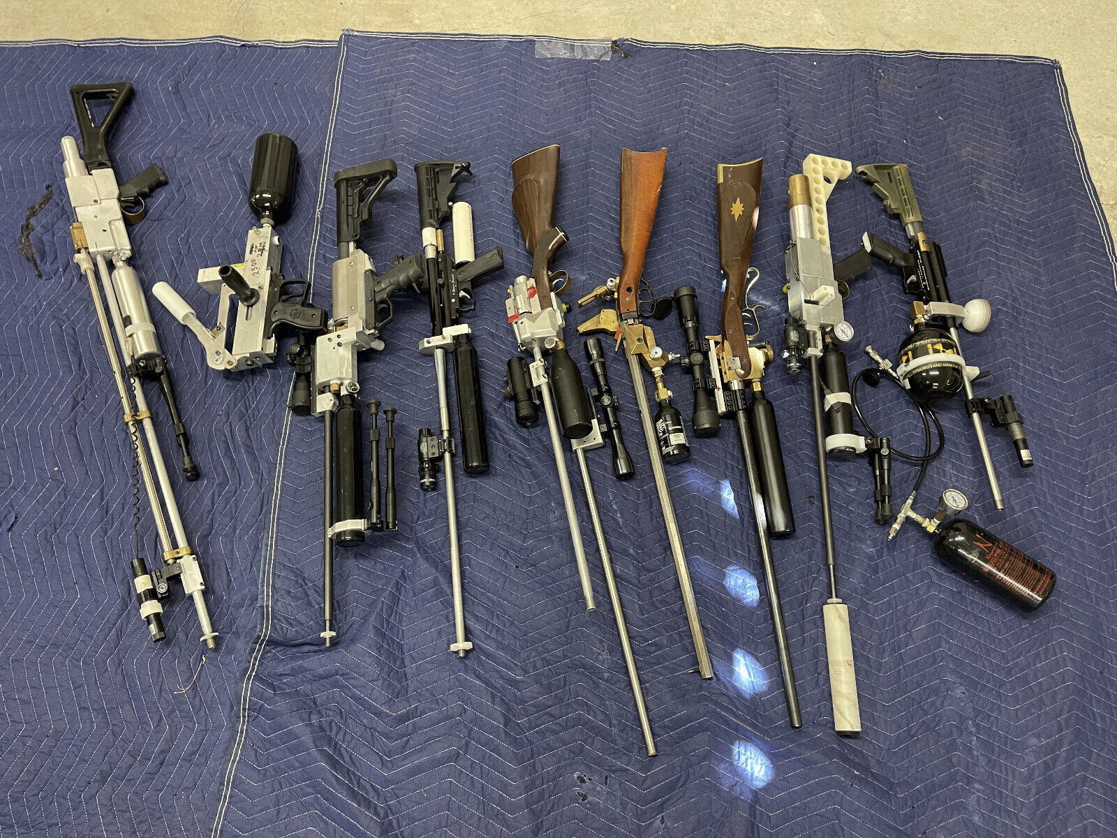

My personal collection
I’ve been air gunning for abt 15 years. My go to on break barrels is my gamo hornet in .22 with a sorovee scope . My others are a gamo bone collector.22 & a gamo silent cat in .177 . All are good shooters but are no comparison to my latest . An air Venturi avenger in .25 with a vortex scope. Its trigger is crisp & the gun is very accurate. I do a lot of bench shooting & some squirrel hunting with them & the Ava is hands down a pleasure to shoot.
