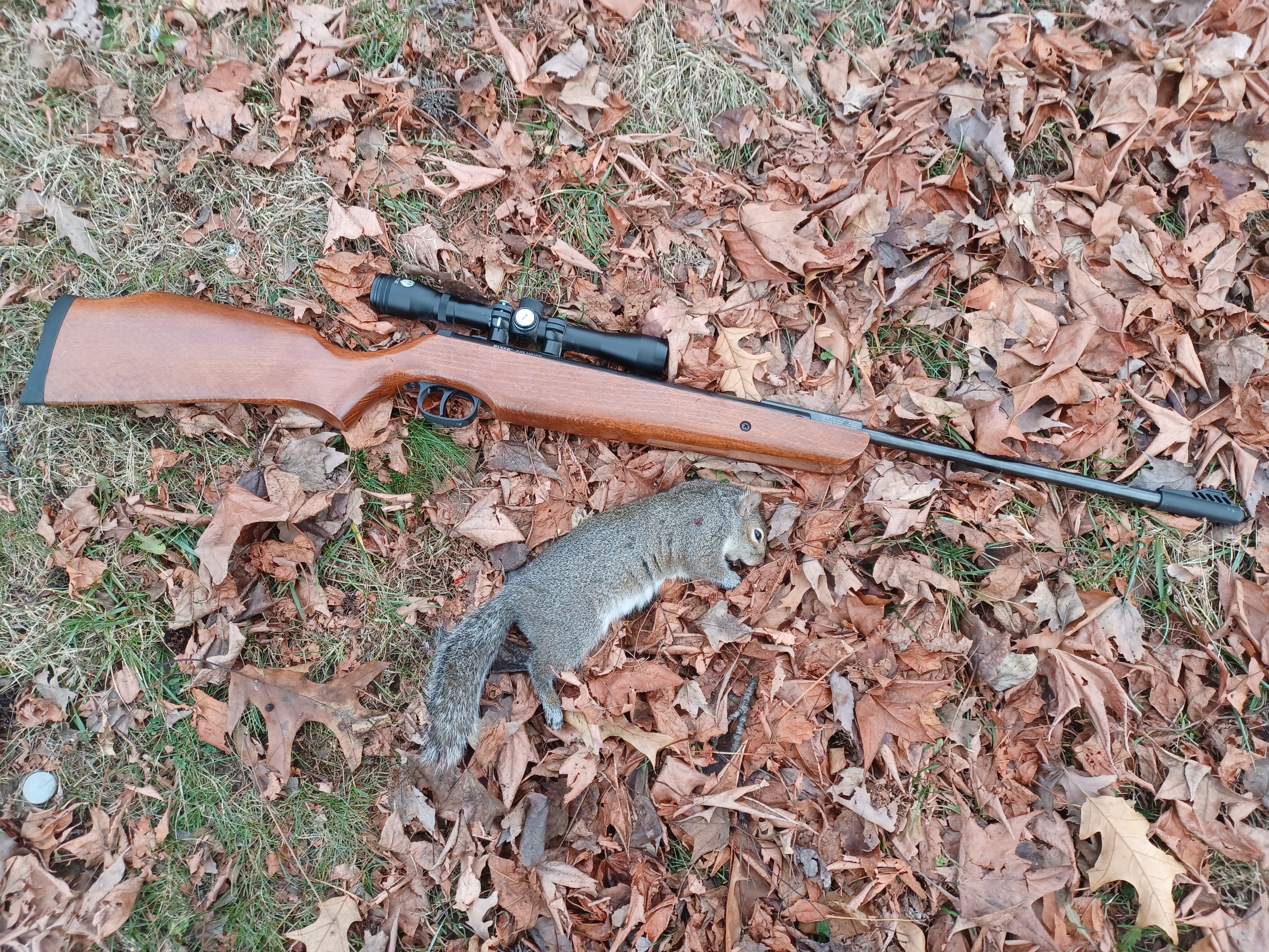

Ruger air hawk strikes again!
Went to my boss's house after work again and got me another female gray. Biggin too.
Got her with the ole trusty air hawk, about 40 yards. Snuck a crosman destroyer right behind the right shoulder. Heard the thump but thought I missed and hit the tree behind her.
Waited a couple seconds and seen her death kicking in the leaves, but not much movement. I've taken the last 4 squirrels with this same shot placement and 3 all were DRT. None were pass thru shots. The squirrel that ran was a full pass thru vital shot from my 50 fpe 25.
Really starting to dig lower power for these close backyard shots. Getting too old to be hopping fences to go get my tree rat.
