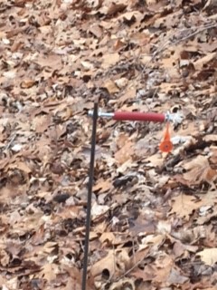

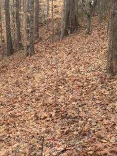

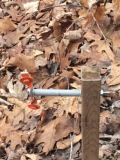

1st 100y Experience
Am I a cool kid now?🤣
It was NOT easy.
Setup the 100 yard first; nice trek🥴
Put an old beer can I found nearby on a branch to hold it in place.
Setup the old spinners with some fresh white tape for visibility sake.
And a shotgun hull I found on a twig.
Took the newer black spinners to the usual 50.
Found some more debris for targeting.
A red and a green plastic bottle cap.
The snowpeak; I am still somewhat getting used to(I keep changing the accessories)
She did fine at 50 after I got comfy.
The Lothar.....ooohhhh👀
What a BEAST!!🤯
50 YARDS WAS PRETTY MUCH NOTHING!
And the shot count🥴
After 75 yards....
Whole new ball game...however in the joy of getting ready to go to the range...I had forgotten to grab the Lothar's preferred pellets🤦‍♂️
I grabbed my closest option.
Benjamin 10.5g HP
It took some dosing for sure.
But I was able to get some dings in and was able to slay that old beer can😆
The shotgun hulls stood no chance as well🥰
Stayed out there a good 6 hours just plinking and enjoying the weather🤗
Plenty of pest birds around to try for.
But I opted to wait for a meal.
2 pairs of ECD at different intervals. I made sure to take out the female first bc the males seemed frisky; so I knew they would wait and not fly away for the downed female; thinking it was playing coy. They both did, both times. Got 4💪
Time to go make dinner!🤗
