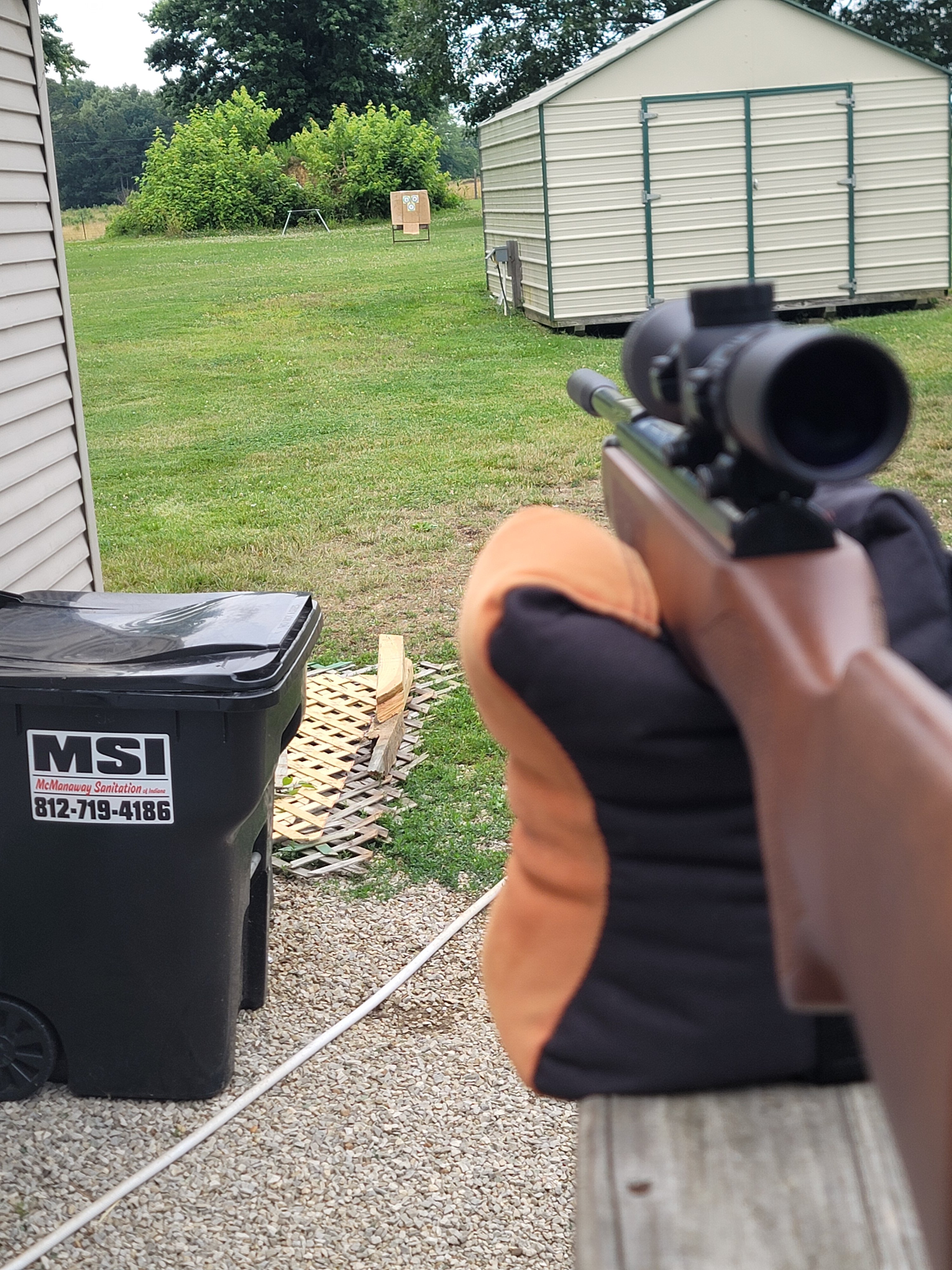

3 1/2 hours on the range
No not shooting. The range needs maintenance, unfortunately. Don’t like weeds taking over. I spend enough time shooting on it, time to clean up. The falling leaves stick to the weeds like Velcro. Here’s what I started with.
This is a shot from last week.
Just I just found this pic. this shot is from my drone. I don’t know how I transferred it to my phone ,but I did. I have some wicked pics in that drone now.
The pic looks like about 60 ft. high. This drone is new to me and really really cool. This shot is before cleanup.
This shot is after cleanup.
Still have a few shovel loads of stones to pick up.
Some of the ground targets I will modify they so I can hang them above the snow. The rest will be cleaned up and removed soon.

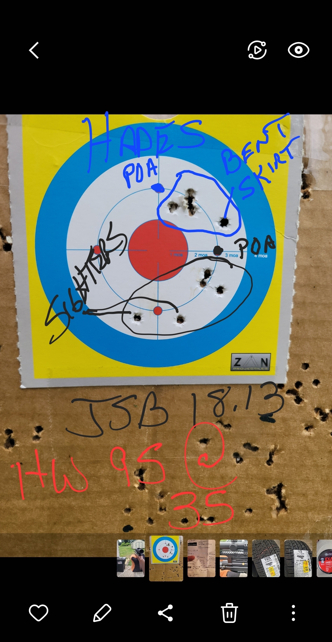

Defective Pellets?
I purchased a new batch of jsb Mark II's about 2 months ago. Since then I've had to send my maverick into the shop with a jammed loading mechanism blaming it on the gun. Now I find my huben has loaded up the barrel with broken pellets which jammed it up and I've sent it in to get fixed professionally because I don't know what all I tore up. Started with accuracy, loading problems. I'm trying to accept this responsibility as mine I don't think it's the gun in fact I know it's not the gun. I Wonder has anyone else seen some discrepancies or have some problems that have some questions in their mind now. I've never seen anything like this before but there's something going on and I'm not going to use any of these pellets. I have some older batches that I had no troubles with, I'm just confused and a little wary any input any experience. Am I nuts?

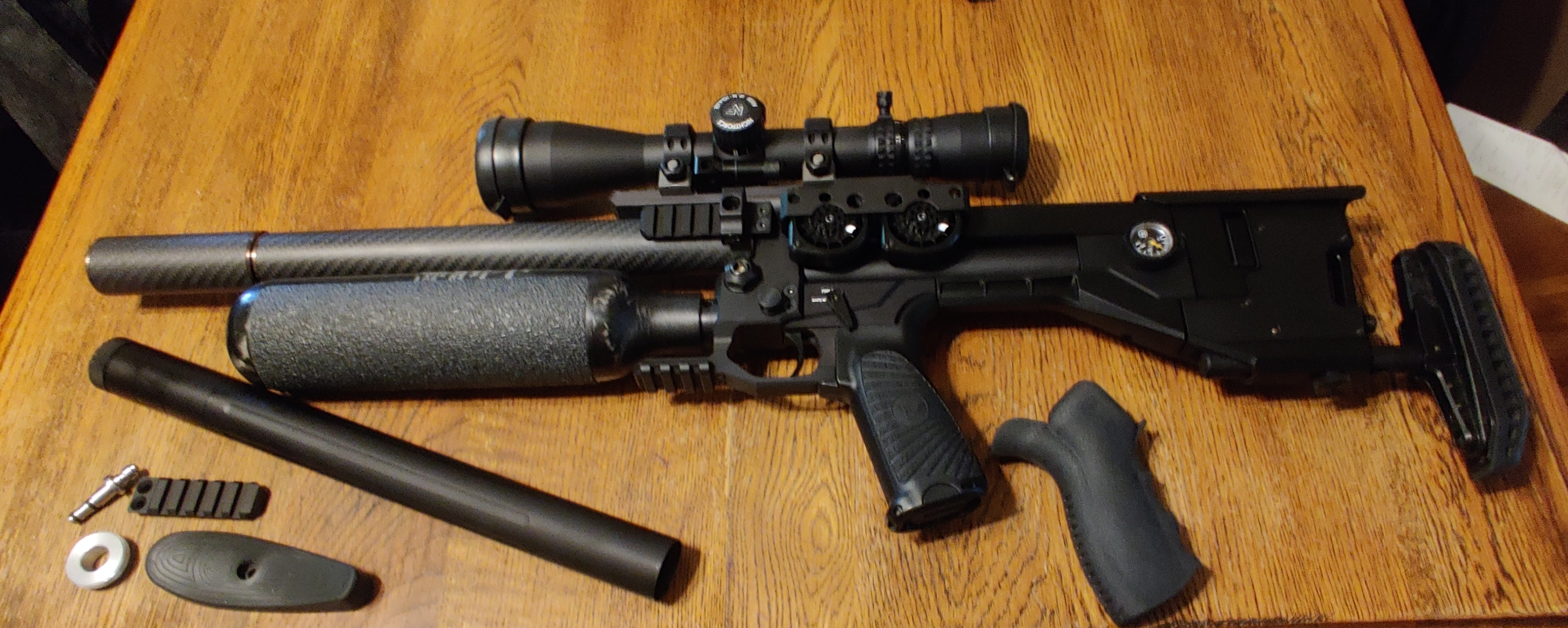

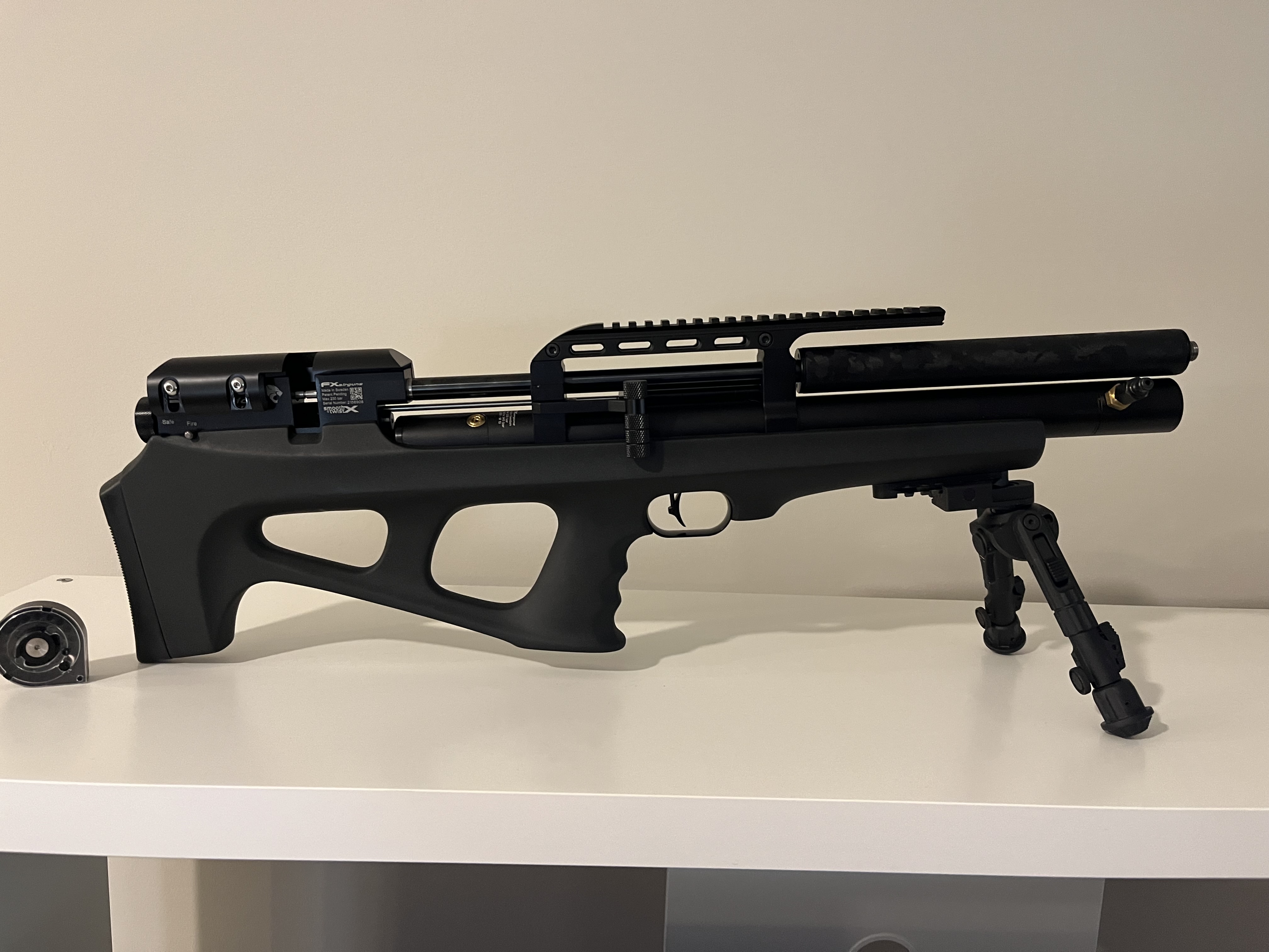

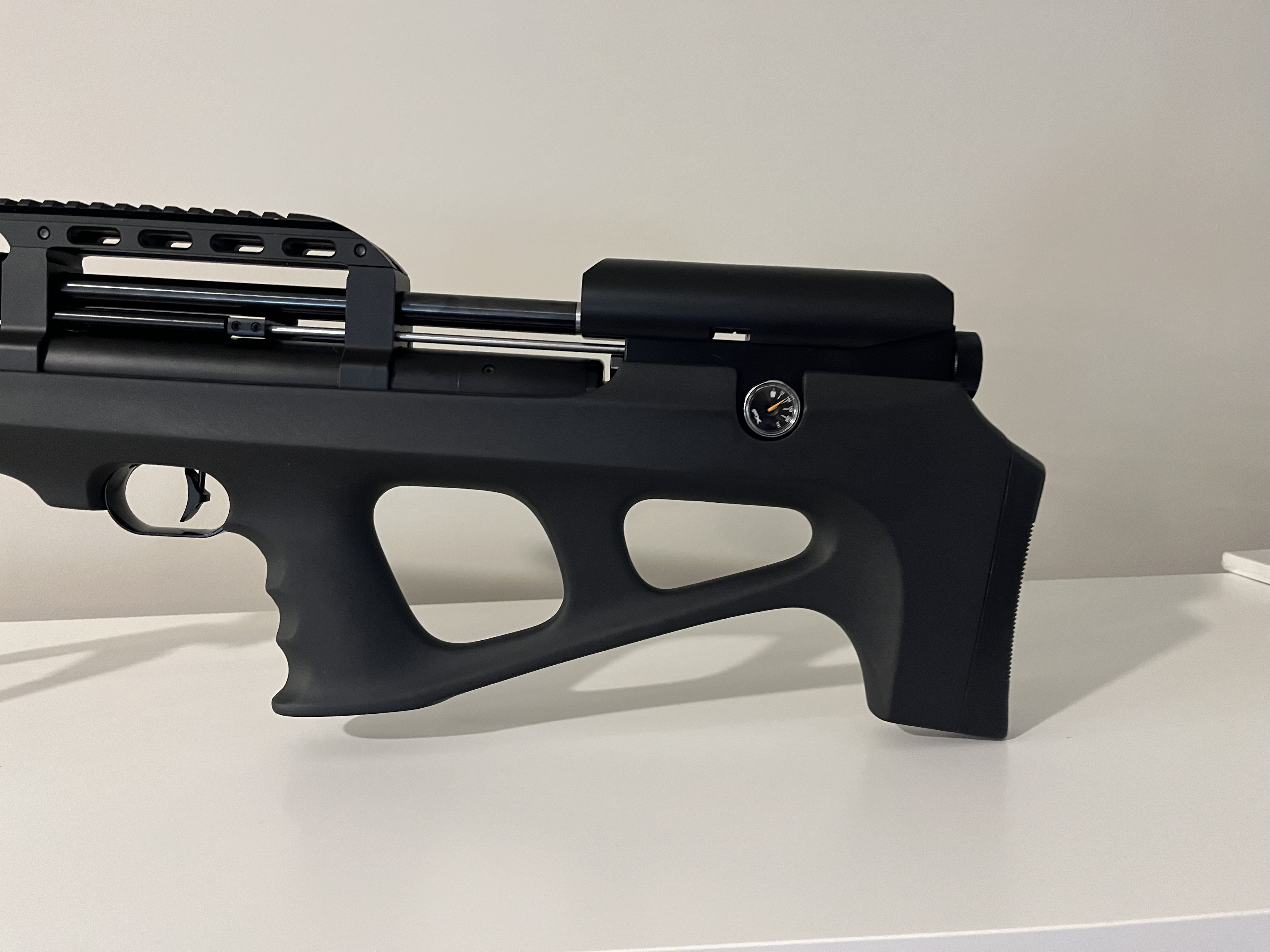

PCP Rifle  NLA Brk Ranger XR 22cal
Selling my BRK Ranger XR in 22cal.
I use my evol mini more, so this one sits a lot (I don’t like safe queens).
Currently shooting cphp cheap pellets at 15fpe super accurate for such a cheap pellet. Trigger and tune were done by Derrick Wall from who I purchased it from.
Comes with 1 mag, and only front picatinny scope rail (reflected in price).
Scope not included.
Asking $1150 shipped conus PayPal f&f or add fees. Will take bankers checks or money orders, but must clear before rifle ships.
Buy with confidence knowing I have perfect feedback, and have bought and sold on here for quite some time.
Thanks for looking.
Any more questions or picture requests, message me privately.
Will include one of qballs 3D printed moderators that makes this thing almost mousefart quiet.

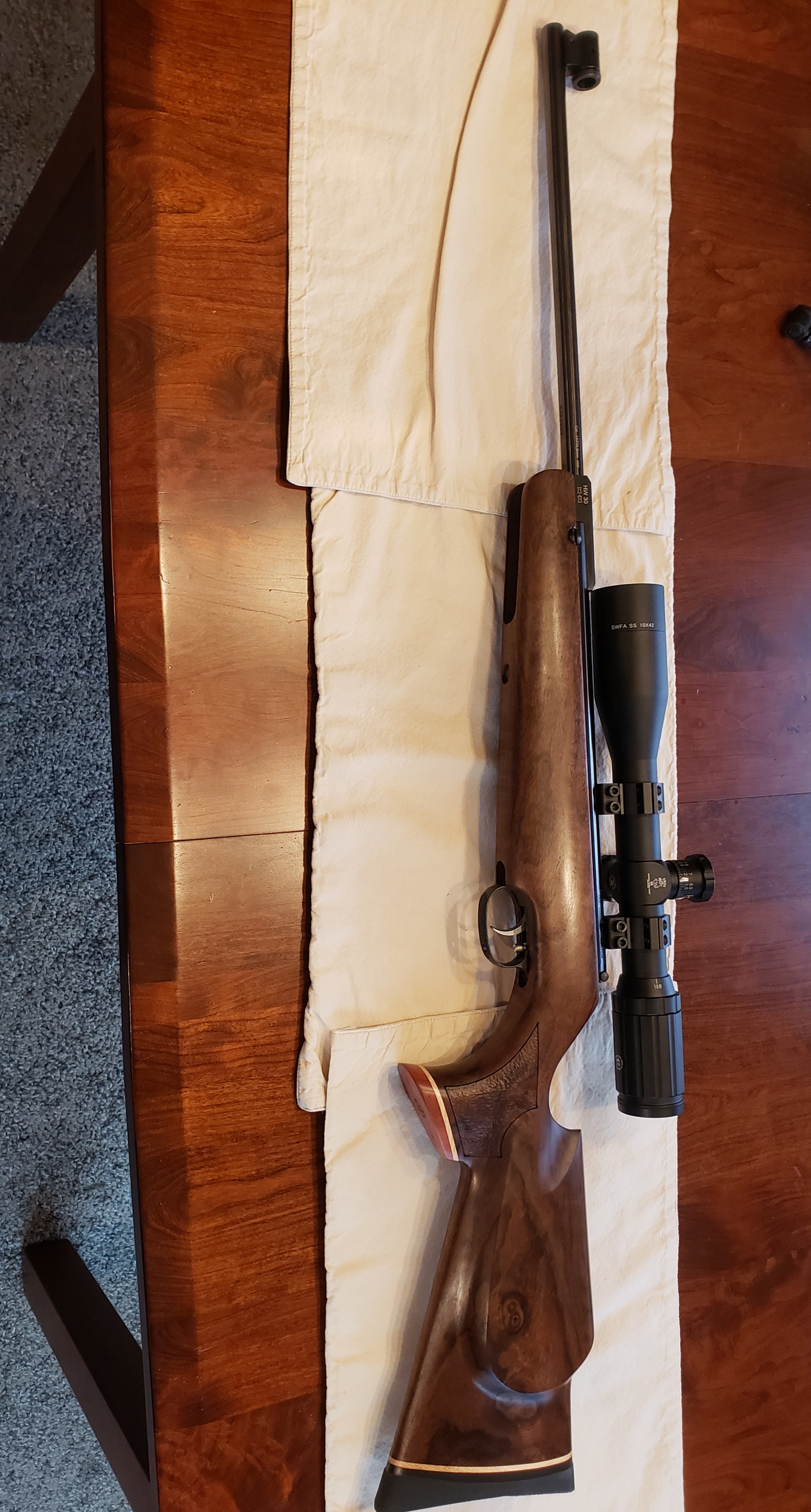

HW 85 Cal. 6.35 How common is it?
Hi All,
I'll go straight to the point: I have a HW 85 springer (Weihrauch 85) Cal. 6.35 mm (.25). I tried to get another one for my nephew, but I was unable to find one anywhere. After failing to find one online, I went to several shops and... same thing. Cal. 177 and .22 readily available, but no .25. Some of them told me that they never seen one and it may be rare.
How rare is it that it is so hard to get one?
