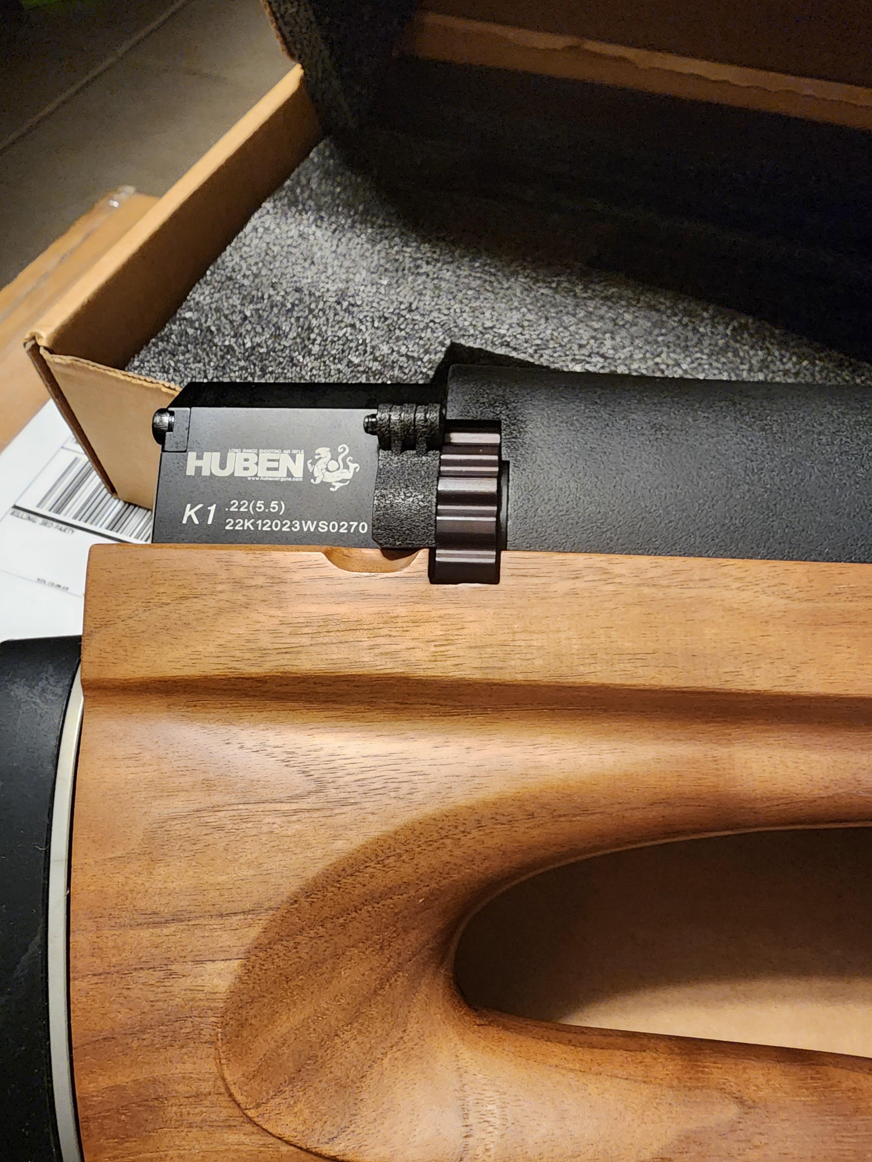

PCP Rifle  SOLD Custom Barrel - Huben K1 .25 by Kraz Cool Air Guns
Up for sale is an insane Huben K1 in .25 cal, built by Kelly at Kraz Cool Air Guns LLC and tuned by SongV. I have used the Huben K1 exclusively for hunting hogs on my property but this airgun doubles just as well for competition shooting. If you YouTube "Desert Airgun"and watch his videos, his Huben is a sibling to this one I own. If you'd like to see this rifle in action you can find some of my videos in the hunting forum here. SongV tuned this rifle for 38gr NSA slugs but it also shoots JSB Hades fantastically as well. There's a small nic in the top rail I've included in the pictures, it doesn't effect anything. The rifle is in excellent condition otherwise. Please see the photo that shows the build specifications for modifications made to the rifle. I will include a Hugget Atom moderator in the price listed as well as any slugs/pellets I have left.
My reason for selling is quite simple, we are building a business on my property and I will no longer have the time nor space to shoot. Happy to answer questions!
Here is the original invoice that comes with the gun so you can see the original cost. I am asking $1950
