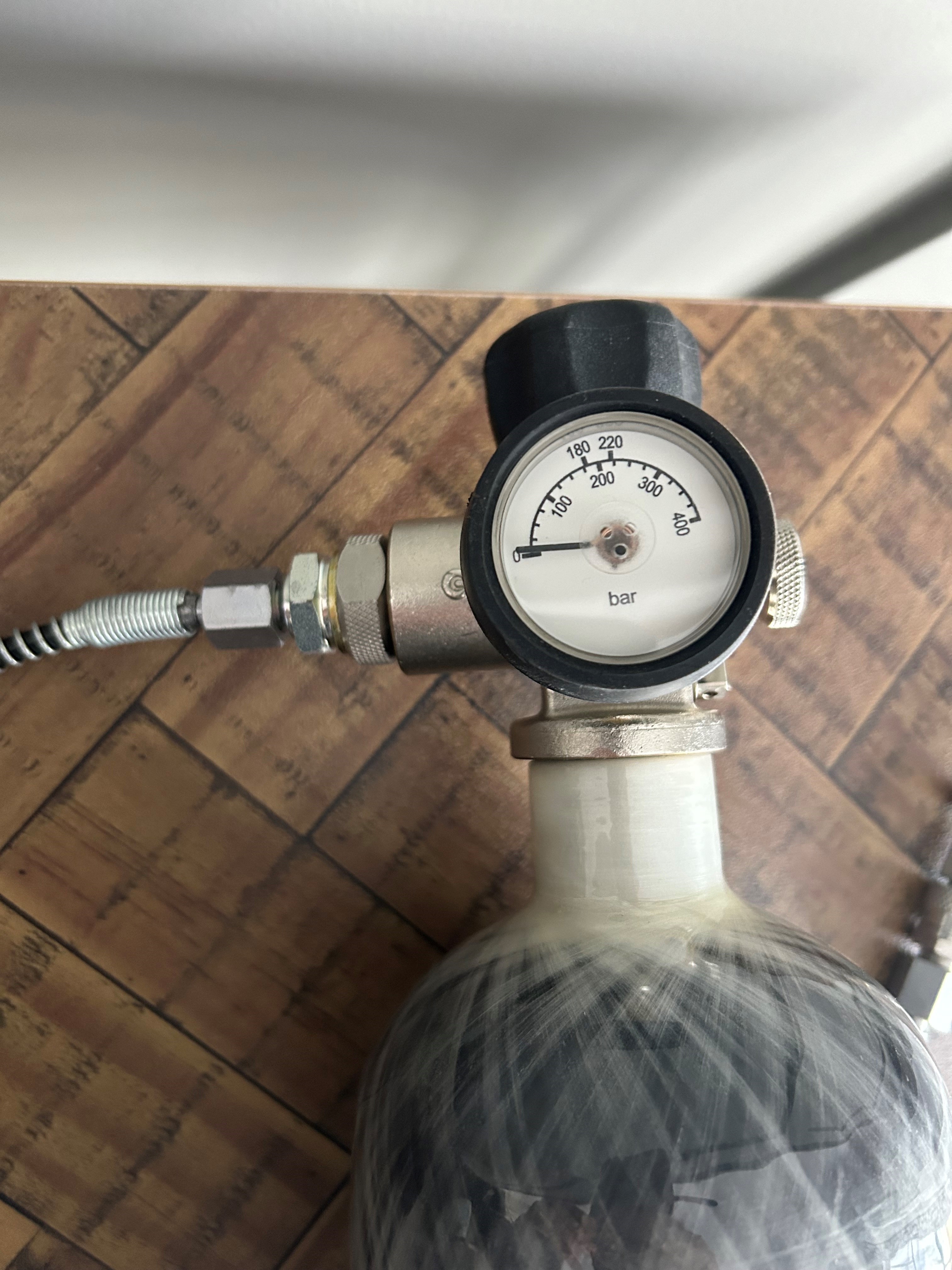

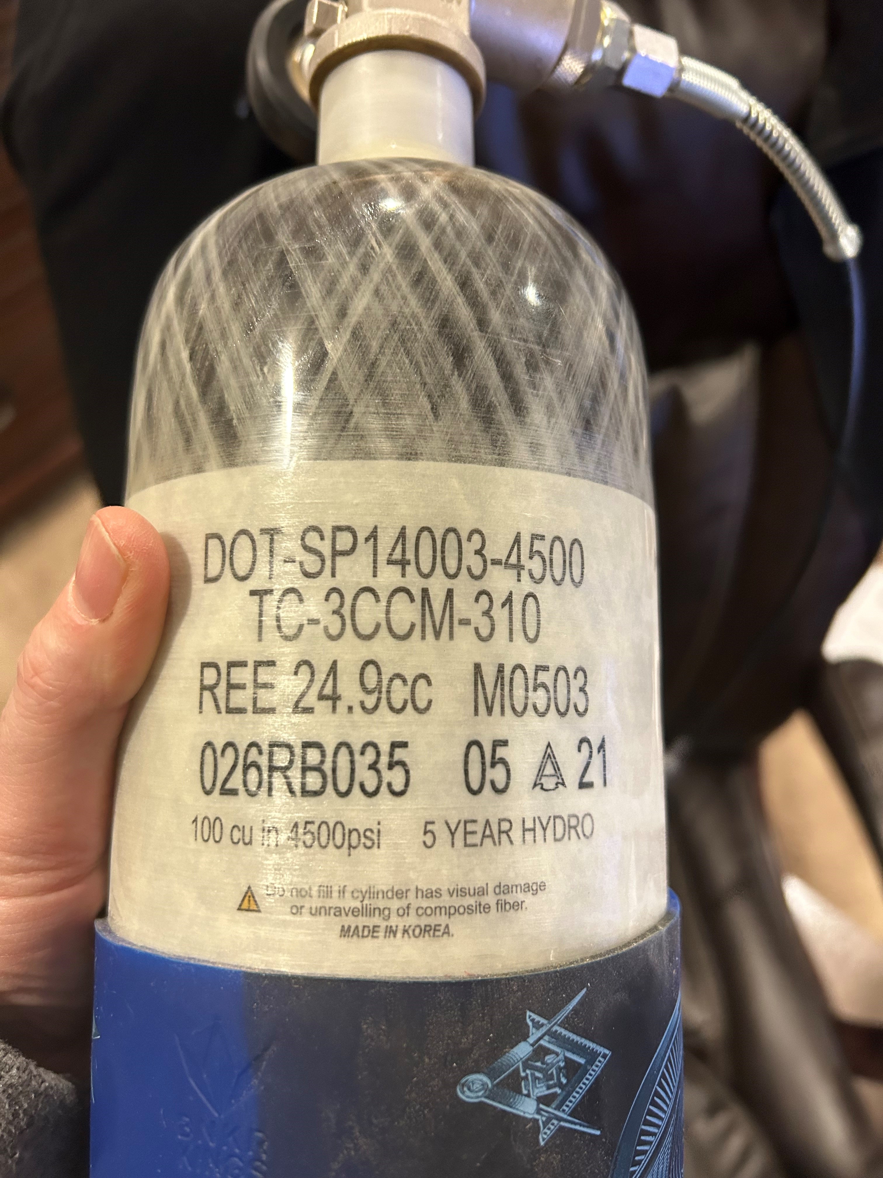

FX  Newbie here-just purchased my first air rifle: Fx Panthera Hunter Compact .25 cal
I have some basic questions regarding correct pressure of gun etc plus tuning.
I paid for scope level, mount and zero up to 35 yds. It is extremely accurate. It came with Reg pressure around 135 Bar. I read in the manual to never let the canister pressure get below the Reg pressure. That being said, I've shot roughly 15-20 rounds through it and the main pressure is super close to Reg pressure now. I believe max reg pressure is around 180 Bar.
My equipment:
Fx Panthera Hunter Compact .25cal
.25 JSB King pellet 25.4gr
300cc carbon fiber fill bottle
Here's my question: with this set up, should I be able to get more shots out of this bottle? Or is this about right with this size bottle, pellet caliber/grain and pressure settings? If I turn the Reg pressure down to around 110, should my accuracy drop much? Or should I just leave it as is, and understand I need to fill it roughly every 1.5 mags. I guess I can always get the next size up bottle too, the 580cc bottle.
