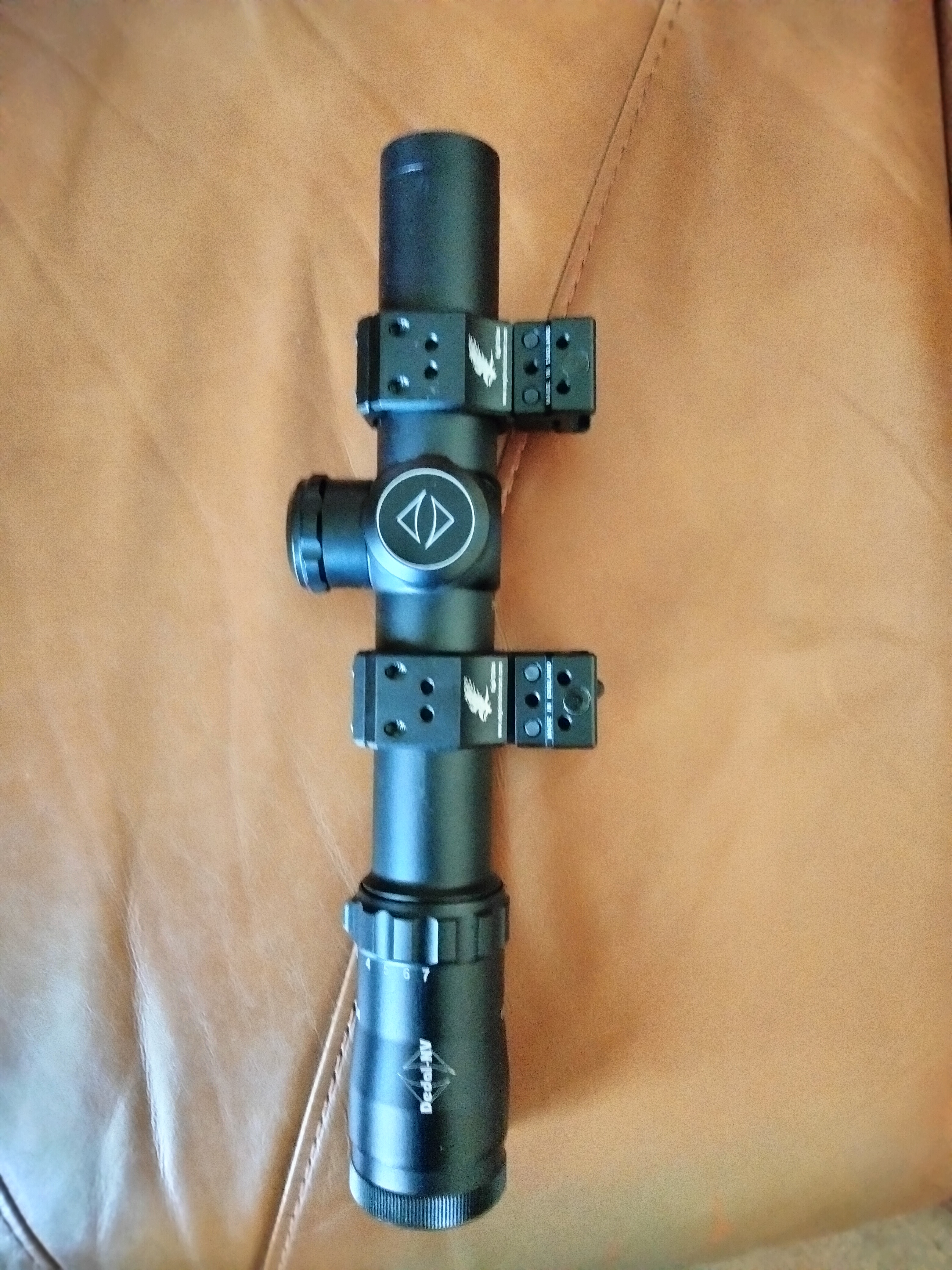

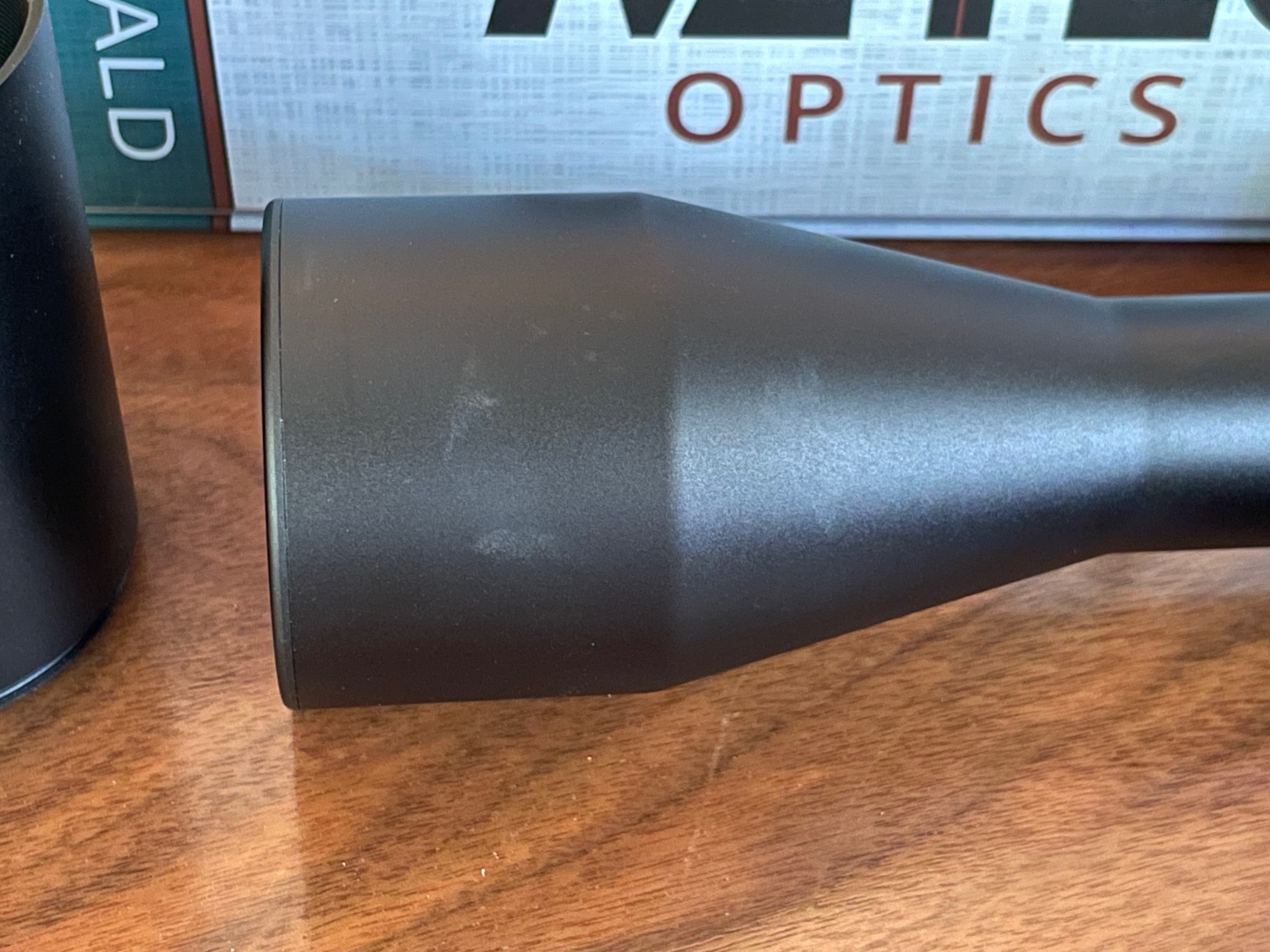

Optics  SOLD Wts hawke frontier 34mm 3x18x50 ffp
Up for sale is a basically new 34mm 3x18x50 ffp scope. This scope focuses closer than the 15 yds it's listed (I can measure when I'm back home) Rest easy with hawkes life warranty. price drop now shipped $510 pp ff or pay fees ....this is a fantastic deal. This scope could basically be listed as new .

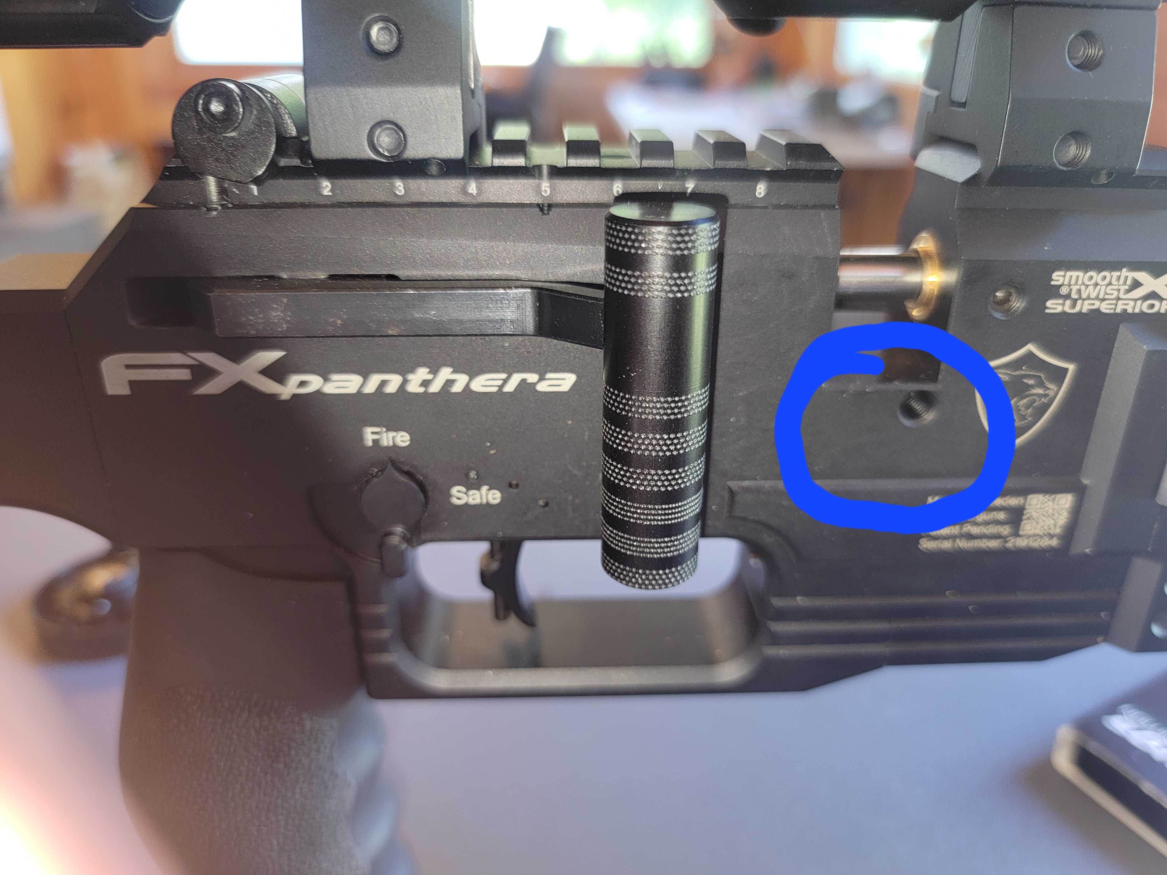

FX  Figuring out how to use this valve removal tool from Bagnall & Kirkwood
I recently purchased a valve removal tool. I'm trying to avoid damaging anything, so I want to be crystal clear on how to use it. Is the screw on the end intended to catch on the edge of the valve seat? There's a video of someone using it, but I'm not entirely sure what they're doing. They're rotating the knurled bit, but I'm not sure to what end.
Thanks.
