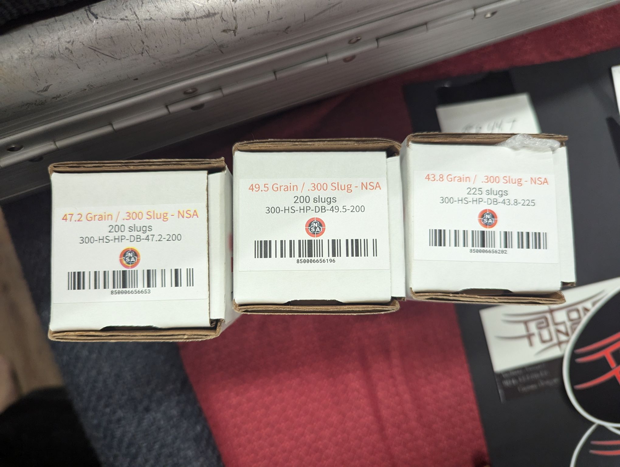

I was shooting CPHPs and tried a 12.5 g slug from a recent NSA order and it degassed on me. So I originally thought maybe it was a combination of low bottle fill w a projectile weight issue and perhaps the power wheel was set too low.
After refilling and shooting just pellets some more it occured again. I hadn't looked at the manometer, but don't think that it was a low fill that time.
I've had big bores dump on me, but that occured at the end of a shot string when I was asking for it. I haven't come up w a pattern yet...this seemed pretty random & I'm just trying to narrow it down.

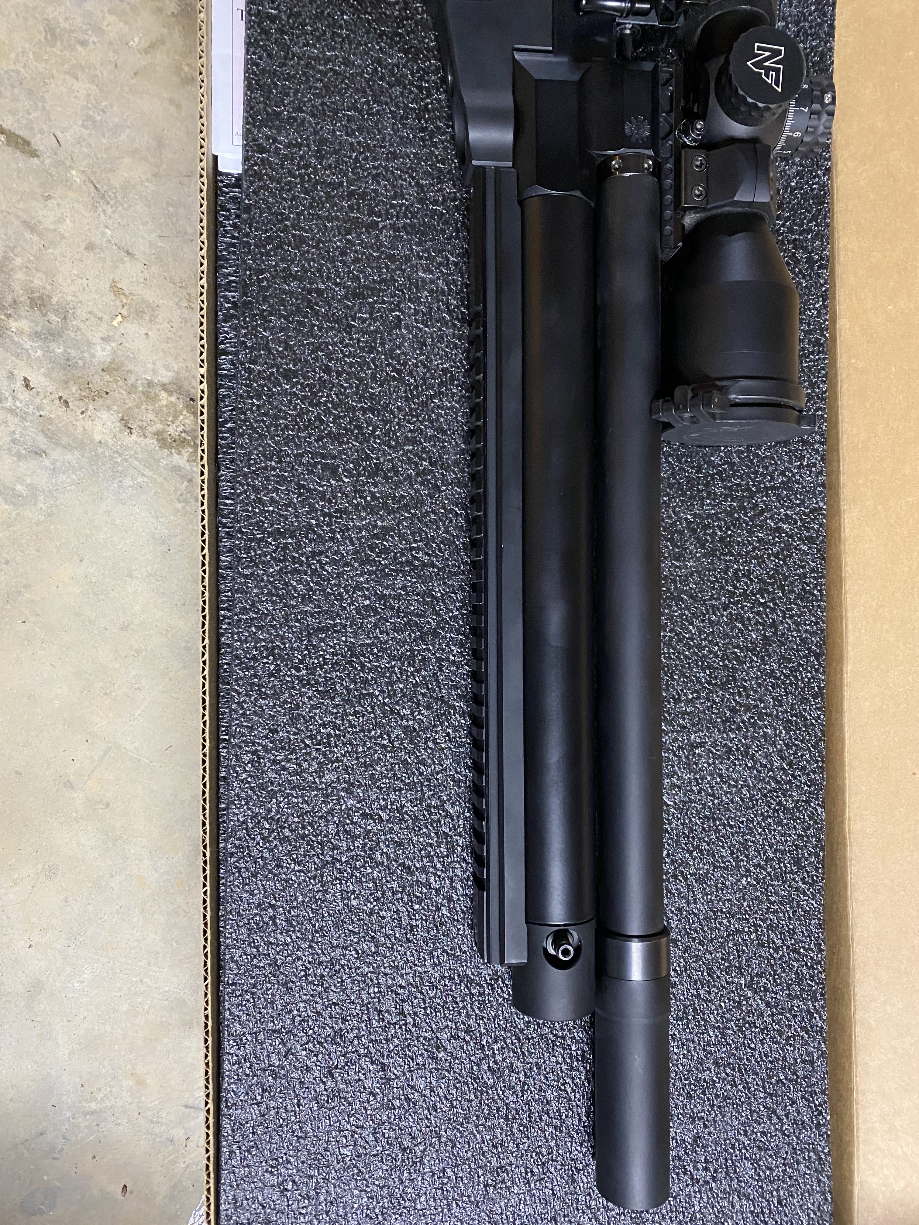

My version of a..."Carbine".
A shortened Brocock Sniper XR Sahara Performance, .22, with the 300cc air cylinder. A modified, two chamber Huma Mod30 mounted to the shortened shroud.
Yeah, I know that the color is a little off. That may get fixed with possible future modifications.
Overall length -
Original - 32.25"
Mine - 27.68"
Barrel length -
Original - 17"
Mine - 8"
The current shroud length shown in the picture includes a two chamber Huma Mod30, in the total shroud length.
Yes, there was a small change in the pellet point of impact after the barrel shortening, but that was also after removing and replacing the barrel four or five times.
The current configuration, with the sight readjusted, is as consistent as it was before the changes.

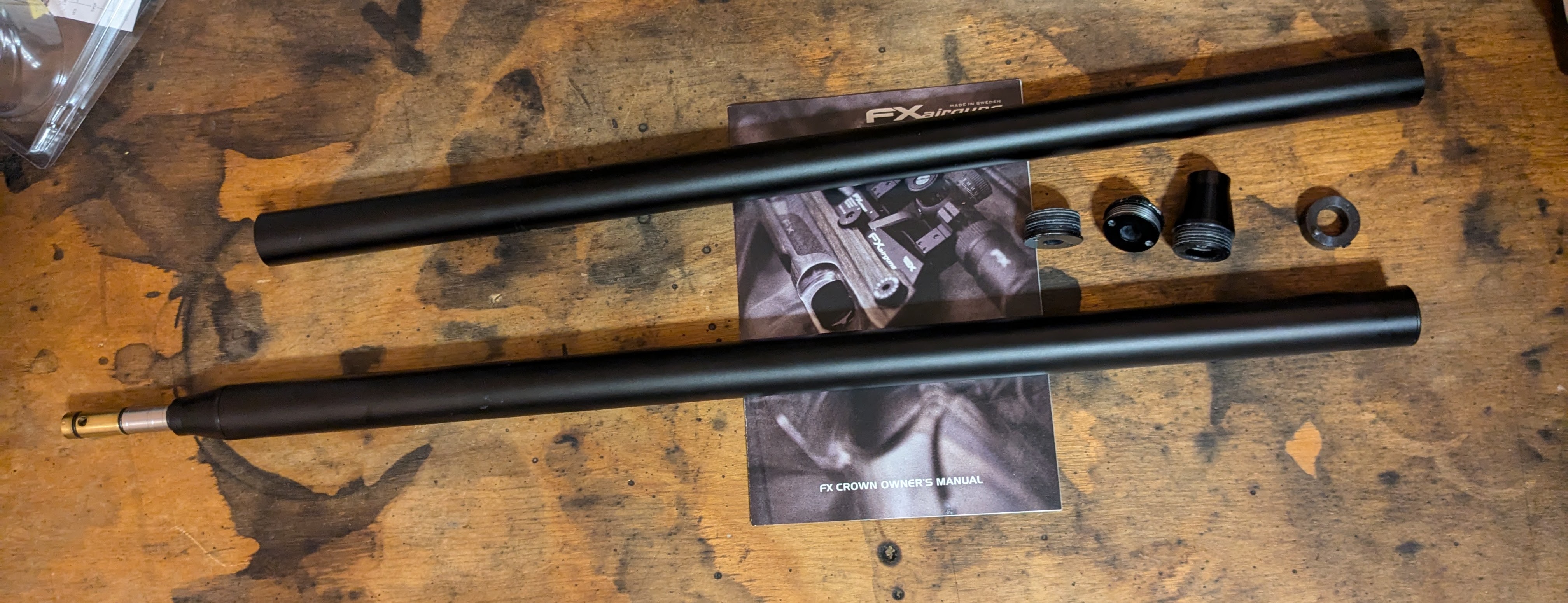

HOLA A TODOS, tengo una gran pregunta y necesito consejo. Tengo una Fx Crown MK1 en .177 mm comprada a finales de 2021. Tras su compra se utilizó de forma habitual y posteriormente se guardó en su estuche con su botella cargada a 200 bar. Así lleva casi 2 años. Lo volví a sacar de su estuche y no había aire en la botella. Lo volví a rellenar y para mi sorpresa el regulador no regula. Lo tenía a 110 bar y se puede ver como la presión del regulador va subiendo hasta igualarse a la del tanque de aire. Con un poco de agua jabonosa encontré la fuga, viene de un agujero en el lateral del cuerpo, creo que esta claro que hay que revisar el regulador o cambiarlo por uno nuevo.
Ahora viene la pregunta, cuando me estoy preparando para comprar un regulador nuevo me encuentro que hay dos modelos y no se cual debo comprar, alguien me podría ayudar y decirme cual debo comprar. Adjunto fotografías de los dos modelos de reguladores que hay disponibles y el número de serie de mi rifle. Y ya que me pongo manos a la obra, ¿sería recomendable utilizar el regulador FX original o sustituirlo por el regulador Huma, que parece funcionar mejor? ¿Cuál sería tu recomendación y por qué?

Muchas gracias y espero vuestra ayuda.

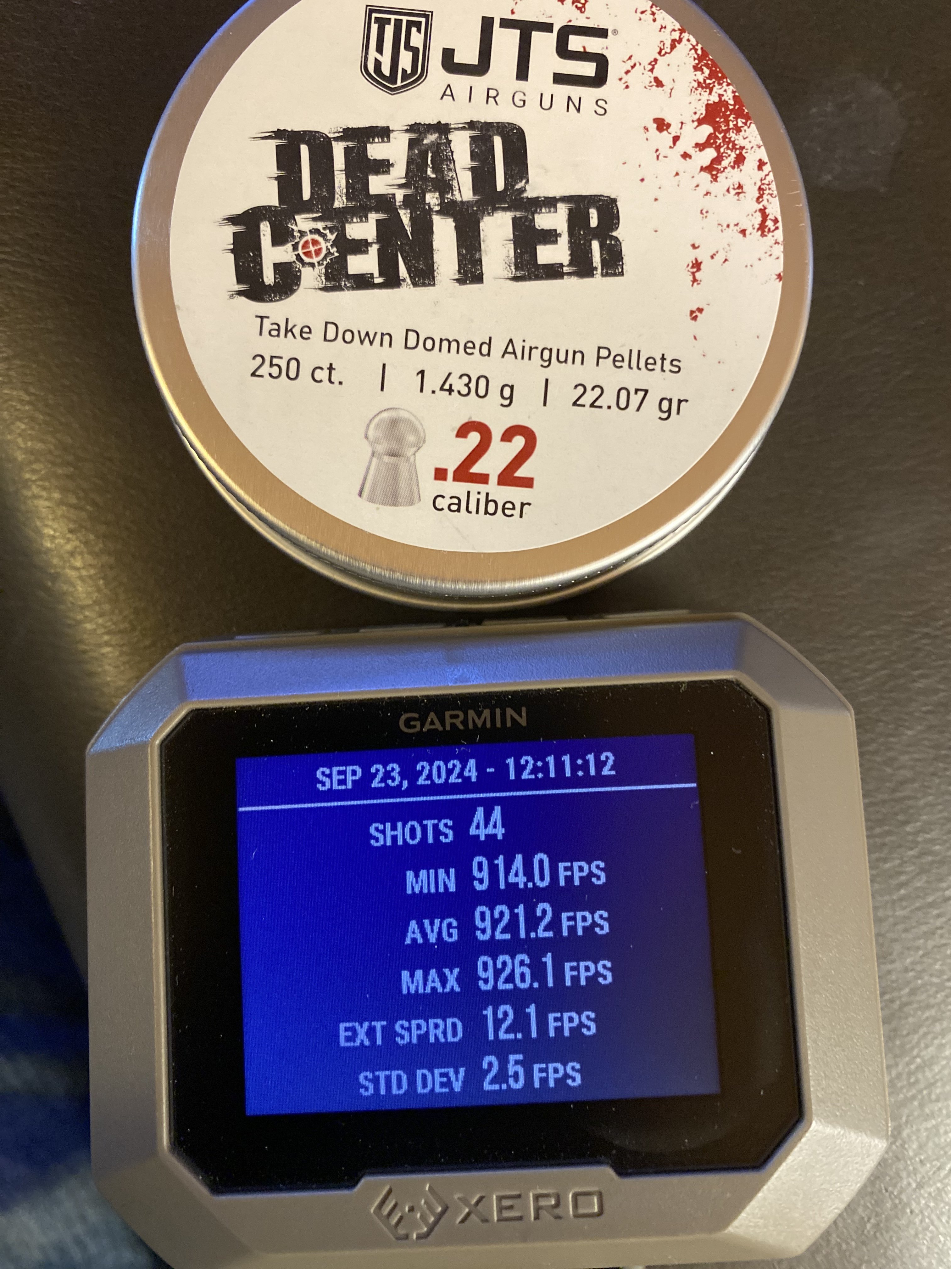

This is a quick intro to the new Skout Airguns Epoch Compact version with the optional Lothar Walther barrel. This gun shoots JTS 22.07 and JSB Redesigns (Deep Skirt) the best but also shoots slugs very well. Awesome gun! Full review coming in a few days. Thanks for watching! -Nate

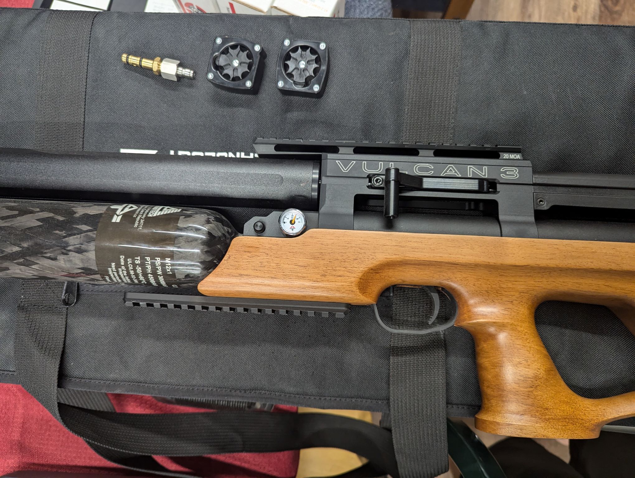

Umarex  C88 Umarex bottle adapter

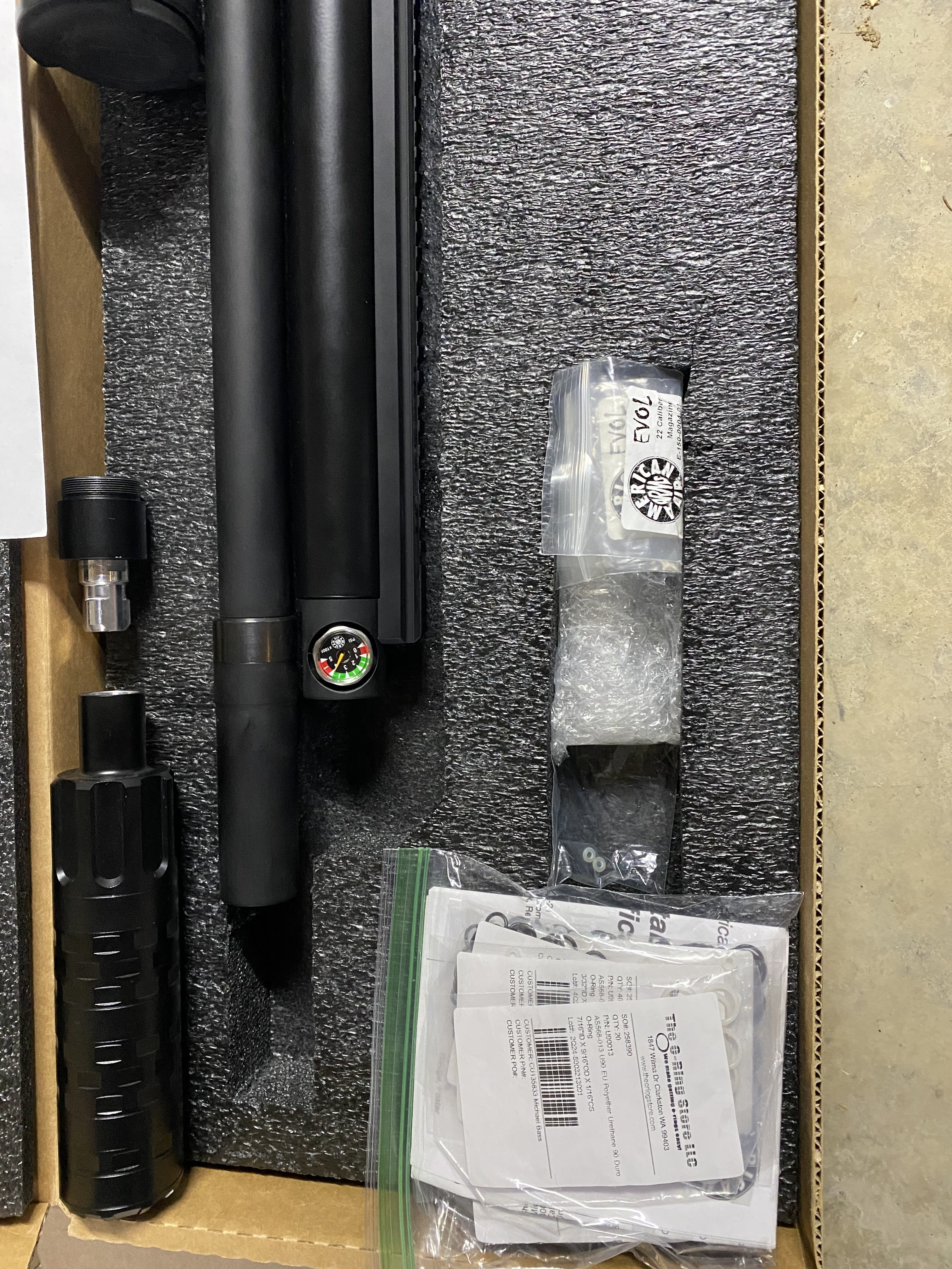

C88 machining bottle adapter, no instructions or info parts just came in a box. What is the metal shims washers for? They are different thicknesses, are they for clocking the adapter so the valve and gauge can be timed how you like? Also, can a 500cc bottle fill a 500cc bottle? Does the fill bottle have to be higher pressure than the bottle I'm trying to fill?

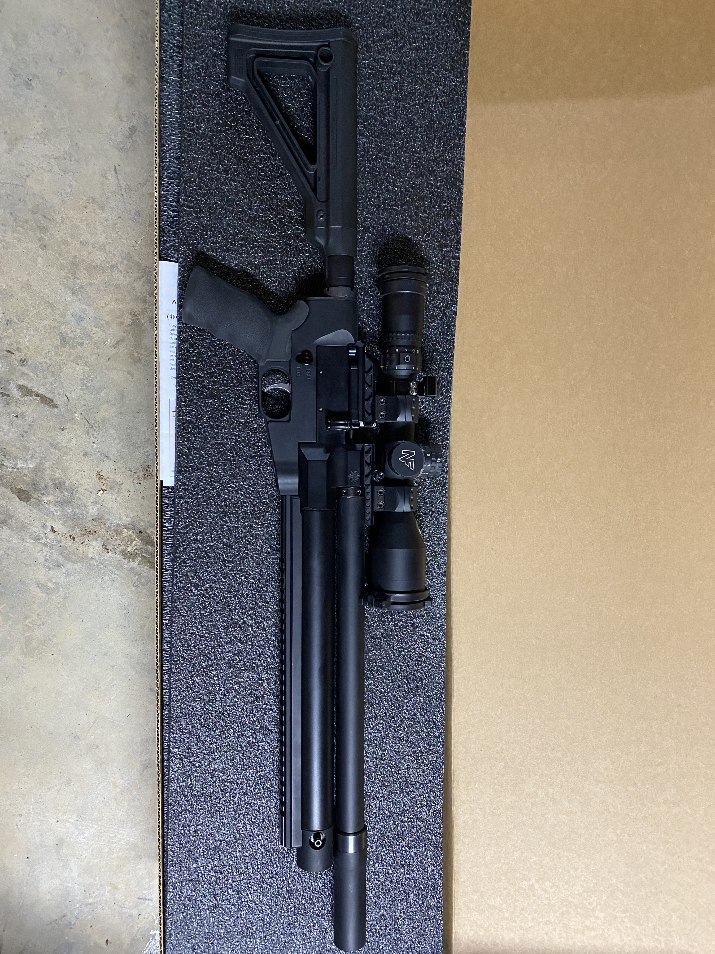

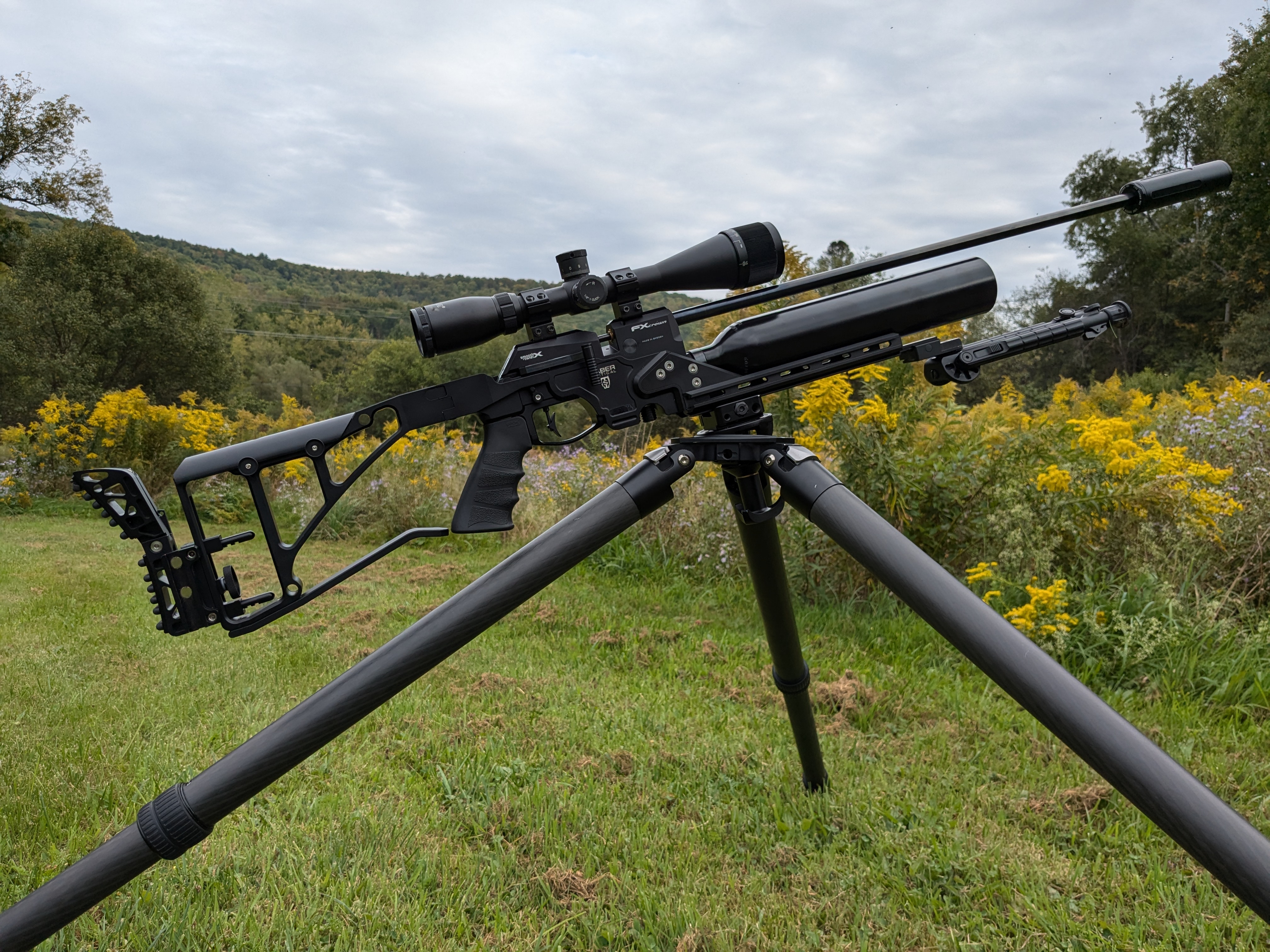

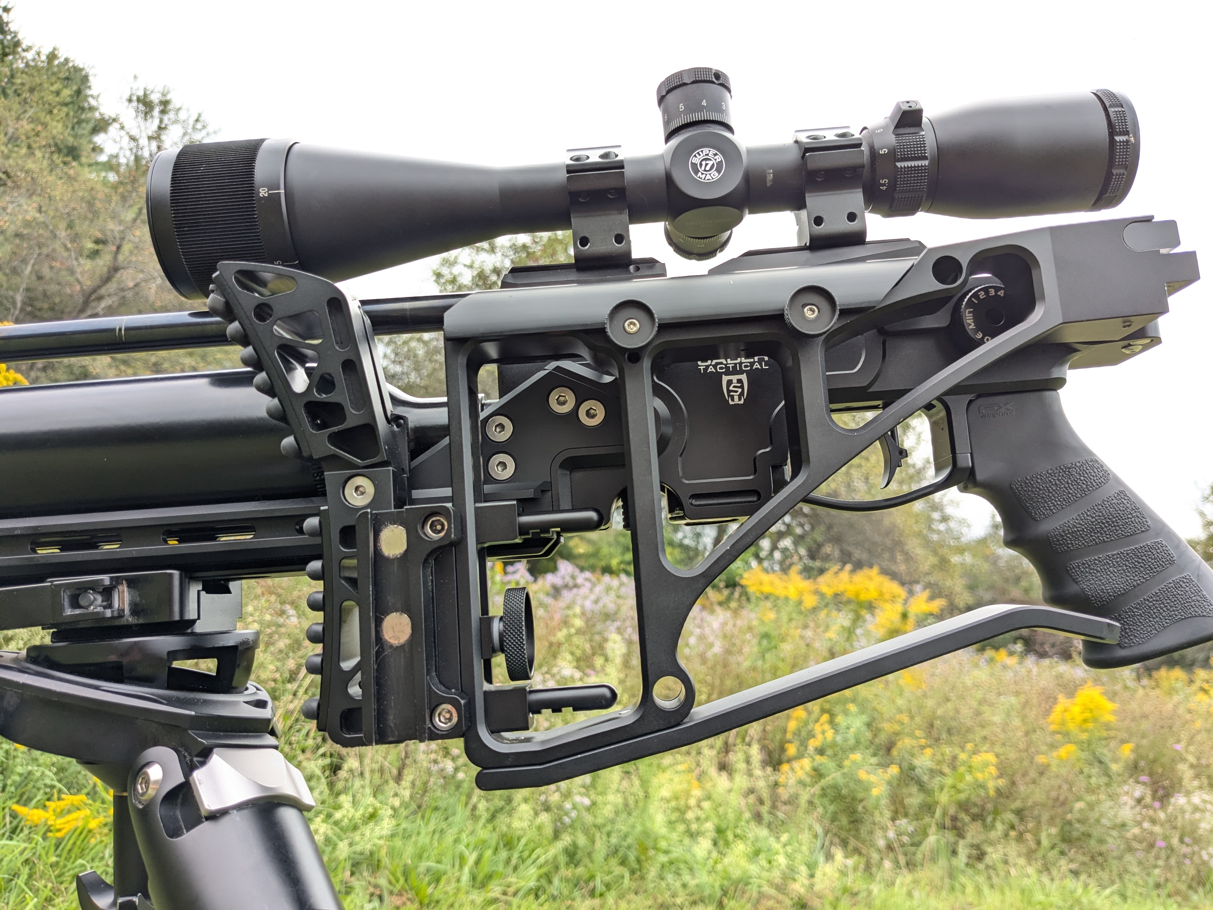

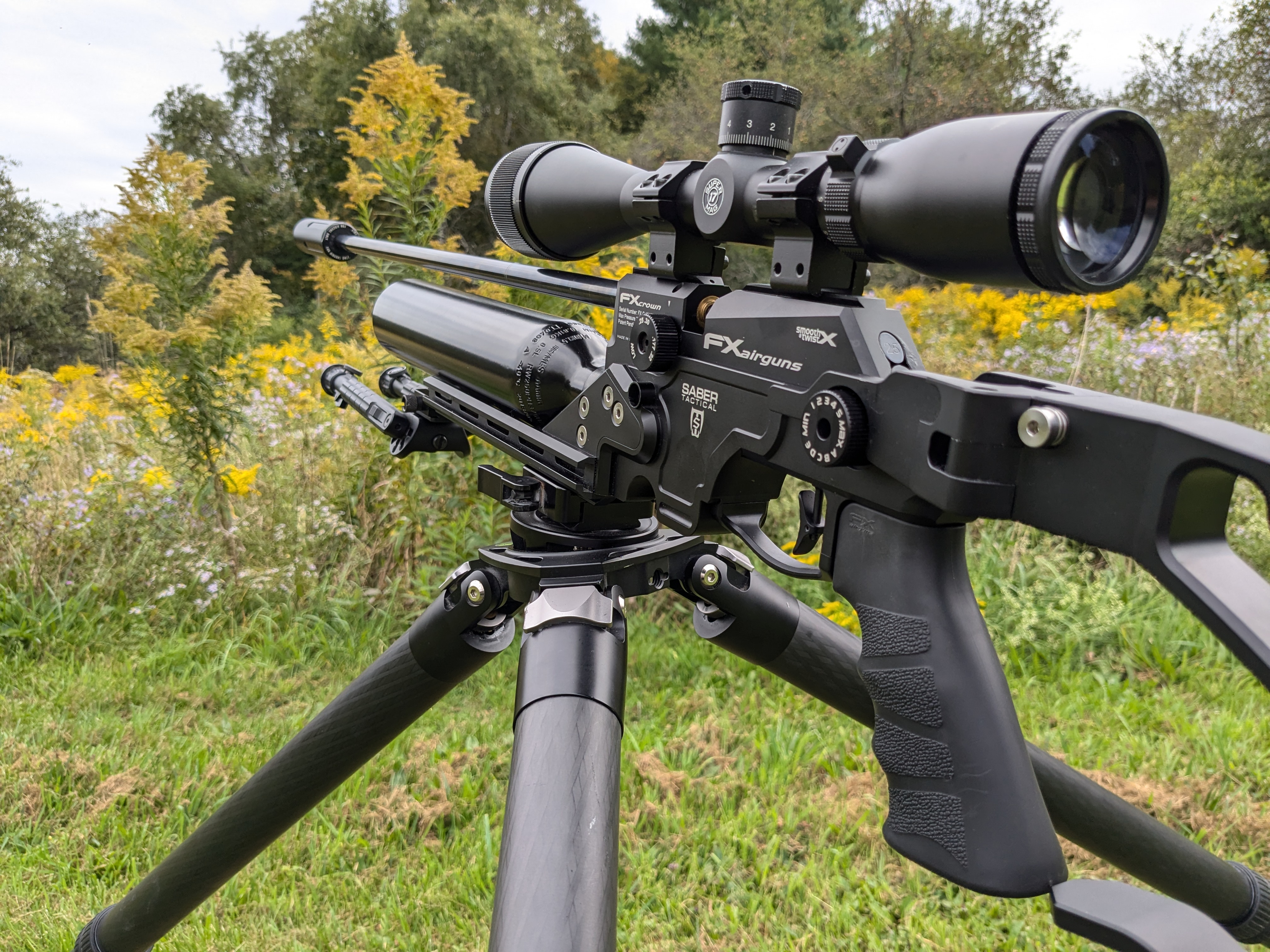

PCP Rifle  SOLD Fx Maverick aka Super Mavvy
Not your average Maverick. Benchrest ready out of box
K&L chassis
K&L KLS-3 benchrest buttstock and bagrider
K&L weaver rail ( gets bipod out a bit farther)
Sabertactical adjustable cheek rest
Sabertactical TRS top rail
Sabertactical vertical grip
Custom brass trigger shoe
Donnyfl tanto
700mm Fx 1:40 liner
Carbonfiber liner cover
Larger cocking handle from Fx Panthera
Fx impact shroud with bonded air stripper
300bar 700cc airmarksmen bottle & valve
Rifle was tuned by ken Shapley his magic worked through out the rifle. over 40 hours went into the tune. It can get 70 plus shots with a ES of 7 from a 300bar fill. The shroud has a custom air stripper that is bonded to the donnyfl tanto. Trigger is tuned for tiny first stage and a break weight of 8oz. This rifle can shoot 235 cards if you do your part. Will shoot the Jsb 44.8 on high power wheel setting 960fps will also sling 50gn Aeas as well if not better. It breaks my heart to list this rifle as i love it. But im moving to a new brand for benchrest. To build this rifle you will be well over 3k dollars.
4 mags 3 stock 1 aftermarket
I will consider trades for
Corbin slug press and swages
Raw 22 or 25 caliber in Master piece arms chassis
Epic Airguns Two Tactical Long With Carbon fiber bottle 22 or 25
Scope, rings, brass weights, bipod not part of sale. Will ship in fx hard case.
2000.00 buyer pays actual shipping cost CONUS only i use pirate ship so it won't be crazy.

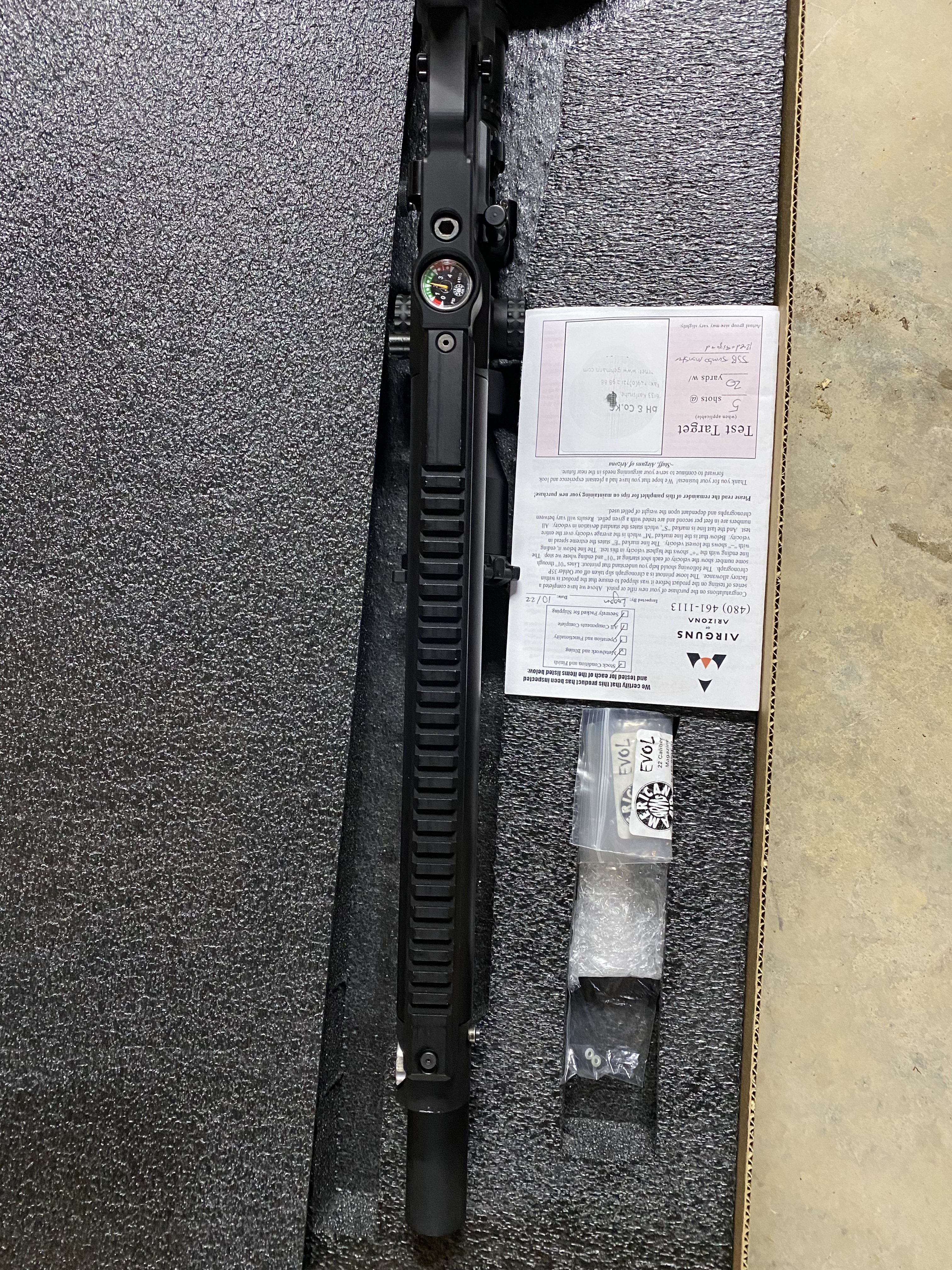

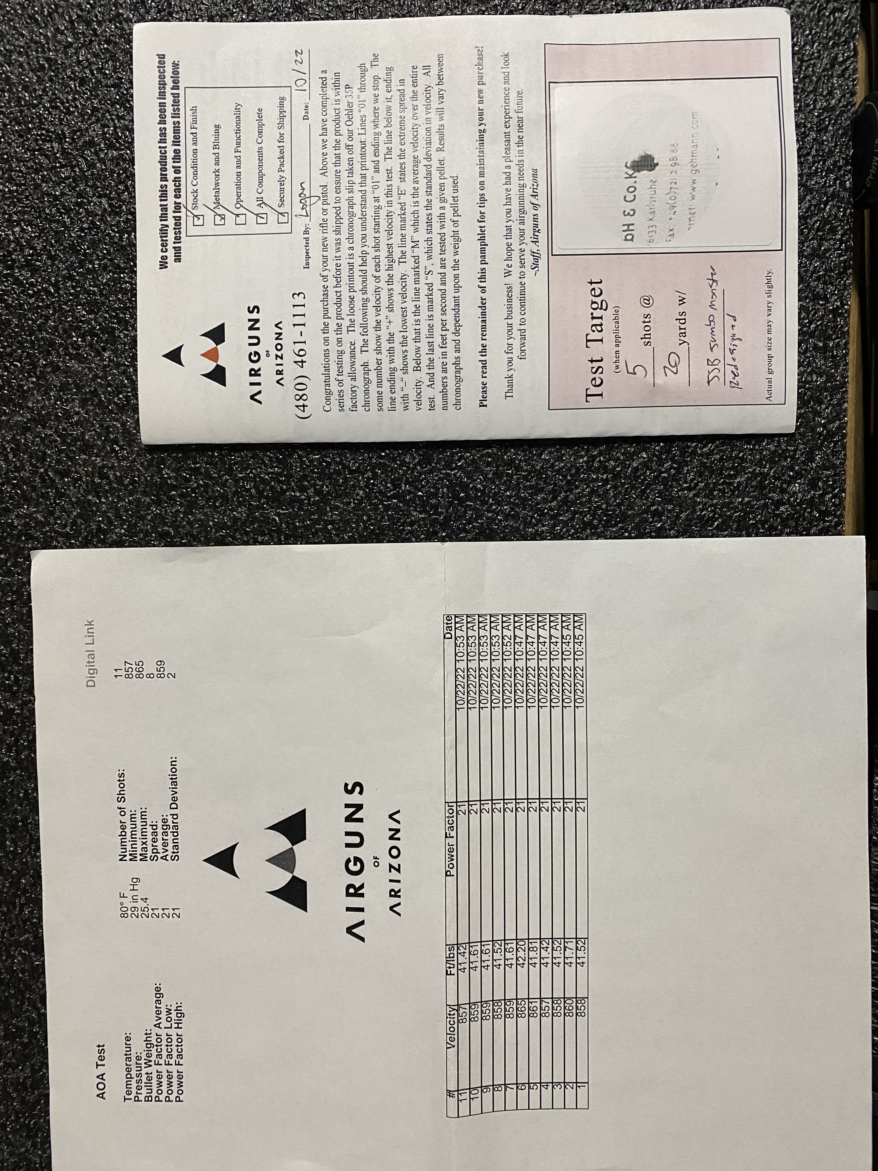

PCP Rifle  NLA .20 AirForce Talon SS with bipod - virtually new
I purchased this rifle just to "play with." After about 150 pellets & only receiving it this past Monday, having five very "high end" air rifles in my vault, I decided it just isn't for me. I paid Pyramid Air $800 for the rifle and bipod. SELLING FOR $550 SHIPPED WITHIN THE CONTINENTAL US.
If you want the Athlon Argos 6-24 Mil FFP scope, also new, add $250. Price is firm. Paymemt via Venmo or PayPal.
There is absolutely nothing wrong with it. Will come in factory packaging with all manuals, etc.
