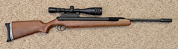

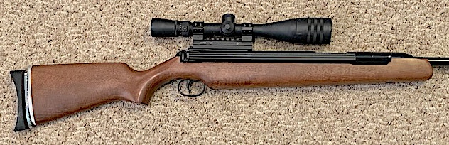

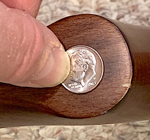

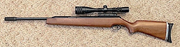

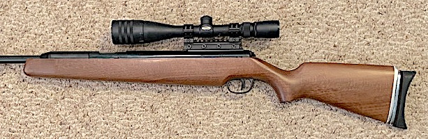

Traditional Rifle  SOLD MAKE OFFER. RWS 34 Meistershutze PRO Compact w/ scope
RWS / Diana 34 Compact Professional Meisterechutze .177 T-06 trigger. The rifle is in excellent condition. Only trouble is it is difficult to cock for an old man even with the oversized cocking aid. Comes with the original RWS 3X9 AO scope. I bought it to use for piston field target.
Make offer. Need to raise $ for a pistol.
Asking $300 shipped or offer.
