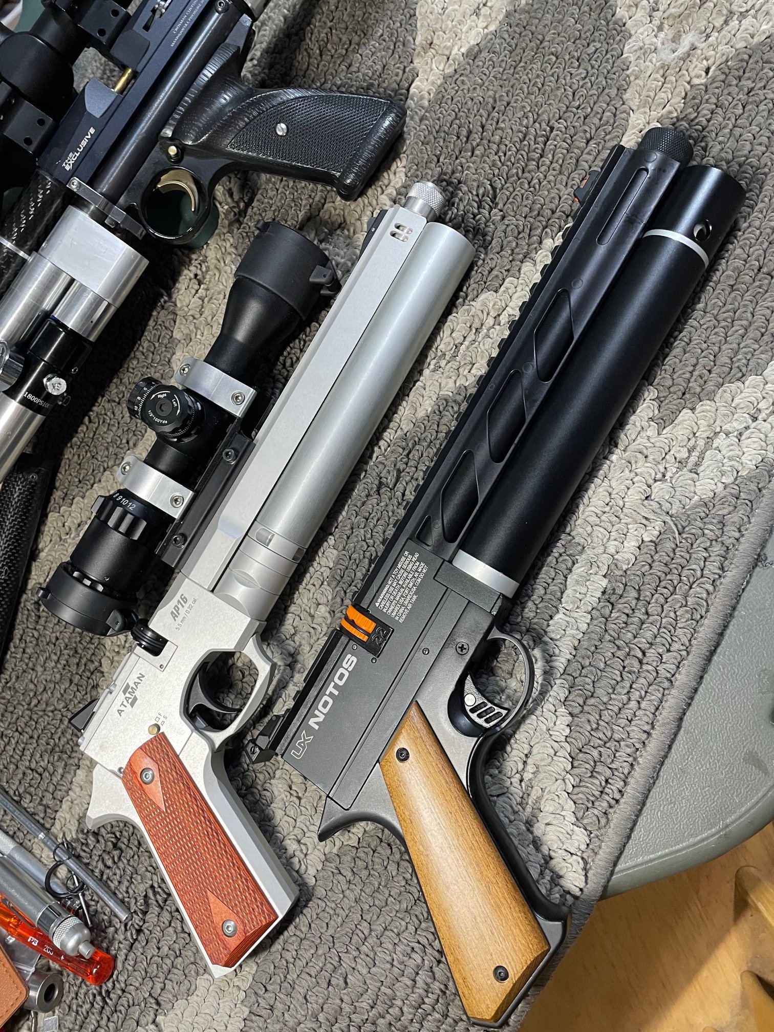

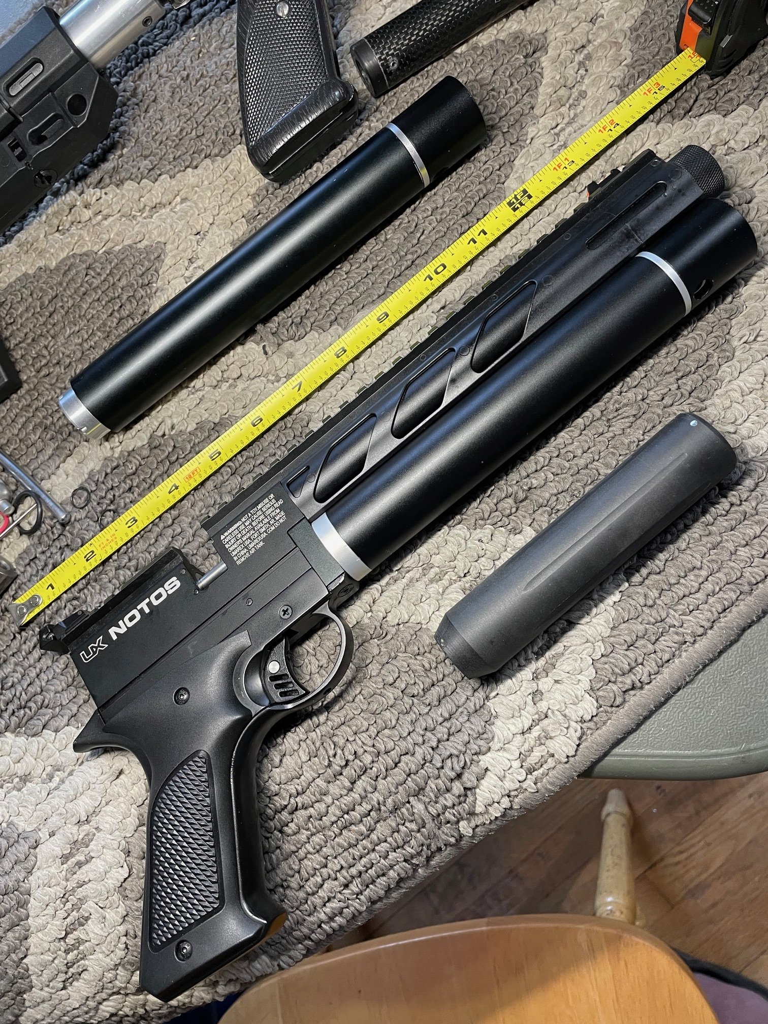

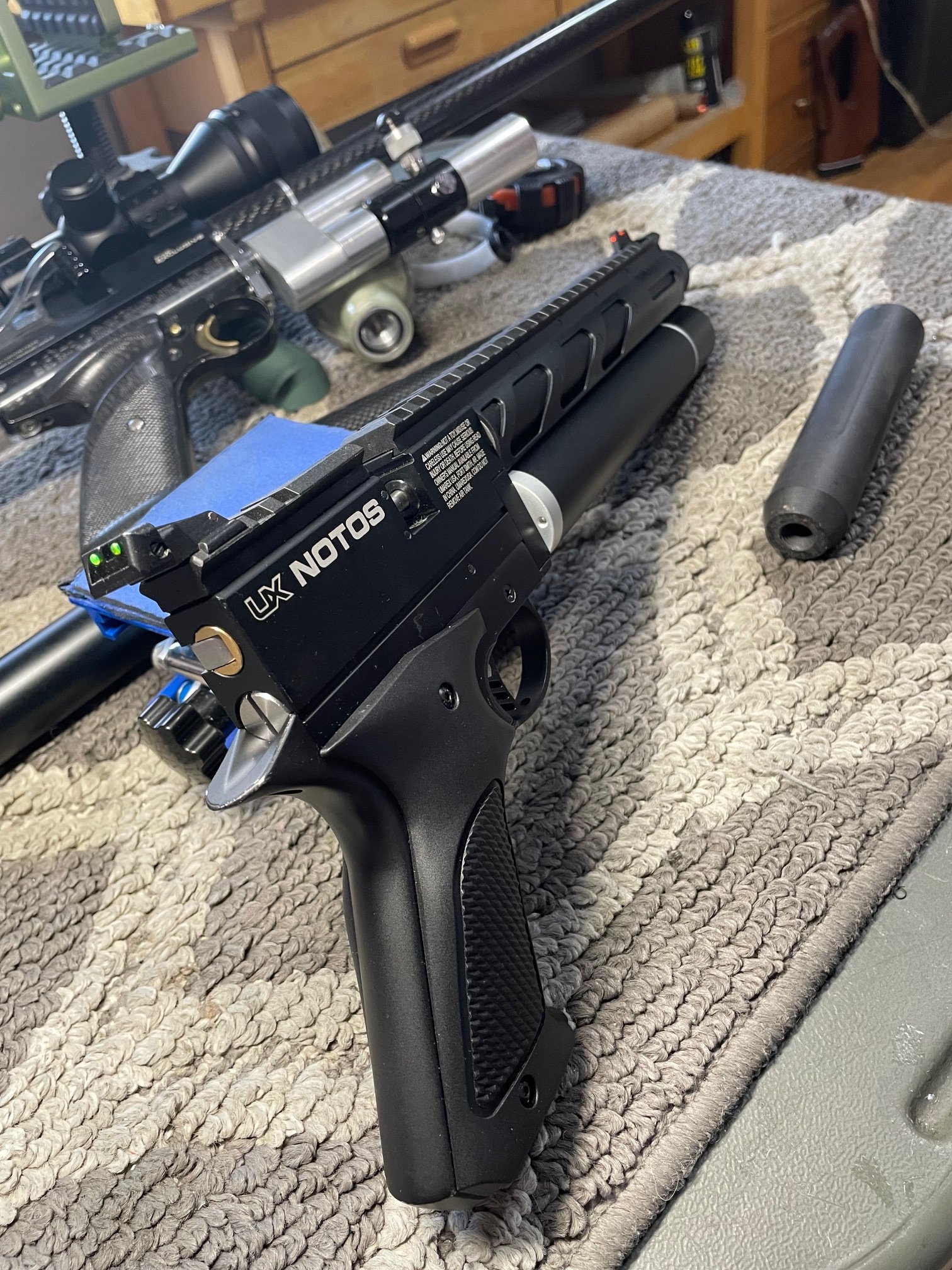

So you have the EVOL/Epic situation. FX DRS classic with Snowpeak M30 and Remington Vought. Notos and Jet. Now Hatsan has made a copy of the Airmaks Katran. This was the only way I found it on the UK forum.
I know imitation is the highest form of flattery but it seems they just aren't trying anymore. I know there are only so many ways to put an air reservoir, barrel and valve together.
