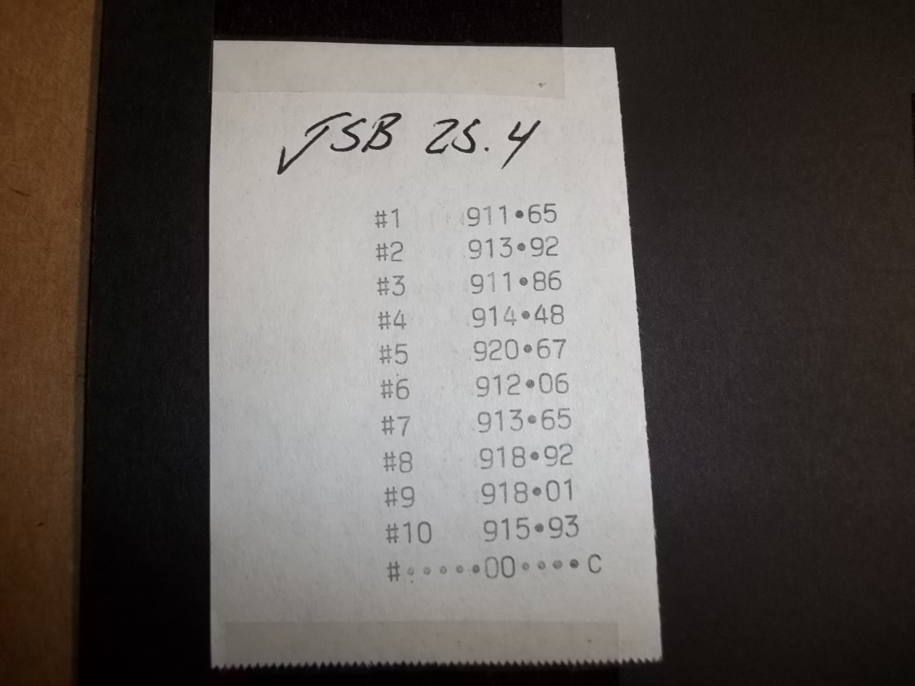

Velocity: 5 shots over the chrono (will test more) show very consistent readings with JSB 8.44gr. ES of 4fps with a SD of 1.5fps. Two thumbs up if that remains consistent. I'll be very happy with 12 and 3 over a 20 shot string though.
