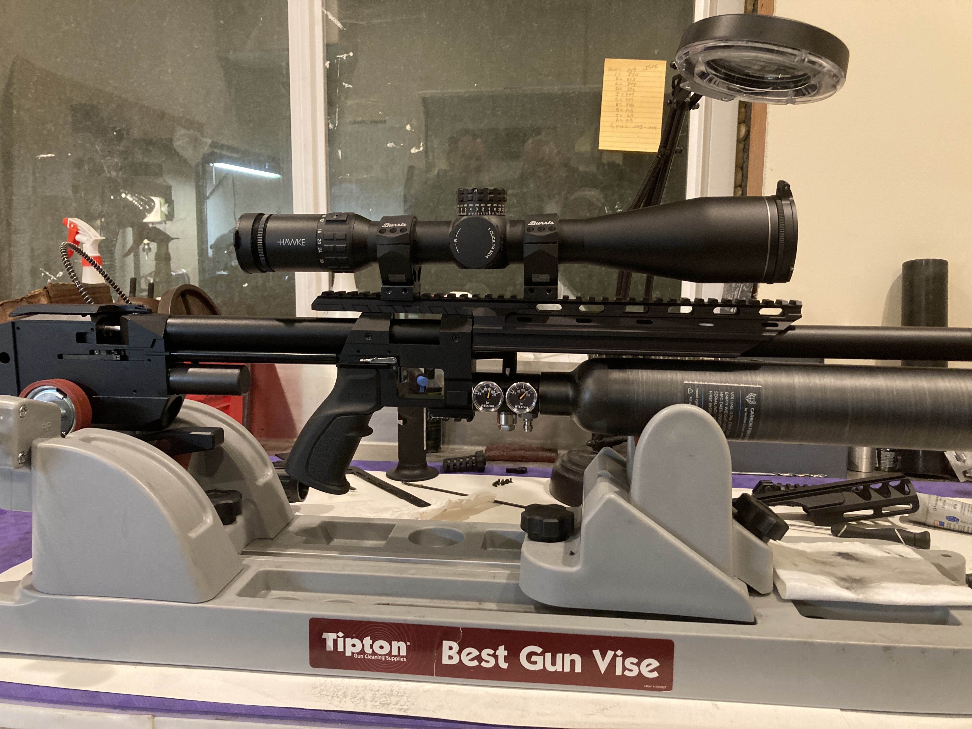

SOLD Kral Mega huma regulated 22 rifle
280cc huma regulated tube, set to 120 bar with dual manometers
I usually fill to 250 bar.
84 shots at 870 with crosman premiers or 850 with hades.
Shrouded 16" np03 barrel with air stripper and baffles
Has the multi caliber bolt installed comes with the 177 probe
Biathlon cocking lever
Westhunter 4-16x44 SFP SF scope included
2 mags, fill probe and o-rings, single shot 22 tray
Selling to fund other toys and I'm not a synthetic stock fan
$350 shipped CONUS
PayPal preferred or PMO
