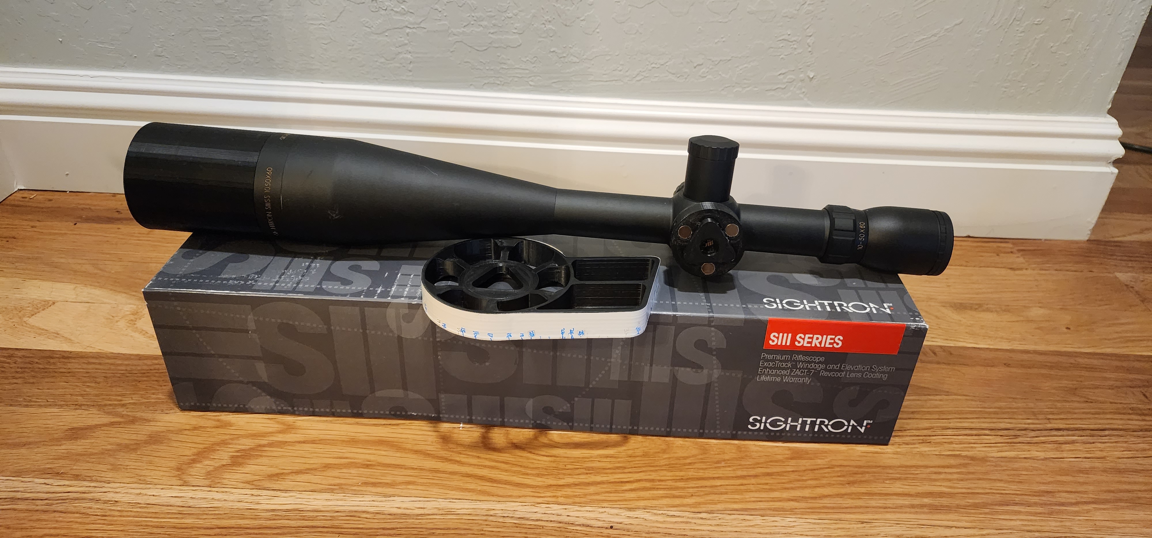

Optics  SOLD Sightron Siii 10-50x60 Mil-Dot w/ custom wheel and Sunshade
Selling a very lightly used Siii 10-50x60.
It has the mil dot reticle and it focuses to 11y. I've never had a problem with that, and miss very few targets because of it.
It has a custom Hatchet style magnetic wheel. It pops on and off easily when wanted, and can only go on one way.
The hatchet design is purposeful, the ramp from the main wheel up to the blade of the hatchet has always been in my zero range. If it's on the blade you will have very visible numbers and a good distance between them due to the near 8" equivalent diameter.
The sunshade is made as a press fit into the objective. I can include the factory shade as well, but the 3d shade is nearly 1/4 the weight of the factory shade.
$725 plus shipping
Have any Field Target guns you'd be willing to trade for it?
(NINE16) Five31-2349
Or
camsprecisionairguns(@)gmail.com

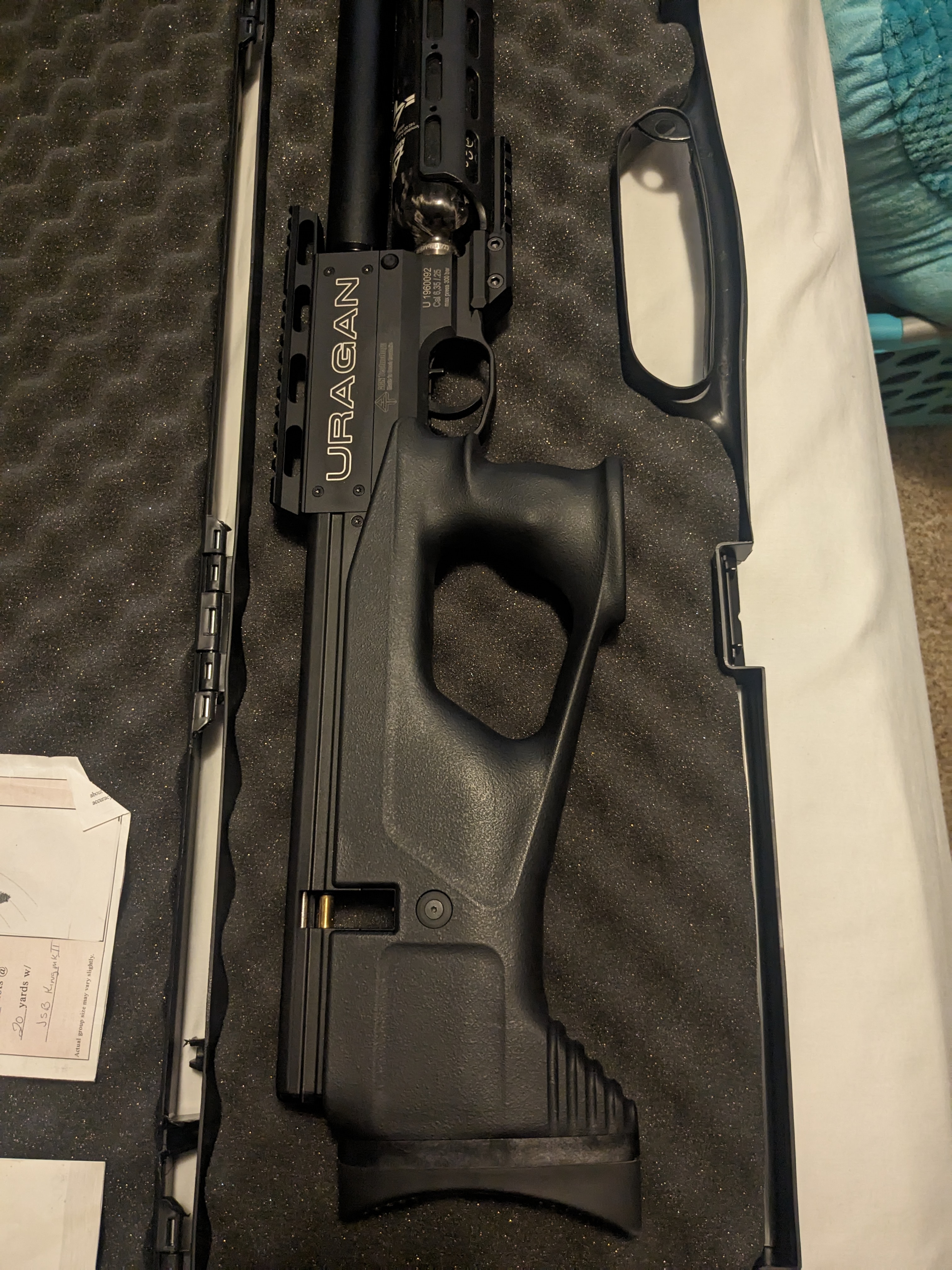

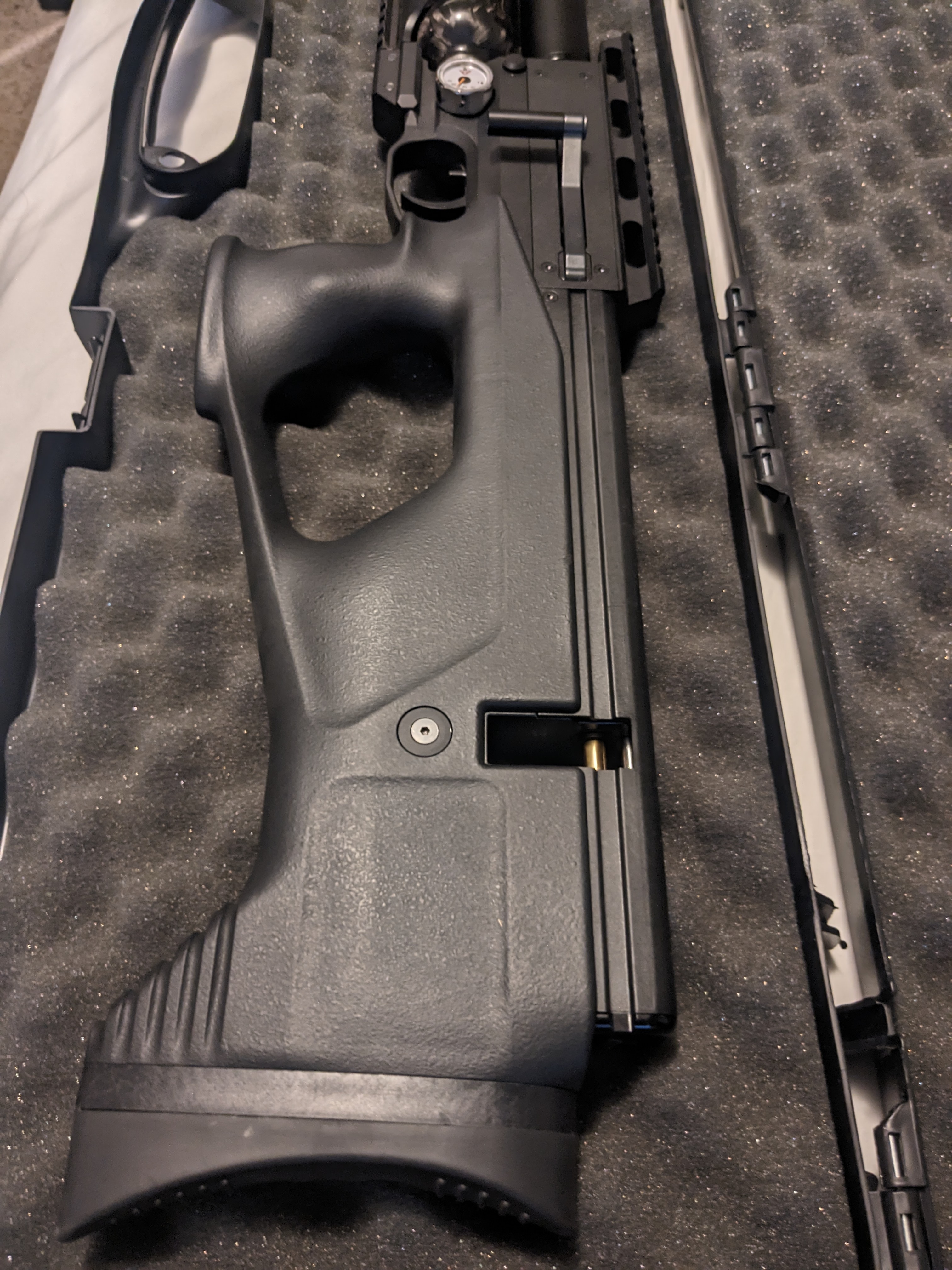

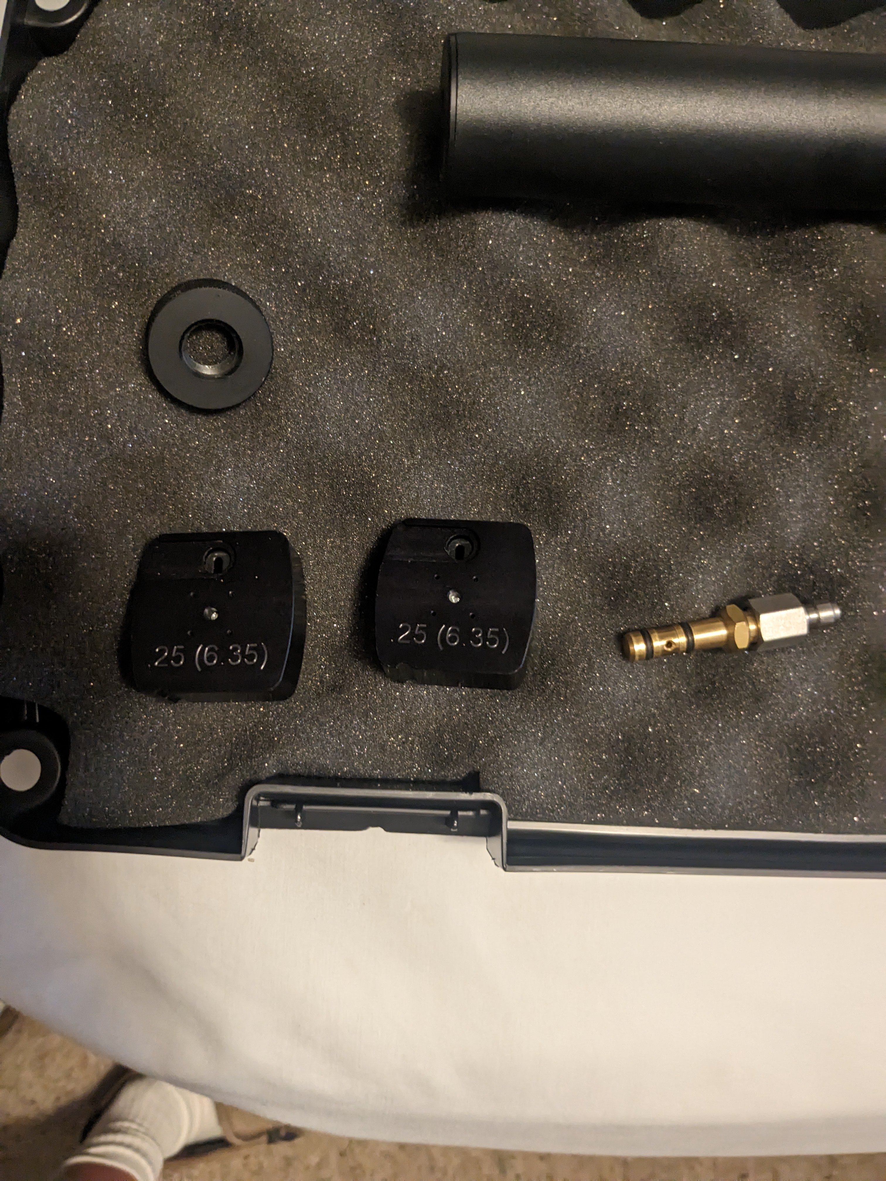

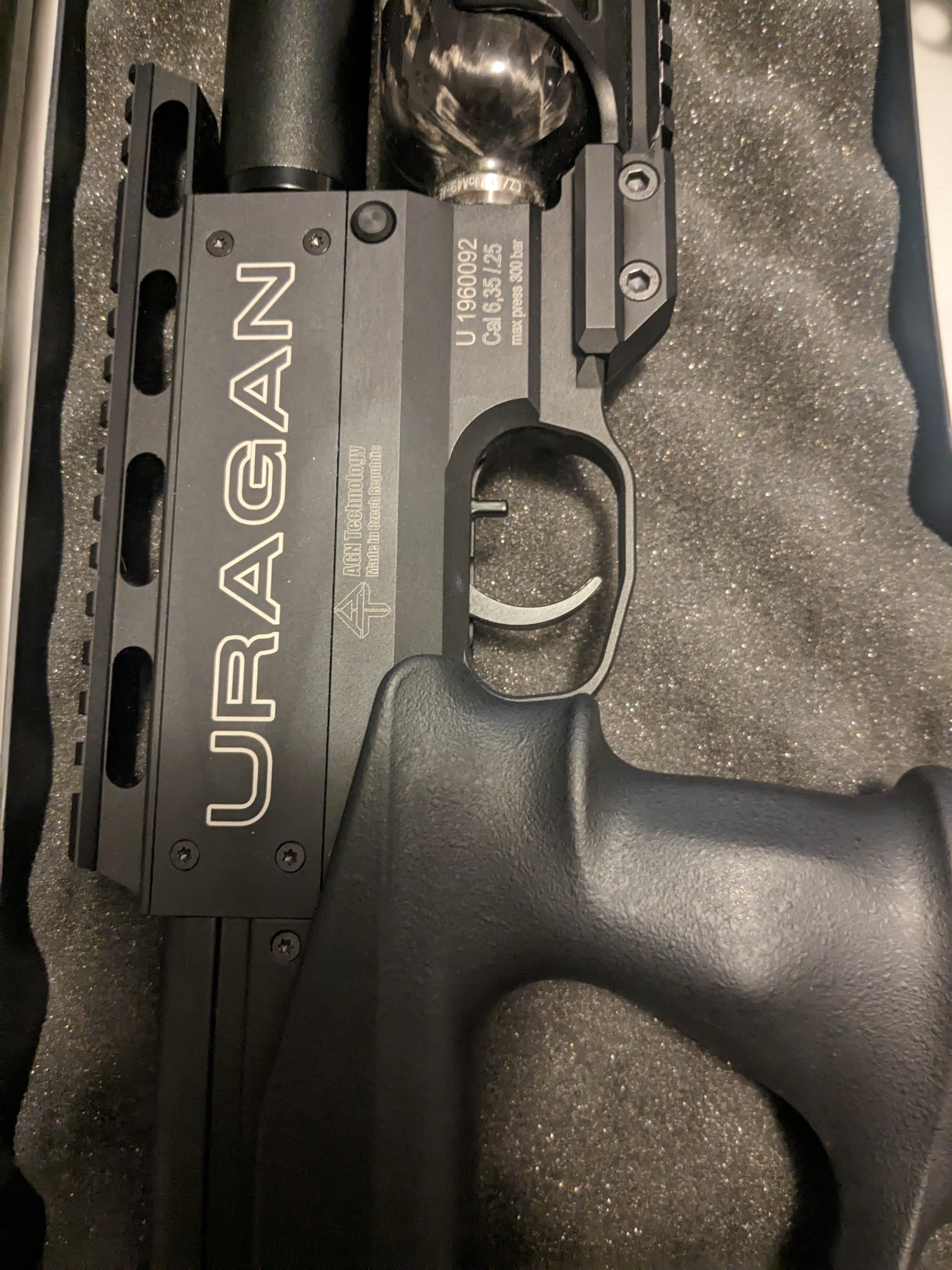

PCP Rifle  SOLD Uragan 1 in .25 $850 shipped
I sold this Uragan a few weeks ago but $ deal fell through so he shipped it back. Condition is excellent but manual & thread protector are now missing & priced accordingly. If he finds & ships me those items I will then ship to you free of charge. AoA test sheet included.PXL_20230702_035711791.MP.jpgPXL_20230702_040025528.jpgPXL_20230702_035948160.jpgPXL_20230702_035853671.jpgPXL_20230702_040309300.jpgPXL_20230702_040855000.jpg
Holds air & no issues & typical CZ goodness for accuracy.
$850. shipped in the USA
Will be shipped in hard case
Joe

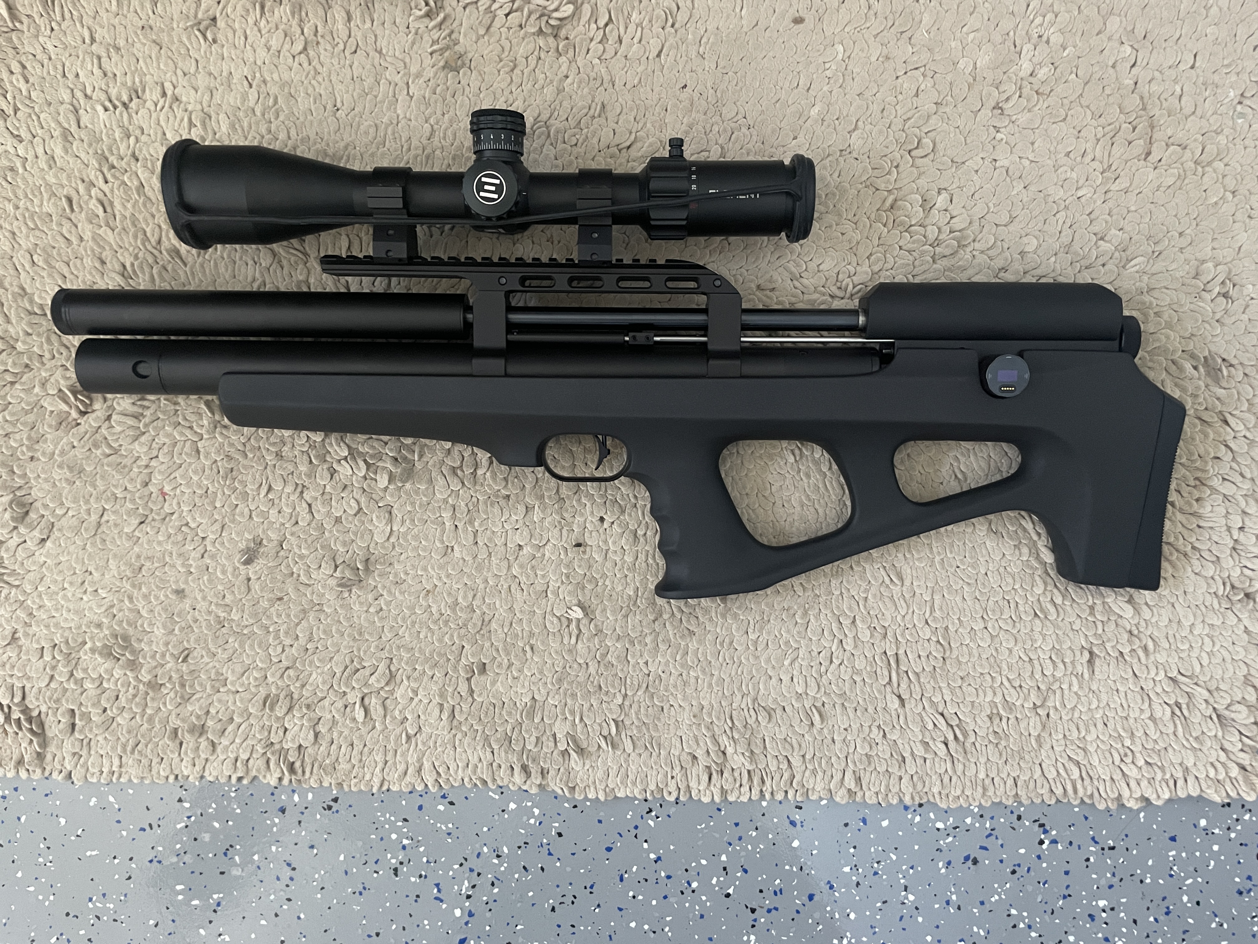

FX  Does the FX Panthera make waiting for a Crown MK3 kind of a moot point?
I really enjoy my Crown MK2 .22 in the Saber Tactical chassis. I’ve been waiting for a MK3 version with some of the latest FX goodies. Very recently I’ve begun looking at all that the Panthera has to offer. Then it occurred to me that a Panthera with a front bottle added and the new K&L arca rail installed is basically an MK3 Crown with all the latest FX goodies. Adding a 480cc bottle in addition to the 300cc in the rear makes for a lot of shots. You get the much larger plenum, the cool front facing air gauges and the really nice fine hammer spring tuning set-up. Am I missing something or does the Panthera with its many options make the idea of a Crown MK3 a bit of a moot point? Thanks,

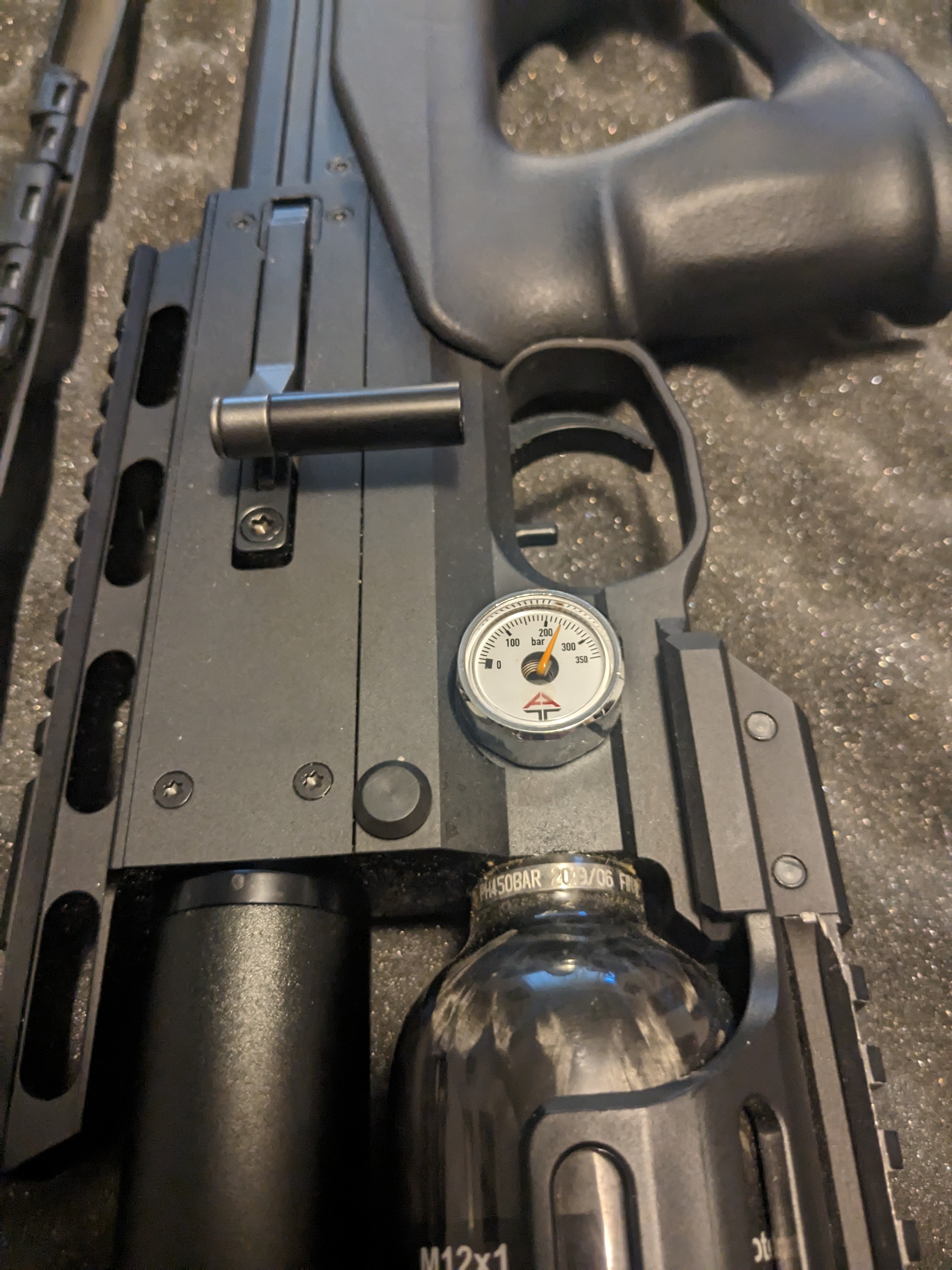

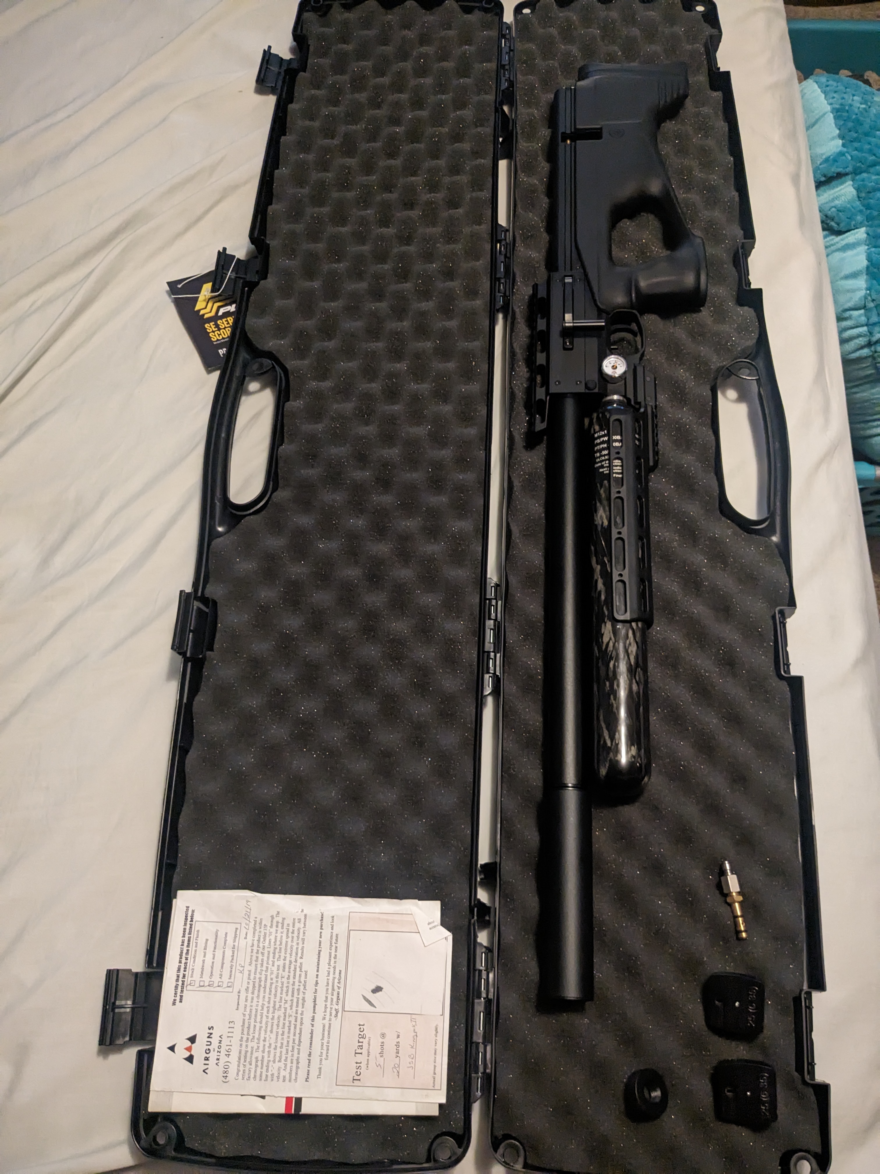

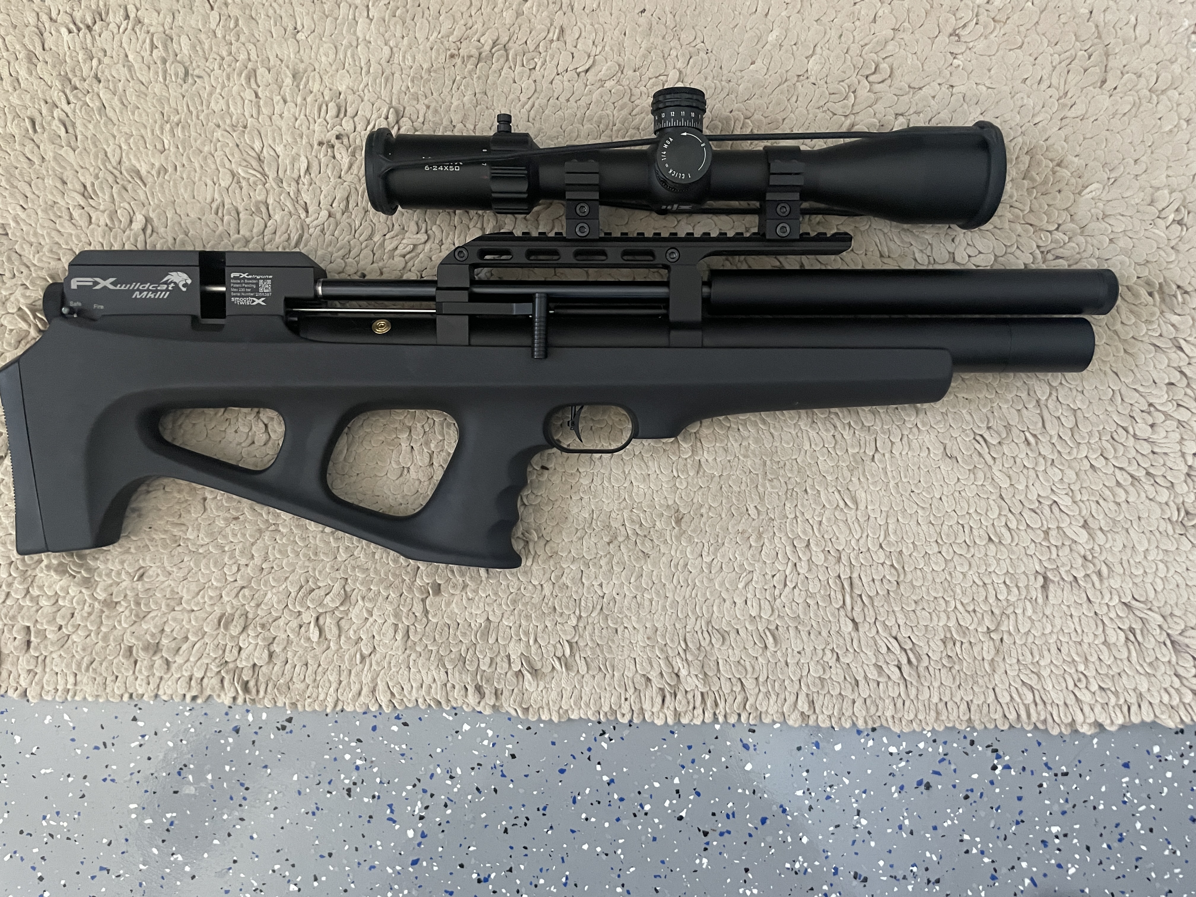

PCP Rifle  SOLD FX Wildcat MK III Compact (22 cal) - One (1) Owner
I am the original owner and purchased it from Utah Airguns (UAG) in December ’21
No modifications other than digital gauge and carbon barrel liner
It is currently tuned to shoot Hades @ 860 FPS and shoots with single-hole accuracy at 25 yards.
Includes:
  • Hard case
  • (1) magazine
  • Fill probe w/ compressor fitting
  • Original gauge
  • Digital gauge charging cord w/ screen protectors and cleaning clothes
  • Owners manual w/ test card from UAG
Scope and mounts NOT included
The asking price is $1,185 with payment preferably through Zelle or Venmo.

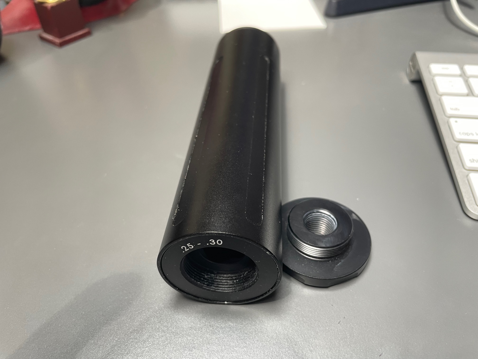

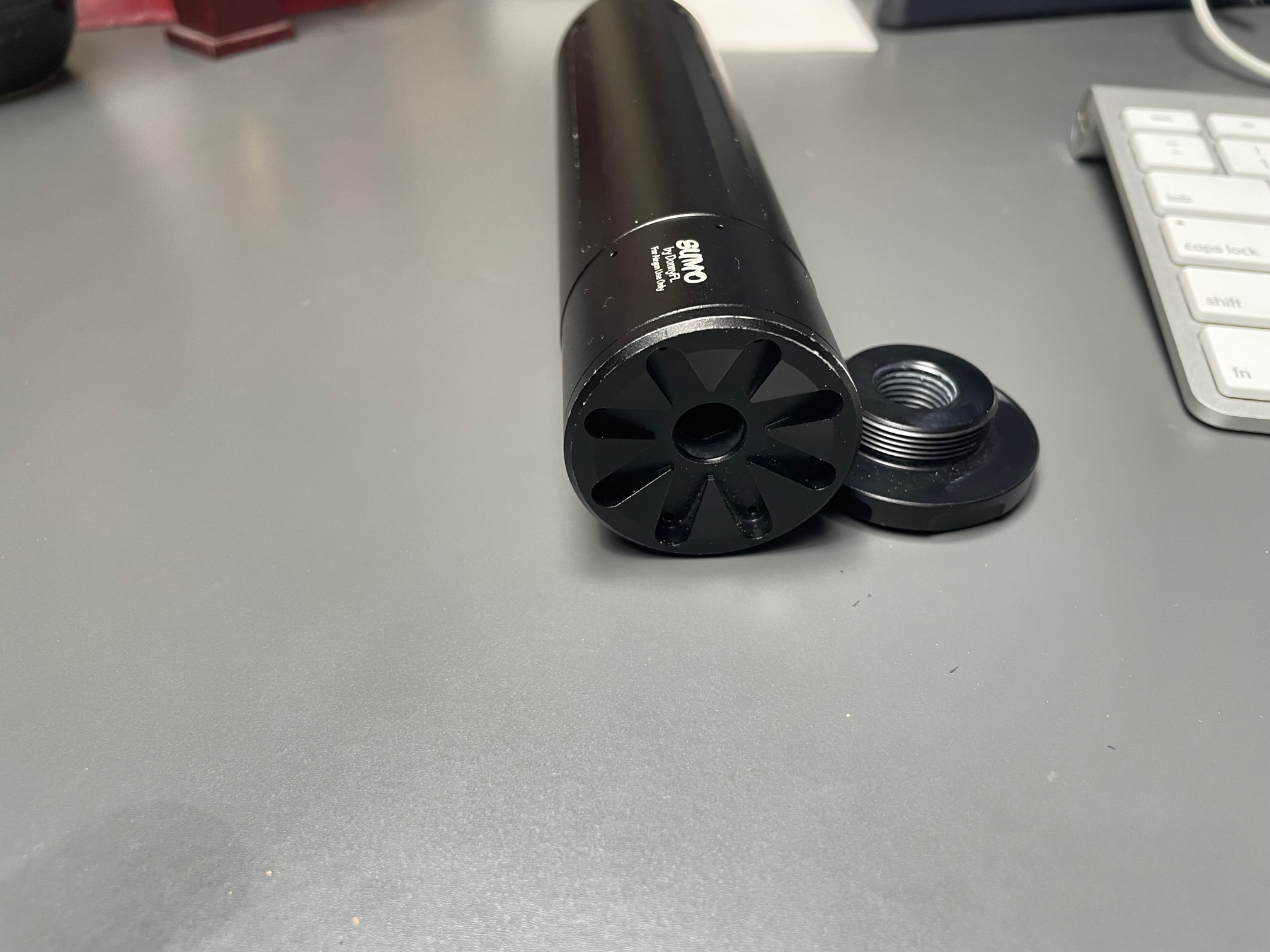

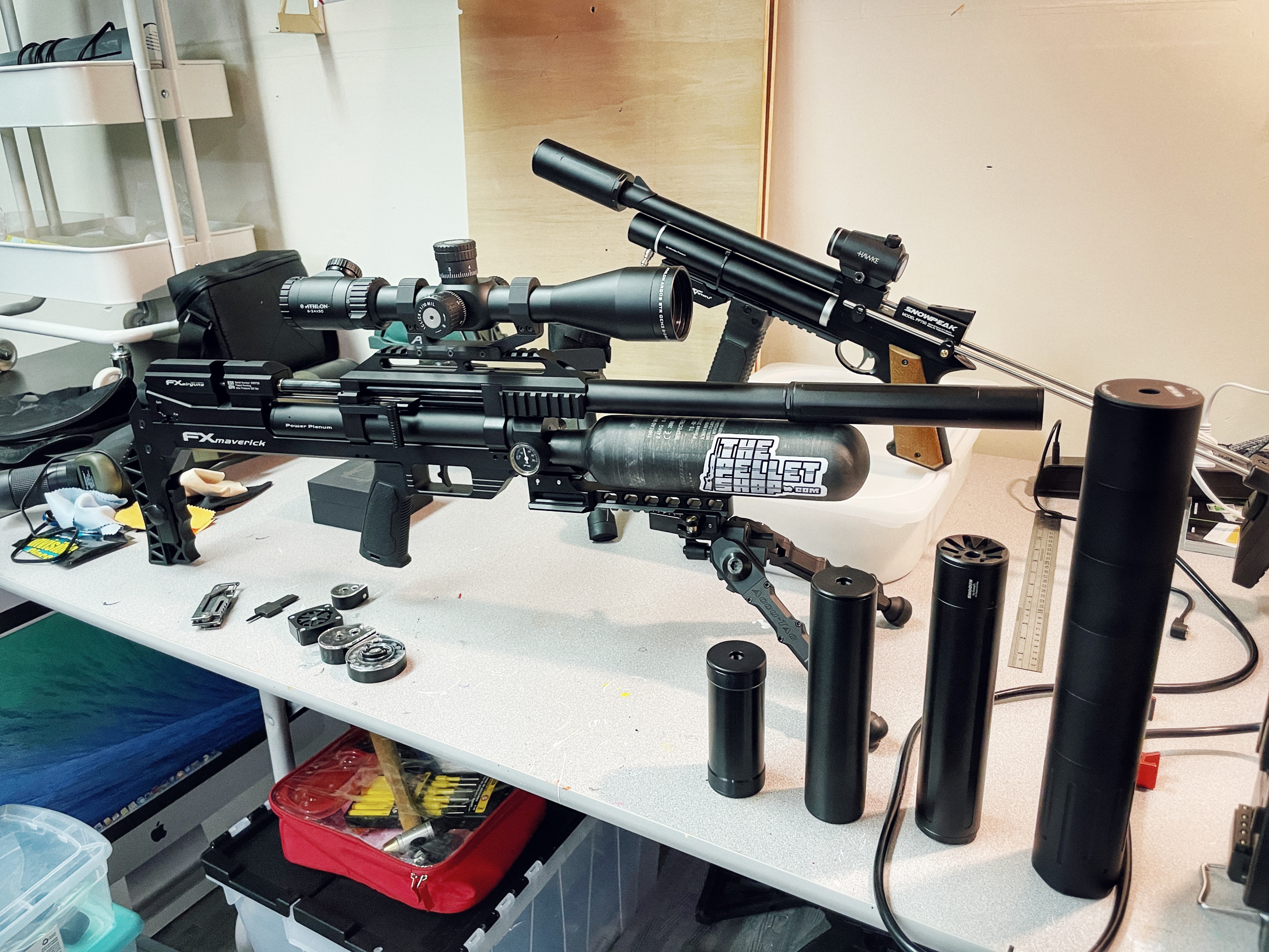

how I got my maverick scary quiet by accident
always in pursuit of silence so I can play in my yard like a ninja. anyways I literally have like 6-7 different suppressors and have tried them all on many different models and brands etc and I have finally achieve what I believe to be the pinnacle of silence. 25 more quiet than any 177 or 22 I've own even, on par with my 22 pp750 pushing 15fpe, maverick is 160/112 hammer 0, 26g @ 715fps about 30fpe or so.
so here's the back story and its kind of funny. I recently purchased my maverick from thepelletshop.com. had the bright idea of putting a 480cc bottle for poop and giggles, so I needed a skinny moderator. it was either hugget sniper or DFL koi and went with the koi because it was a little longer and cheaper. so pretty straightforward you would think
but the reason it is scary quiet is get this... the koi is 177/22 caliber! no issues with clipping. and even though DFL has told me directly that larger volume is what suppresses more I've found this is not always the case. because my huma mod40 works better than my mod50 on my AEA SF .30. so with this tid bit of info I took a bit of a gamble got the koi in a smaller caliber,. they even called me to confirm that's what I wanted. works like a charm!
