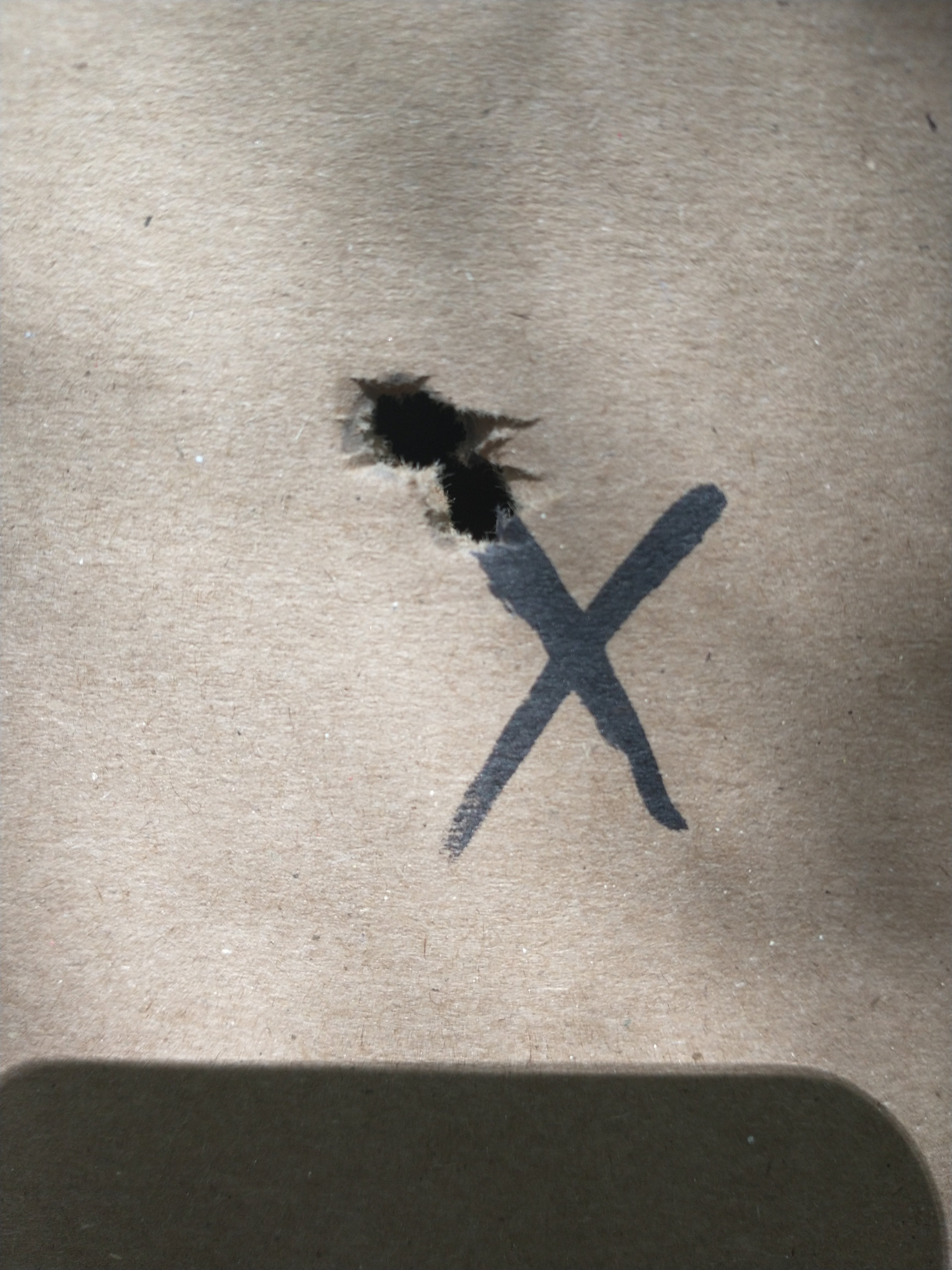

We my son and I are literally shooting orange tic tacs hot glued to wooden skewer sticks. Purchased from dollar store
Started at about 25 yrds. To easy. 50 yrds to easy moved to 100 yrds just out right fun. Takes 2-3 shots to hit at the 100 yrd distance. Best air gun purchase to date.
Wow...can't believe how much harder 50m is over 50y.

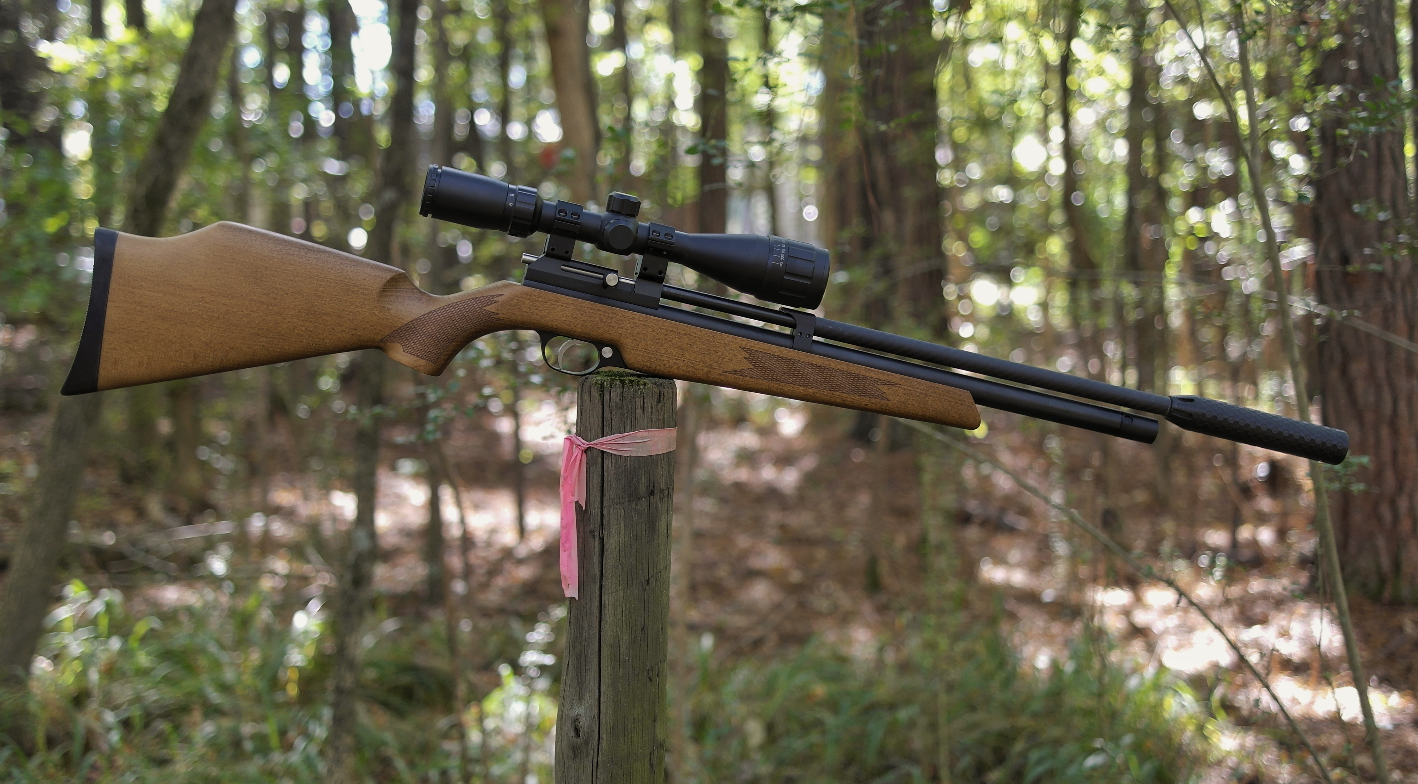

Printed this dovetail rail on my resin printer.
The attachment for the sling is off the shelf.
The rail attachment epoxies into place. It could be modified to use screws and a screw plate.
The front sling mount is off the shelf as well.
The rifle is tuned to shoot JSB 15.89 . 20 caliber at 850 fps for 25 fpe. It is very flat shooting. The LASER is mounted for the close shots with zero at about 8 yards. POI with the LASER is +/- an inch between 3 and 18 yards. I'll write more about this rifle later.
