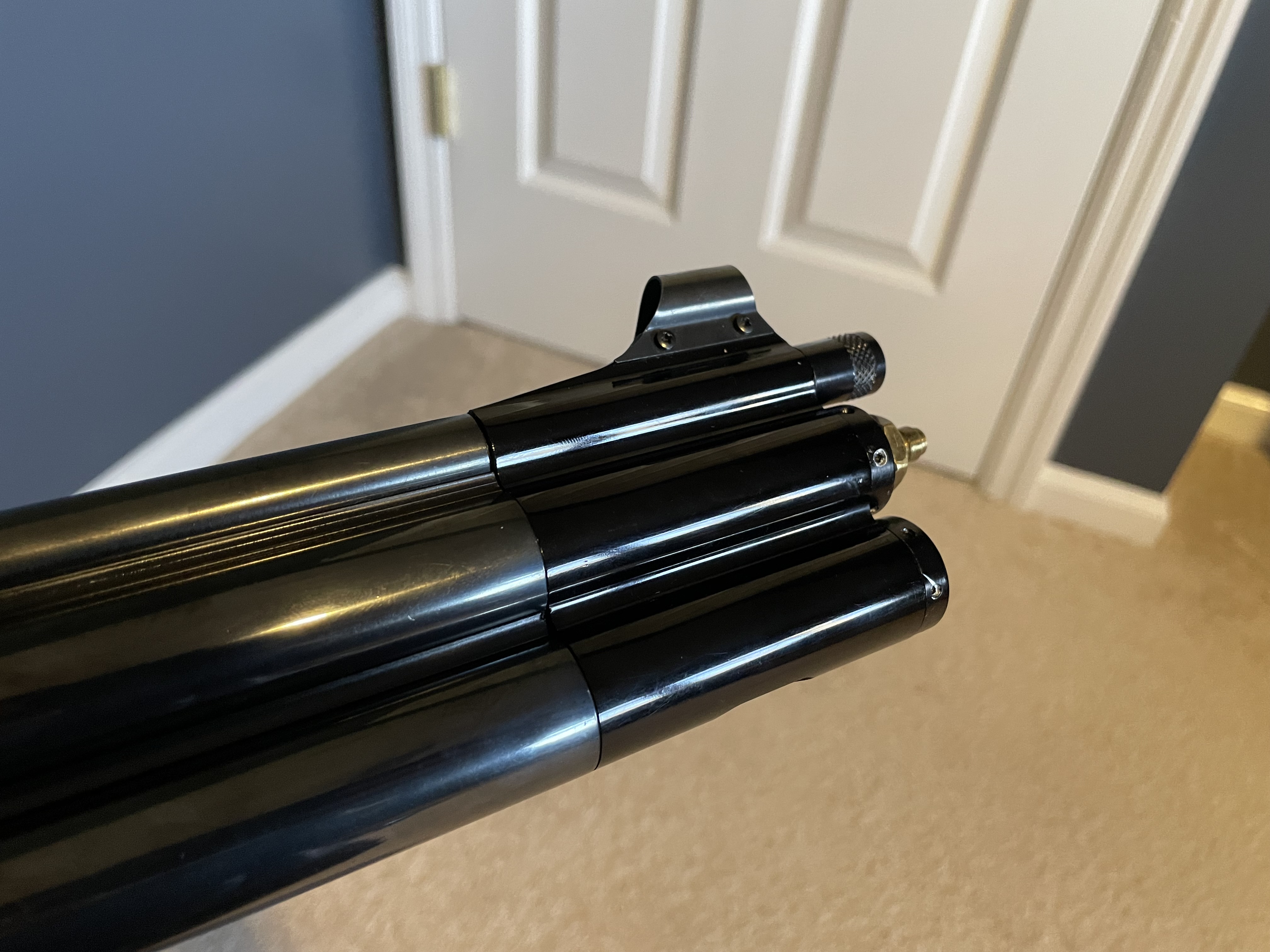

Other  Scratches on HW97/TX200 style sliding breech
With the TX200/HW97/Diana 460, etc., style of breech opening, are fine scratches a common thing on the visible silver portion of the compression tube that slides back and forth? I've seen several guns that have them, including one of mine (HW97). They aren't very deep, but I'm surprised that such high-end springers don't have a better fit and polish of the metal-to-metal surfaces to prevent scratches from forming.

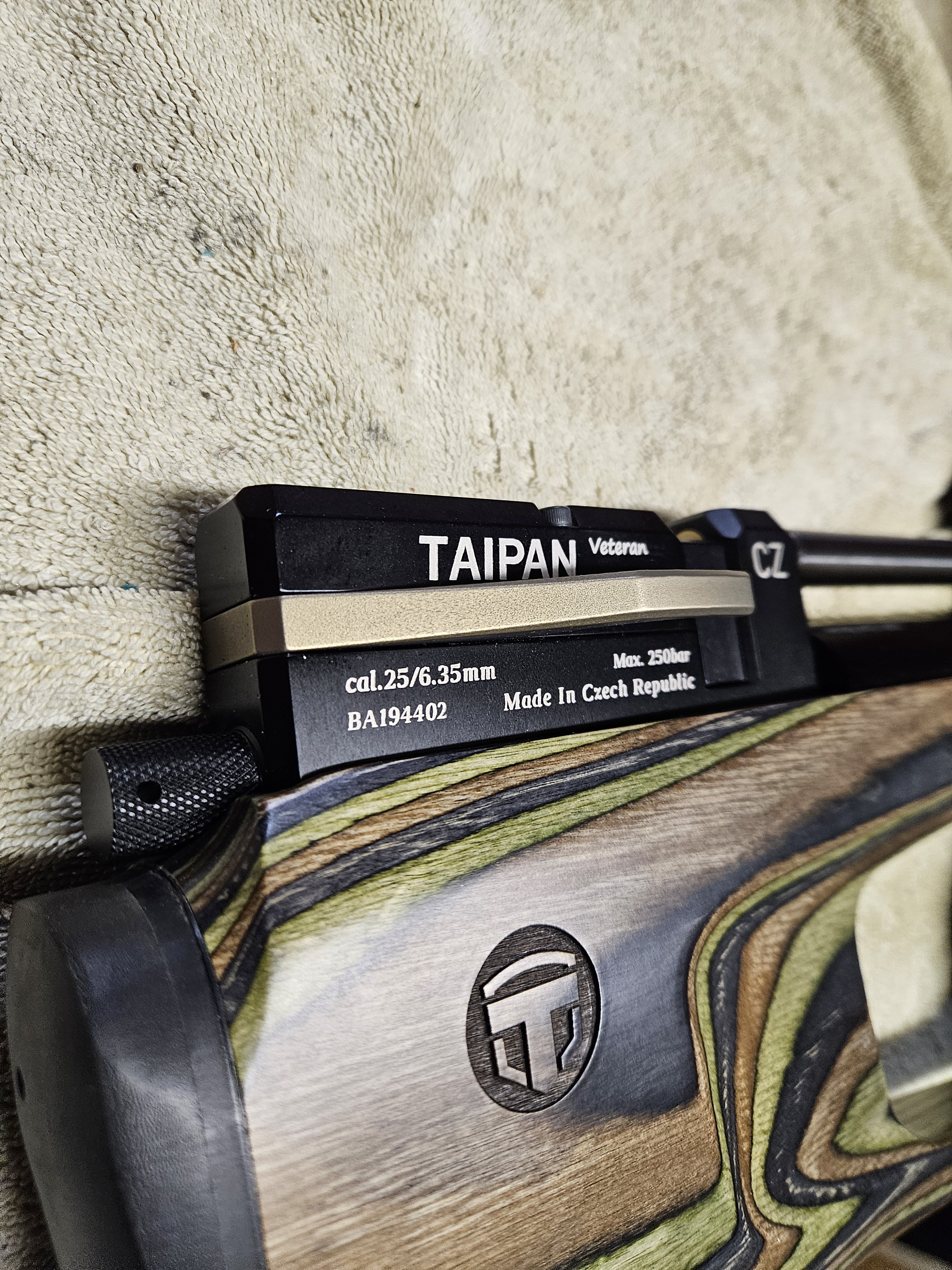

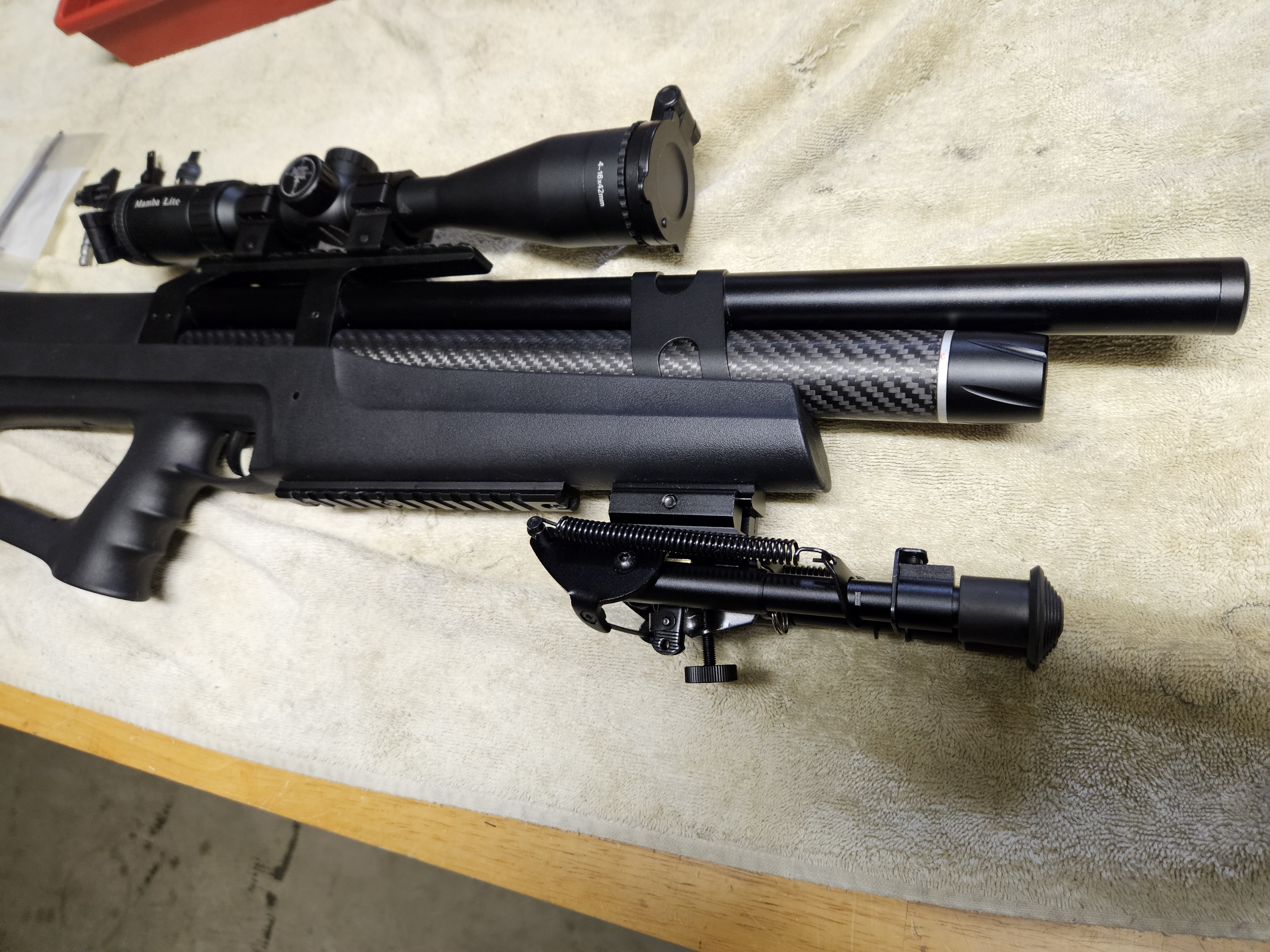

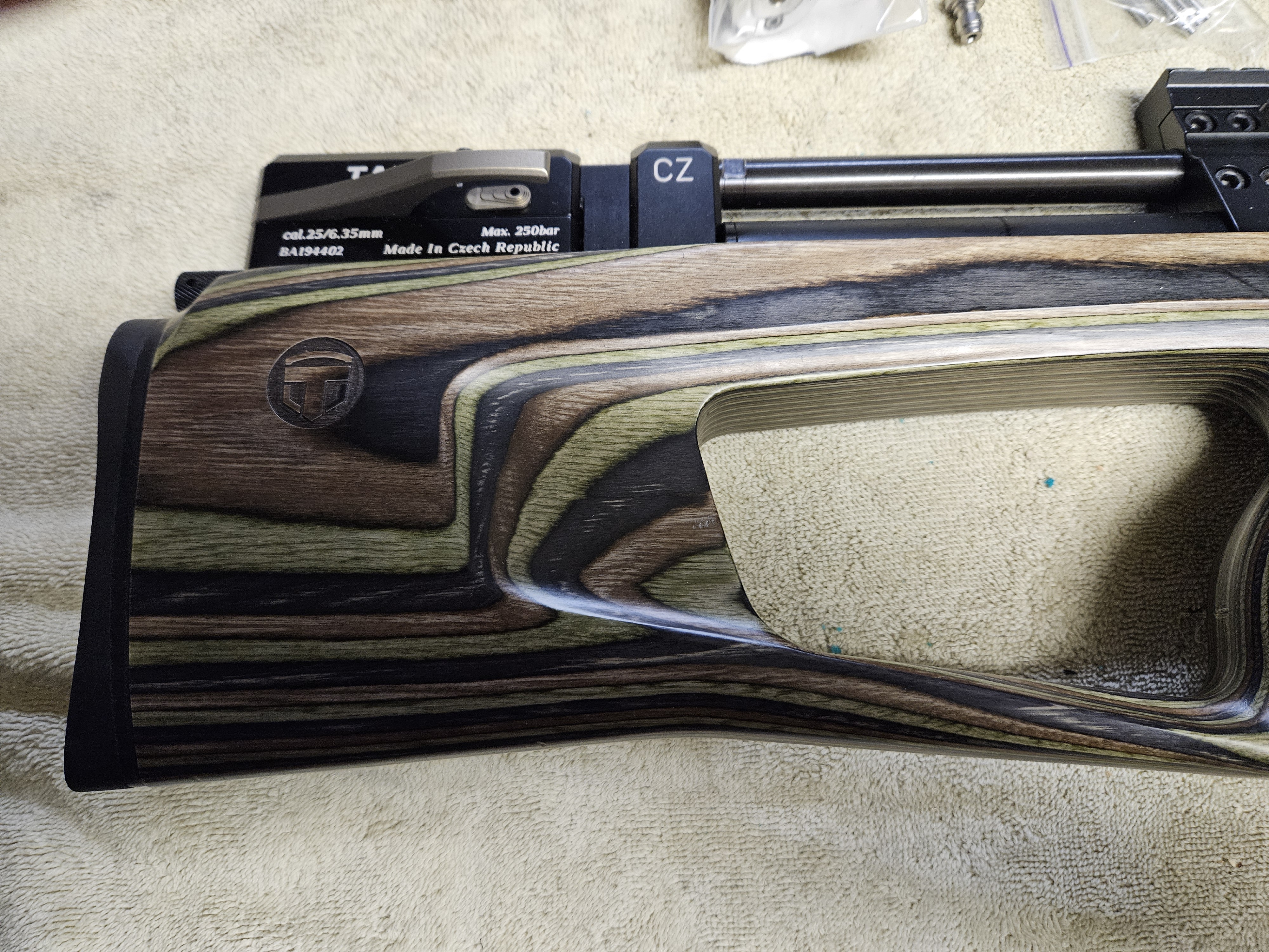

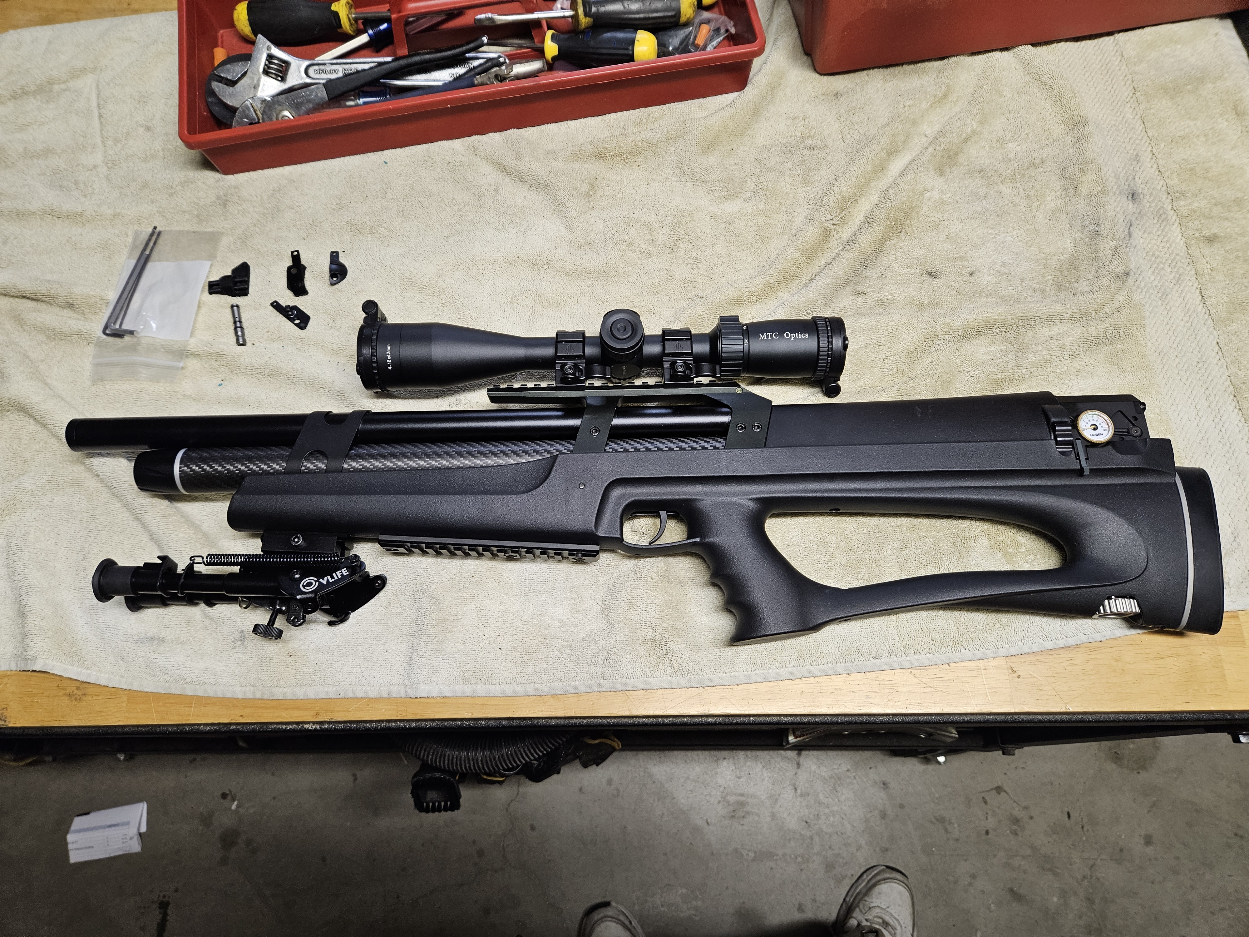

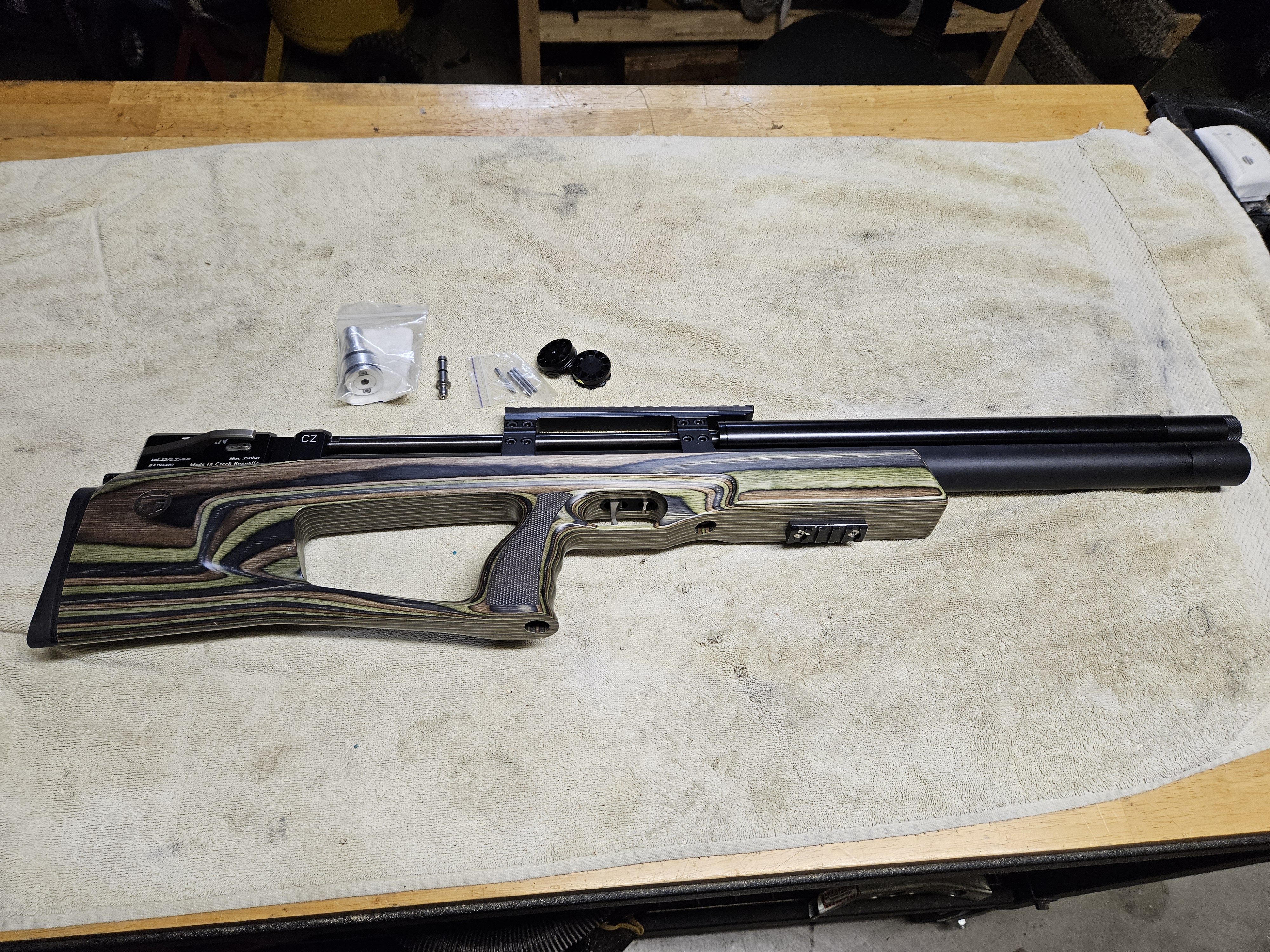

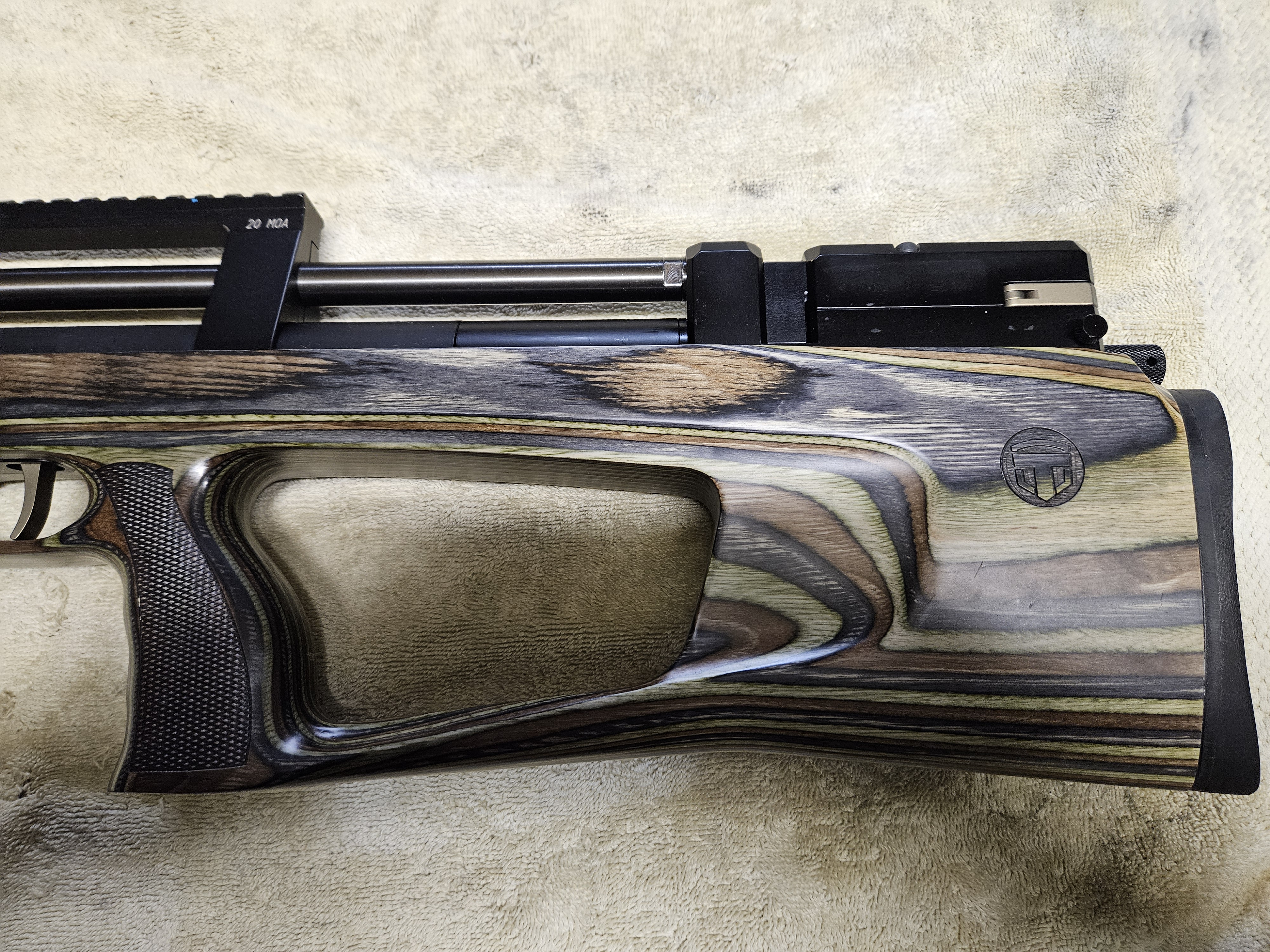

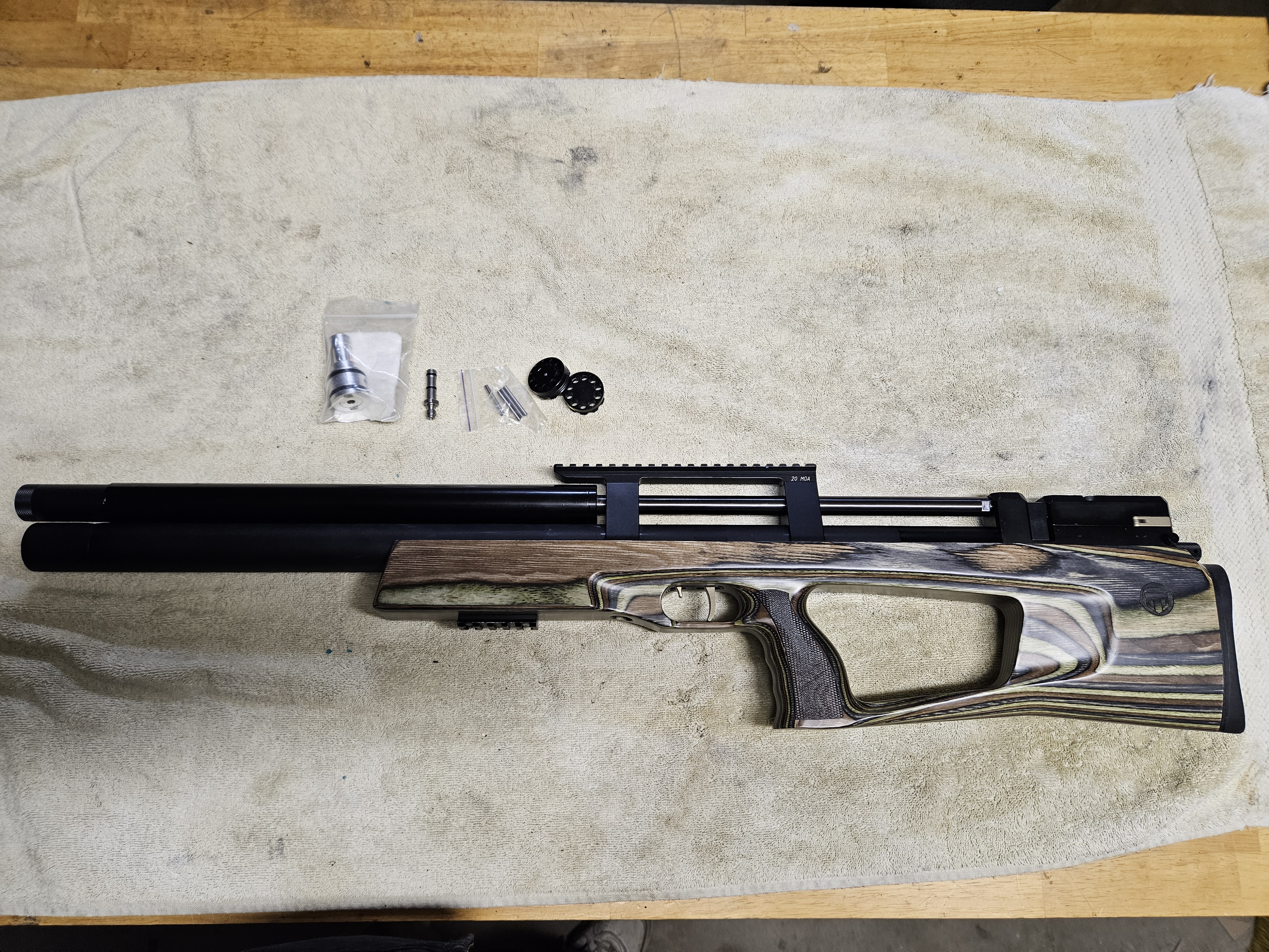

PCP Rifle  SOLD Wildcat MK3 BT .25 ( reduced )
I have a Wildcat VP that I put an FX 480 CC carbon fiber bottle on in place of the original aluminum one that came on it, so it has the 600 mm barrel in .25. I bought it new and it has two years factory warranty remaining. The gun is perfect in every way and has had nothing but dry air run through it. The liner has the carbon sleeve on it and it will come with two factory mags. Scope and Donny Tatsu are not included. Asking $1150 shipped CONUS. Moderator can be added for an extra $100.

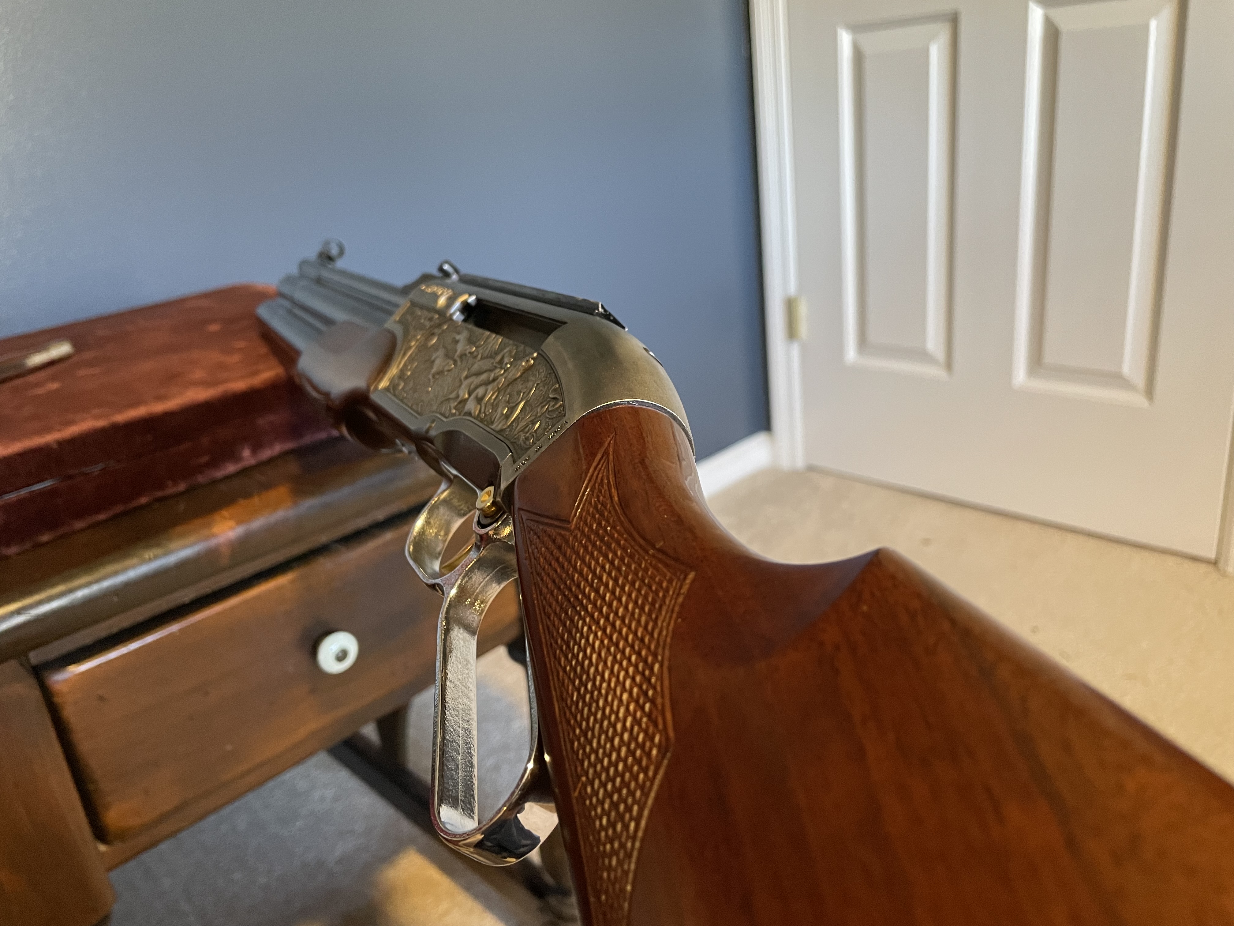

Benjamin  Benjamin Knurled Bolt
I picked up this Benjamin 392P on the used list at AOA. It came with this knurled bolt. Being a lefty, I prefer it over the traditional right leveraged bolts. I can’t seem to find one on the market anywhere. I doubt it’s custom made because I have seen these on other Benjamin 397/392’s. I have other‘s that I would like to change over. The knob is larger than the knob on the Benjamin pistol. Any help would be greatly appreciated.
