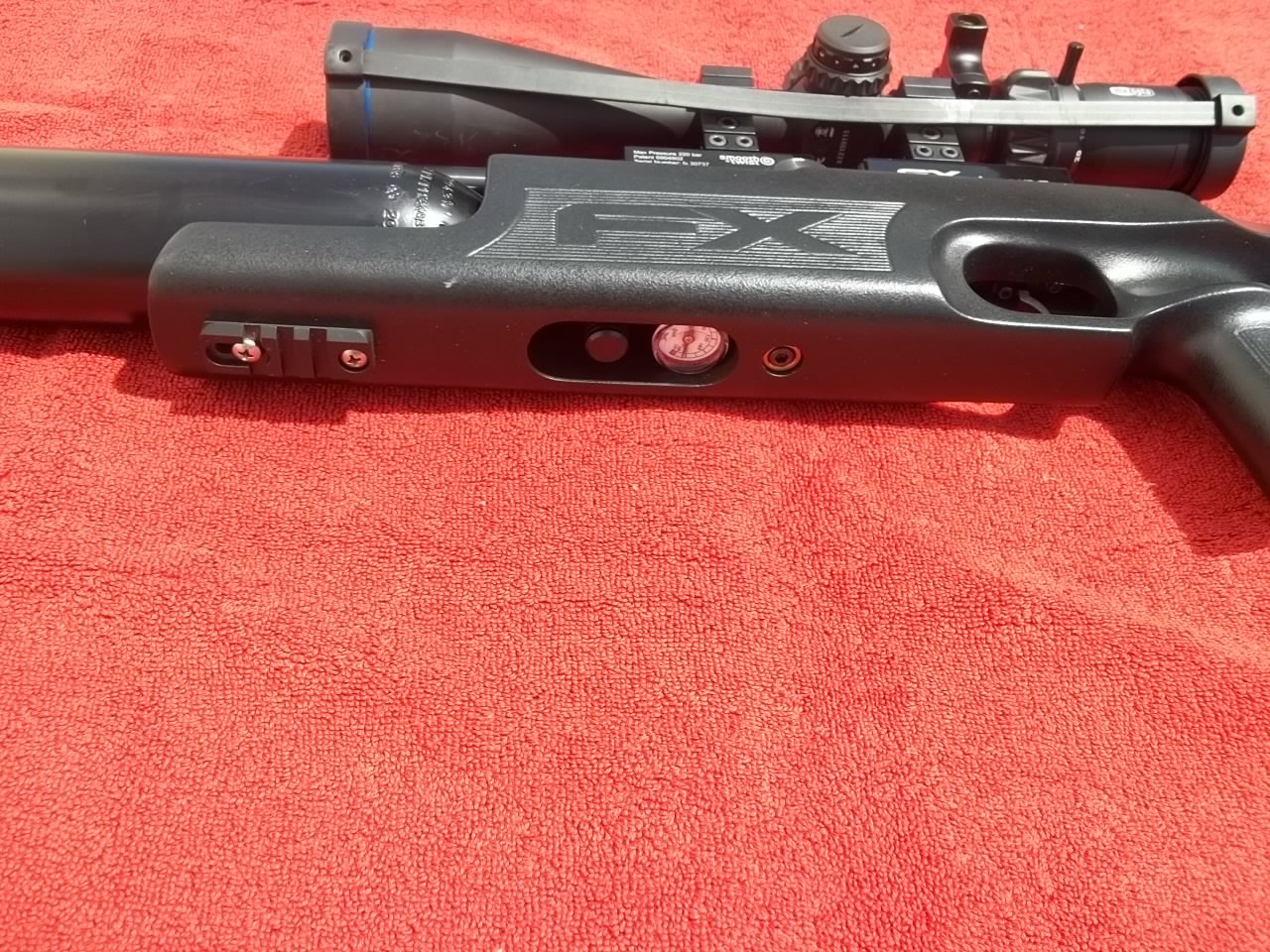

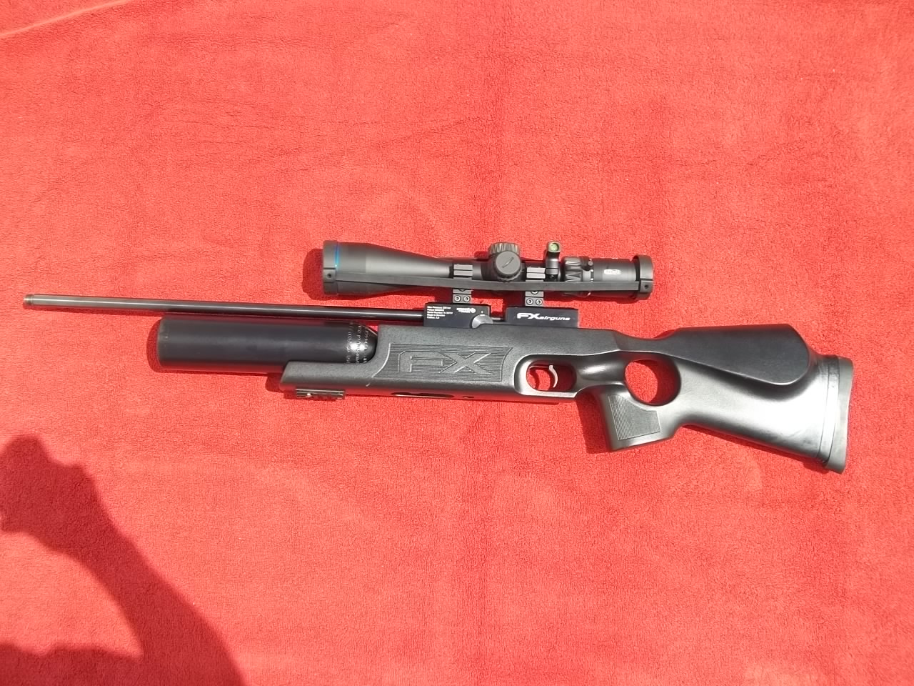

PCP Rifle  SOLD FX DreamTact Compact w/ .177 AND .22 Barrels - Lots of Custom Parts!
FX DreamTact Compact w/ 300mm .177 and .22 "Skinny" 20mm Barrels/Shroud - .177 Pin Probe, .22 High Flow Pellet Probe - x1 .177 FX Magazine, x1 .22 FX Magazine. 910 Airguns Short Throw Cocking Lever with Oversized Cocking Handle and custom two tone rubber soft grip - New Huma 23mm Gauges w/custom two tone rubber gauge covers (250 & 300 bar) - FX 300cc 250bar CF Bottle - FX Power Plenum - New FX Brass Piston AMP Regulator - New Upgraded Power Wheel w/ custom two tone rubber cover -Tethered Rubber Foster Fill Cover - Folding custom lightweight CF Tube/Bag Rider Buttstock w/ custom soft two tone Cheek Rest and Buttpad. "Knockoff" Atlas BT-10 w/QD Pic Clamp included.
It's a FULL Dual Caliber Package!! Perfect for Light Pesting or Plinking. PERFECT Like new condition, no leaks and shoots perfect. NOT INCLUDED are the Scope, Mount, and Moderator pictured. - ** HUGGET ATOM MODERATOR AND FX HARD CASE AVAILABLE AT ADDITIONAL COST**
$1150 Shipped/Insured (ships in original FX Box, no hard case) Paypal F&F (or cover the G&S Fees), Zelle, Venmo, Cash App.
Happy to answer any and all questions, contact info sent on request.
NO TRADES CONSIDERED AT THIS TIME! LOWBALLERS WILL BE IGNORED, DON'T WASTE YOUR TIME OR MINE PLEASE.
