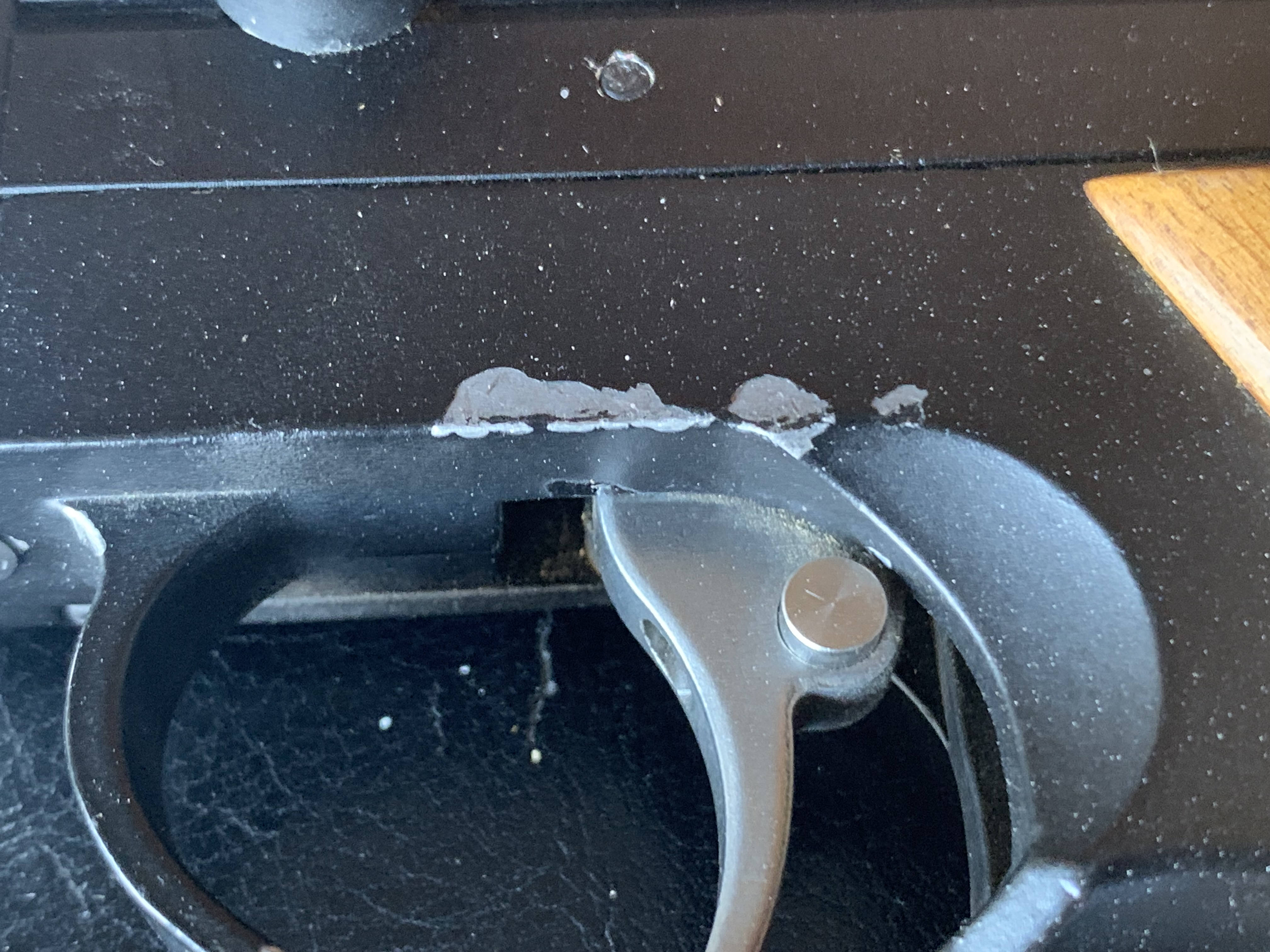

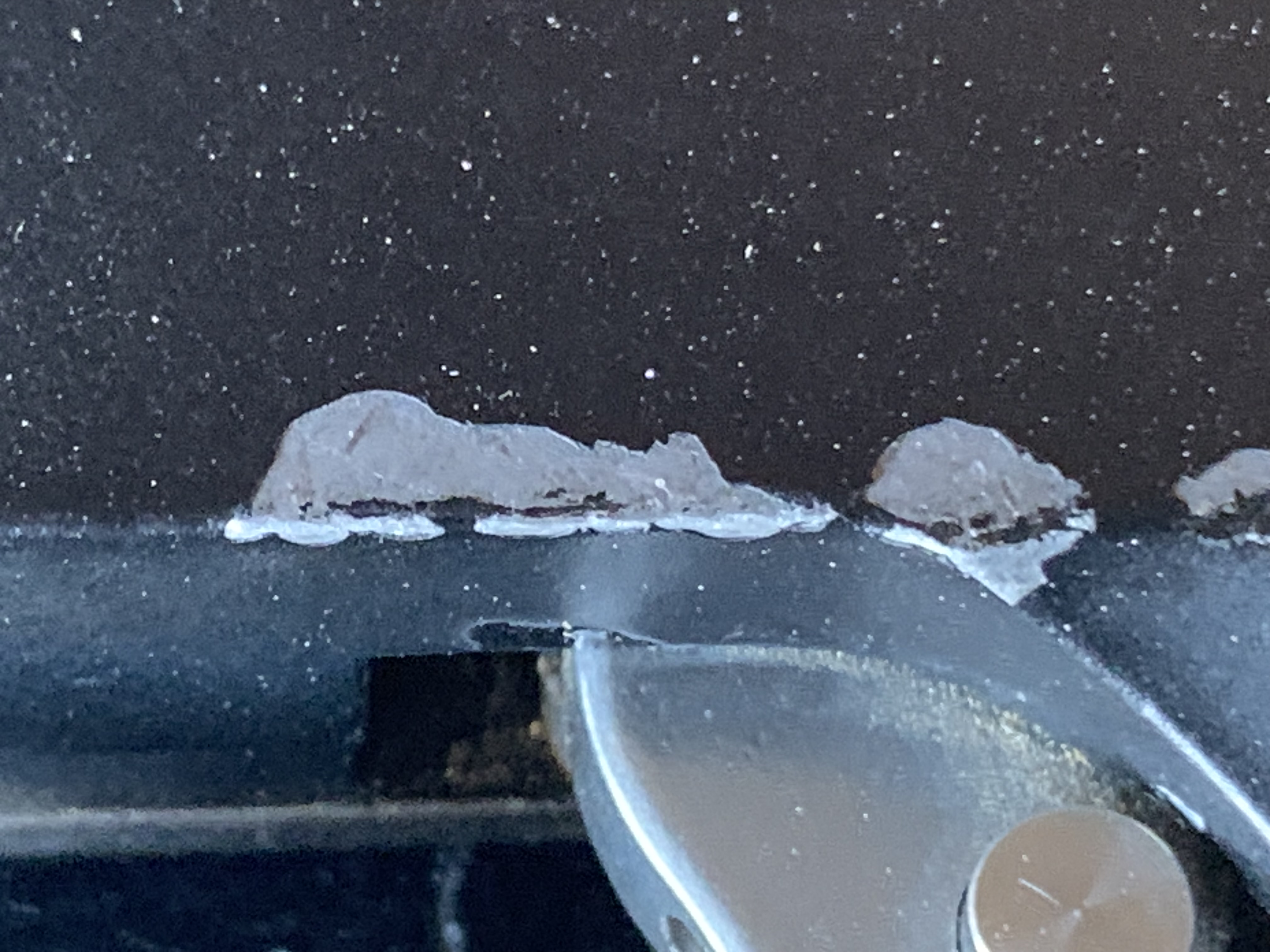

We are getting cooler temperatures for the first time in months but I'm not sure it was that because it happened later this morning. But the smoke alarm that always seems to need something started chirping. I tried a new battery but that did not fix it. It was not old, not sure what the issue is. But I just ordered a new one from Amazon (different brand) and decided to have a little fun with the useless one. I shot it 8 or 9 times with my P35-177 spitting out H&N Baracuda FTs at about 880 fps. The smoke detector was 35 yards from my gun. The first shot knocked the detector over but did not go through. By after 8 I had holes in the back too. Next I pulled out my Caiman X in 22 which is shooting H&N Baracuda 18s at a little over 900 fps. That put some bigger holes through it and busted off some parts. My P35-25 has a slow leak (takes days to show up on the gauge and weeks to drain the air) so it was going to get a couple new O-rings and needed to be drained. I only shot the dectector 3 times with the 25, it was shooting JSB Heavies at about 770 fps (down from 800 due to the cool weather). The first two shots just clipped the edge of the detector. I was aiming at that corner because I could see the speaker in there but either the scope is off a bit or there was wind drift (it's windy today). But I got a good smack on it with the third shot. I did not destroy the speaker but I put a pretty good hurt on it. Satisfying. The last two pictures were at the end. The second one is after the 22 caliber hits and the first is what I started with.

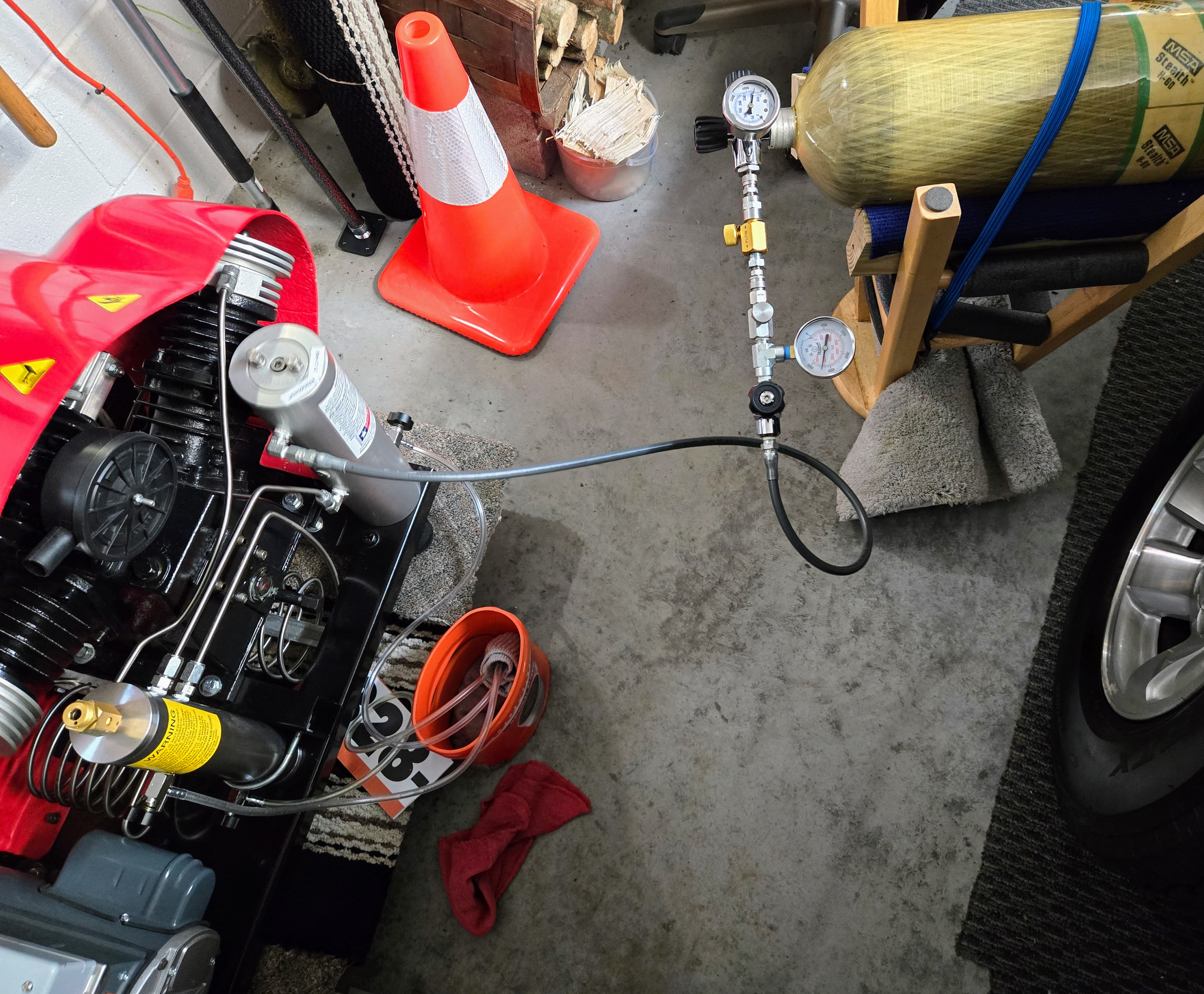

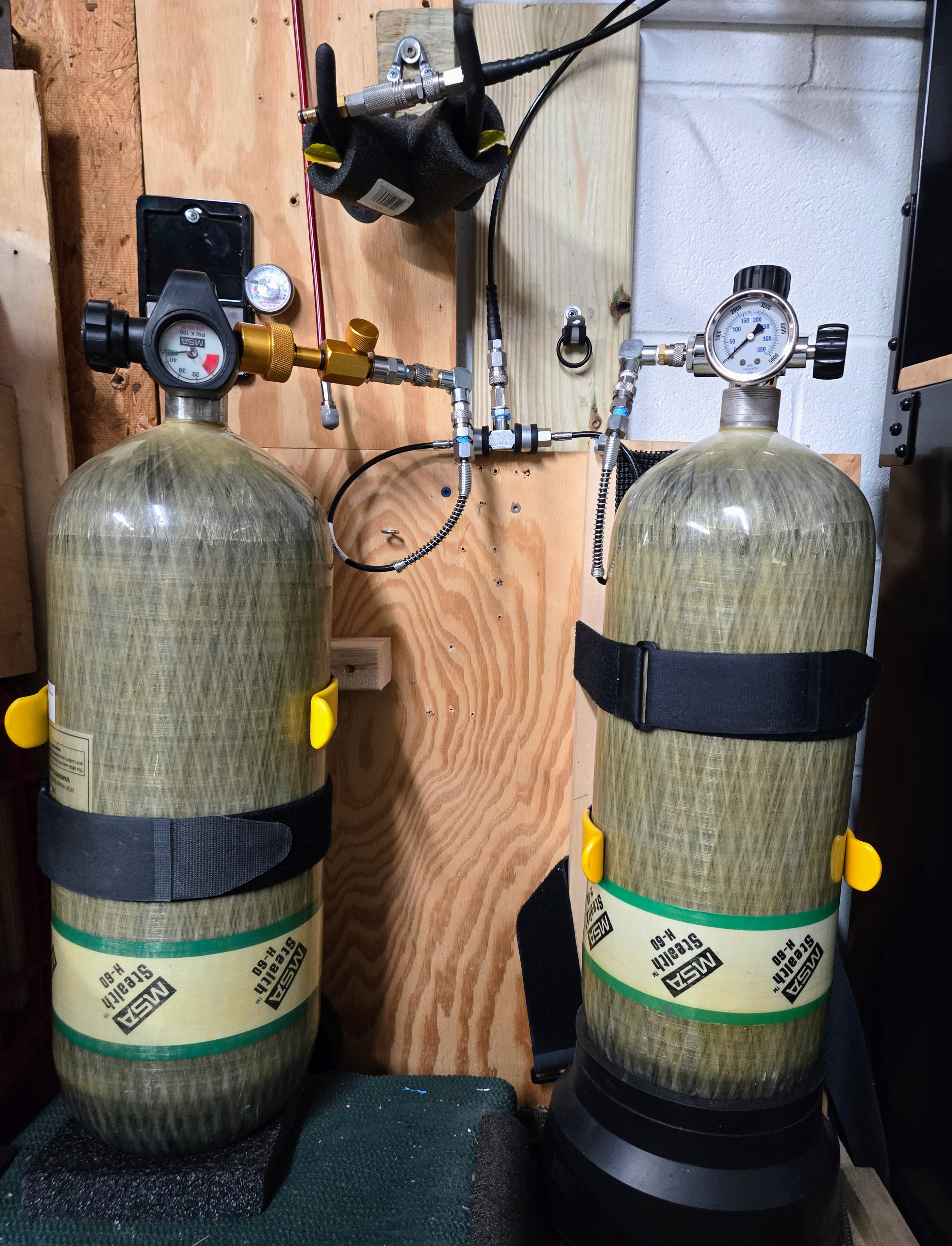

AIr compressor question
Read through this forum category and only found a couple mentions of what I am considering. I have 100 PSI instrument quality air online in my shop currently. I'm a retired dental equipment guy thus my compressor is a dental compressed air system with excellent filtration and drying. The unit has desiccant drying, very low dewpoint air is produced, about -150 F dewpoint.
I see the intake on my new 4500 PSI 30 bar compressor is 1/4 NPT. My thought is to plumb the intake of the HPA compressor to the output of my shop compressor. So regulate the source air to the 1/4 NPT port to ballpark atmospheric pressure? I'm thinking 10-15 PSI regulated input.
