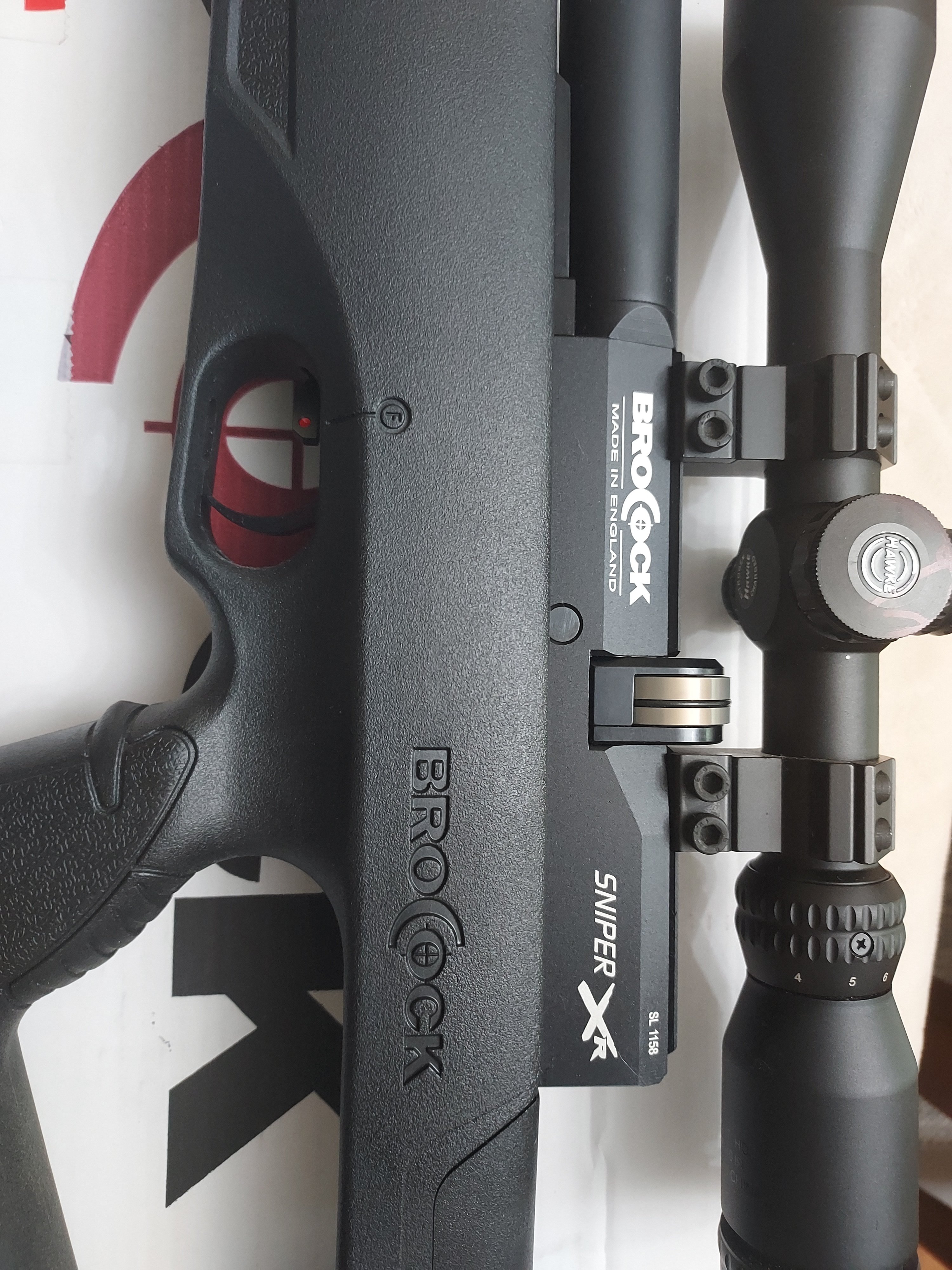

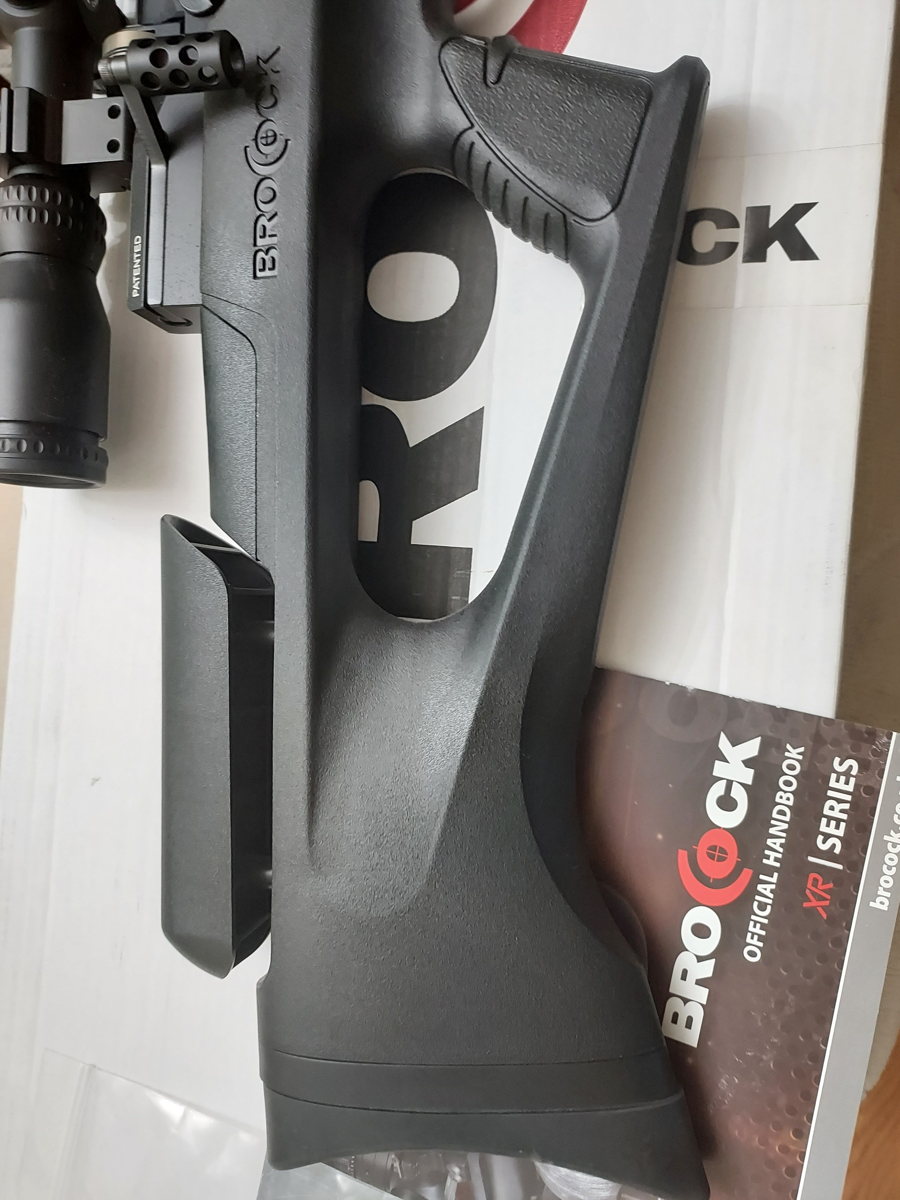

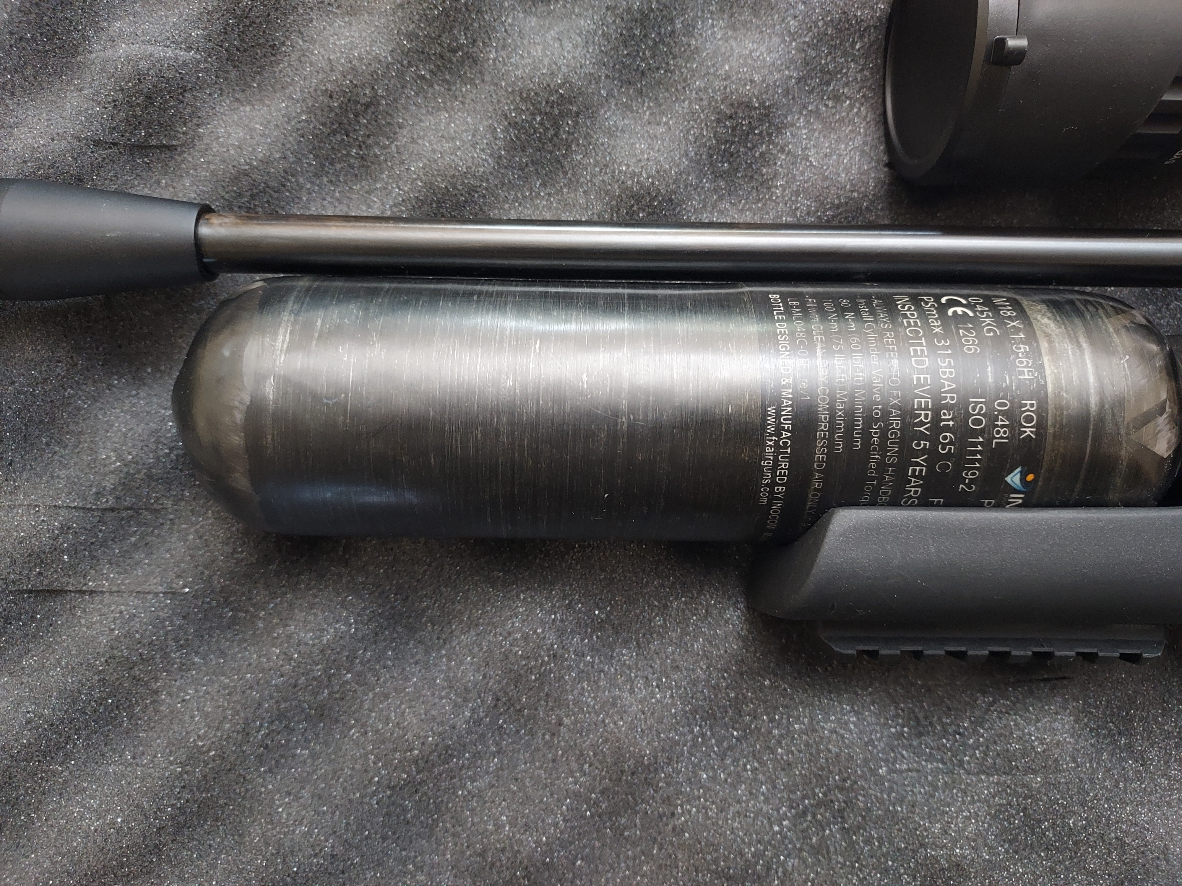

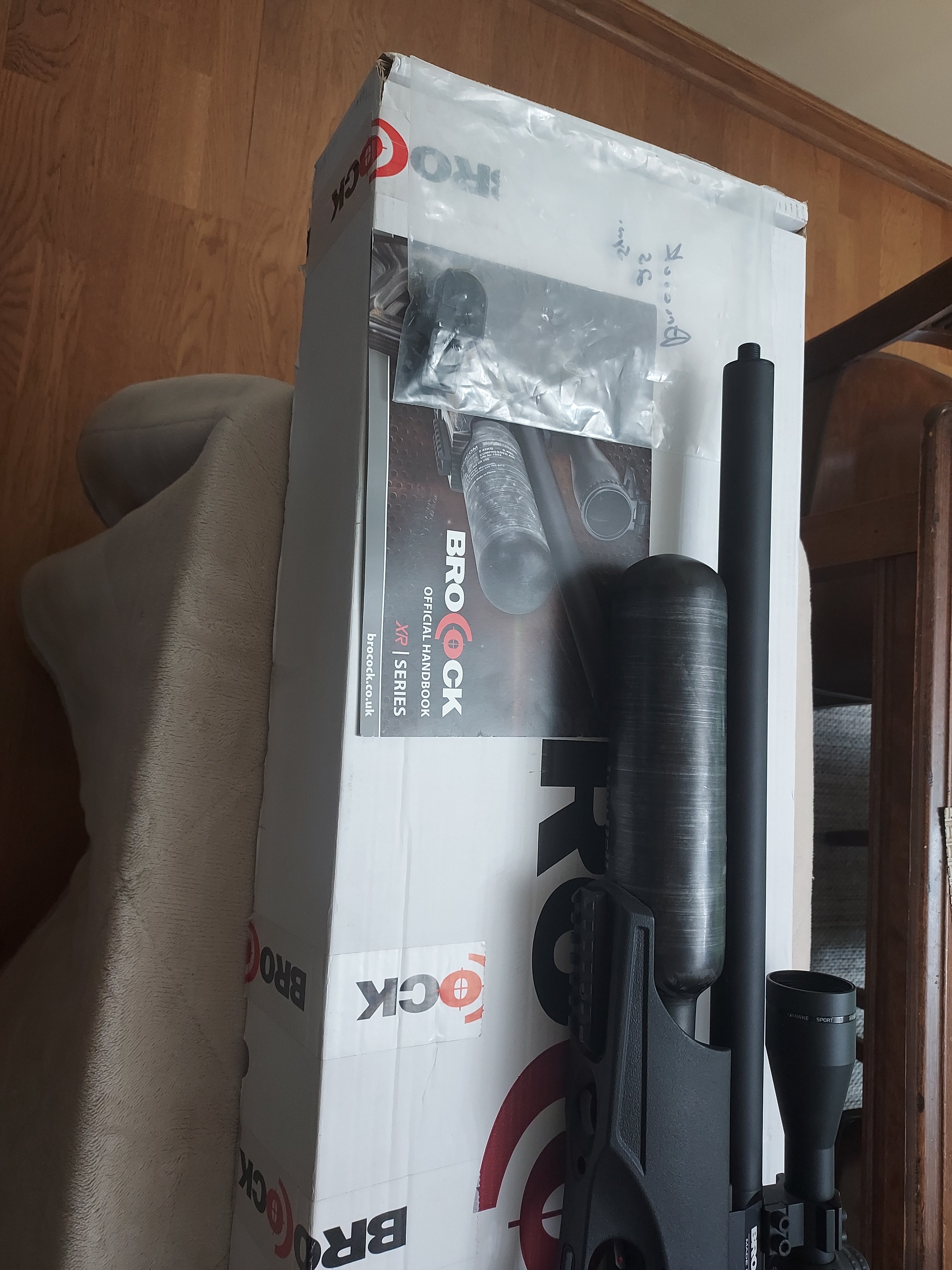

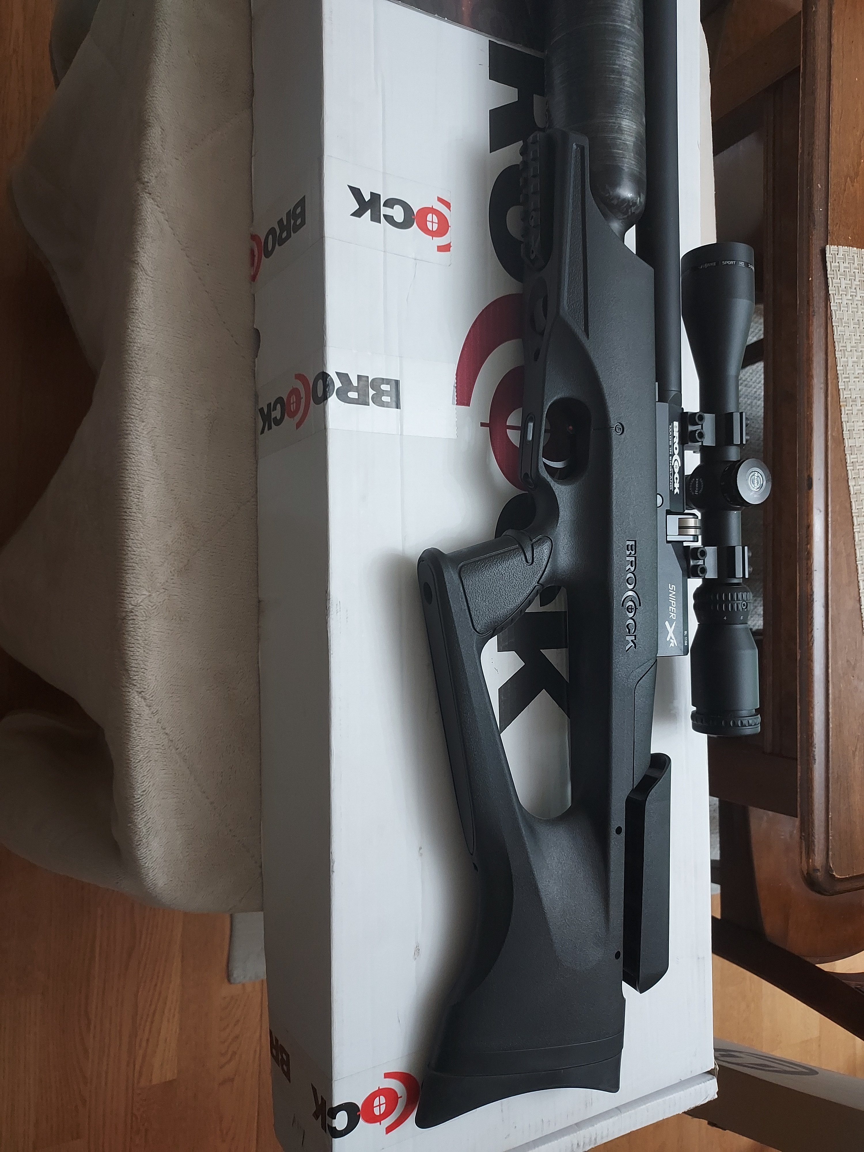

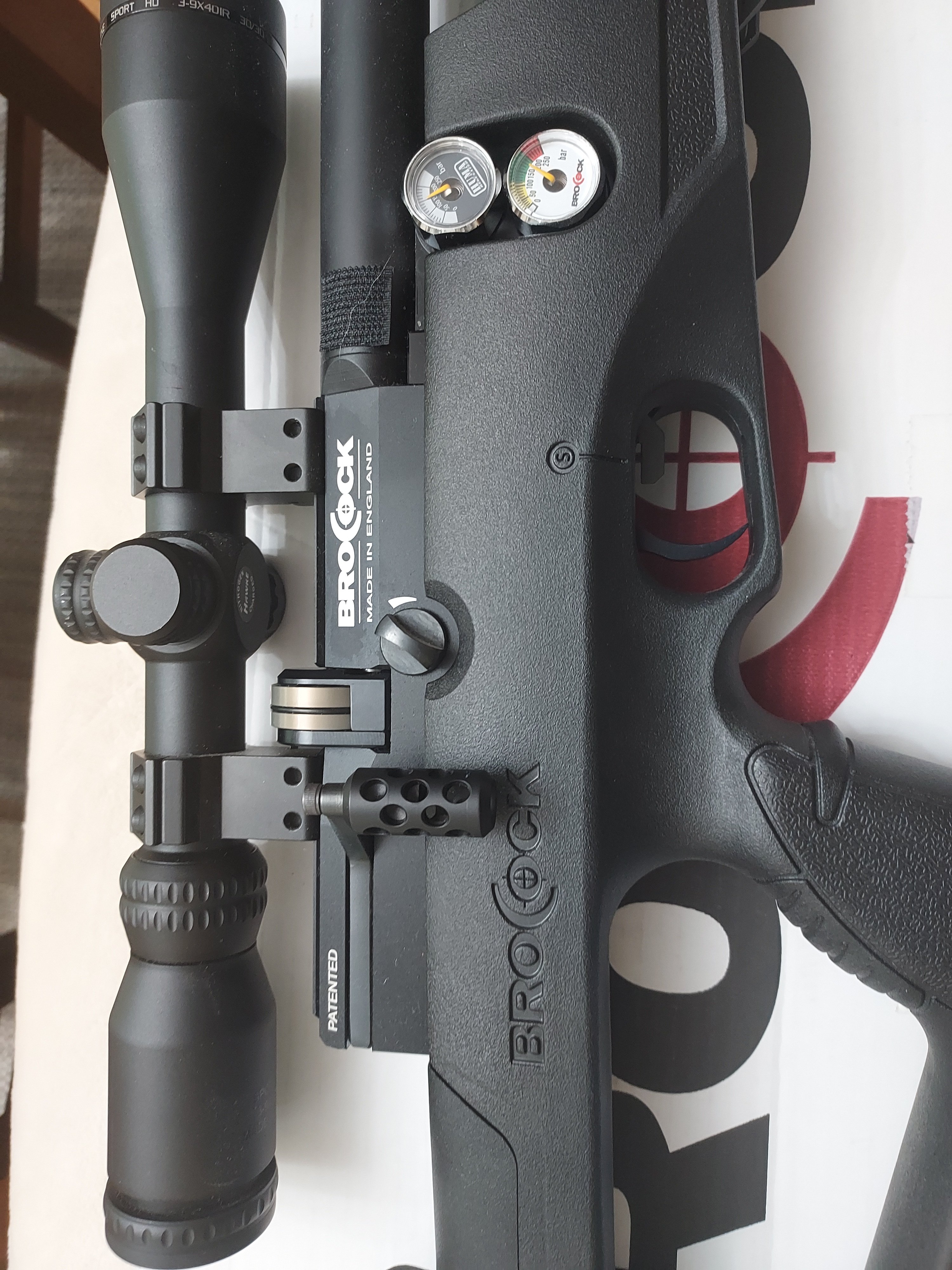

PCP Rifle  SOLD Brocock Sniper XR .25 Cal W/Hawke 3x9 Scope NICE!
This is a Brocock Sniper XR .25Cal W/Hawke 3x9 Scope all in mint condition. Gun has had less than 2 tins of pellets thru it. Great shooter never any problems. Can't find the thread protector for barrel. I have it somewhere just can't find it. Selling due to health reasons. $1000.00 Shipped to lower 48 Email or text for more info 9892257424

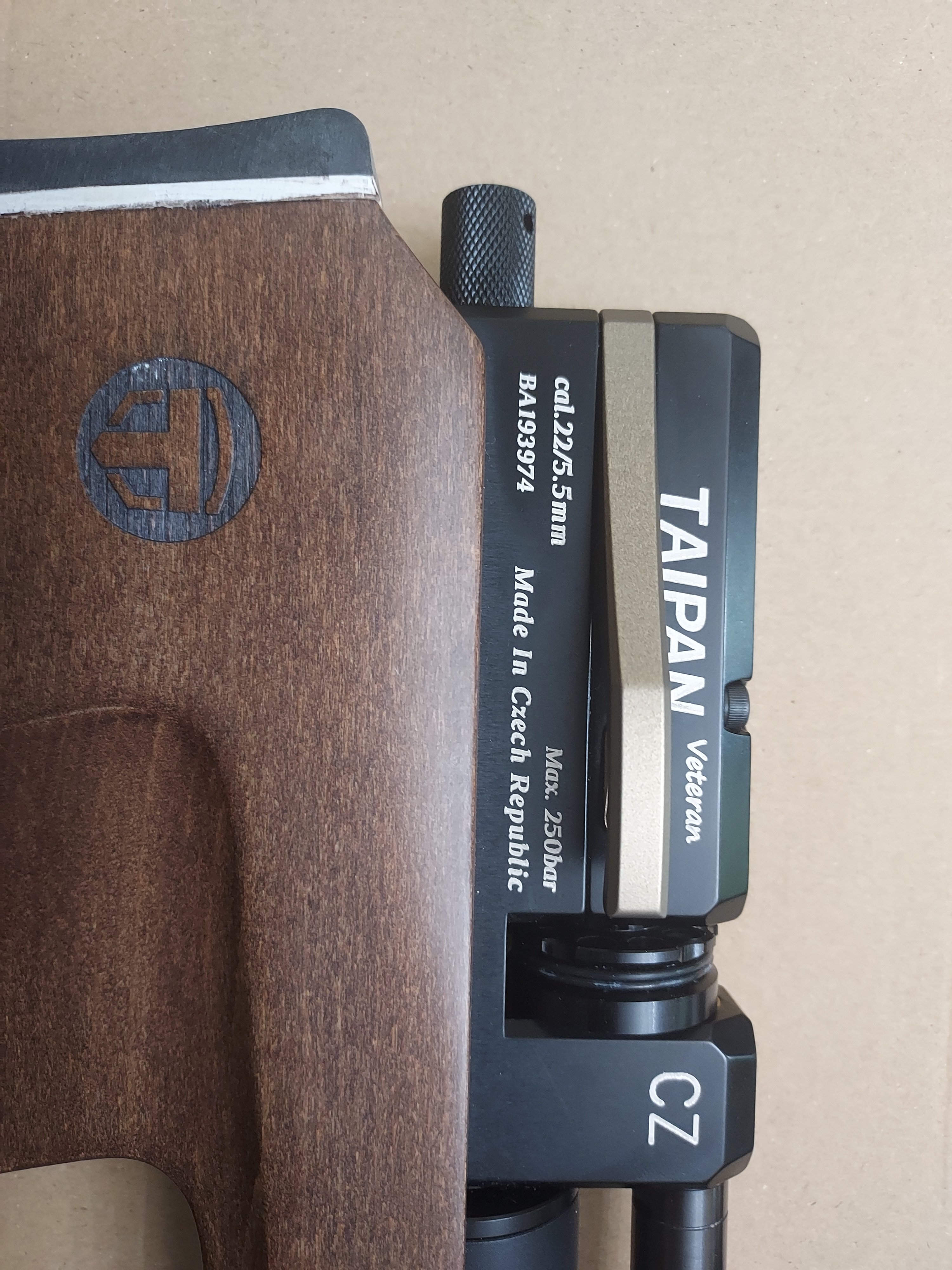

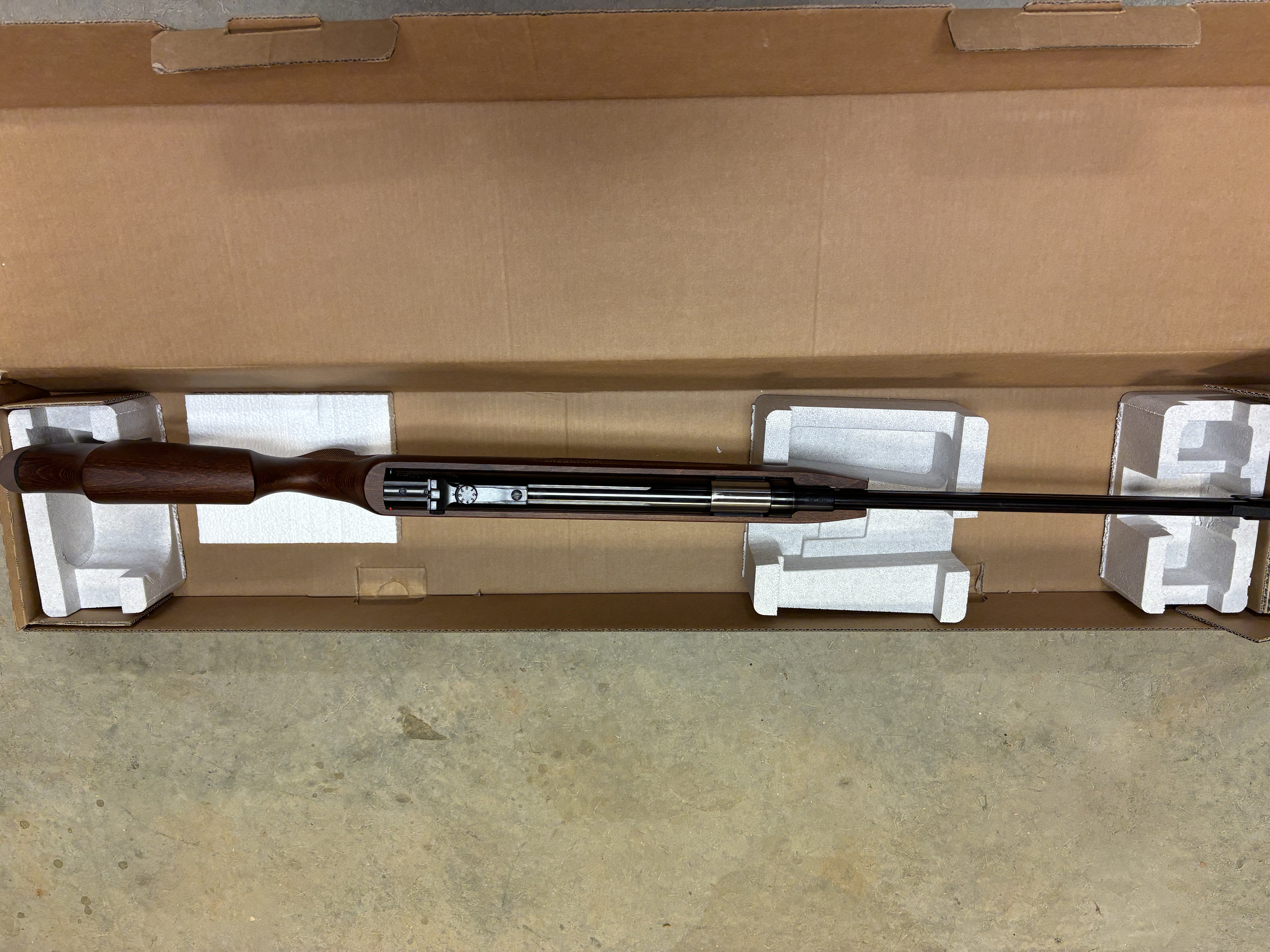

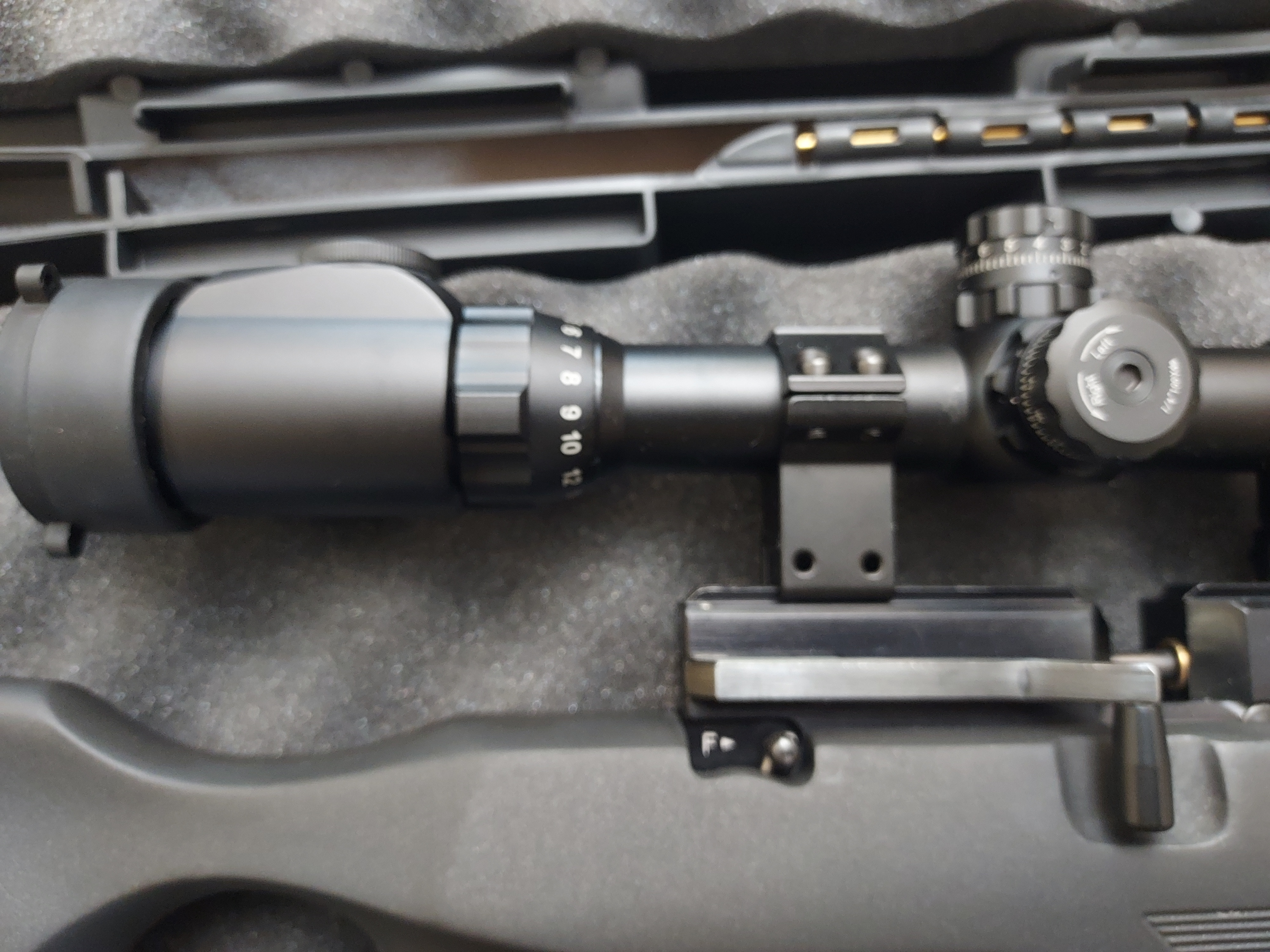

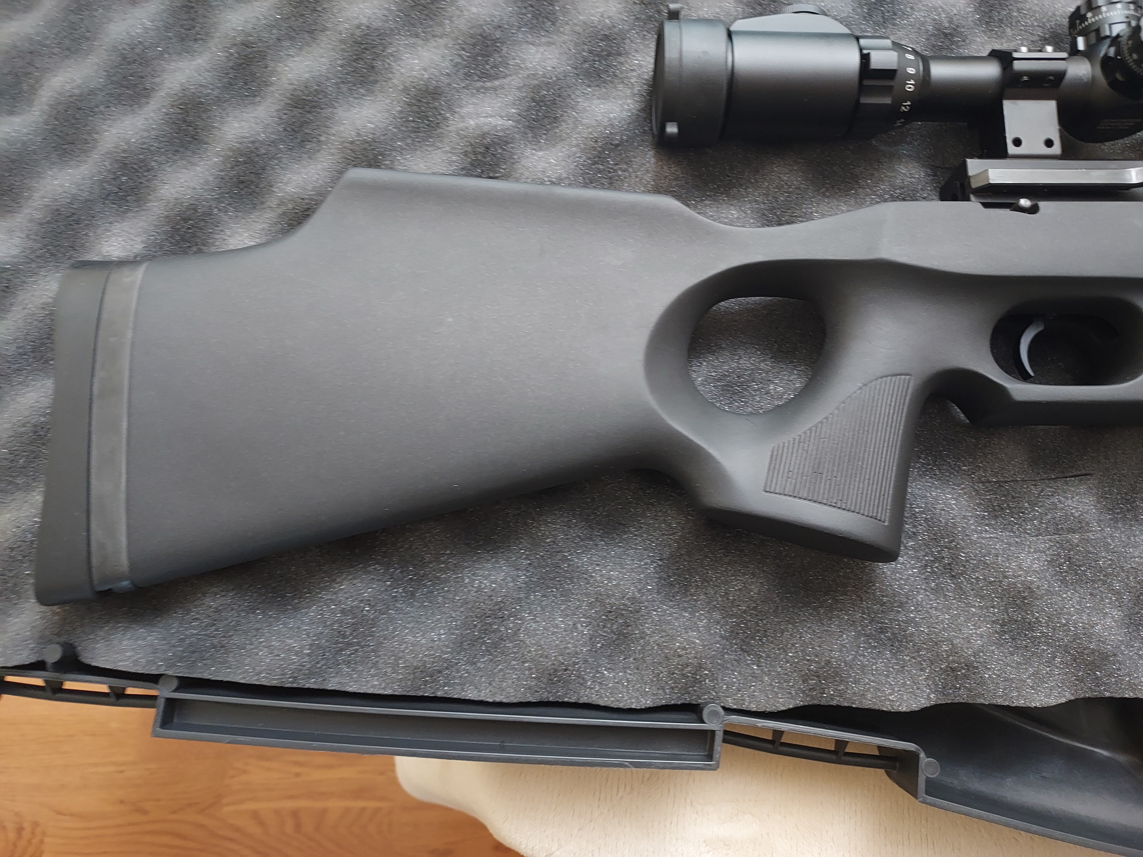

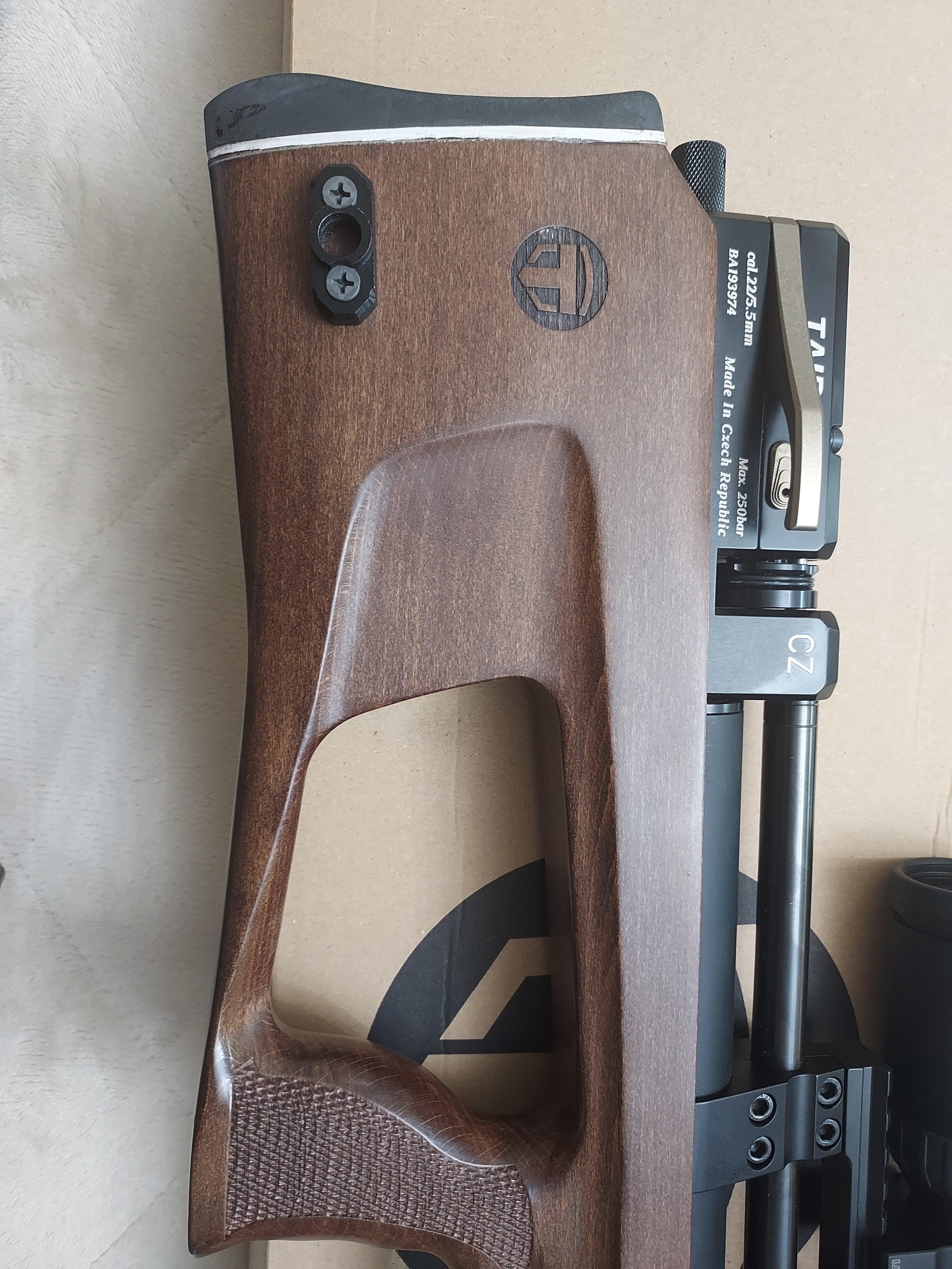

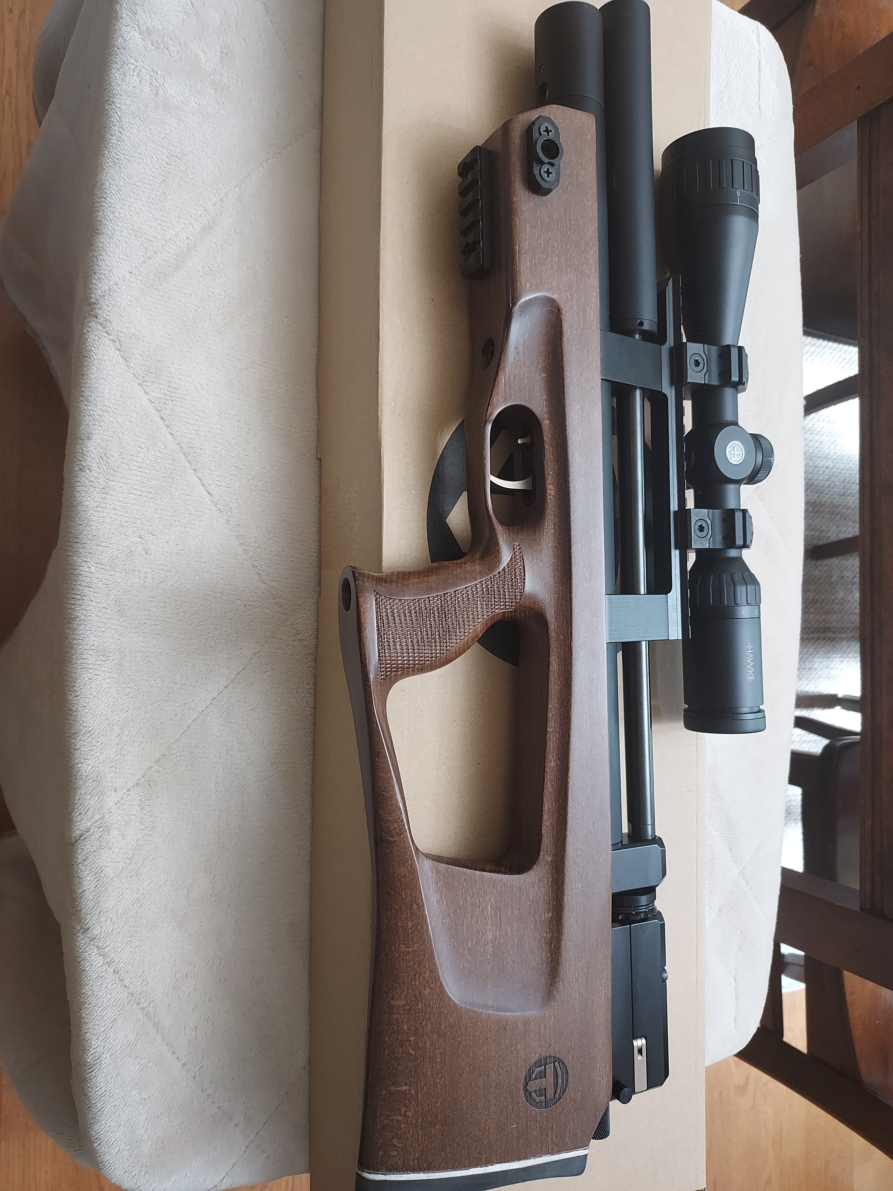

PCP Rifle  SOLD Taipan Veteran Short 22Cal. W/Hawke 4x12 Scope Like New!!

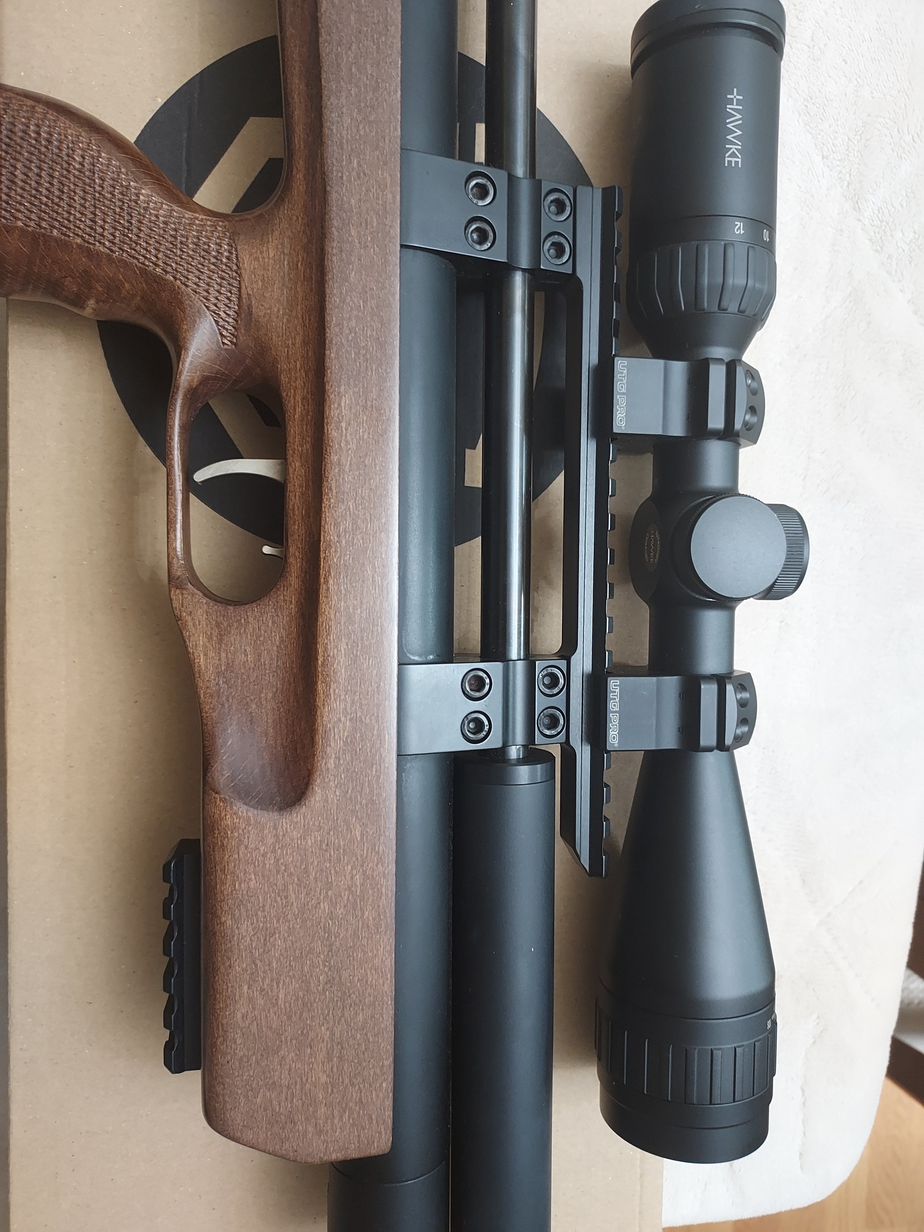

This is a like new Taipan Veteran Short 22Cal. Comes with Hawke 4x12 Scope, 1 Magazine and fill probe. Has had less then 2 tins off pellets. Shoots excellent never any problems, medical issues reason for selling. Never hunted with or been outside, very nice and accurate gun! $1100.00 shipped in lower 48. Email or text for more info 9892257424

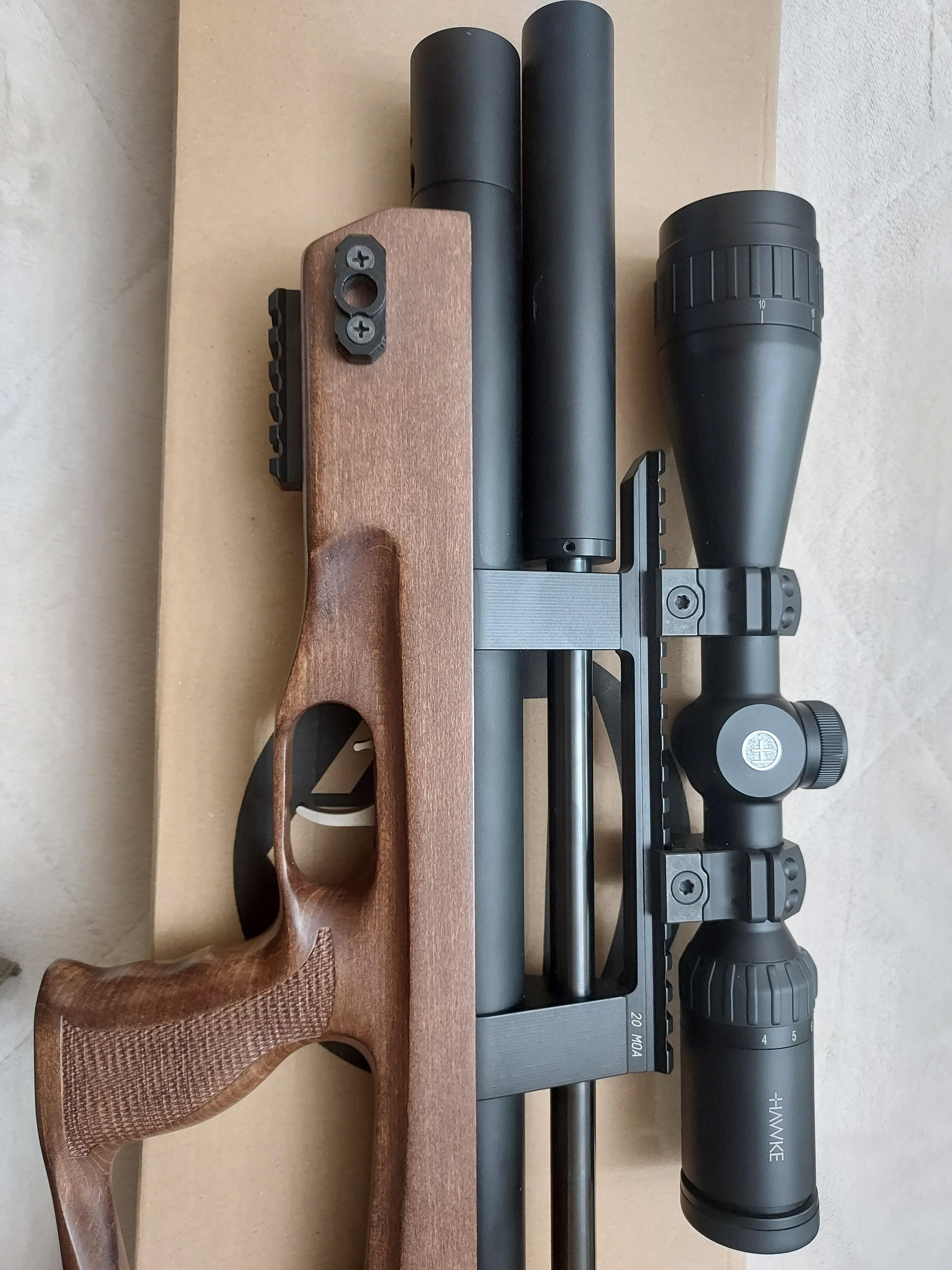

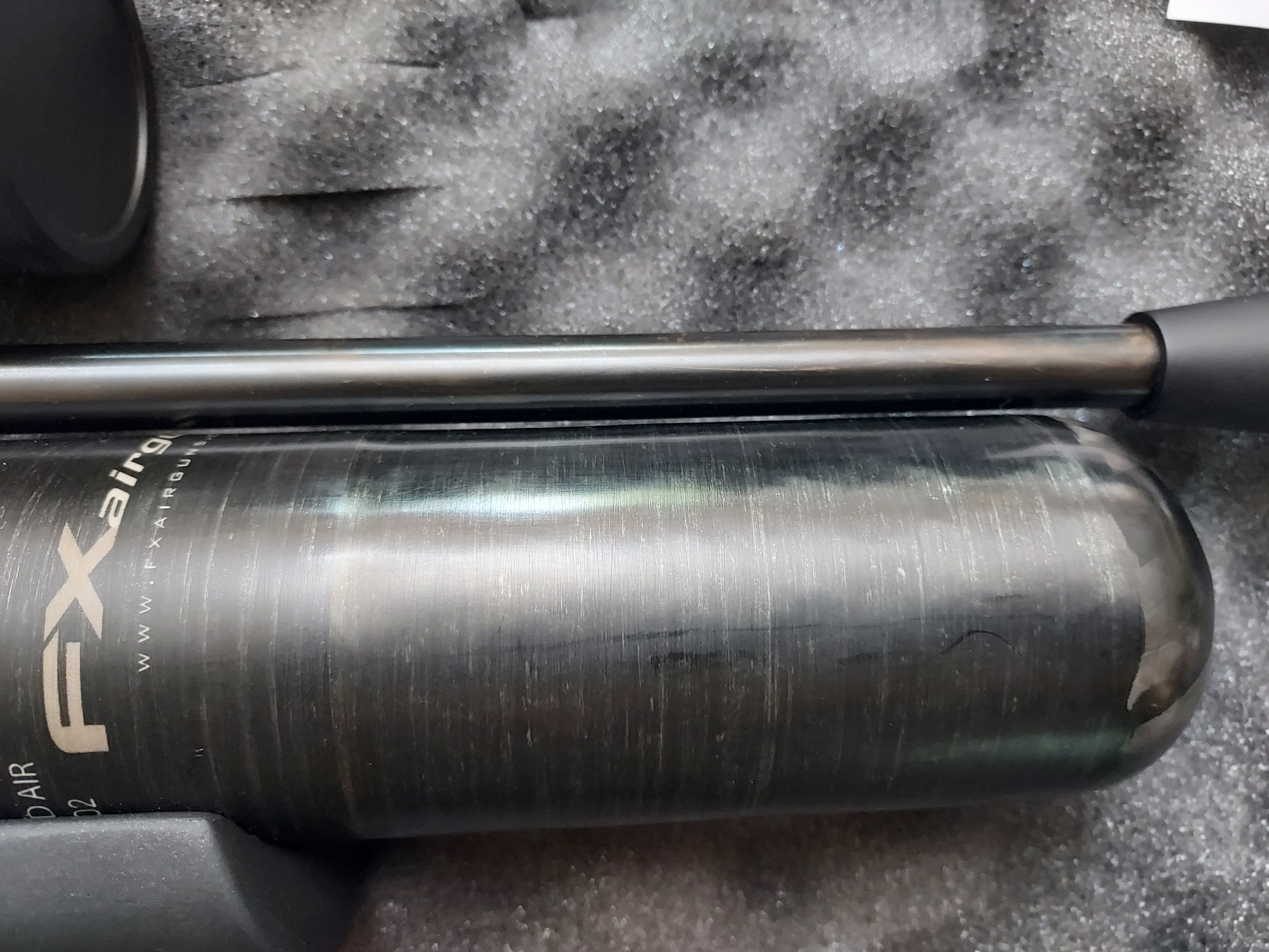

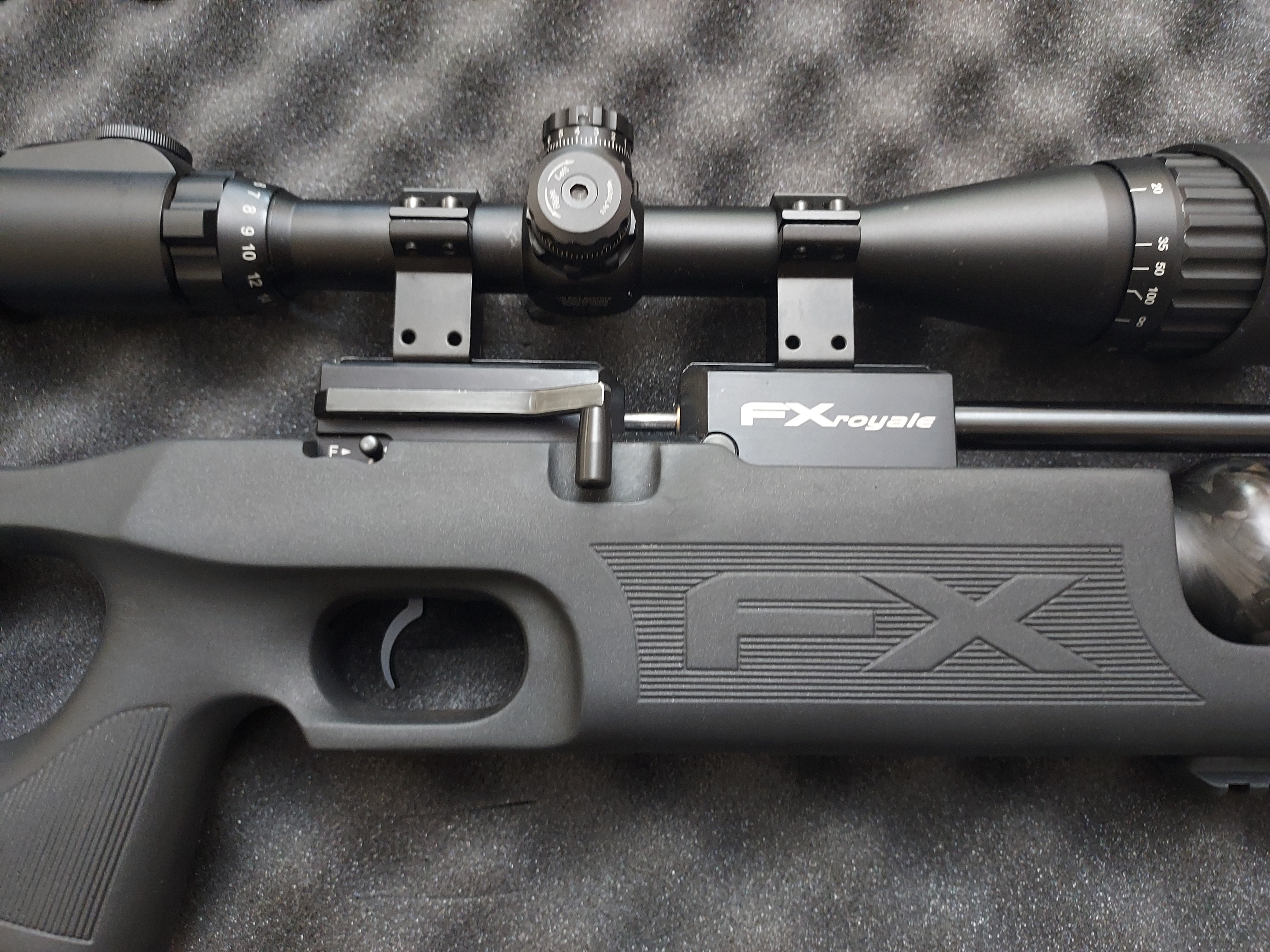

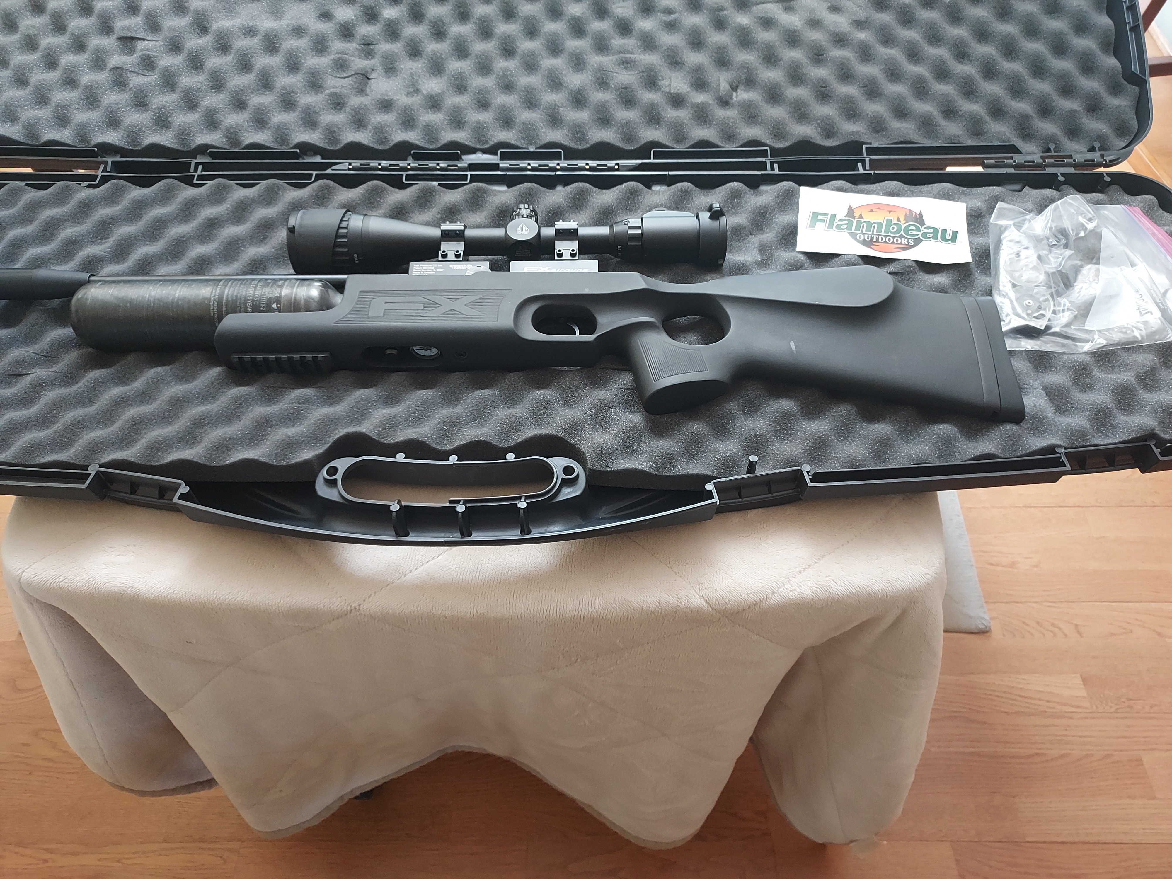

PCP Rifle  SOLD FX Royale 22Cal. W/4x16 UTG Lighted Scope NICE!!

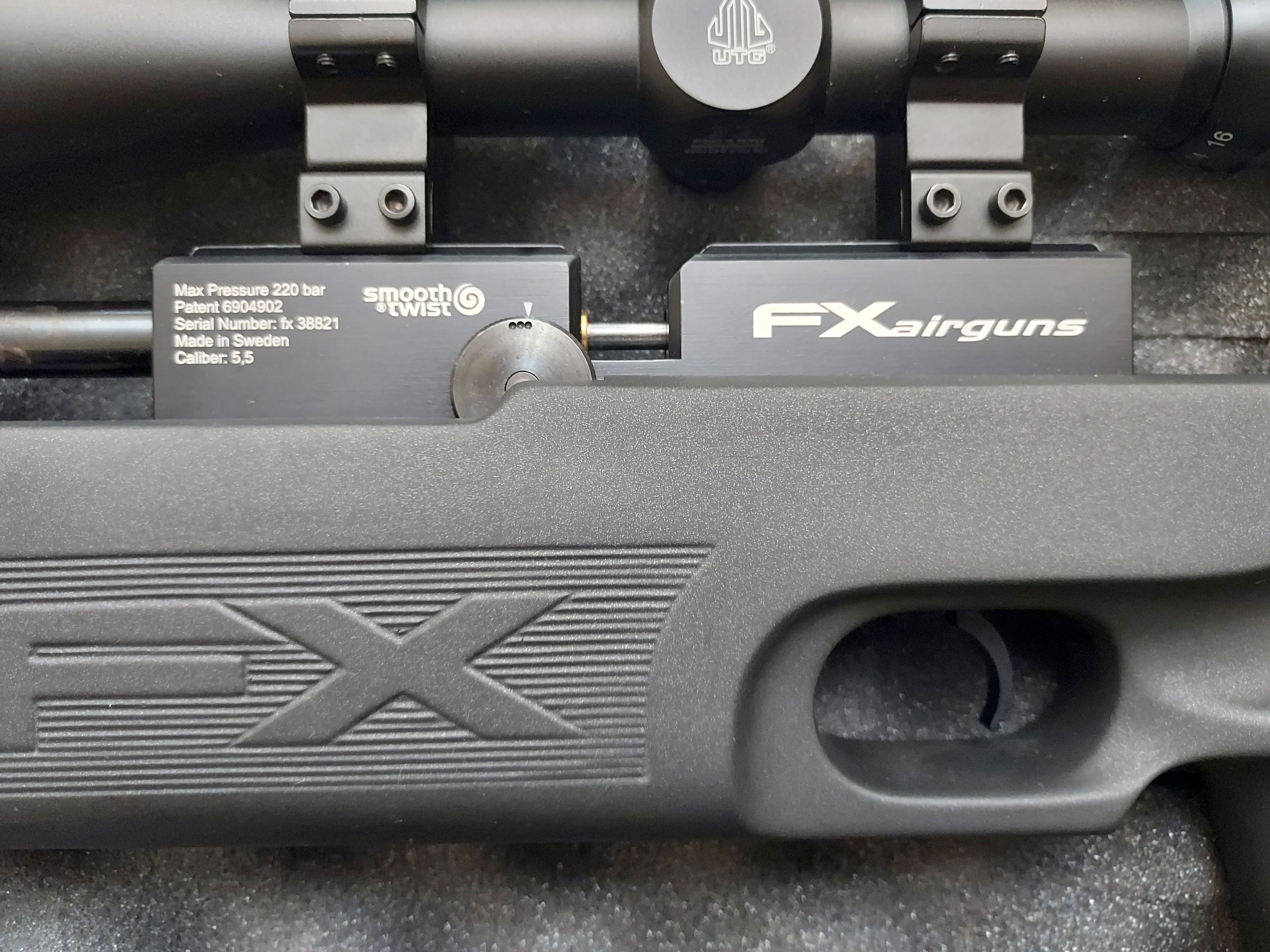

This is a FX Royale in 22Cal. with a UTG 4x16 Lighted scope. Gun shoots great, holds air forever, super quiet. Comes with 2 magazines and single shot tray. Gun is in nice shape, the barrel has a small discoloration up by the moderator i couldn't get it to show in pics. Due to medical issues just getting rid of some guns. Never been touched internally or anything else. $900.00 shipped to lower 48. Nice Gun! Can email or text me at 9892257424

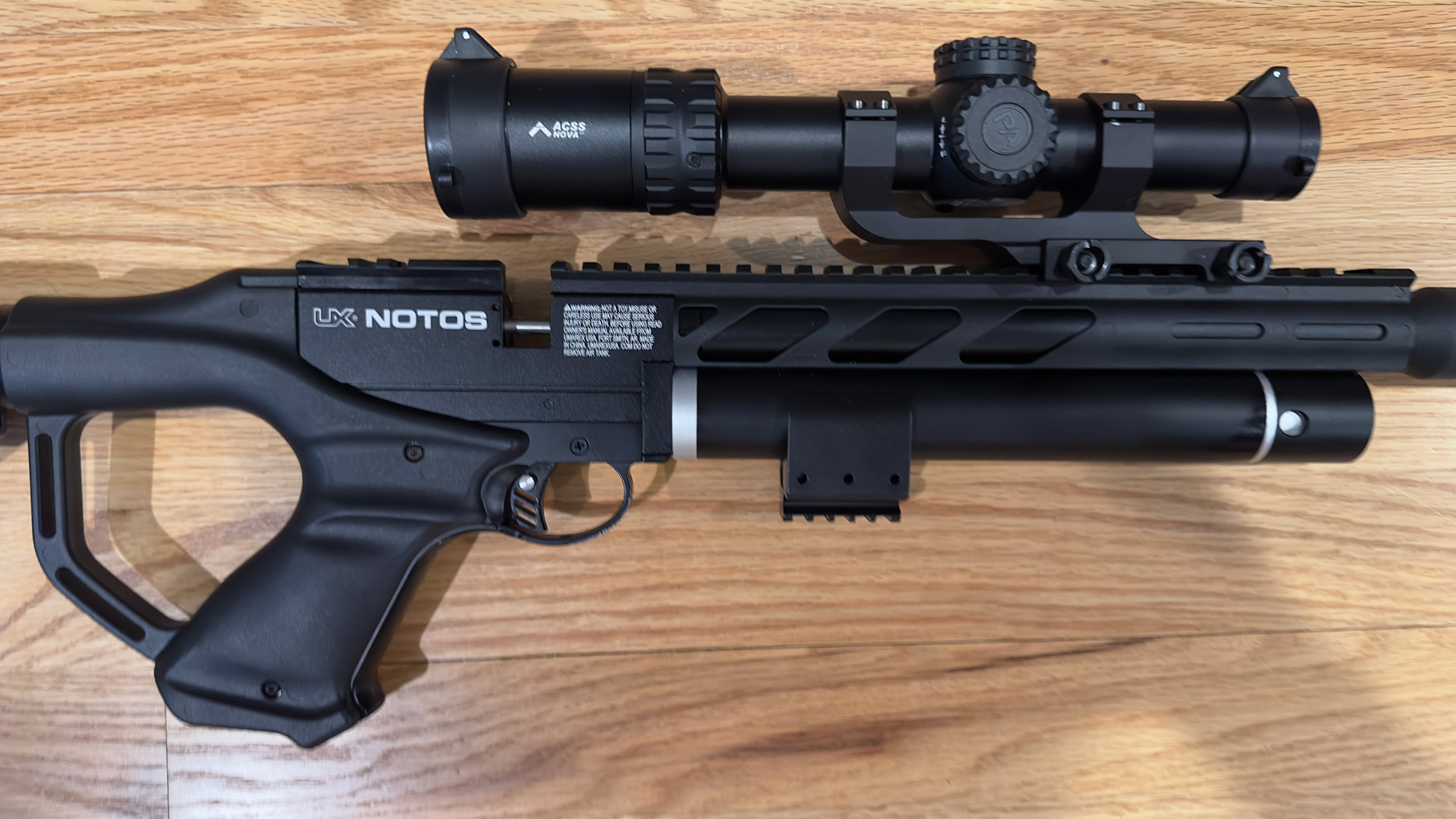

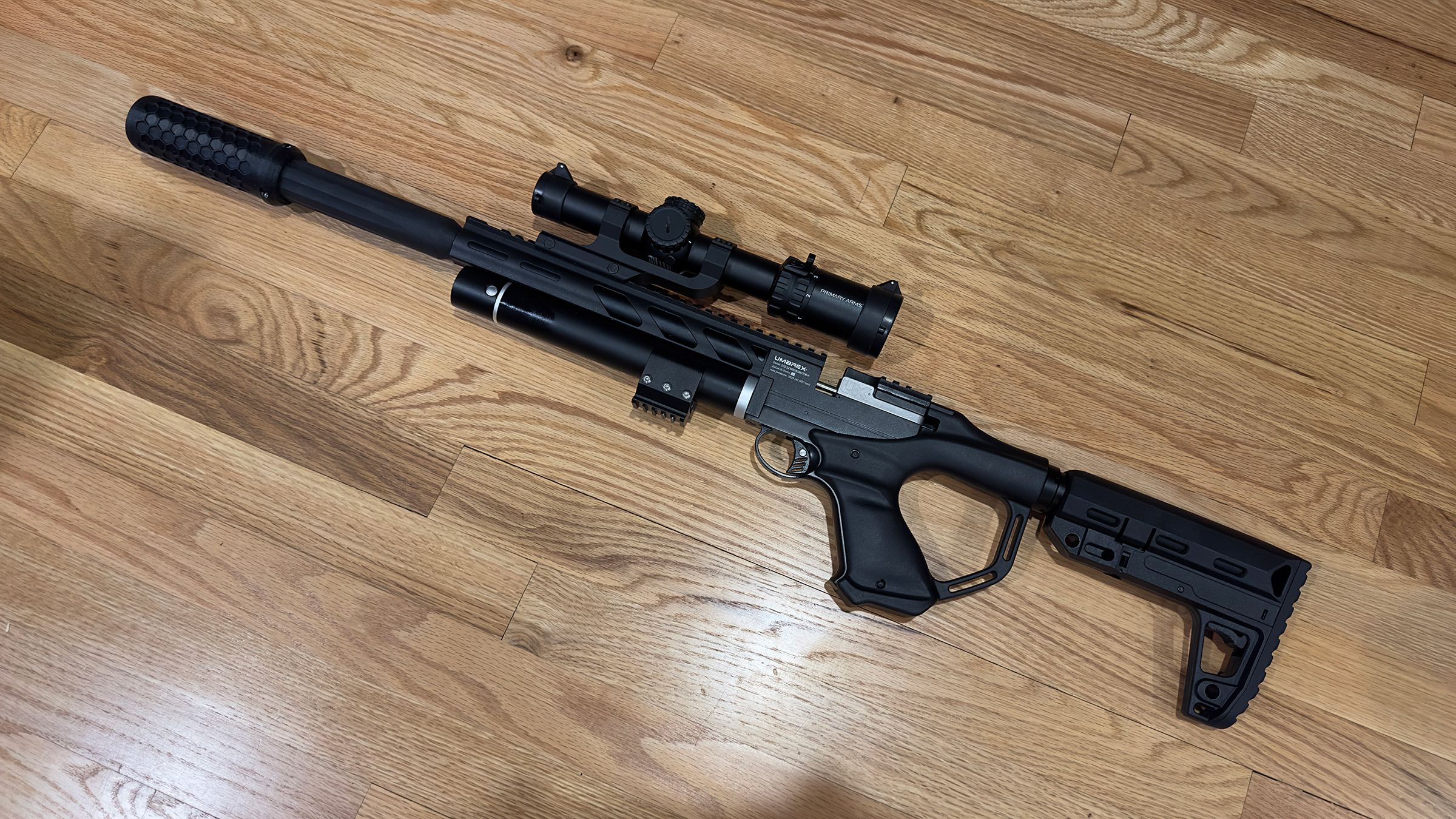

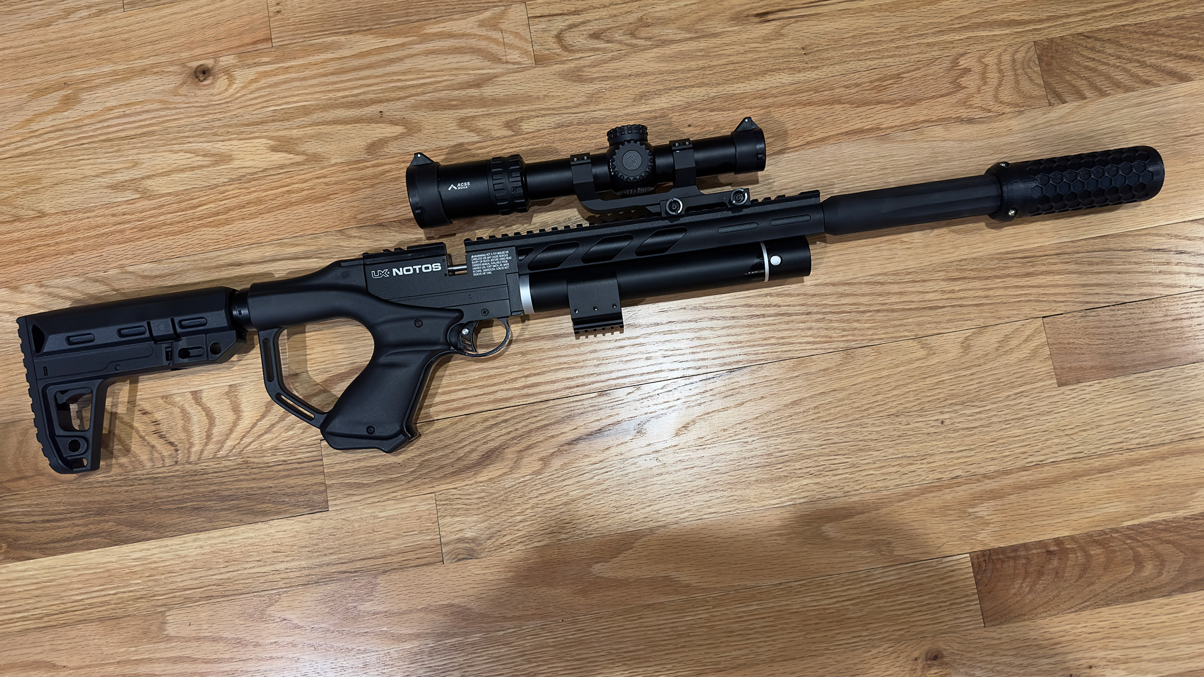

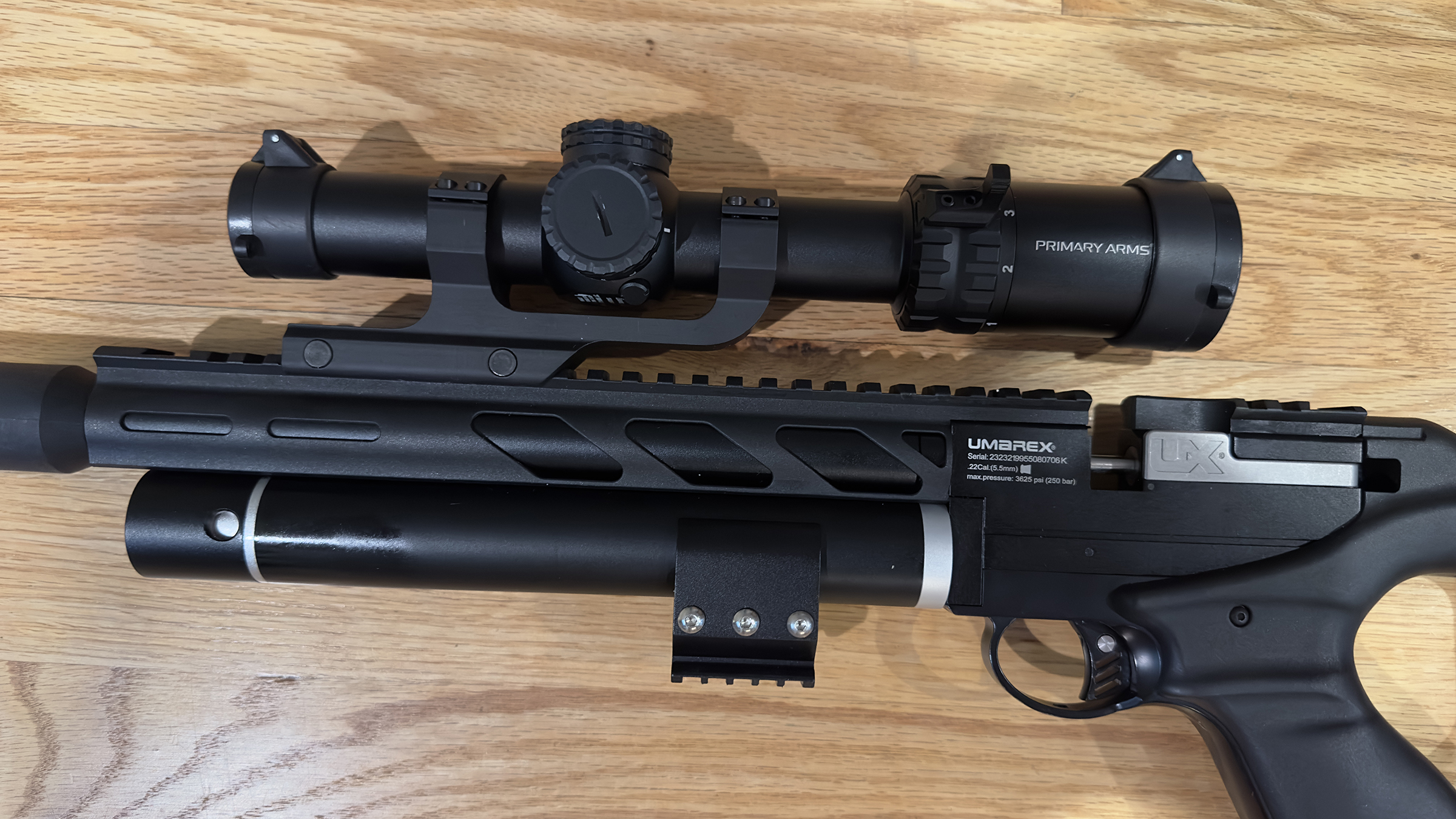

PCP Rifle  SOLD PRICE DROP Umarex Notos with upgrades and Primary Arms 1-6x24 SFP
PRICE DROP!
Umarex Notos with upgrades and Primary Arms 1-6x24 SFP scope
Notos - excellent condition – close to new, no scratches, dings, etc.
Accurate. No issues. Holds air. Includes fill probe.

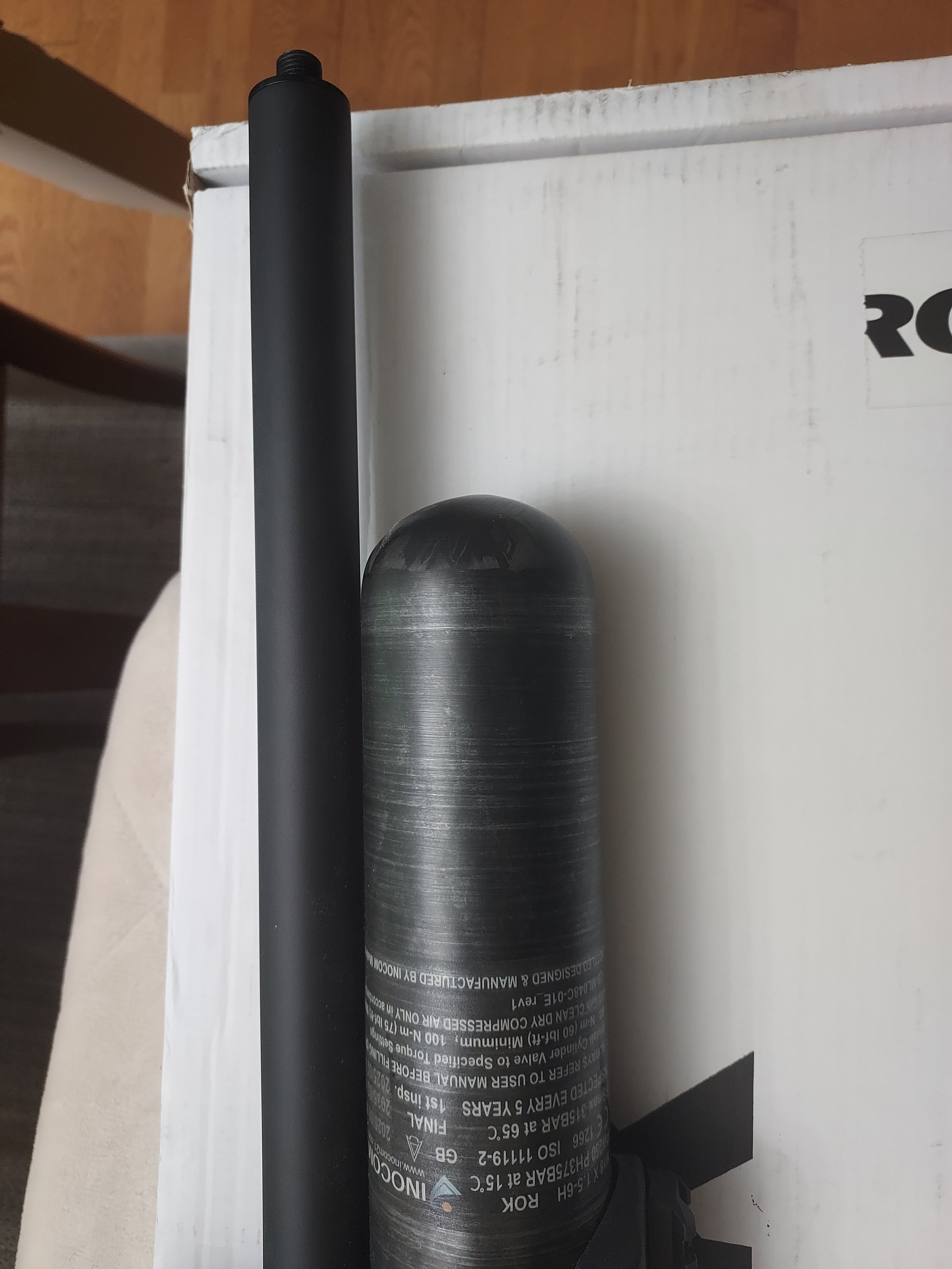

Upgrades include: bottle picatinny rail mount, RedCornOutdoors No Mod Moderator (installed on top of Notos moderator), Maple magazine (I discarded the Notos magazine as they never work)
Primary Arms 1-6x24 SFP scope – great condition
Selling as one package.
Less than 6 months old.
Rarely used as I moved up to another air rifle.
This is a great affordable starter PCP air rifle package at an affordable price.
Over $650 invested.
$250 + buyer pays actual shipping

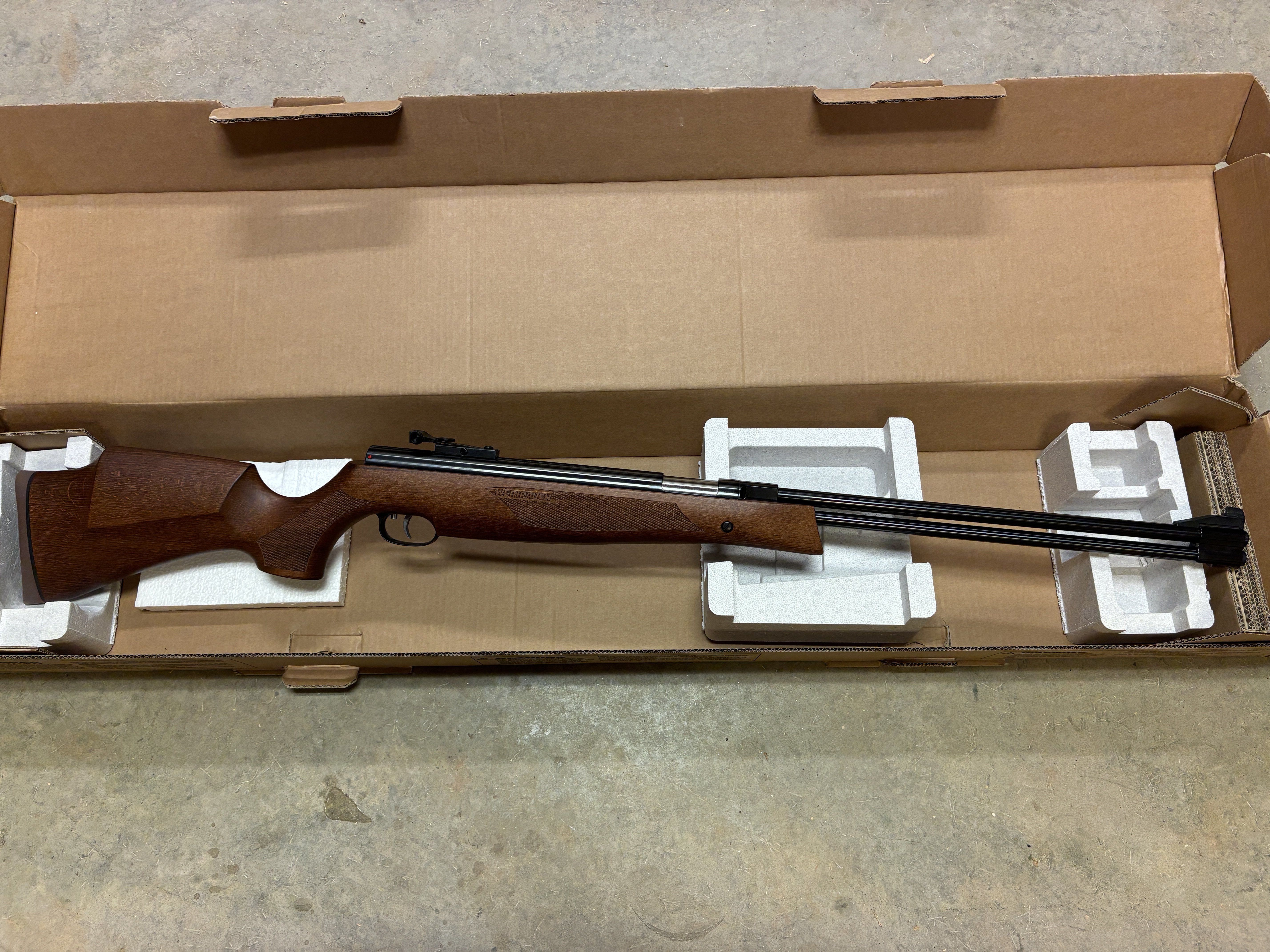

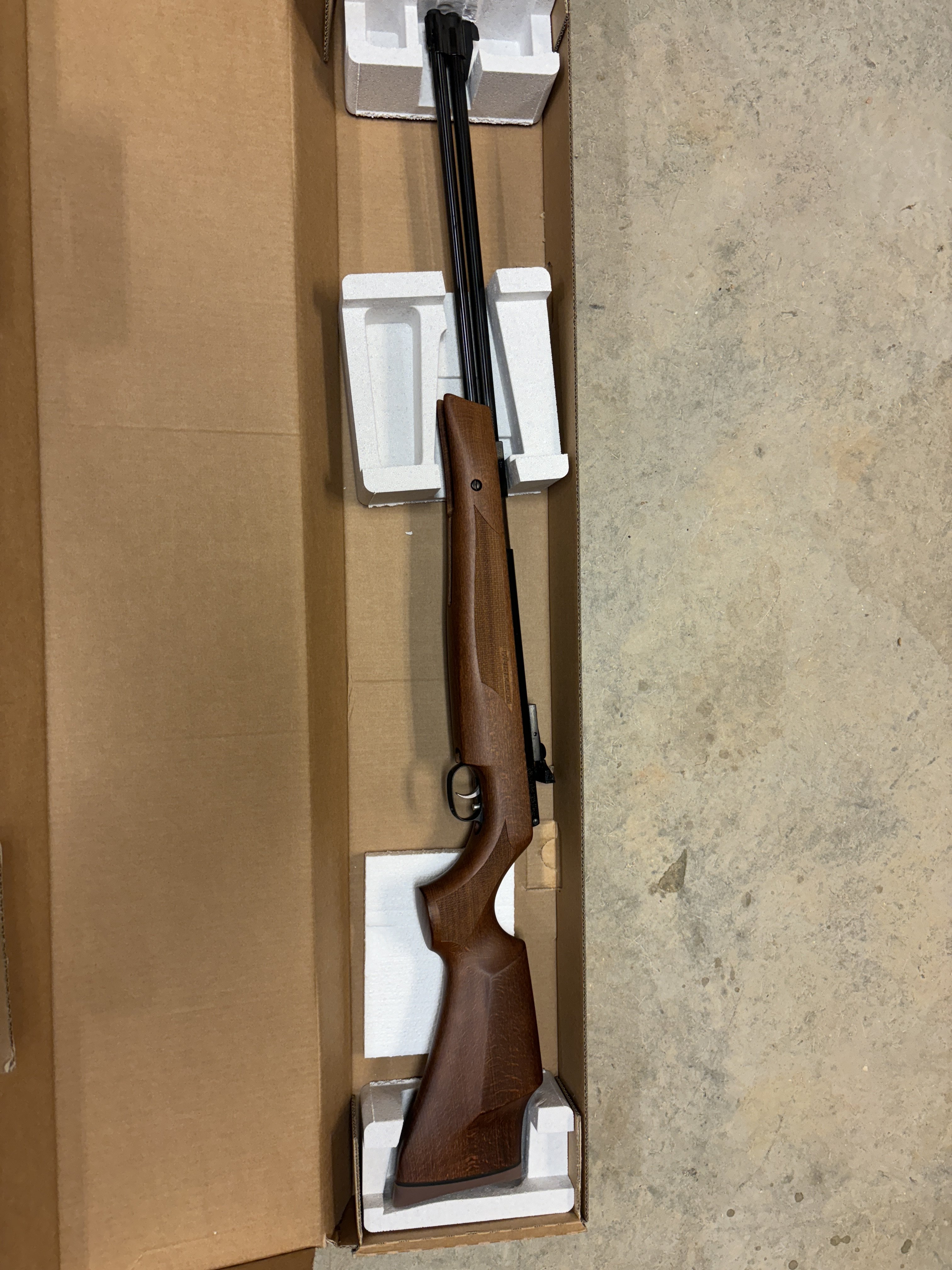

Traditional Rifle  NLA Weihrauch HW77 Rifle (not carbine) .177
FS: New HW77 rifle in .177, not the carbine. I purchase two of these years ago. My son and I shot one but this one remains untouched. The rear sight has not even been moved on the rail. This is a full power version at around 14 fpe. If you've ever wanted the full length version this is your chance. I can take other pictures if needed. Price is $600 plus actual shipping/insurance. I am open to trades. Perhaps an HW30/R7 in .177 or an HW50 in .22 plus some cash. It's a fine rifle, the bluing is deep and rich, not a mark on it. The other one we had shot incredibly. I can certainly keep it but I would prefer something that I can more easily use with my grandson. Thank you for your interest. I don't have a lot off feedback here but you can find me over at GunBroker and I used to be very active on the old yellow forum. Please PM with questions and offers. I accept PayPal and US Postal money orders only.
