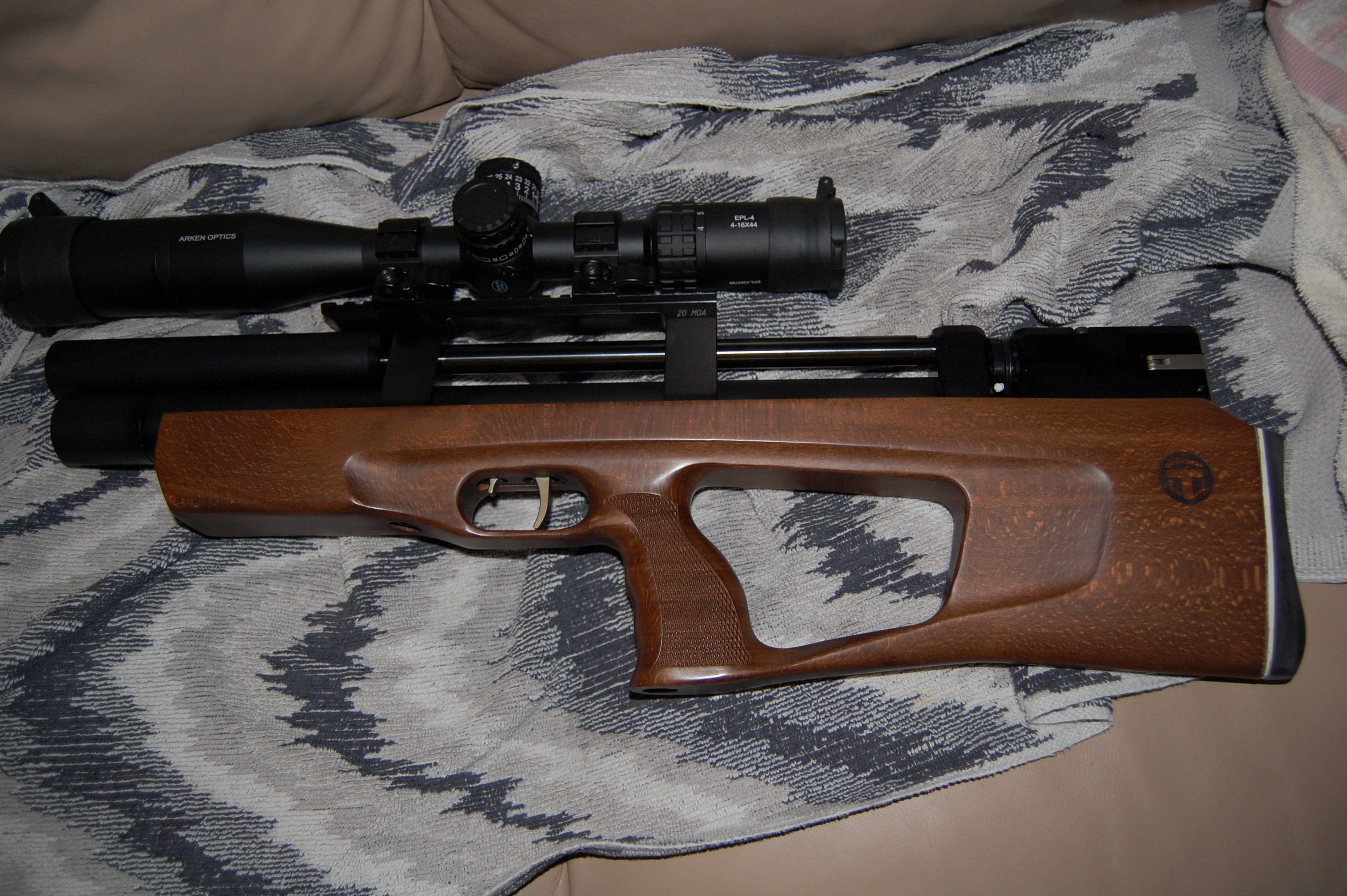

PCP Rifle  SOLD SOLD 👀 WTS: Taipan Veteran Compact / Short .22 with Arken EPL-4 scope / UTG medium rings PKG ! 👀
SOLD WTS: Taipan Veteran Compact / Short .22 with Arken EPL-4 scope / UTG medium rings PKG ! Used and in excellent condition. Comes with 4 magazines, 1 single shot tray, fill probe, and spare o-rings. Payment by Zelle, PayPal Friends and Family. Please, no trade offers. $1325.00 PKG CONUS 👀
Front flip-its scope cap retaining pin keeps moving out - extremely minor. Just have not figured out a way to keep the pin from working back out. This is a wonderful compact setup and unfortunately must part with. Been shooting crosman HP 14.3 premier pellets with great accuracy and have not used anything else for pesting purposes. No modifications, upgrades, or customizations have been made to the Taipan.
With no scope or rings, $1075.00 CONUS 👀

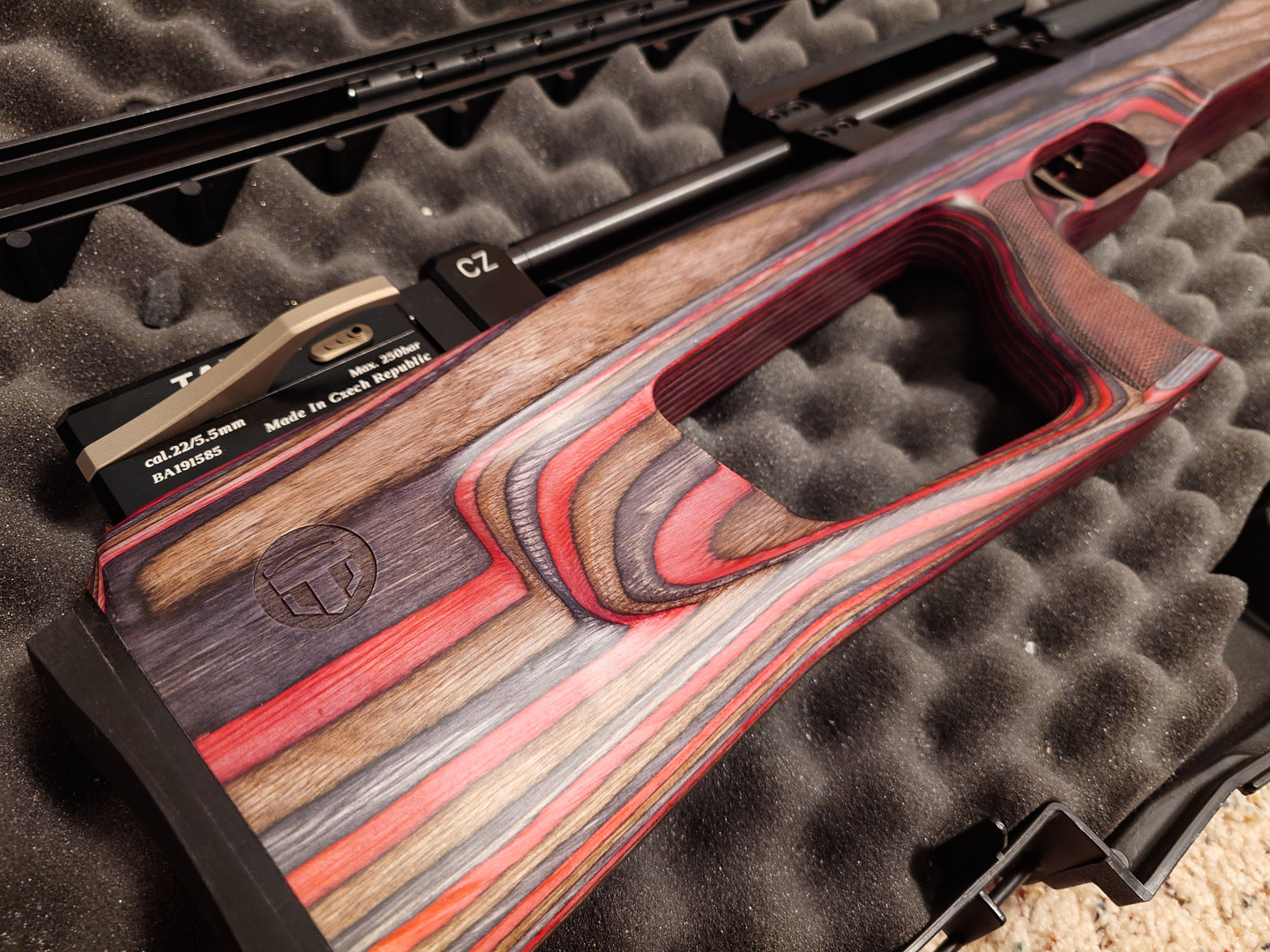

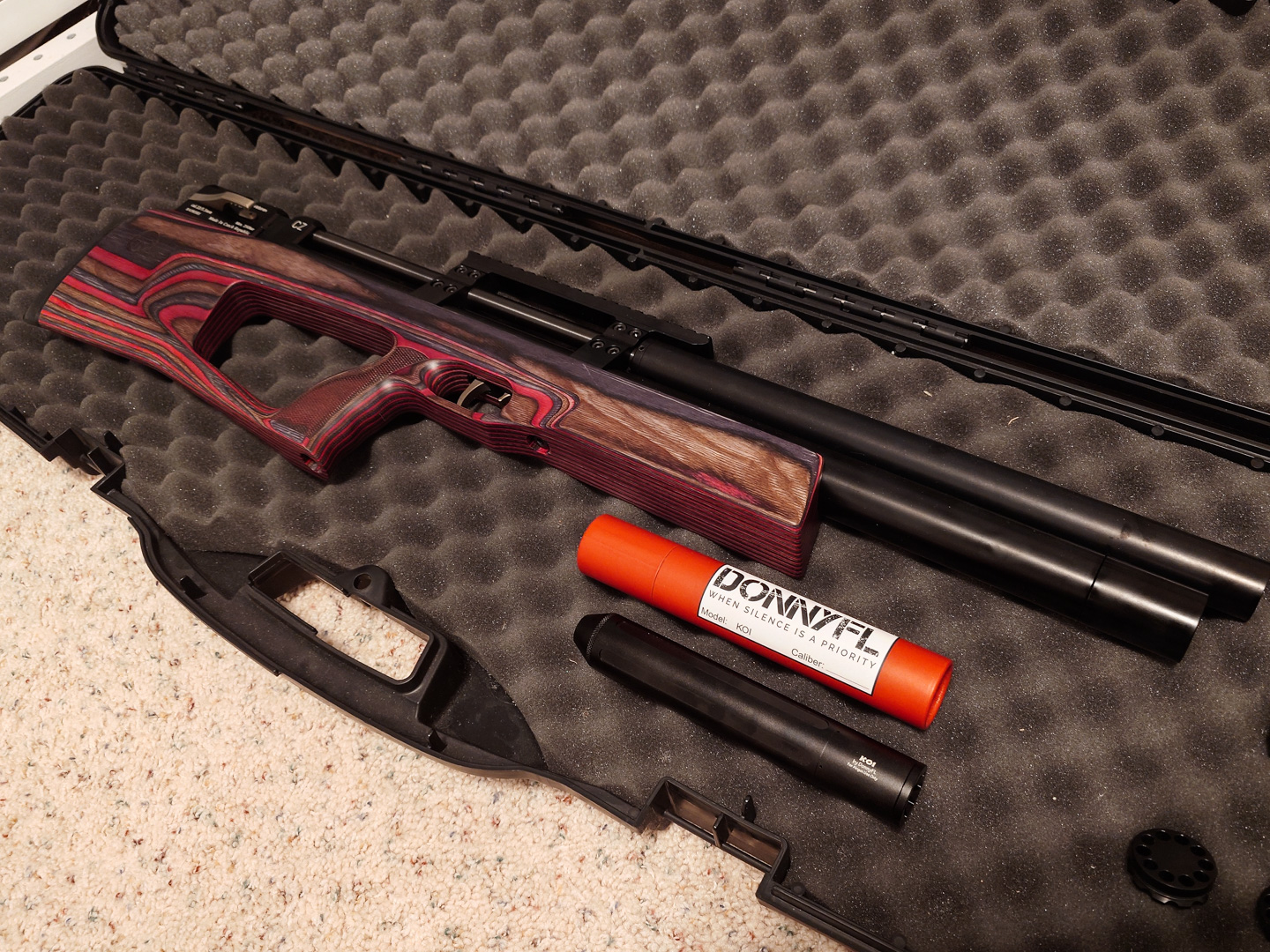

PCP Rifle  SOLD Taipan Veteran Long .22 Red Laminate Stock (Price Further Reduced) $875 shipped CONUS

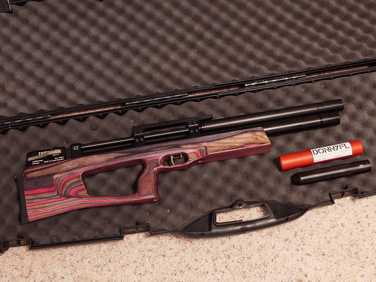

For sale is my Taipan Veteran Long in .22 caliber with red laminate stock. This was a standby backyard varmint rifle so it didn't see very much use. Total shots through it is 1459 according to my logs. It has never been out in the field as all of the shots were made either from shooting out of a window or indoors on a chronograph.
This gun has performed flawlessly with my time with it. Never had a leak. The stock regulator is set to around 145 bars and I have never adjusted this. I stored the gun at 125 bar fill pressure when not in use.

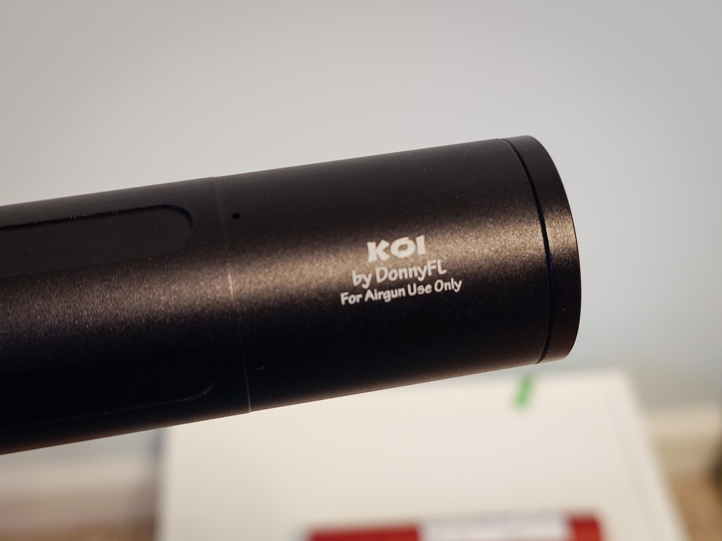

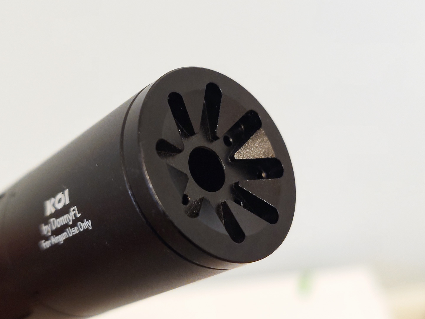

This sale will also come with the DonnyFL Koi (0.177/0.22 model) moderator. I used this moderator threaded directly on the barrel with the stock barrel shroud removed. This is how I recommend you do it as ideally, you would need a size up bigger moderator if you are attaching it to the shroud. You will also need to buy the proper adapter to do that.
This sale comes with everything the gun came with when I received it from Talon Tunes. It will also come with the 3D printed cheekpiece that I bought for it. You will need a double sided tape to install it on the receiver.
Please note that this does not come with the steel dowels to adjust the brass hammer spring tension. I didn't get those from Talon Tunes when I bought the gun and at the time, I didn't realized that they were supposed to be included. I've always just used two 3mm allen bits to adjust the hammer spring tension.
Accessories included as listed (if it is not in this list, please do not assume it is included);
2 magazines, single shot tray, fill probe with bolt-on male quick disconnect. Two metal dowels used to unscrew the cap at the end of the moderator, two pieces of 3D printed cheekpiece that needs double sided tape to install, DonnyFL Koi 0.177/0.22 moderator with cone endcap, serialized instructions manual with a test sheet from Talon Tunes.

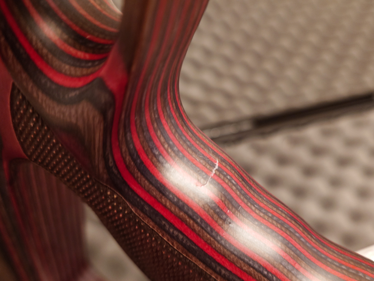

Please note that there is a slight ding on grip part of the laminate stock. Please see photo. This is how it came to me from Talon Tunes. Other than this, the gun looks very clean overall with no marks or scratches. Please be aware that although the gun is in perfect condition, the nature of the finishing of the anodization is not perfect from the factory. They are all like that. The finish on the metal is not the very shiny type as seen on something like the Air Arms TX200.
$1065 $950 (or $889 $875 without the DonnyFL Koi) shipped to continental USA. PayPal or Venmo payment. I am in North GA and can meet up in a safe place for transaction.
I understand that I don't have feedback on this forum yet. I sold a gun here a few years ago. I am CarnivoreGreens on eBay with 1000+ feedback on there. For validation of my selling reputation, you can send me a message over there and I will reply back to confirm.
Thank you for looking.

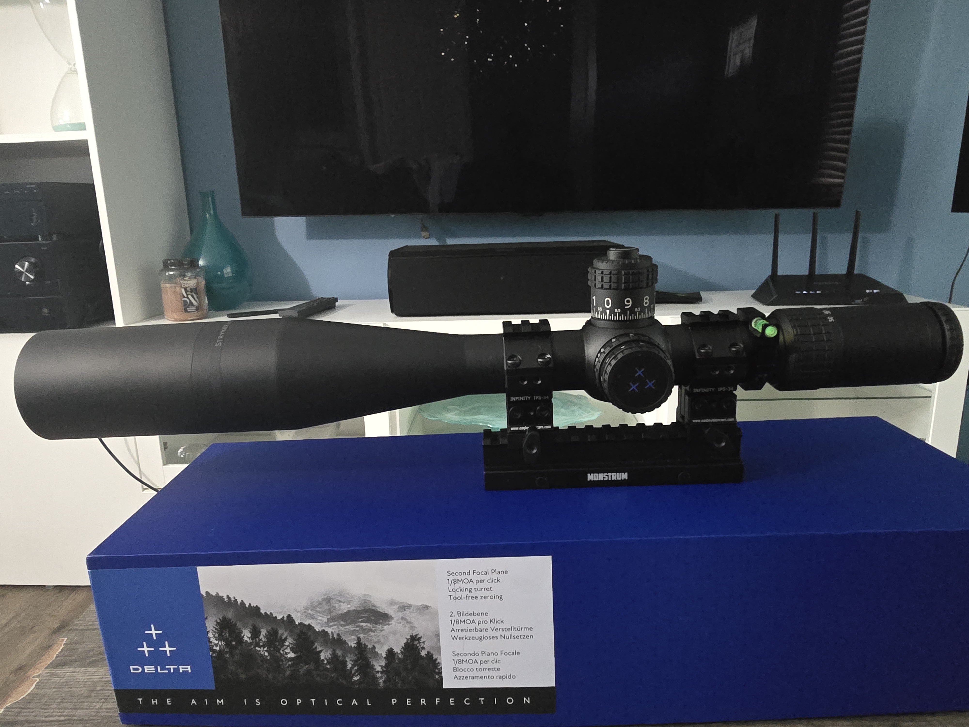

PCP Rifle  NLA Delta Stryker 5-50-56 $1200

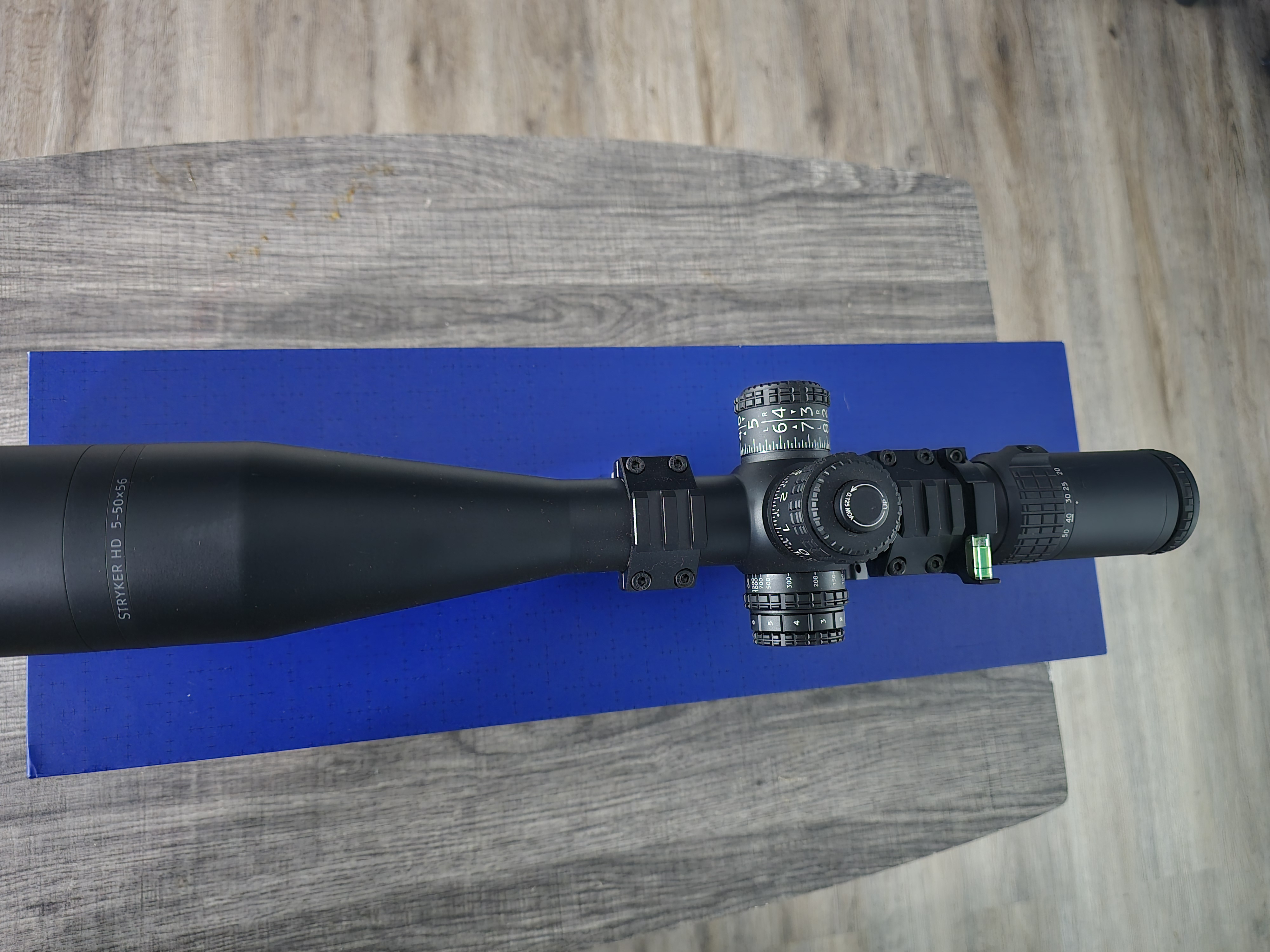

Up for sale is a great condition Delta Stryker. It was used on my .30 Skout epoch that I don't own anymore, so it needs to go to someone who will enjoy it. I will let it go for $1200 shipped to your door with insurance. Call or text Keith 513-479-3630 rings not included. I may trade let me know what you have.

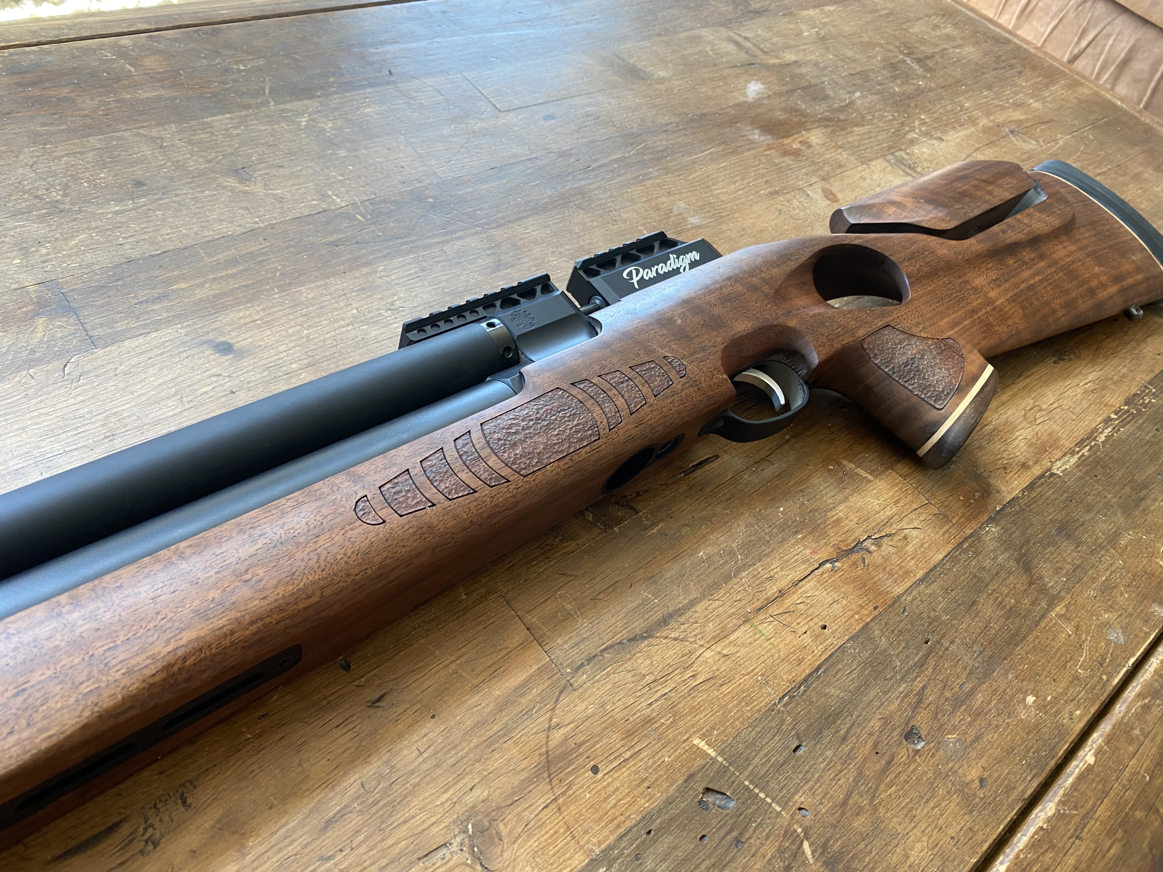

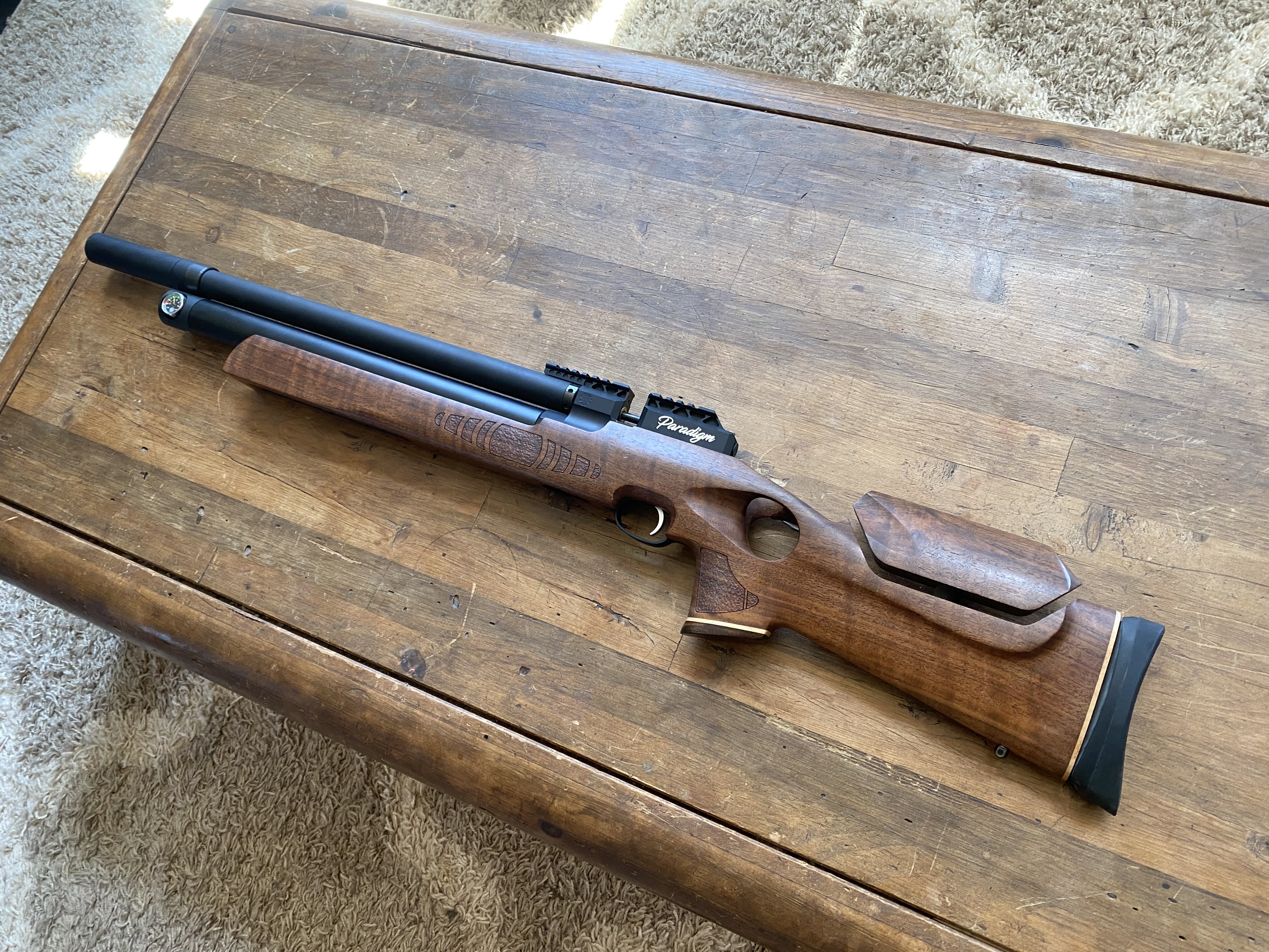

PCP Rifle  SOLD Weekend SALE PRICE! AAA Paradigm .30 $1900! OBO + Free Shipping!

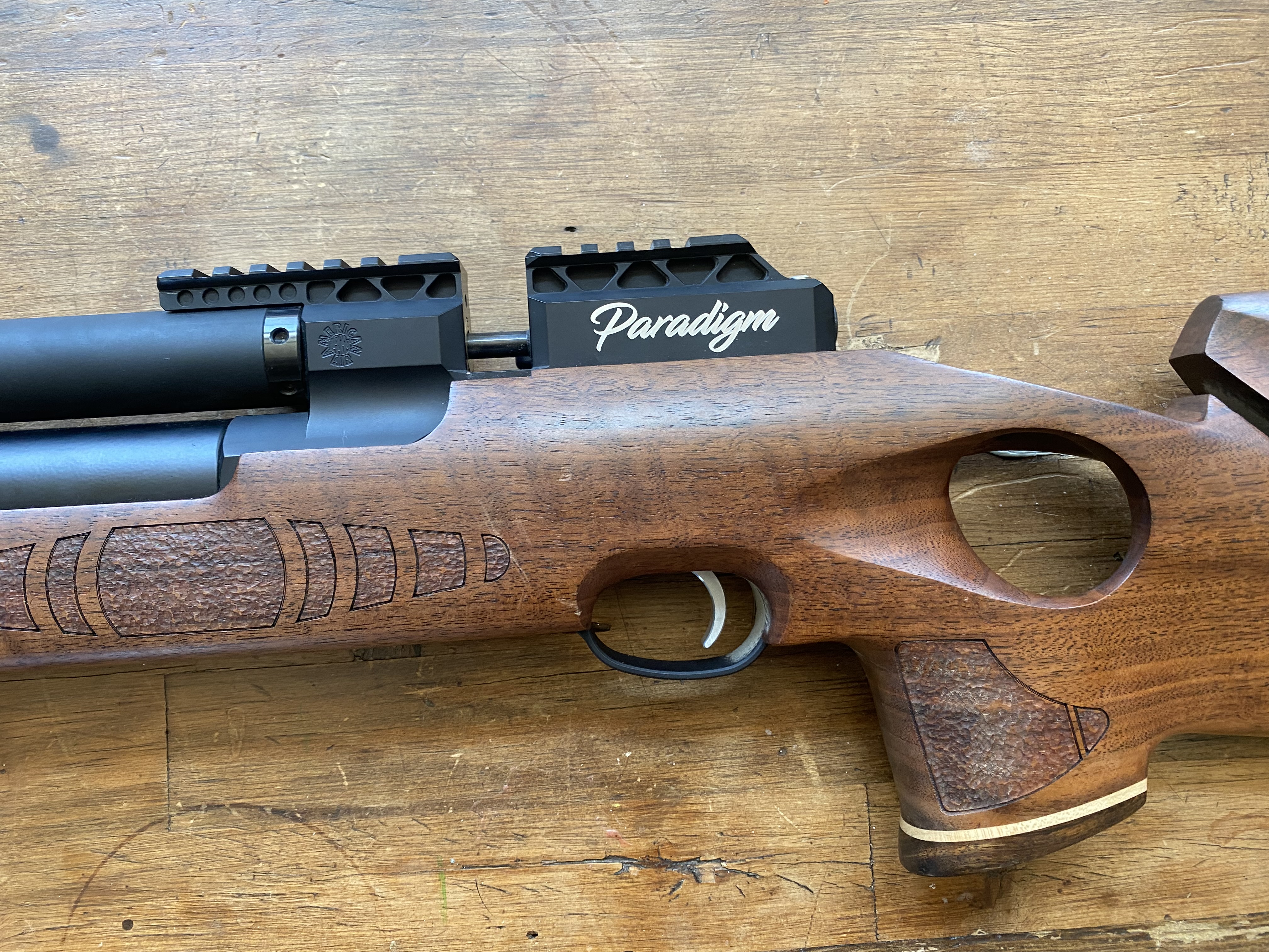

I have this American air arms paradigm .30 cal available for sale. Used it in some review work and a few competitions. But I’m moving in a different direction and rather than let this beautiful airgun sit around. I figure one of you guys should to put it to good use. Literally nothing wrong with it other than a few scuffs on the stock, this is an extremely well-made and accurate airgun And I am offering it for a good discount off of what they sell for new. I’m offering it for a special discount this weekend (8/23 -8/25) $1900 including free shipping and I’m open to offers so please hit me up, text as best at 928-846-0437.
