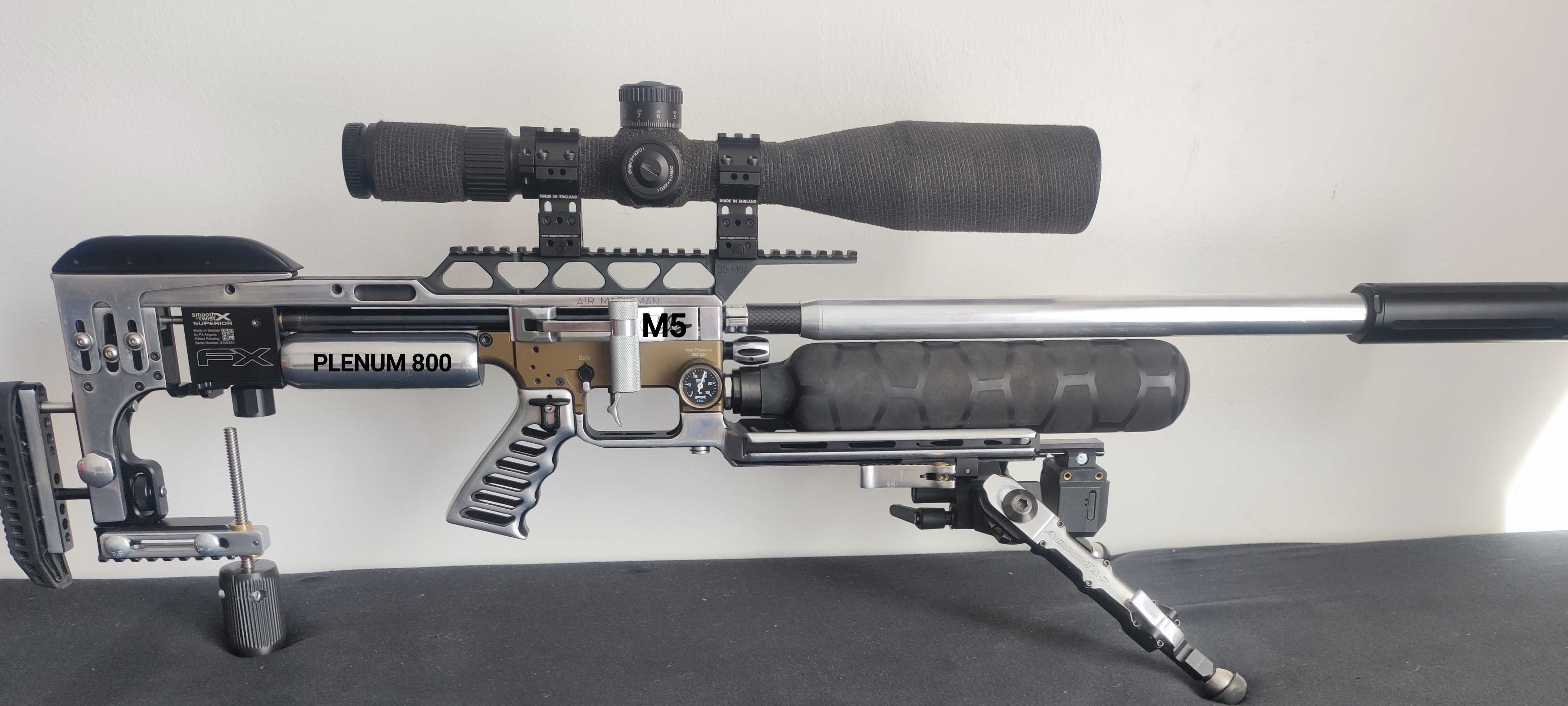

FX  How many dry shots to bleed the plenum?
Hi,
I've been arguing with someone about how many shots you need to fire before the 62cc micro plenum of the FX PANTHERA HUNTER COMPACT bleeds.
He said that a good rifle will bleed in 1 or 2 shots.
I said that according to power settings of reg and hammer wheel it can get empty after 1 or 2 or even 10 shots.
Can anyone set the reg to something around 100-120bar and tell me how many shots it takes to bleed the plenum while tank is removed ?
Please help as I want to return the rifle I have cause I think it's faulty somehow in a valve.
But the seller doesn't want to accept the return as he said I have a better than normal piece.

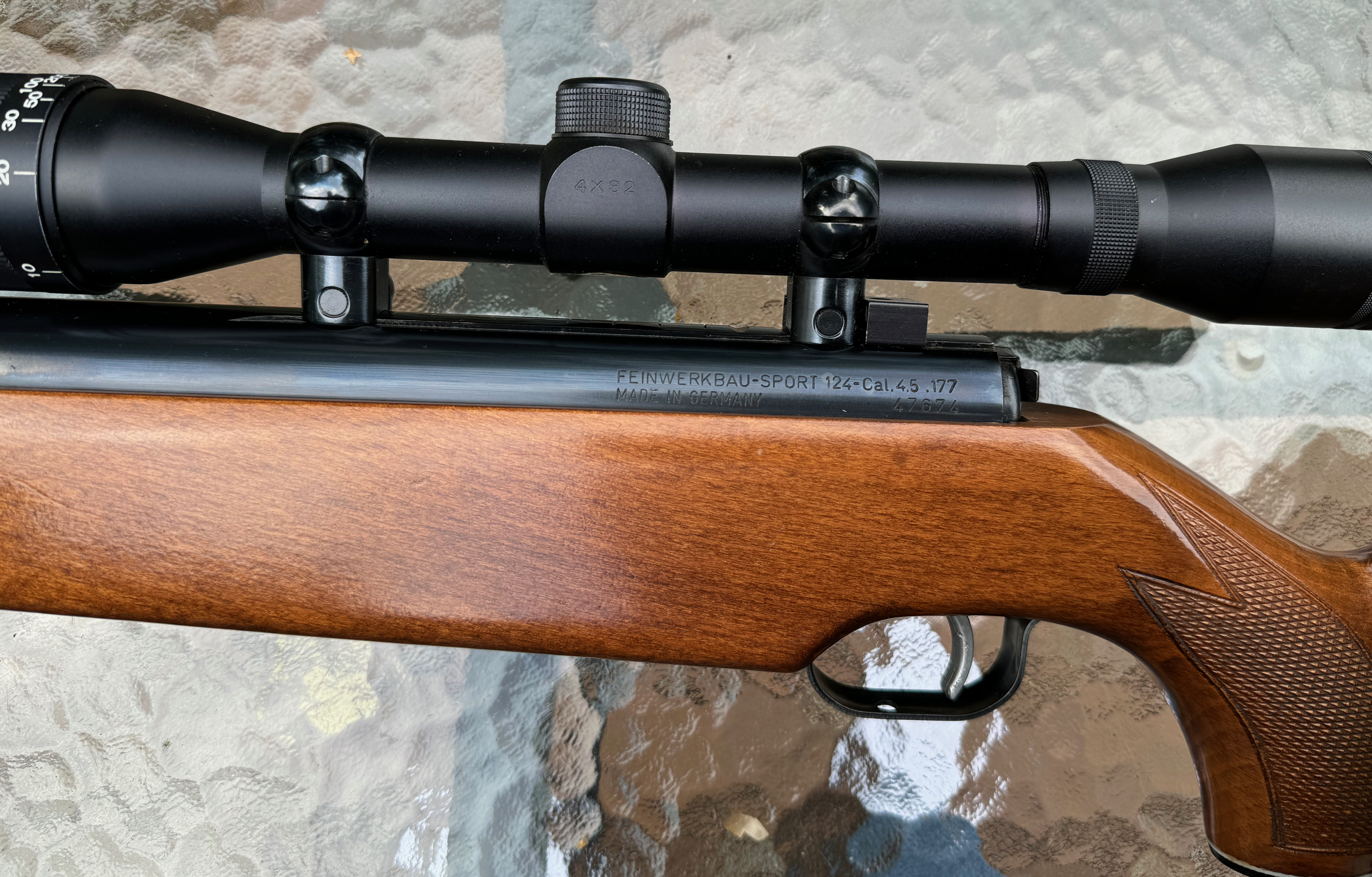

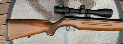

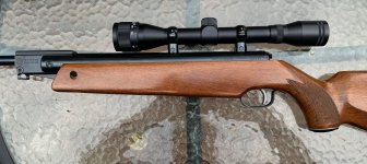

N/A  Springer valuation help needed: HW35 and FWB 124 Sport
Hello, it turns out I am not much of an airgun guy and just shoot yard varmints with my old Sheridan. Just pulled these two out of the safe and would like to move at least one of them.
Can you give me a range of value for each one? HW35 and FWB Sport 124.
Thanks in advance.

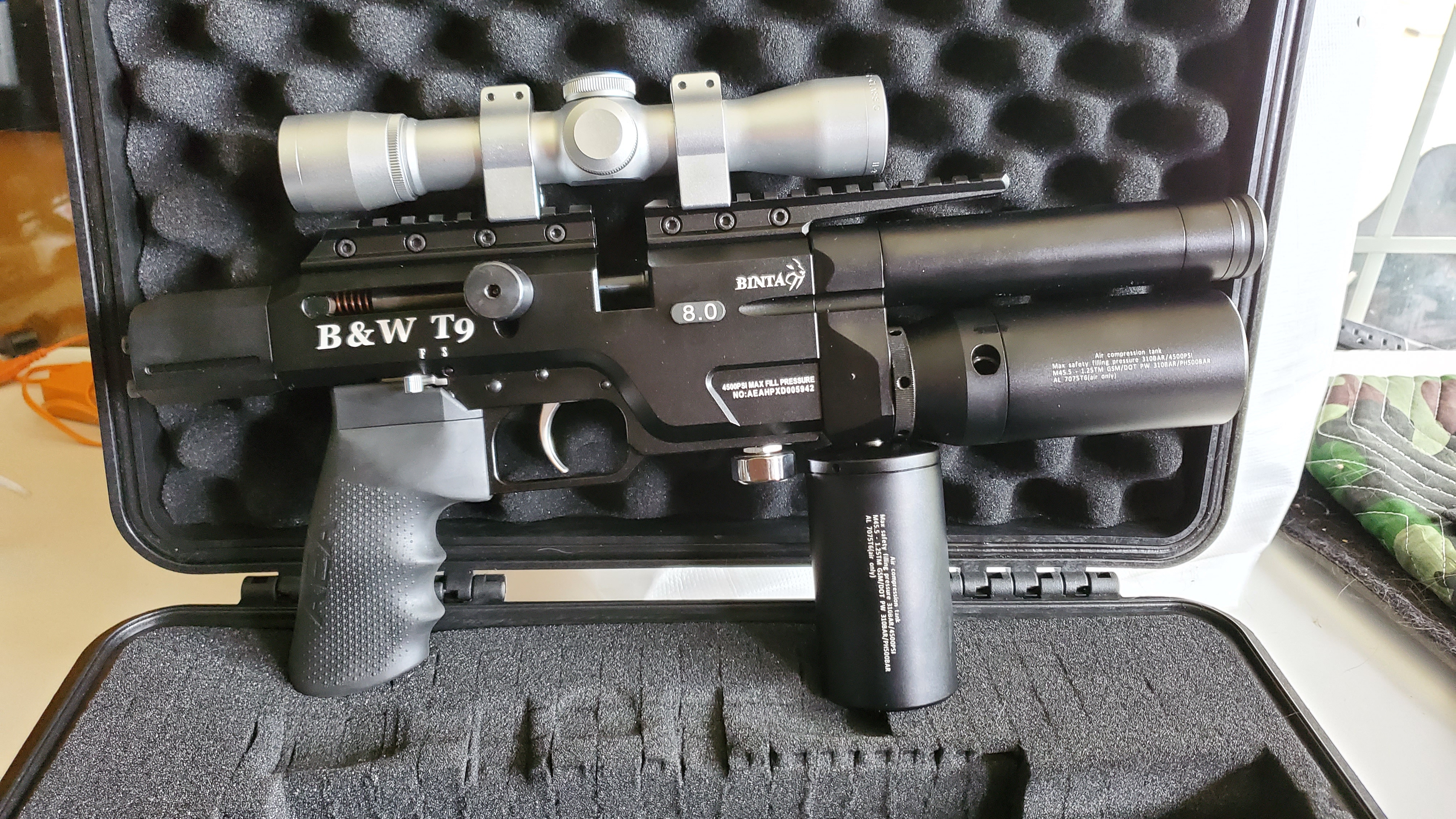

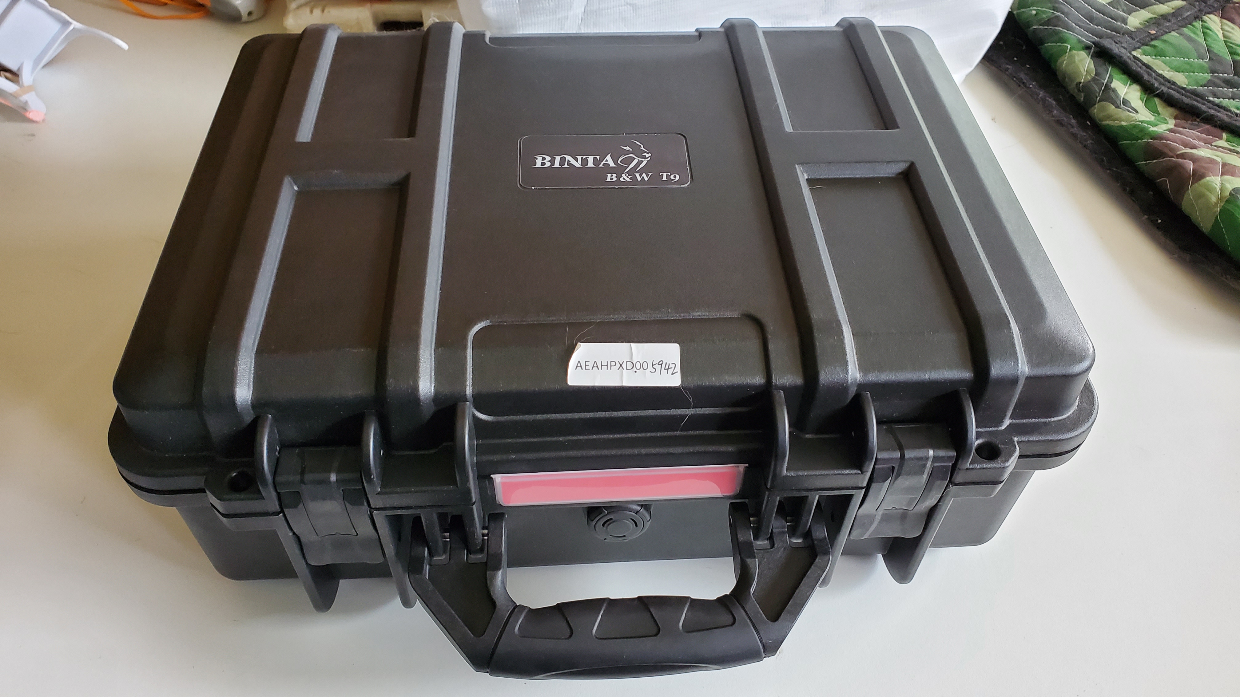

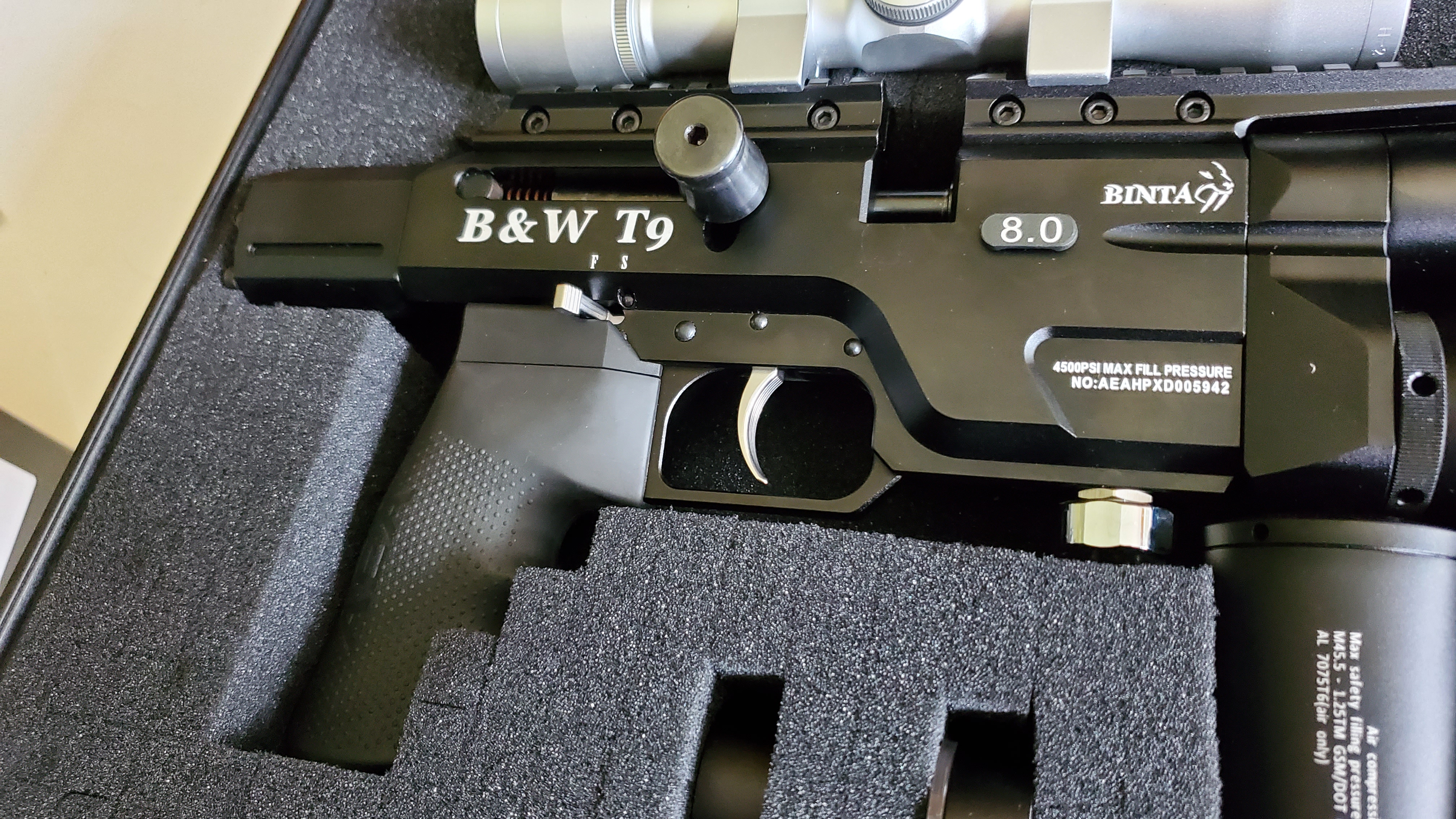

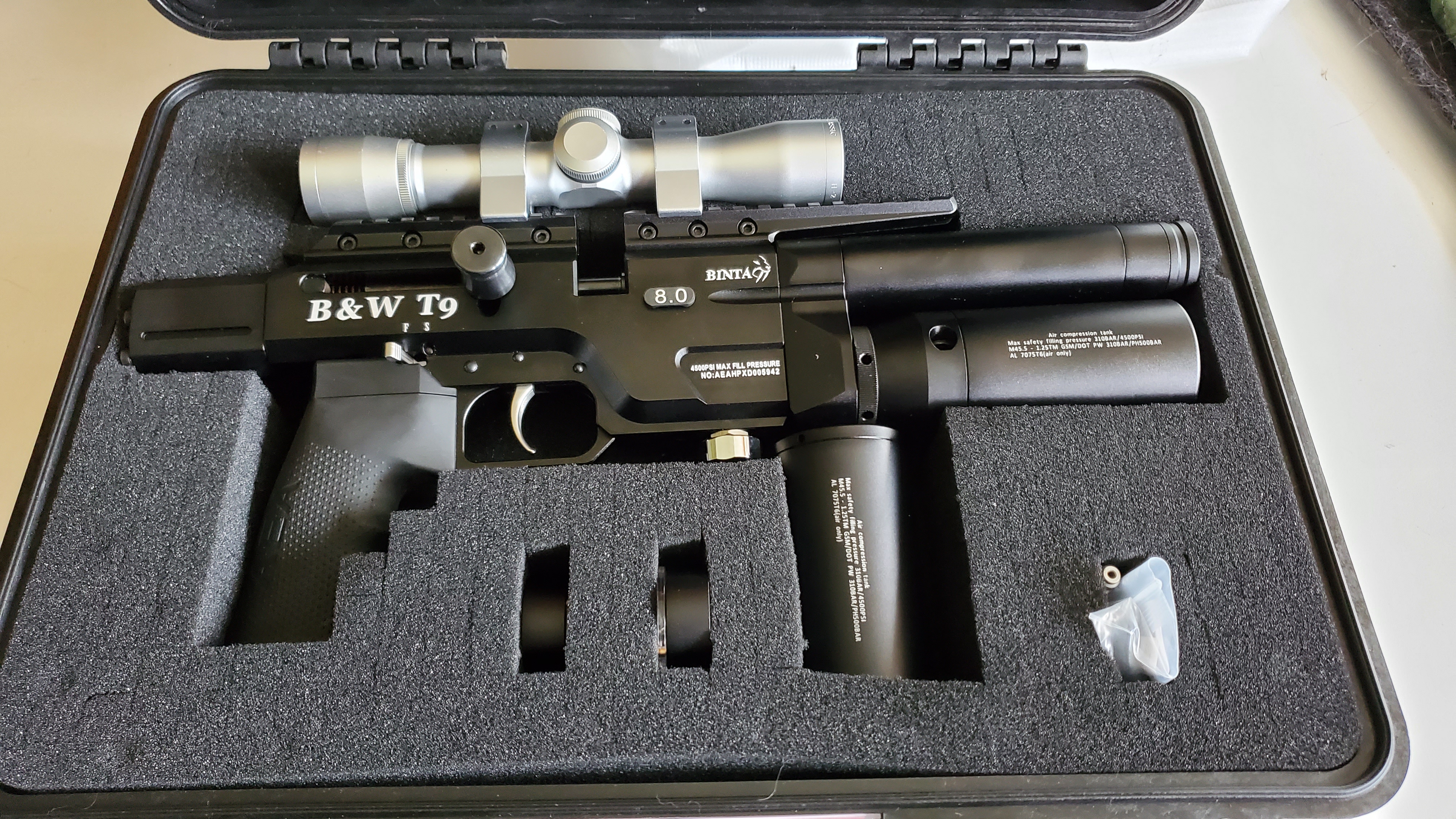

PCP Pistol  SOLD As New T9 Pistol w/ Case (Semi-Auto .357/9mm)
This thing is extremely accurate. .357/9mm semi-auto. Can use one or both tanks. Brand new from Airgun Tactical. Only shot from the bench to film the promotional video, then put back in the box. Brand new condition. Includes case and 2 magazines. Scope not inlcuded. Full video here. You can PM me here or email me at [email protected] or call or text me at 360-844-0962
$799 + free shipping.

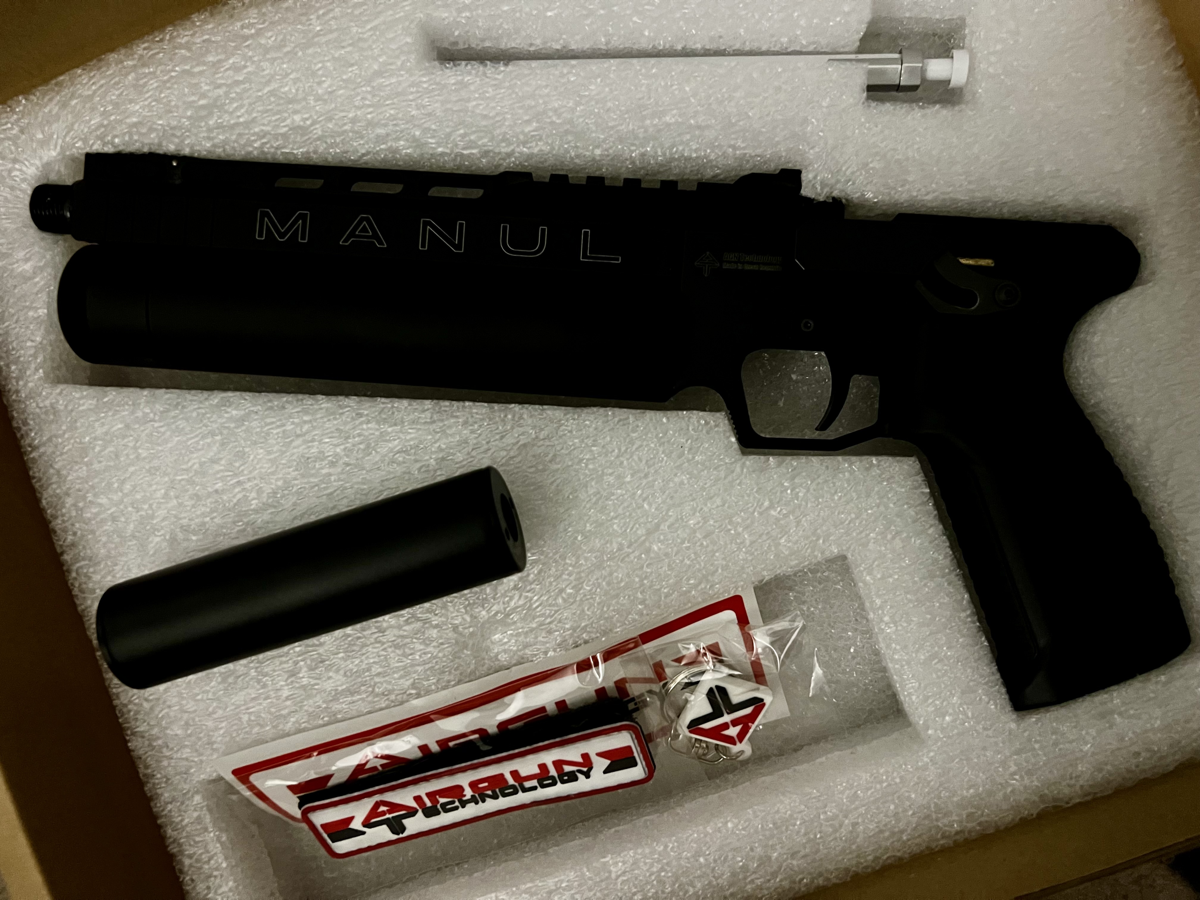

PCP Pistol  NLA For Sale: Airgun Technologies Manul .22 Caliber PCP Pistol – Precision, Power, and Pure Fun! Updated Price
Looking for an airgun that perfectly blends high-quality craftsmanship with pinpoint accuracy? Look no further! I'm selling my Airgun Technologies Manul .22 caliber PCP pistol – and trust me, this beauty is not just a piece of equipment; it's an experience.
**Why You'll Love It:**
- **Top-Notch Build Quality:** Crafted with meticulous attention to detail, the Manul is built to last. Its robust construction and sleek design make it a reliable companion for both seasoned shooters and beginners.
- **Unmatched Accuracy:** Whether you're target shooting or pest control, this pistol delivers tight groups consistently. The precision-engineered barrel ensures every shot hits its mark, making it perfect for those who demand accuracy.
- **Super Fun to Shoot:** The Manul isn't just about performance – it's about enjoyment too. Smooth trigger action, customizable settings, and a satisfying feel make every shooting session a blast.
Whether you're adding to your collection or looking for your first high-quality PCP pistol, the Manul is a choice you won't regret. I'm looking to sell quickly, so don’t miss out on this fantastic deal!
To quiet its bark, and as an added value to the low price, I’m including the attached AGT LDC for free as well (see pictures)…
Payment of $749 $729 get this pistol to you with prepaid USPS Priority Mail for free (or UPS Ground if you prefer) - for this sale, I’d prefer PayPal only with F&F - I believe my feedback merits not letting PayPal take a 4% cut.
I have aggressively priced this over $100 below the lowest price ($150 below actually) that you can find on the web, in stock, because I have my eye on another project.
Why am I selling? Simply put, I have big hands and sausage style fingers, and this airgun doesn’t seem perfectly fit for my dexterity. YMMV.
Finally, I will be unreachable the weekend of the 24th - please be patient - I will respond to all inquiries on Monday evening, the 27th.
Thanks Friends!
Mark

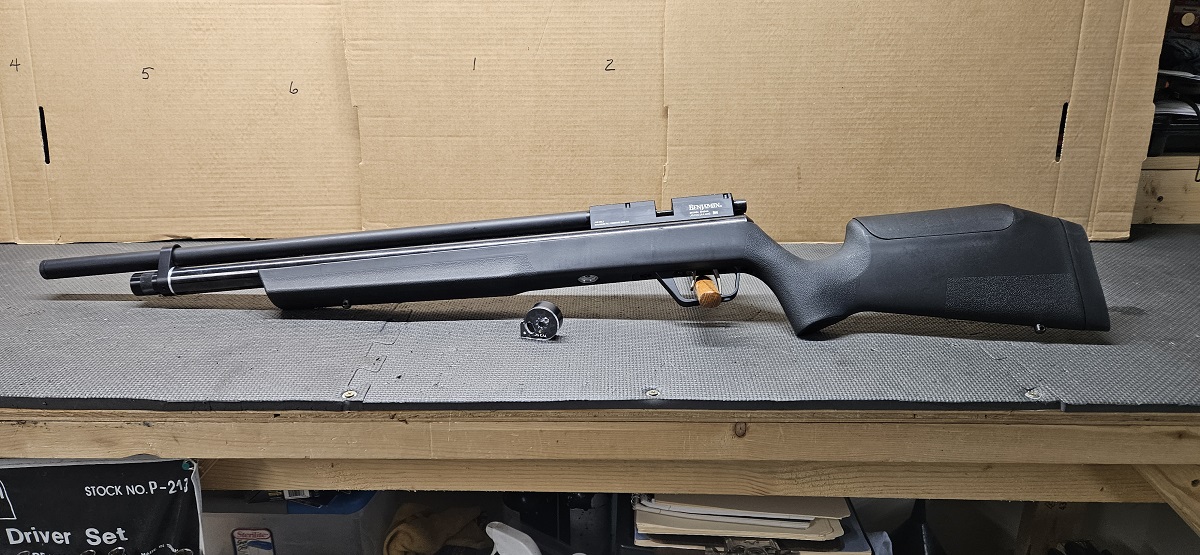

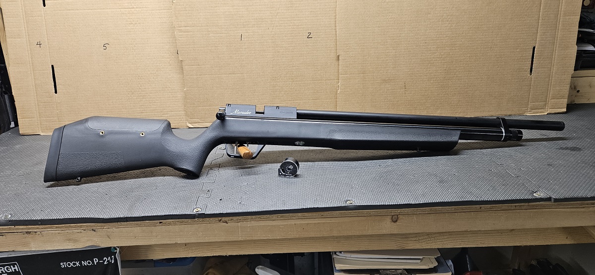

PCP Rifle  SOLD Benjamin Marauder 25cal Air Rifle SOLD
I'm thinning the herd so I have a Benjamin Marauder 25cal with 2 mags another impulse buy just wanted to shoot it some and I now have so it's also looking for a new home, holds air great now that I replaced the leaking oring between the gauge and air tube. It definitely shoots better than I can shoot it an it punched a ragged hole at 25 yards with JTS 25.39s it's pushing them in the 850 to 870s. Asking $285 shipped and insured...Thanks Terry
