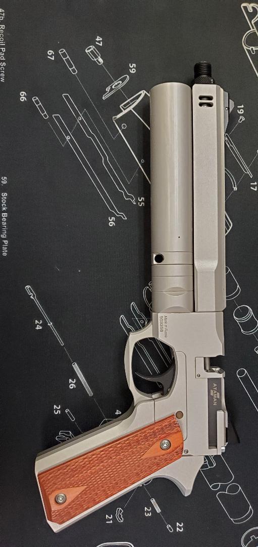

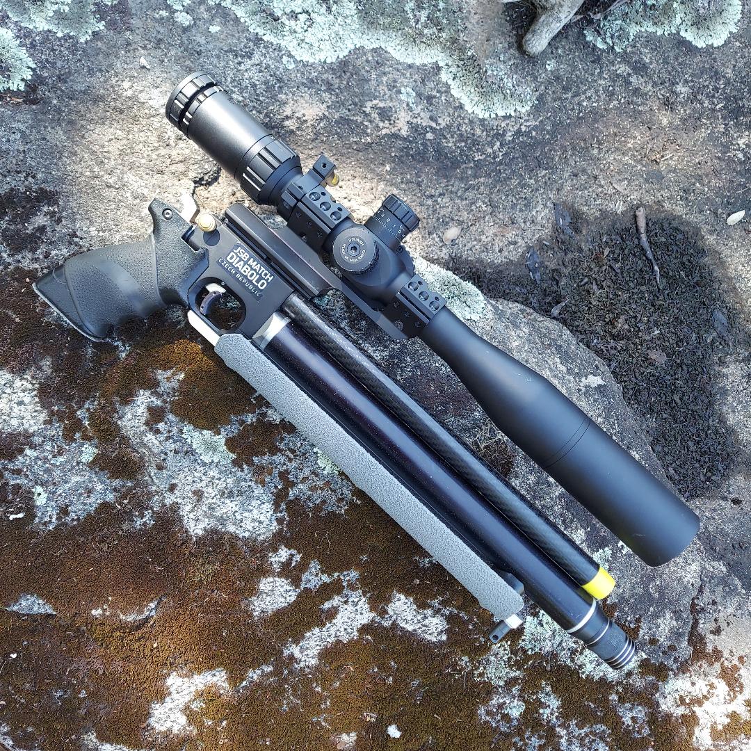

PCP Pistol  SOLD A VERY Custom AIRMAX "Field Target Pistol" in .20 caliber W/ Sidewinder optics.****SOLD****
Here is a twist on really improving and customizing a great pistol :love:
It is stellar accurate, easy on air at sub 12 being IMO a really trick set up & a 1 of a kind.
Yes a MOTORHEADS custom built for myself a couple years ago ... Seldom shoot it, so thinning the herd sorta speak.
Power can adjust sub 12 to near 20 fpe for extreme use if desired .. can adj it pre delivery ;)
Starting with an Airmax PP700 we did internal trigger work & fitted a trigger shoe. Altered porting valve to barrel, Peek poppet, HUMA in tube regulator using a custom extented Aluminum air tube with side gauge reading HP fill pressure. Fill foster on tubes end.
Barrel a Choked Lothar-Walther 12g in .20 caliber ;) set at a legal max 15" with the HW breech seal modification fitted ... Yellow cap protects 1/2-20 threads if wanting an LDC. Full length grip rail attached under & forward of trigger guard ( Under the 3" rule )
Up top a Cantilever scope mount placing optics further forward, Scope a like new HAWKE SIDEWINDER 4.5-14x42 in 1/2-10x mildot w/ small parrilax wheel. BKL bubble level. 8 shot pellet holder on left side.
Sold as a package only ... Rtr as in Ready to rock !!
$675.00 shipped domestic

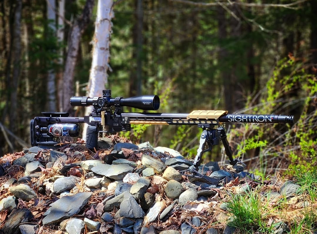

New Nylon6-Carbon Fiber Chassis Stock For FX DRS
I have been working on developing a new chassis stock for the FX DRS which leverages some of my current design work on the FX DRS.
Diamond Nylon6- Carbon Fiber Spitzer Chassis Stock for the FX DRS rifles.
Stock Features
Stock weighs 2 lbs
Adjustable Cheek Riser
Flexible Diamond Recoil Pad
Custom Length of Pull Available
7075 Aluminum M-Lok style rail panels.

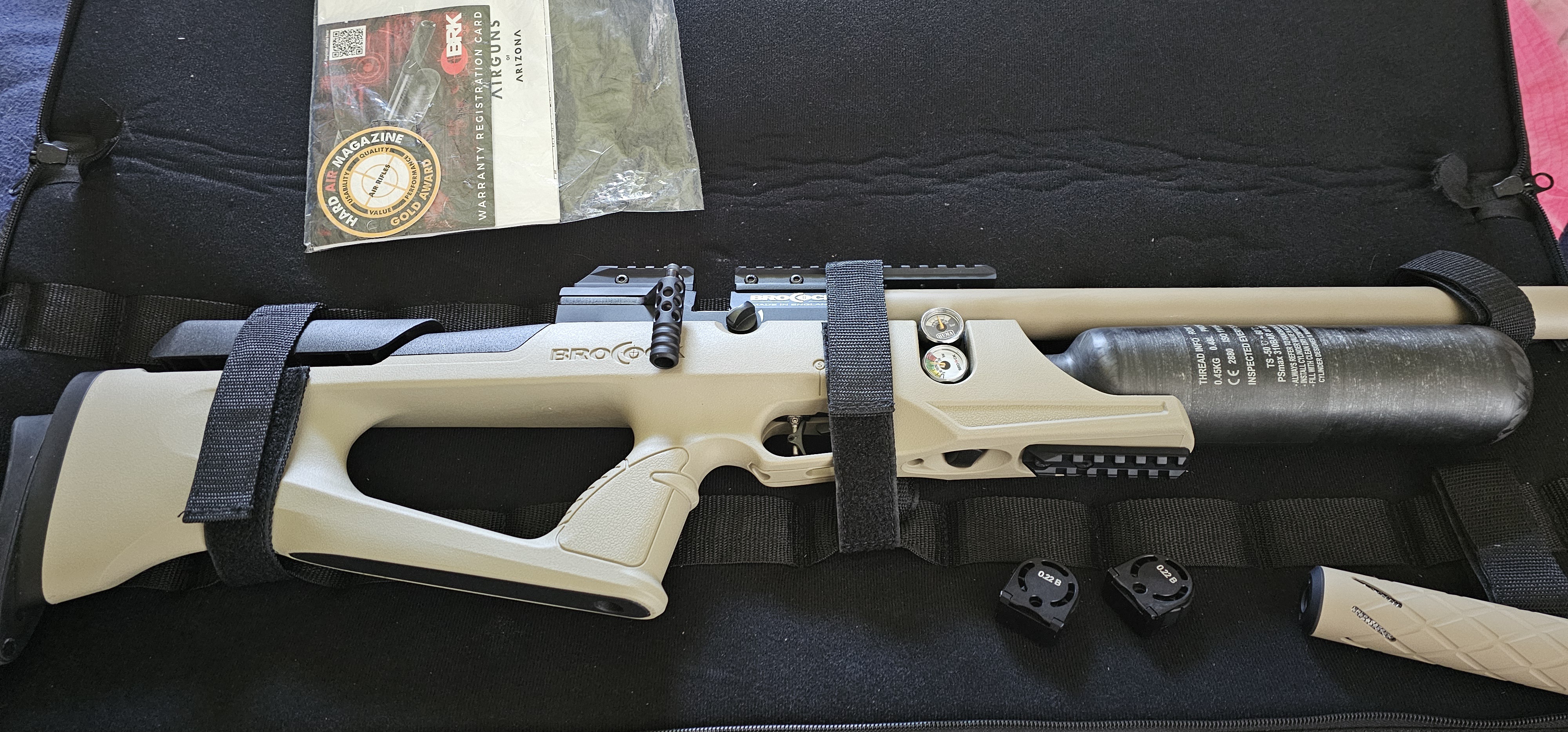

PCP Rifle  SOLD Brand new in box BRK sniper sahara XR for sale
Hello. I have a brand new in box BRK sniper sahara XR for sale. Zero shots, really brand new(only tested by AOA).
It will come with everything from factory and the silencer.
Im asking for $999 shipped
Please don’t ask me for a reason, there is no reason. I won’t hide any issues of the item that I’m selling here. Especially this air rifle has a warranty.
Thank you.

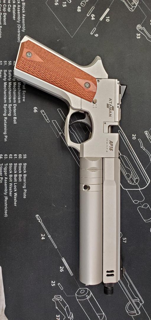

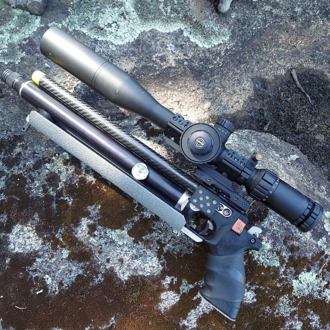

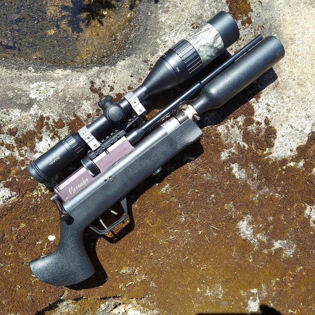

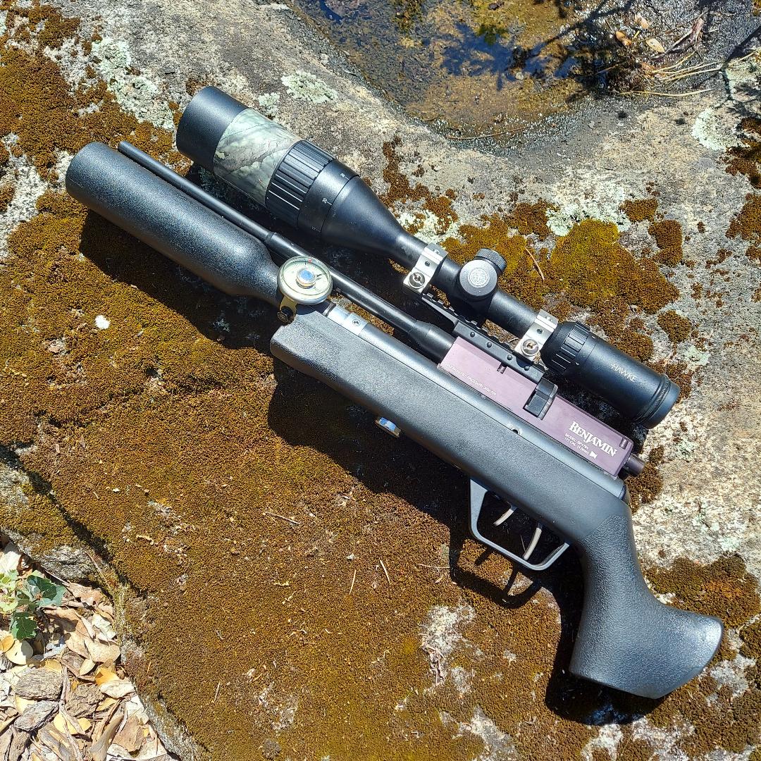

PCP Pistol  SOLD ** Custom Marauder Rifle to Bottled "PISTOL" conversion for Field Target .177 cal "One of a kind" RTR
Here is something you don't see every day ... actually any day :love:
AND IT'S SOLD !!!
Offered for sale is a Custom I put together a year or so ago built from extra Gen 2 Marauder rifle parts & pieces assembling this very unique pistol purpose built and tuned for the task of Pistol Field target. ( Could restock it and have a unique carbine too )
Main tube a shortened & threaded OEM steel, Modified valve, Custom hammer w/ stroke adjustablity, SSG anti bounce devise & trigger work. Cut down synthetic factory stock. barrel a 15mm turned down over bottle for clearance at the legal <15" length.
