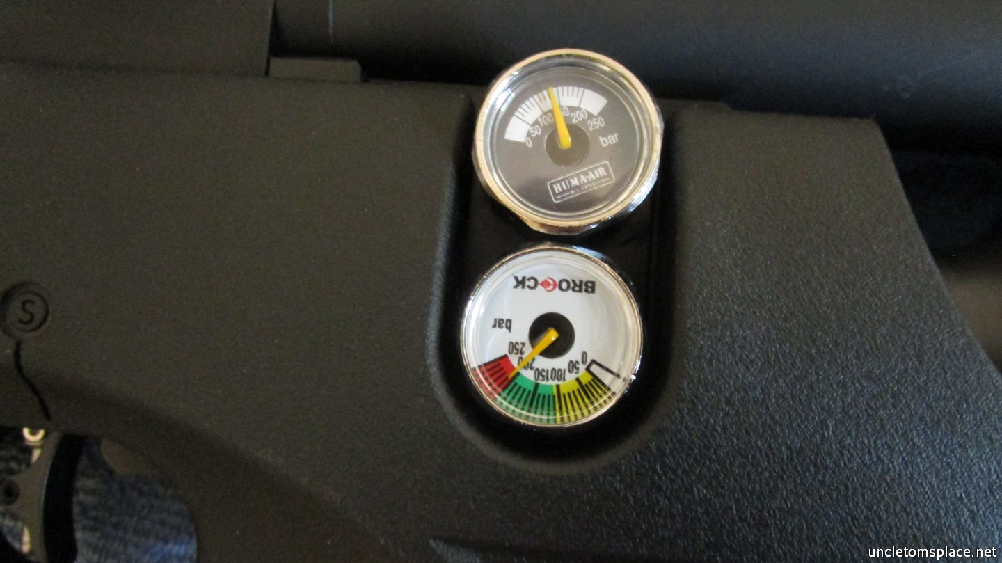

updraded pressure gauges with glow in the dark faces. ***Not shown in picture**** picture shows old gauges.

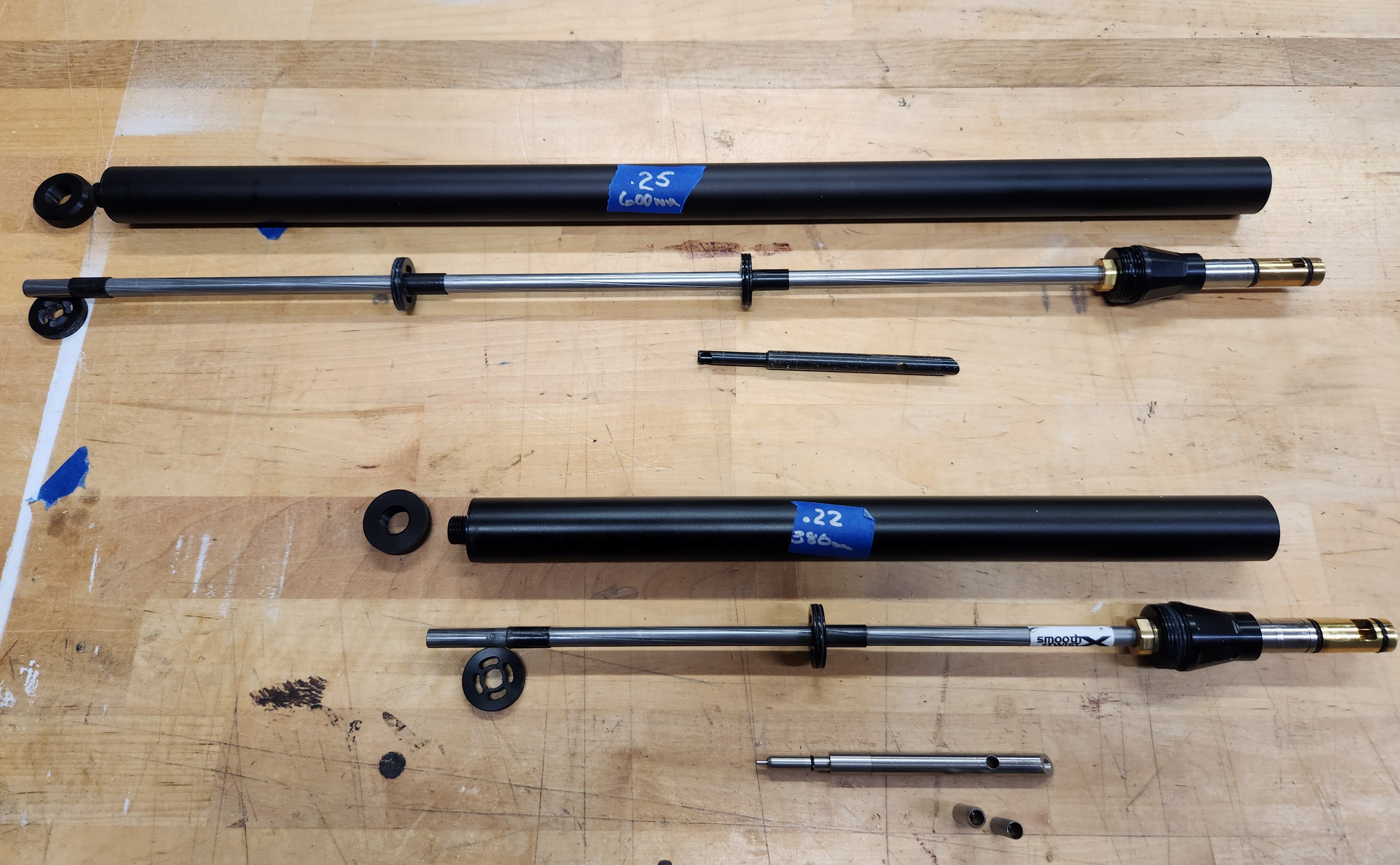

This post describes the main mod I am using to get longer flatter shot strings for unregulated PCPs.
I use a finely tuned, 3D printed (from TPU) buffer placed between the valve and hammer.
The buffer needs to be slightly larger than the inner diameter of the air tube so that it does not move.
The height of the buffer is essential, 0.1mm can change velocities by 30+ FPS.
The hammer spring is close to the max preload, this allows you to start at higher pressure.
I got to those tunes through trial and error, many of both.
I have tuned many unregulated PCPs using the same valve hammer buffer mod.
Since I target shoot I want at least 4 magazines worth in every shooting session at a low velocity spread (less than 5%).
I tuned both my Beeman Raider for 4+ maqazines worth of shots (48 in .177, 40 in .22) with a tight FPS spread.
These are their current tunes.
