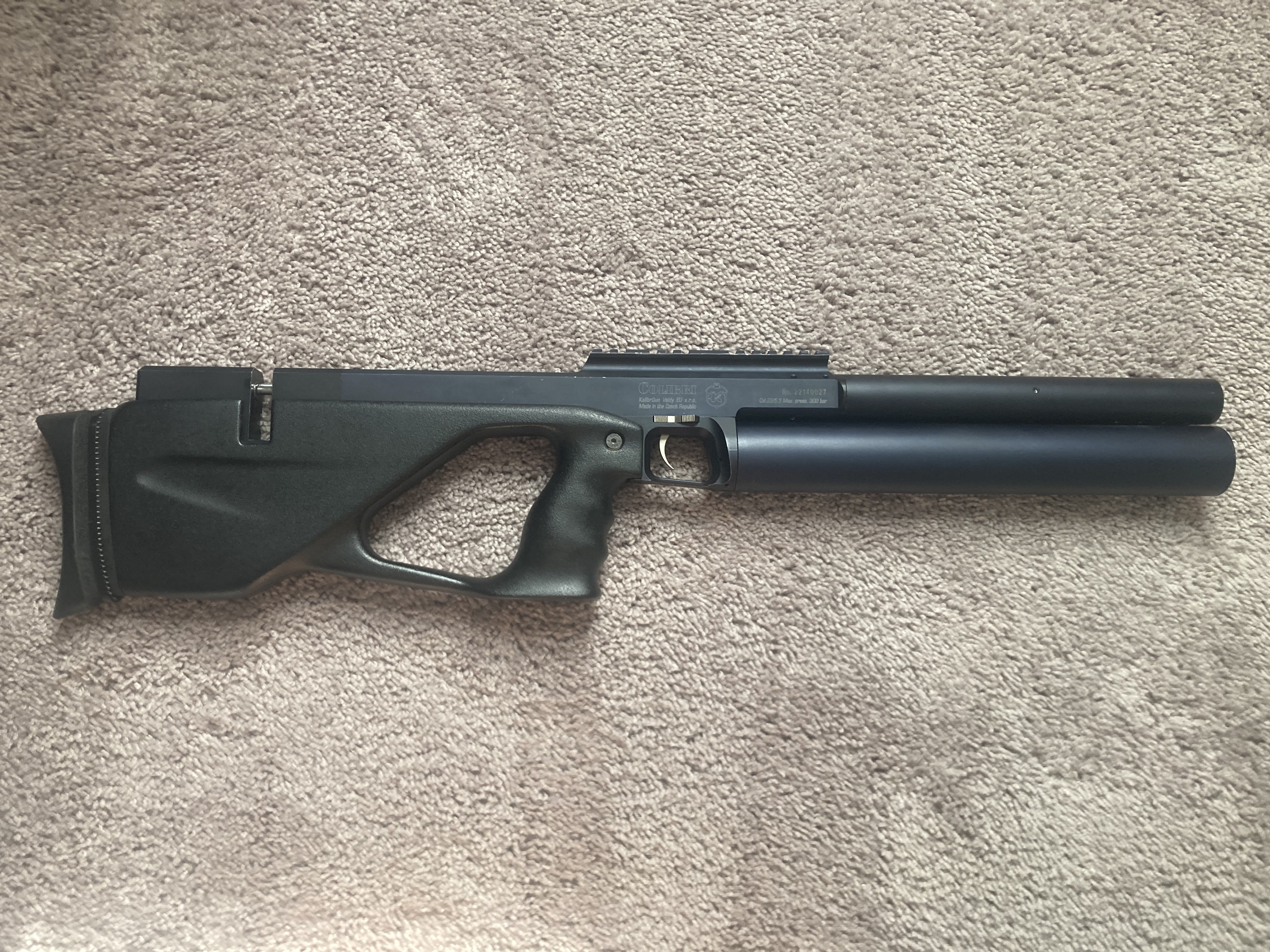

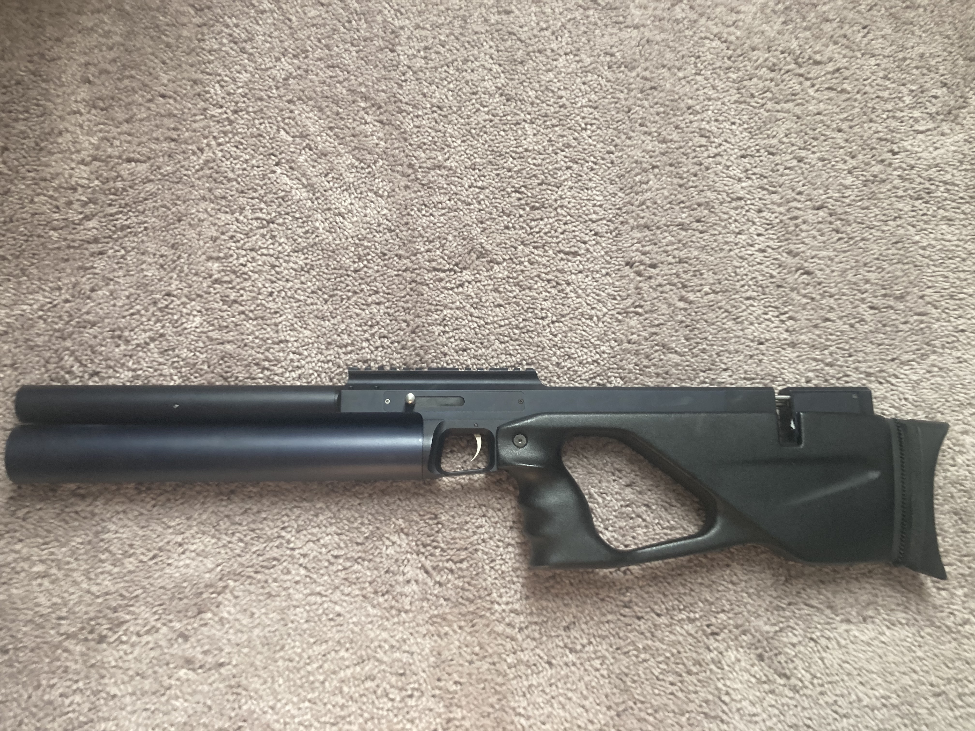

PCP Rifle  WTS Tuned Marauder Pistol with aftermarket stock and shroud
Hello guys,
Selling a tuned Marauder pistol set up for right around 16 FPE average for 32 shots.
Fill pressure is 2950, end pressure is 1600psi.
Extremely hand pump friendly, super accurate factory barrel with custom shroud.
Trigger shoe, valve work, transfer port work, trigger adjustment new hammer spring and valve return spring.
700fps / 725fps \ 700fps is the tune.
Will come with two magazines.
Looking for $550 shipped.
Contact me here, via text (nine16)531-2349
Or email: camsprecisionairguns(@)gmail.com
