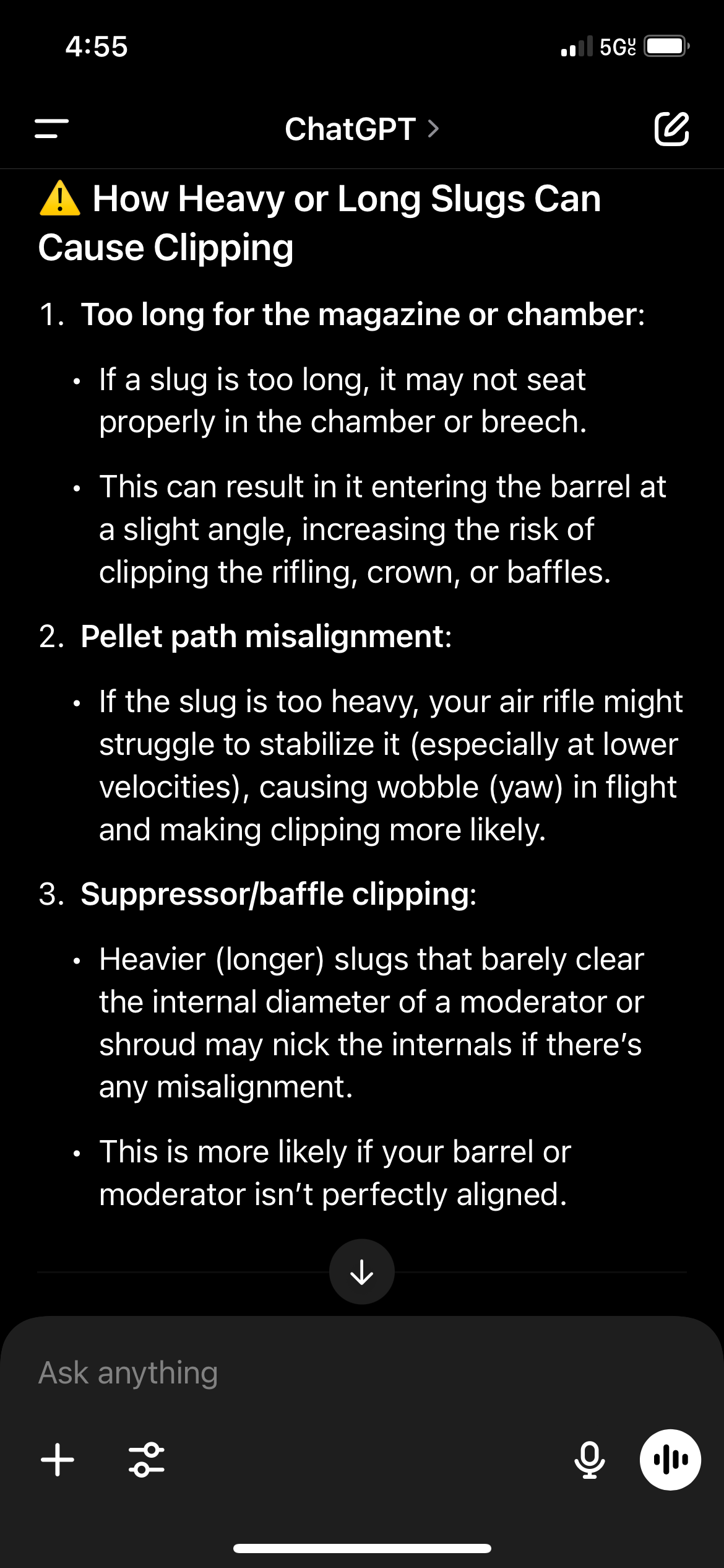

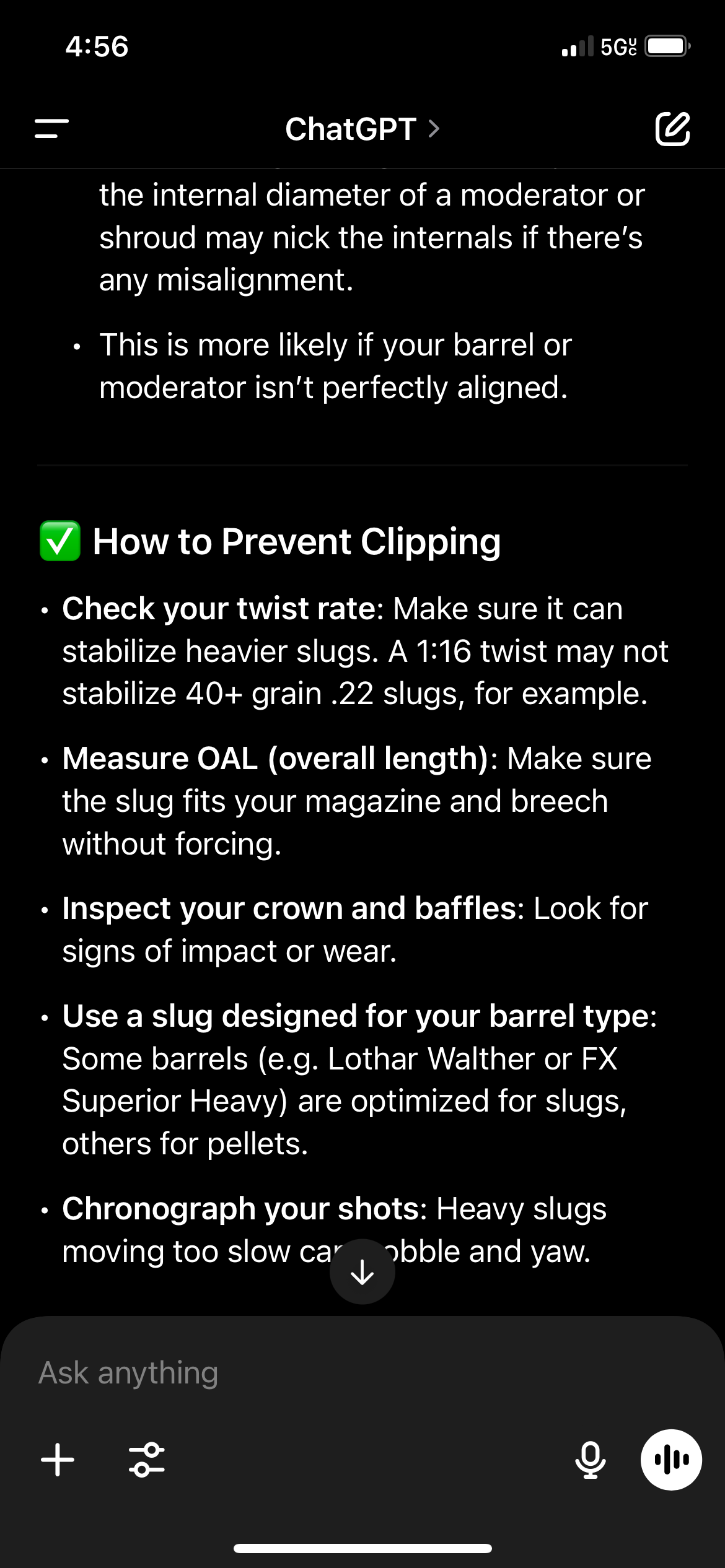

How can velocity cause clipping? In my opinion, it should never happen unless you double load, but that's not possible with the Slash.
From chat gpt
So, is the below correct? I think I might still be confused :)

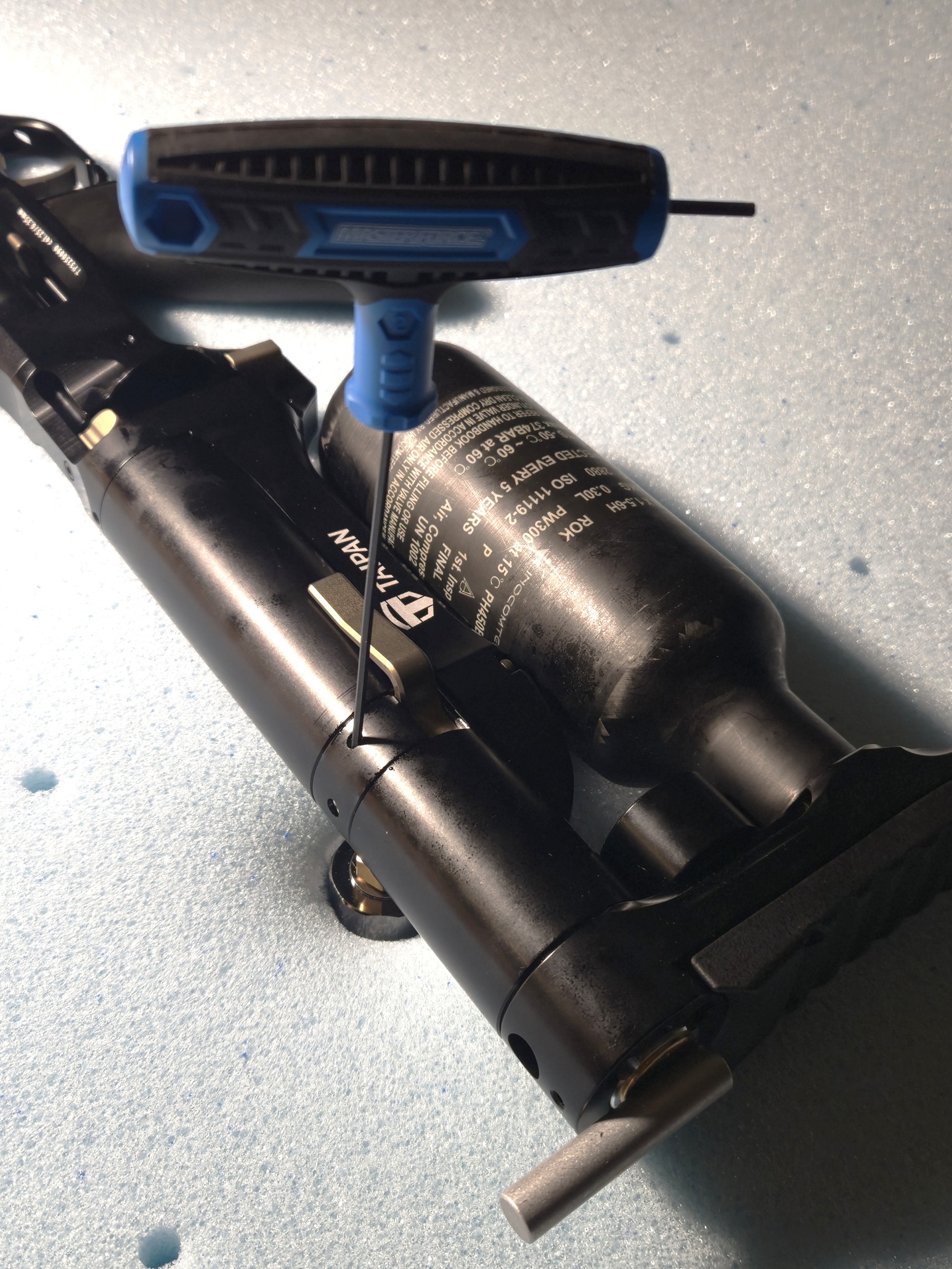

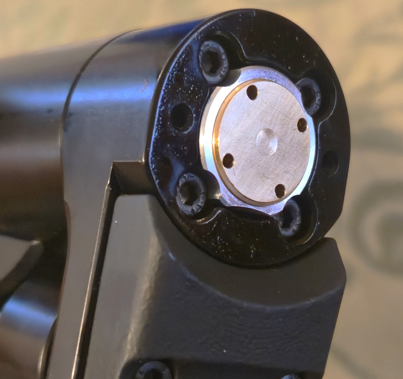

If I want to adjust regulator without gauge, then no degassing necessary?
For this method, I would adjust reg cw to increase reg pressure. But, when turning ccw to decrease reg pressure, I must dry fire 2-3 time to get reg to settle at new pressure?
You basically can adjust any regulator up under pressure. I’d be very cautious doing it decreasing reg pressure unless explicitly stated by the manufacturer. There are very few that actually operate completely this way going down in pressure. Most that “allow” that are still a grey area. Move it an 1/8 turn and fire. They are having you move it tiny amounts so you don’t damage the internals. I personally pass on that and just degass when decreasing .

I don't think Taipan has made this clear yet. I'm degassing for all moves up of down at the moment until clarification is made by them. What you say does seem logical though and likely the way it's designed.
I'm just doing what I am out of caution for now. On the Taipan.. CW is more pressure and CCW is less.. Very straight forward and easily done. I almost see that adding the reg gauge to tune like a fighter jet retracting it's landing gear. This design keeps things simplified and it really helps as it's so easy to shoulder and helps make a narrower rifles case.
If you see earlier in the thread Taipan has already explicitly stated you can move down without degassing… they just said you have to dry fire a few times for the reg to actually reset to the adjustment. No other cautionary statements were made…. This gun is like the Huben: All valve no hammer spring.

They have clarified. Just dry fire the gun 2-3 times after moving the reg down to reset and reflect the new reg pressure. I literally posted a screen shot on their official YouTube where they state this… he also states it in that shooting demonstration video

Good to hear. Wish more were like this. Most aren’t. I have to rebuild a daystate huma reg for stupidly turning the screw the wrong way and not realizing it until I had moved it twice a decent amount. It now doesn’t maintain its rock solid pressure. It slowly creeps down as the bottle pressure decreases. There is a small delrin disk in those regs that gets squished when you turn down under pressure. Then the reg doesn’t act right.
