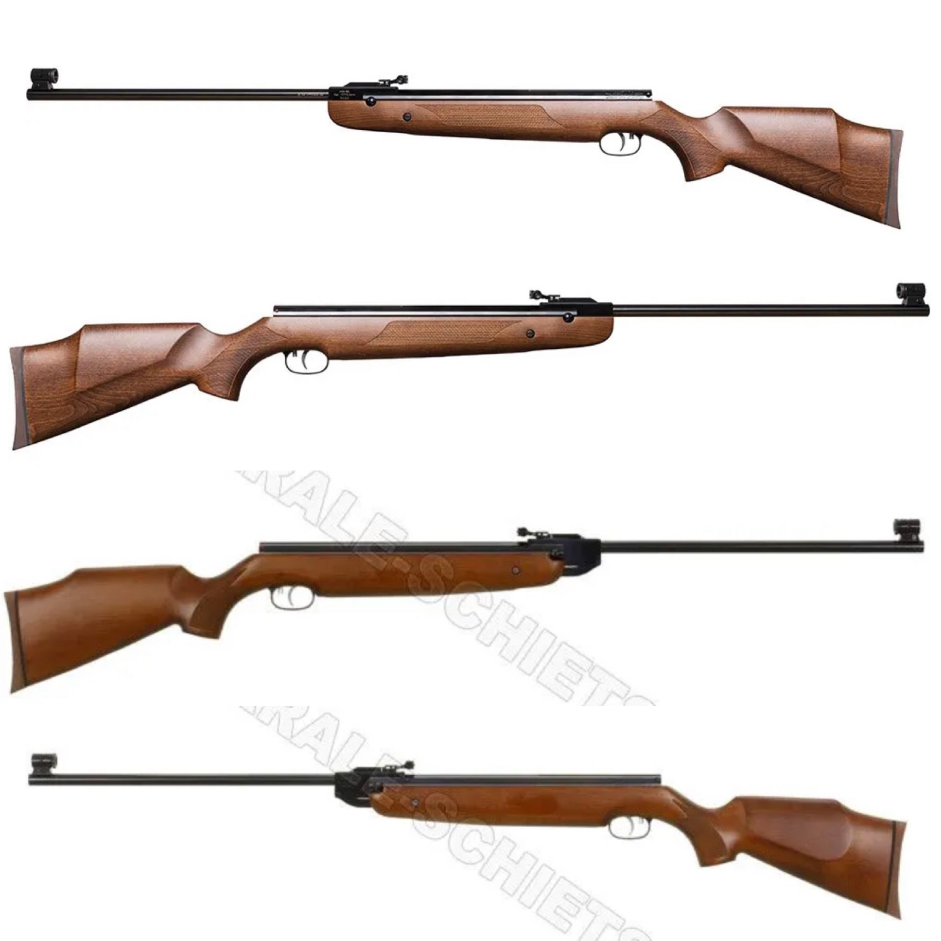

Had to go down and look. No it’s not. Not much of a rise. A piece of leather would do the job. I think deerstalker has on his. Looks awesome. Sucks to be a right handed shot. Didn’t realize you were so limited. Crow
yup lefty only , well i suppose i could shoot righty buy never was any good at righty
Lux stocks are ambidextrous ,standard stocks are not/ right handed. his is a standard in that picture.
In the link i have earlier seems hw break barrels they show are now kinda all luxus stocked . I wonder if there discontinuing the standard stocks for the lux's ambidextrous ?
I’m a lefty and been using right hand Weihrauch’s for decades. The tiny little cheek piece in my book does not qualify it to be labeled a right hand gun. The way my cheek hits the stock most left hand Stocks with a tiny cheek ”bump” don’t feel any different than nothing.
For the past 40 years I have removed countless number of cheek pieces (right hand) off these Weihrauch’s. Sold them to right hangers and nobody ever complained. I don’t bother anymore because they look nice anyway. Unless a cheek piece is really large like CSStocks LTD puts on their stocks, they are more decorative than functional.
The biggest difference between the two 85’s is the drop in the stock. The Luxus model is so high on the comb it makes using the open sights difficult. The standard model is absolutely better for iron sights. The Luxus for scope. Forget the cheek piece as it does not matter at all.View attachment 323146
