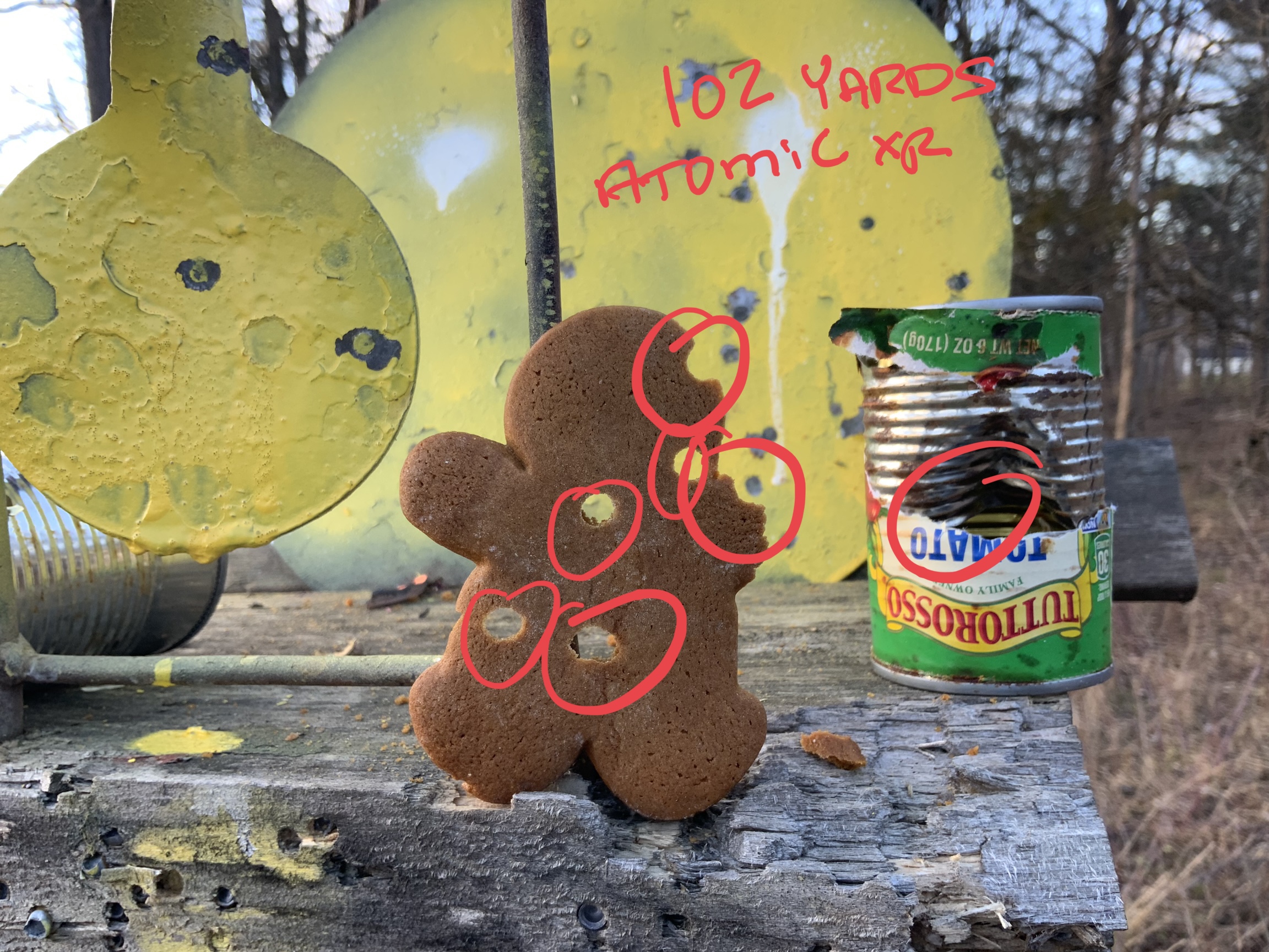

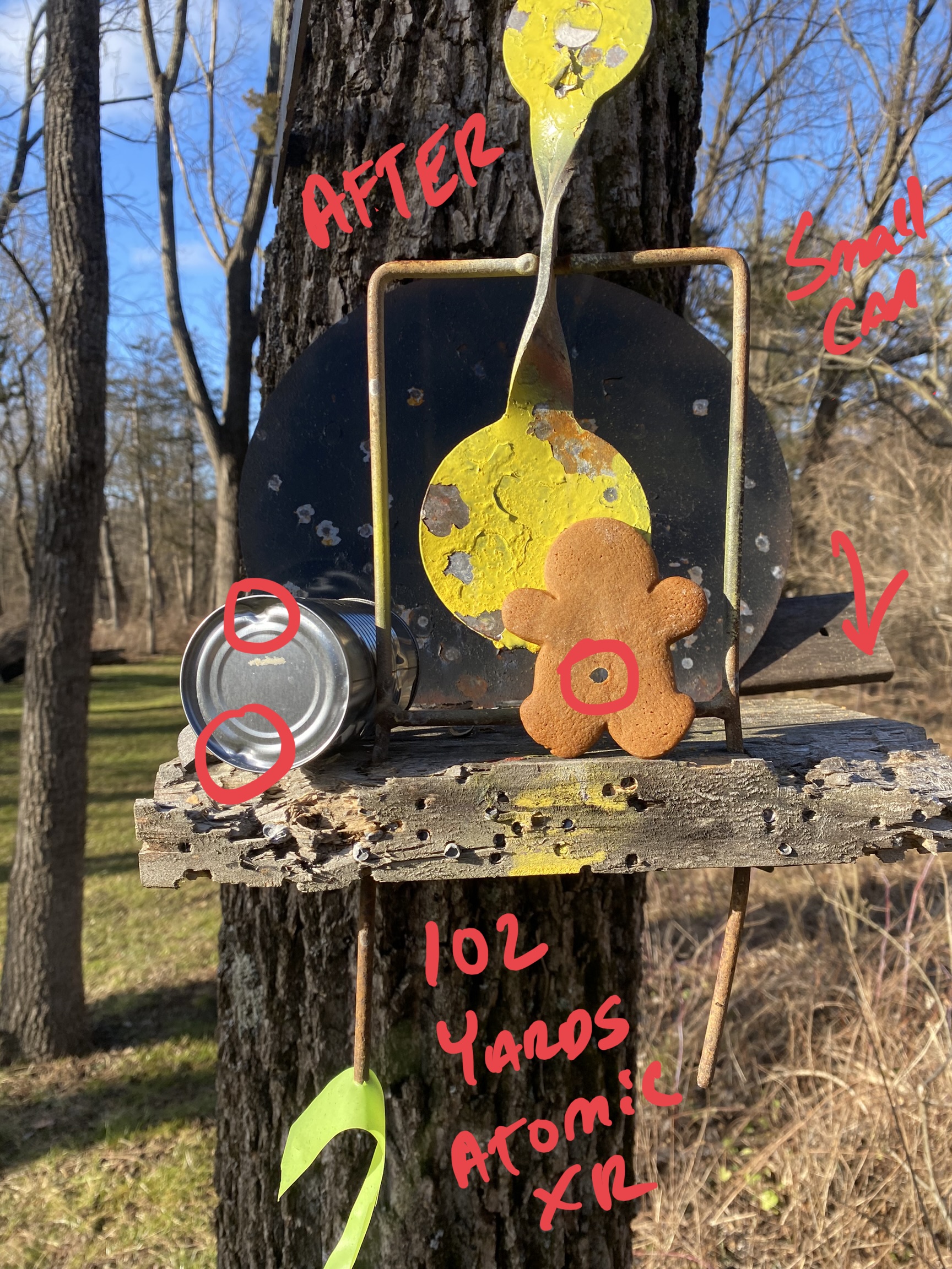

Any small critters you target will find those 18 fpe irresistible, all you need is 4-5 fpe at POI to kill small game. Here is an image of my plinking foolishness at 102 yards with my Atomic…Seems like lots of good options. I’m drawn to the Ranger XR, folds down very compact and the price is right. Just not sure if 18 fpe is going to be a limitation.

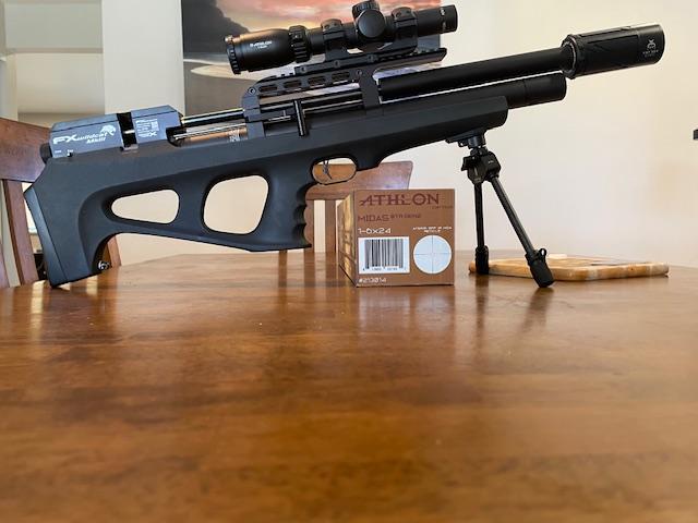

My Talon(s) with moderators are very quiet.I just got into airguns as a way to do backyard hunting, but seeing how fun and accurate it is, I decided to set up a steel range in the yard. Got a Huben K1 in .22 and it’s great, however I want something I can hand pump (for the exercise).

How quiet? My K1 .22 with Falx is around 107db. Just ordered a Sarissa to see if I can get it quieter.My Talon(s) with moderators are very quiet.
