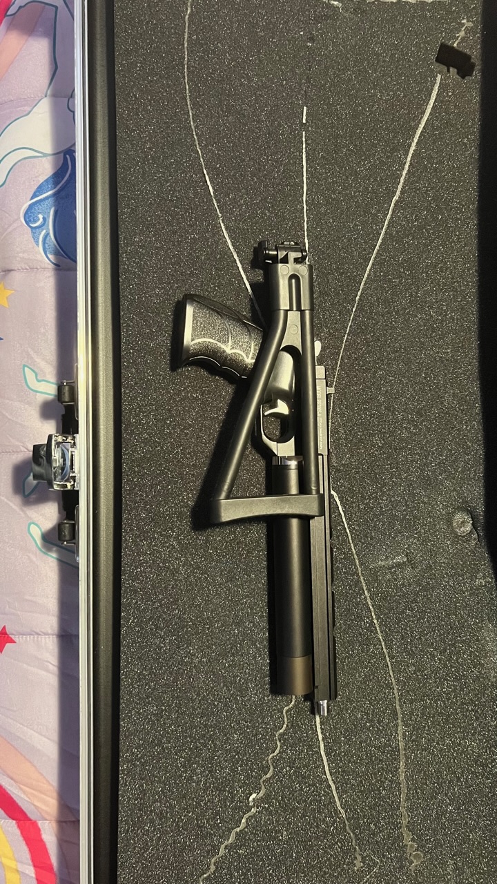

PCP Rifle  NLA Aea hp max .457 with m50 barrel and m50 pistol barrel
Pretty much everything you can do with the HP max. It comes with the m50 pistol kit and two length pistol gas tubes, the HP max 457 barrel and gas tube and the m50 barrel. 4 magazines and some 457 slugs I have left as well as sabots to use the 457 slugs in the 50 cal barrels. It also has a red dot sight. I haven't even shot the m50 barrelkit yet. Looking for 600 to your door.
