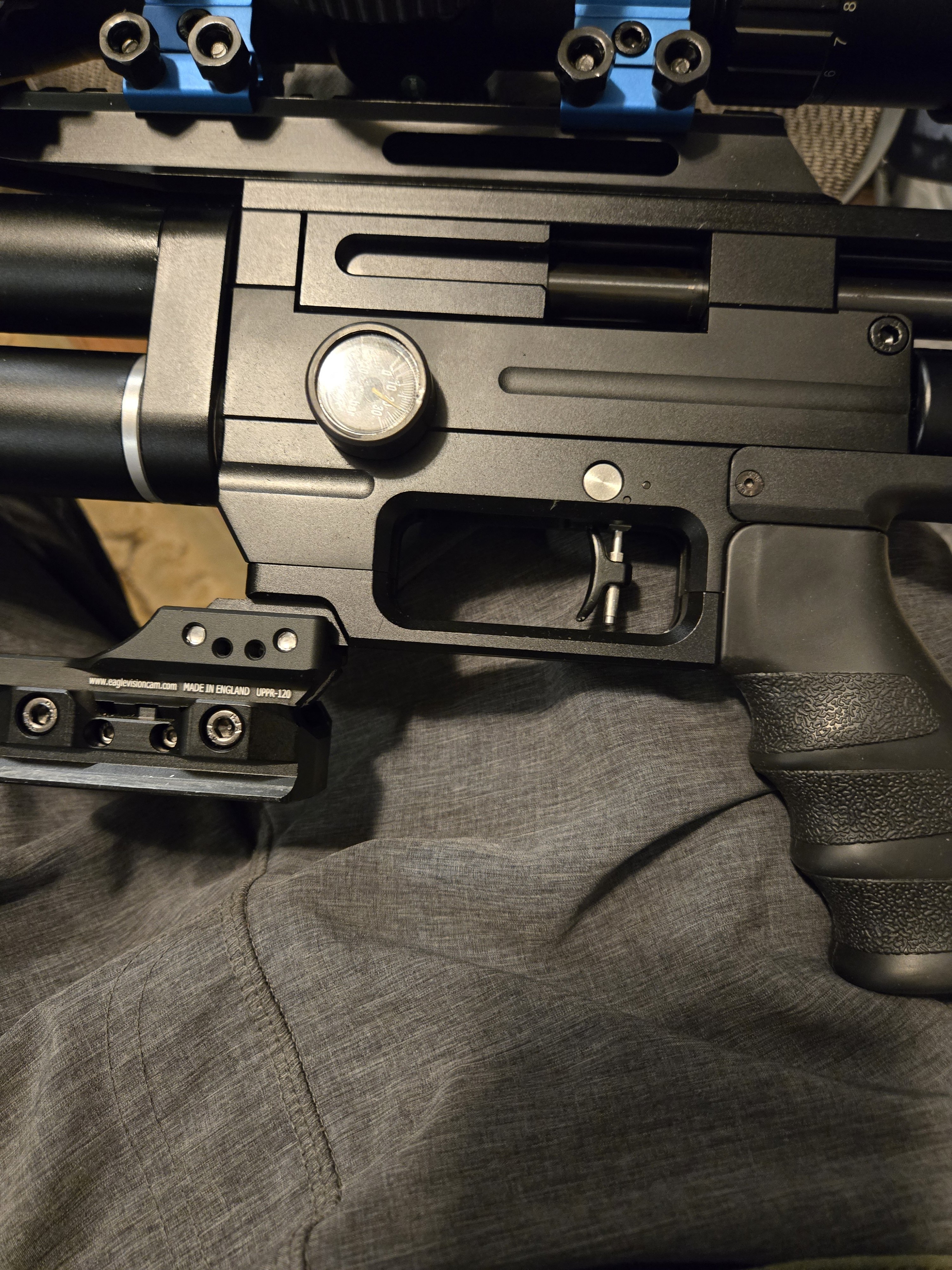

My Brother’s Notos setup for running a 15rd Big Air mag. Sorry I don’t have a photo with the mag inserted. Those are med height rings with 1/2” risers. The mag has a little clearance left, at most a 1/4”
Ahh I see. So in order for me to run the 15round mag, im gonna have to run the high ring mounts. And probably med ring for the 12shot mag. Thanks for the photo and information *OneAcreFarmer 👍
