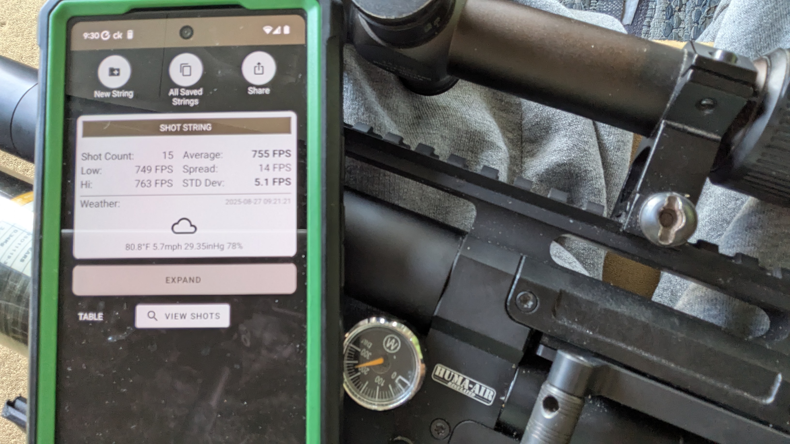

FX Chrono Odd since last update?
My old FX chrono will occasionally give a ghost reading, but it is extremely rare.
and it will also some times for unknown reasons go into what i call doublefire mode, this mean it give out the speed of a shot 2 times.
My phone for some reason will also always try to start up 2 FX chrono APPs, i overcome this by letting the FX APP ask for permission to turn on bluetooth.
But the doublefire thing will still happen suddenly, but it is then rare.
The new V2 chrono now mine CUZ we swapped, well on my friends rifle it will at times bark out 4-5-6 ghost shots for no apparent reason, and it will also some times give you a extremely low speed reading even if the shot is good and hit where it is supposed to hit, so pretty sure it is not a duble load.
But that is on my friends DRS, on my TWO and Maverick it seem to work just fine.
PS: you can delete shots in a string, use list instead of graph display and then swipe left on the reading you want to delete.
Tomorrow i will put the FX V2 chrono head to head with my new Buckchrono.
