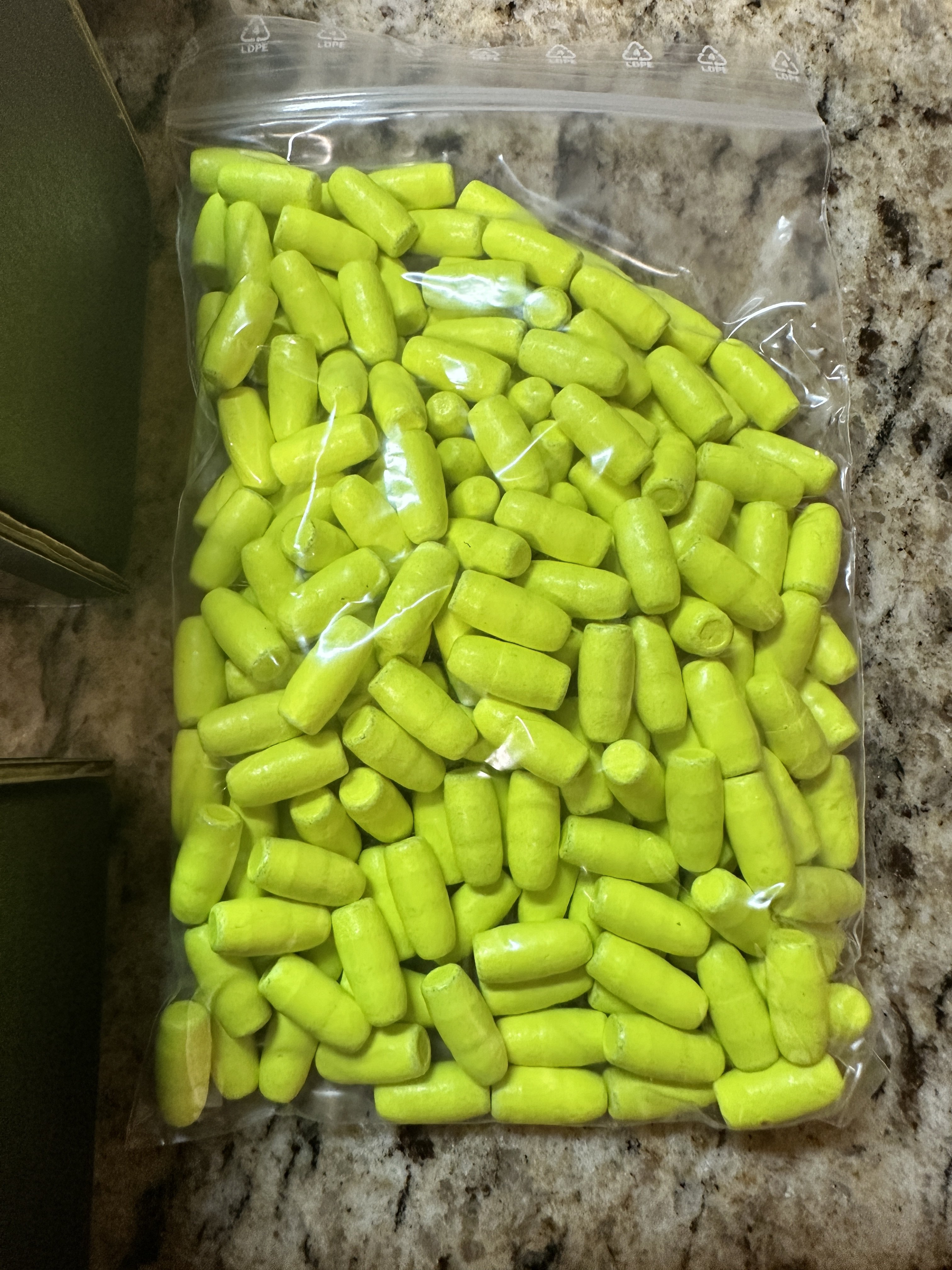

I ordered some directly from Zan. Fast shipping through DHL. Can’t wait to start testing them.
