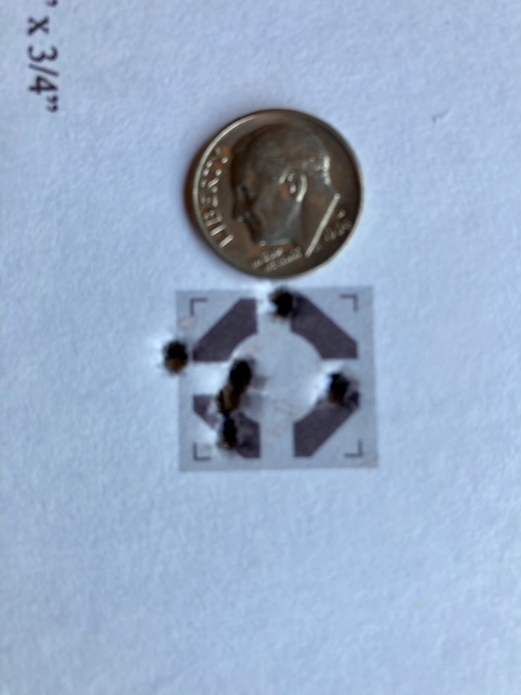

After work I shot 7 ten shot groups – filling to just 205bar and shooting down to 125 bar. That’s 70 shots using 80bar – this equates to 16.5 psi per shot. So by cutting the spring from 3.1” to 2.7”, the efficiency improved from 31 psi per shot to 16.5 psi per shot – roughly double the efficiency with that quick change. I know from experience that using a 2.57” spring with .177 in these rifles will give an efficiency of about 11.5 psi per shot (shooting 10.3g pellets at 890fps).
Note that the 1st 65 shots had a 13 fps spread !! The rifle’s sound volume was MUCH quieter – as it was using ½ the air per shot now.
Also, I will try filling above the 205bar that I used for the shot string (max fill is 250 bar !) – I may be able to get 90+ shots with a less than 20fps spread – with the 2.7” spring (and well over 100 shots with the proper 2.57” spring).
As you can see, the 10-shot groups were all under a dime (one flyer). Groups 6 and 7 were getting tighter as the velocity dropped into the lower 890s. Next groups I’ll try shooting 870 fps – and see if the groups get tighter.
