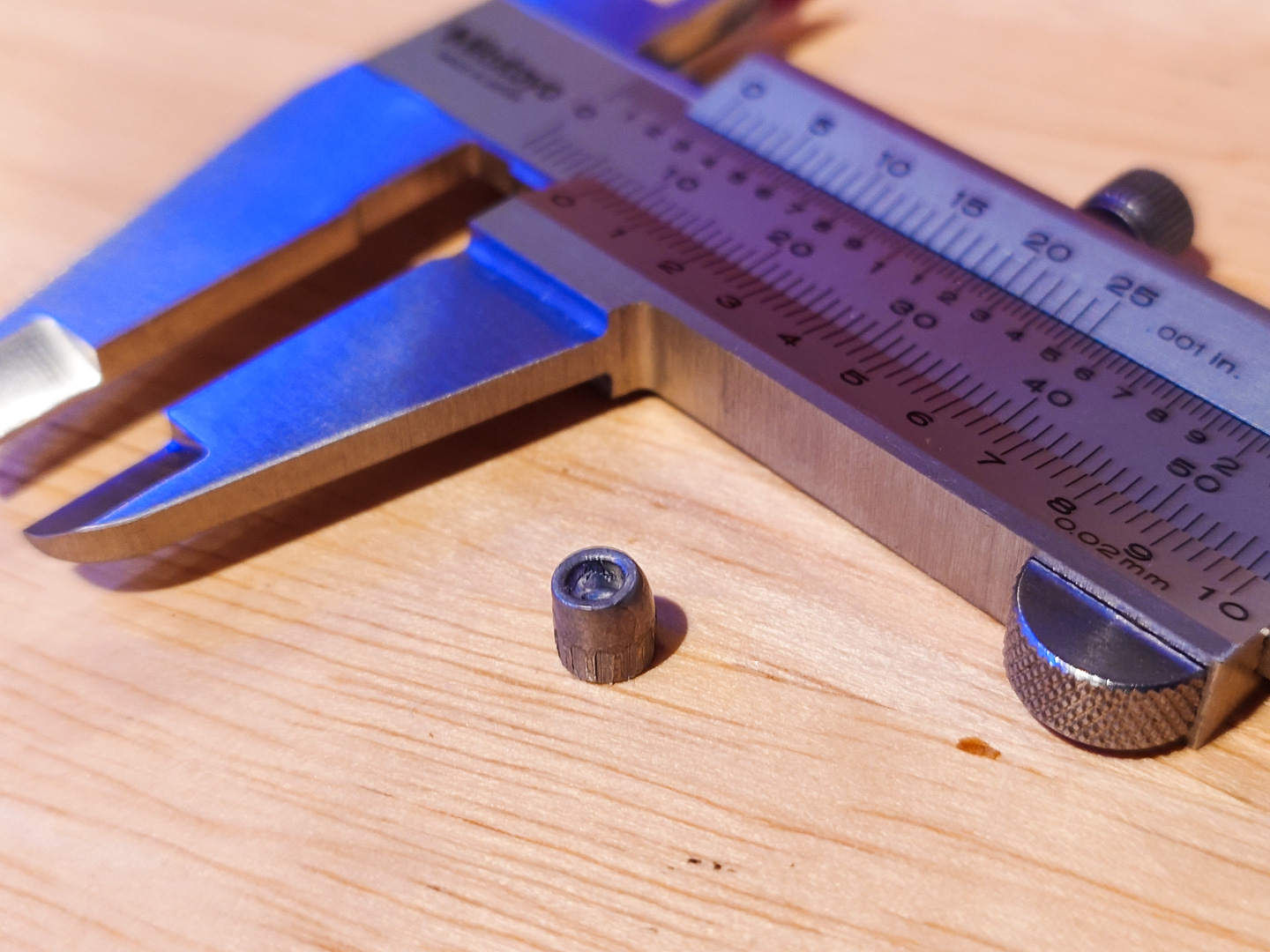

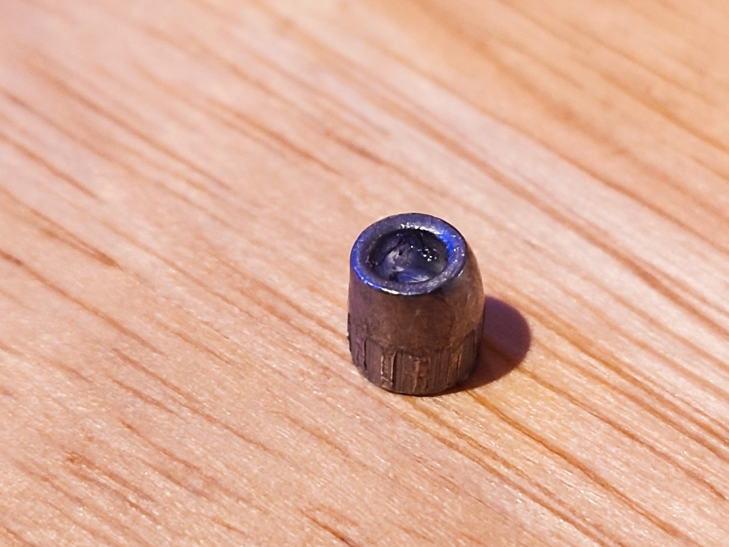

Accidentally slugged my barrel. What do I do with the data?
On my gun, I found the NSA 17.5gr 0.2165 slugs to be quite accurate at 900 FPS muzzle velocity. Last night, I shot at the bottom of a half gallon milk jug full of water from 31 meters away to see if I could blow it out. It didn't blow out but it caught the slug inside. Slug velocity on impact would have been about 800 FPS.
I measured the grooves on the slug (which would be the lands in the barrel) to be 0.211" and the lands (groove on the barrel) at 0.216". The slug started out supposedly at 0.2165" but my caliper is not precise to the 10,000th of a inch. This measurement is when I put the slug on the table and put the calipers flat on the table to measure from as low as I can. If I measure closer to the middle of the rifling marks, I get a much bigger measurement of 0.219". I think this maybe because the sides of the slug has started to bow out when it hit the water making the middle part wider than the base. I also think that the starting diameter of the slug is a smidge smaller than the grooves in the barrel. I've measure multiple times and even used a magnifying glass to read the vernier caliper and this is as accurate as I can read it without any specialized measuring instruments.
Having said all that, what do I do with this data. As I said, I find the NSA 17.5gr 0.2165 slugs to be accurate in my gun. But how can I use this data when selecting other slugs in the future?
The hollow point hole went from 2.13mm to 2.82mm as pictured. It's not a mushrooming effect as I think the walls are a bit too thick for the velocities I'm shooting these slugs at. I think it should be ok for penetration at longer distances.

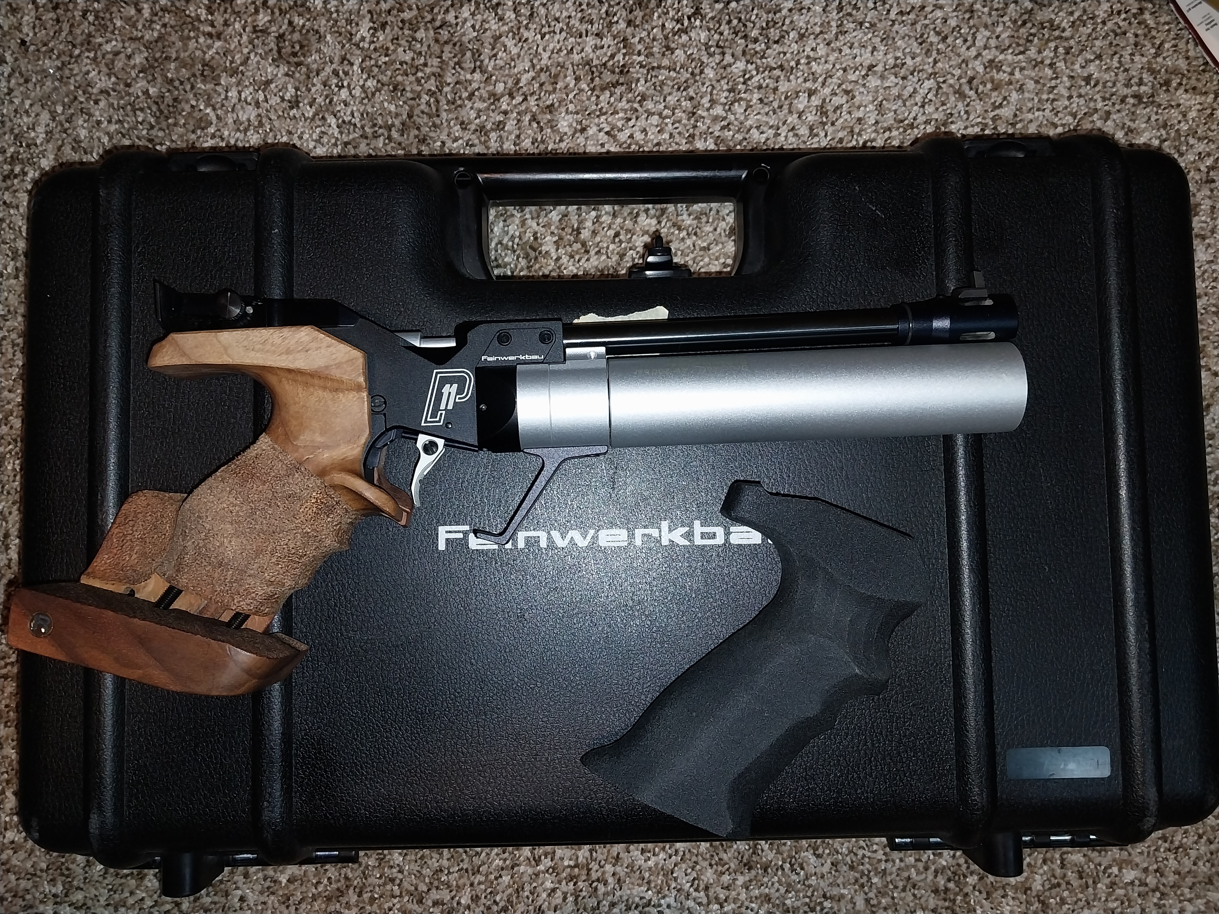

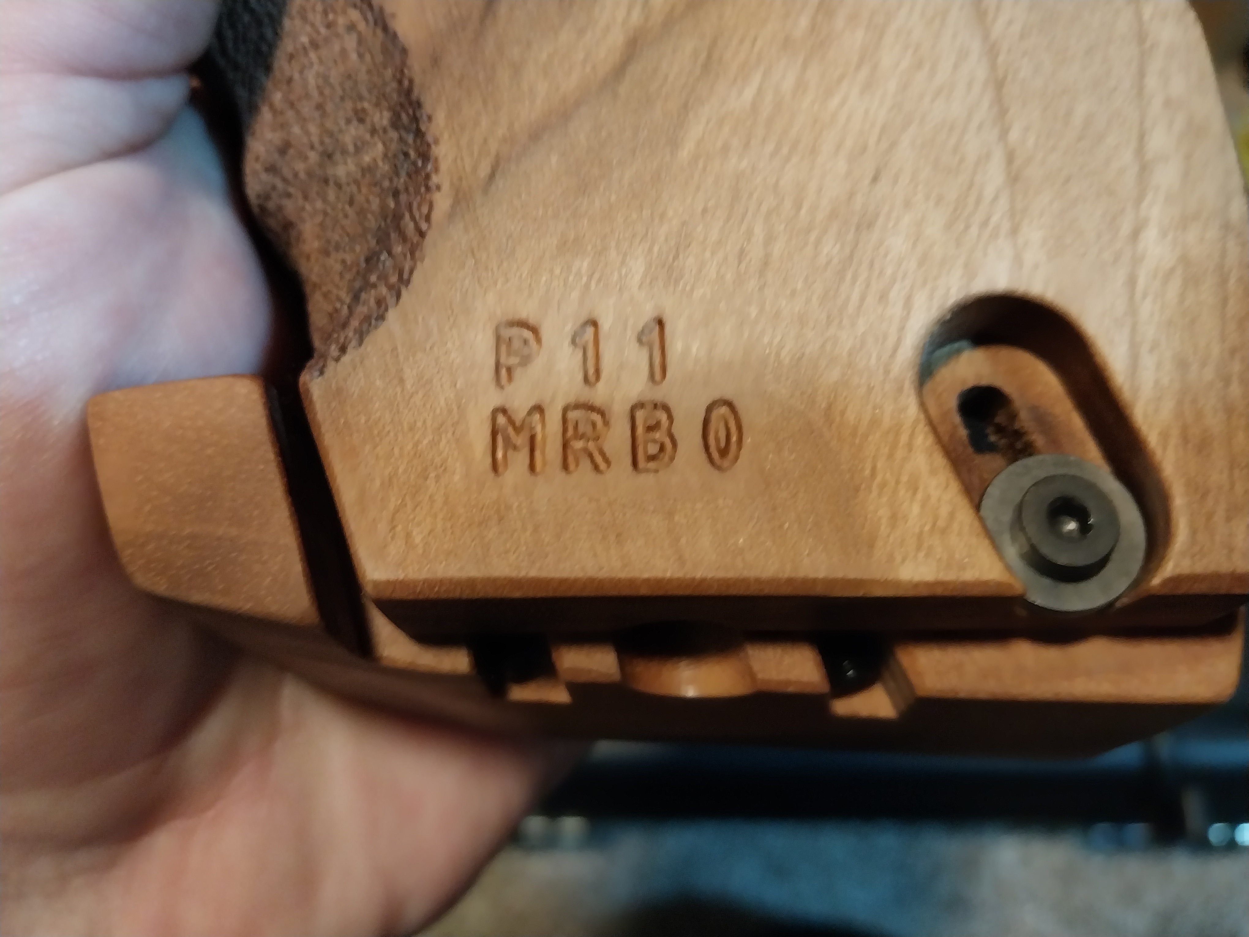

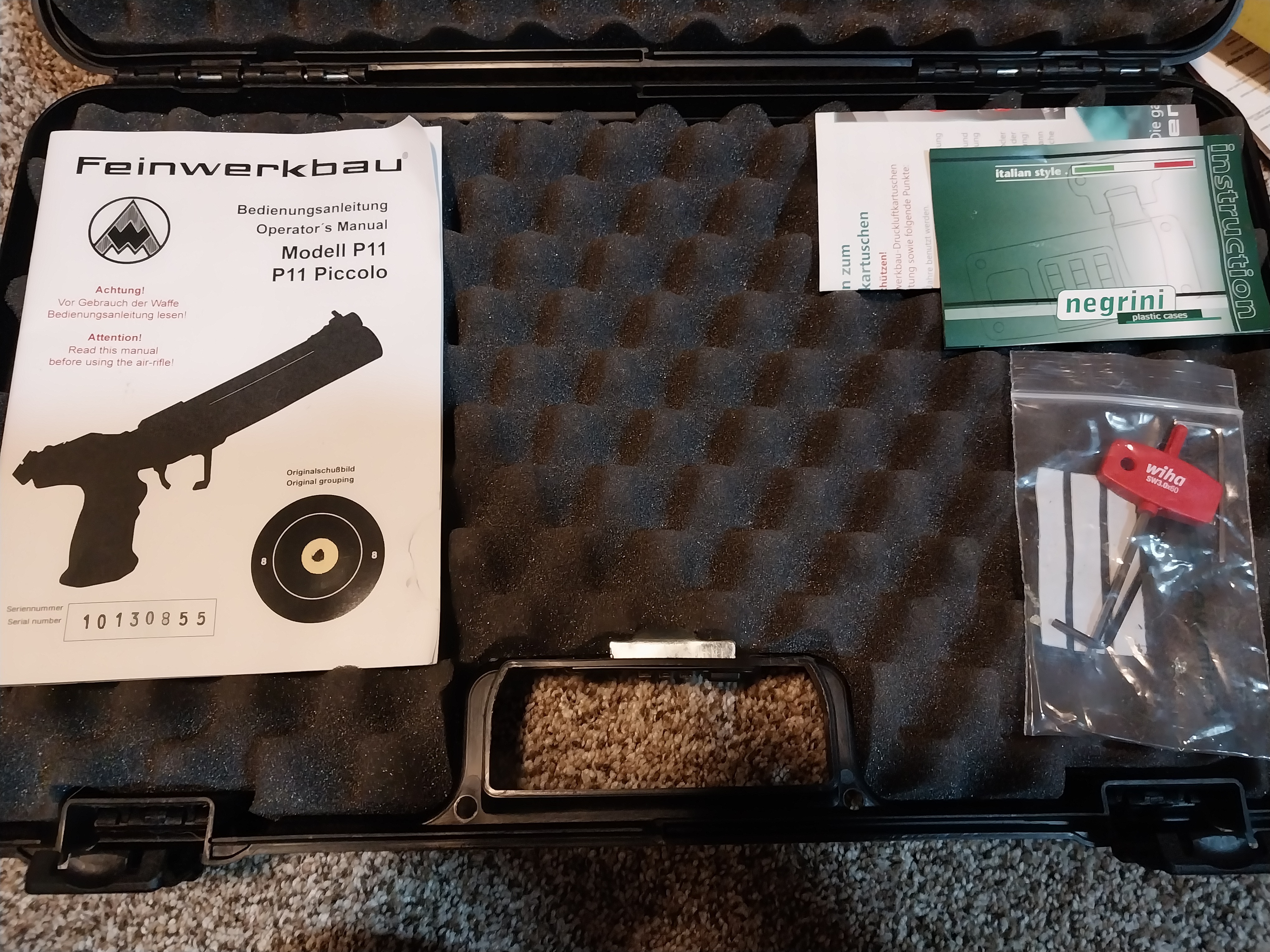

PCP Pistol  SOLD FS - FWB P11 w Rink Grips
Excellent condition, has case and everything that came with it from FWB including original ambidextrous grip. Rink walnut grip is medium to maybe smallish in size (sorry, don't know size, made to my hand measurements).
Asking $900 shipped in the CONUS. Paypal friends and family or add 4% to cover fees. Email tobinwebster at yahoo dot com for more info/photos.

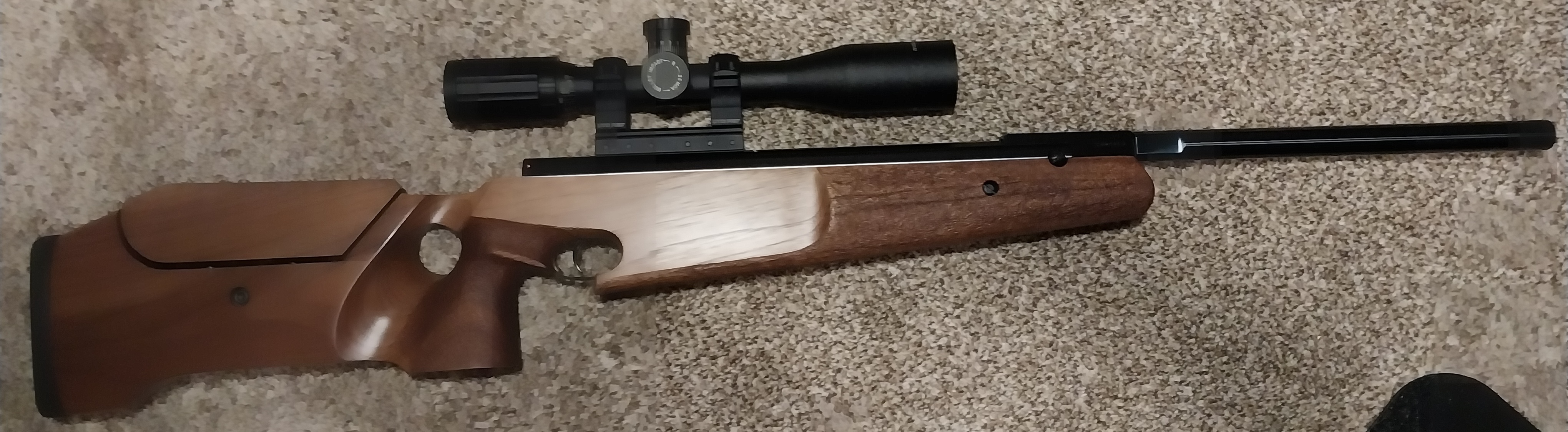

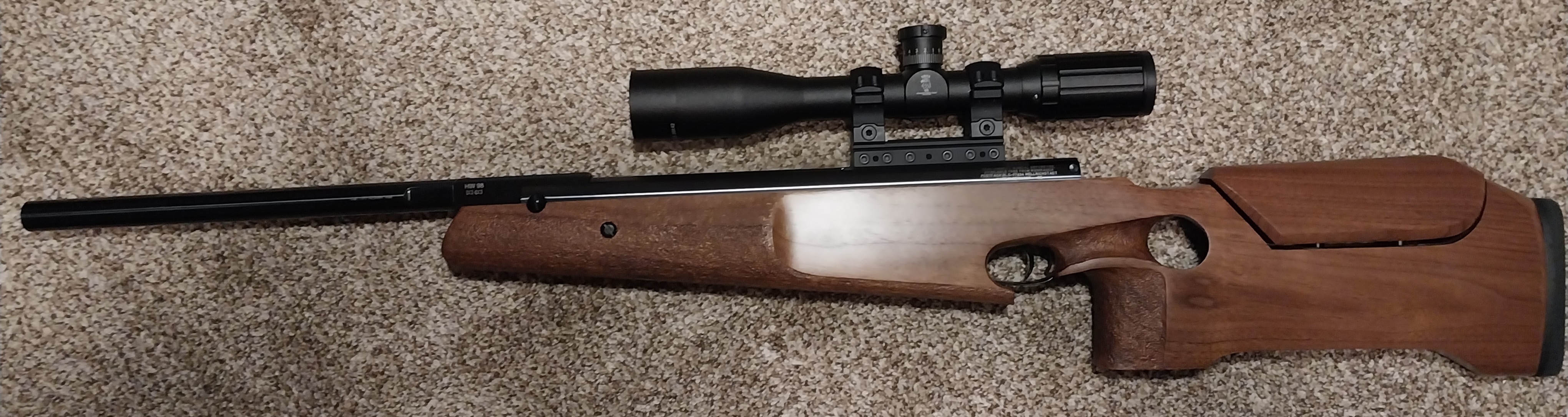

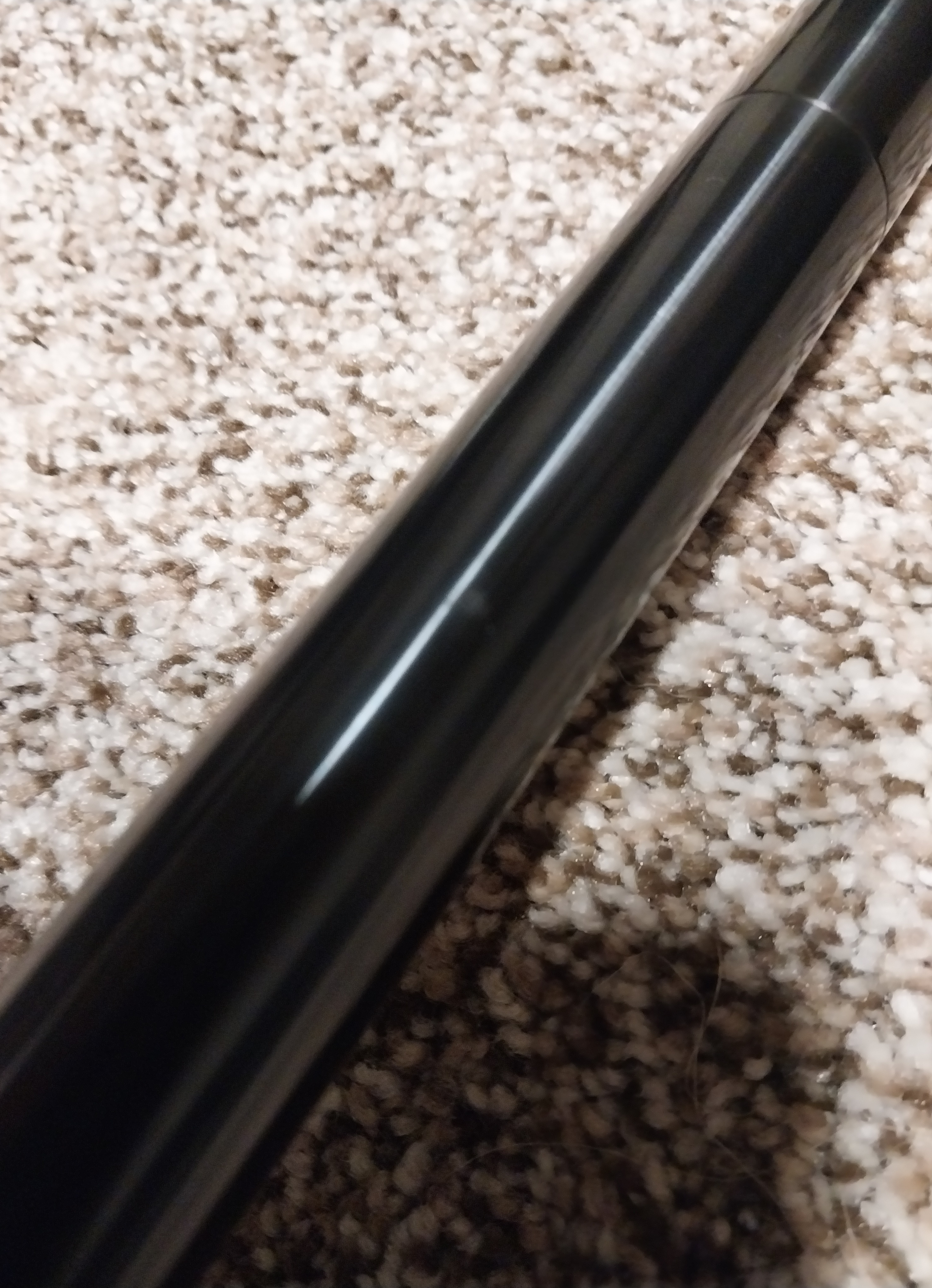

Traditional Rifle  SOLD Lowered FS - HW98 with CS Target Stock 0.177
Excellent condition HW98 with a walnut CS Target Stock, 12FPE Vortek spring kit, and black anodized Rowan Engineering set back trigger. Only mark I see is a pin head sized nick or blemish on the barrel which is how it came from the manufacturer when i bought it about 9 months ago (photo). Has threaded barrel and muzzle weight.
Stock has a non-adjustabke Ruger rubber butt plate. The adjustable one that came with it was very poorly fit and added a lot of LOP, so I installed the thinner rubber pad. Works great. You will need high rings as the stock cheek rest is pretty tall - at leasr for me.
I can also put this in an HW95 Field Pro beech stock (as new) or an original HW98 stock. Or, if you'd like to just buy the CS Target Stock, let me know. If interested, contact me and we can discuss pricing.
Riser, rings and scope not included in the sale. Asking $750 shipped. Paypal friends and family or add 4% to cover fees.
Please email tobinwebster at yahoo dot com if interested or for more/better photos.

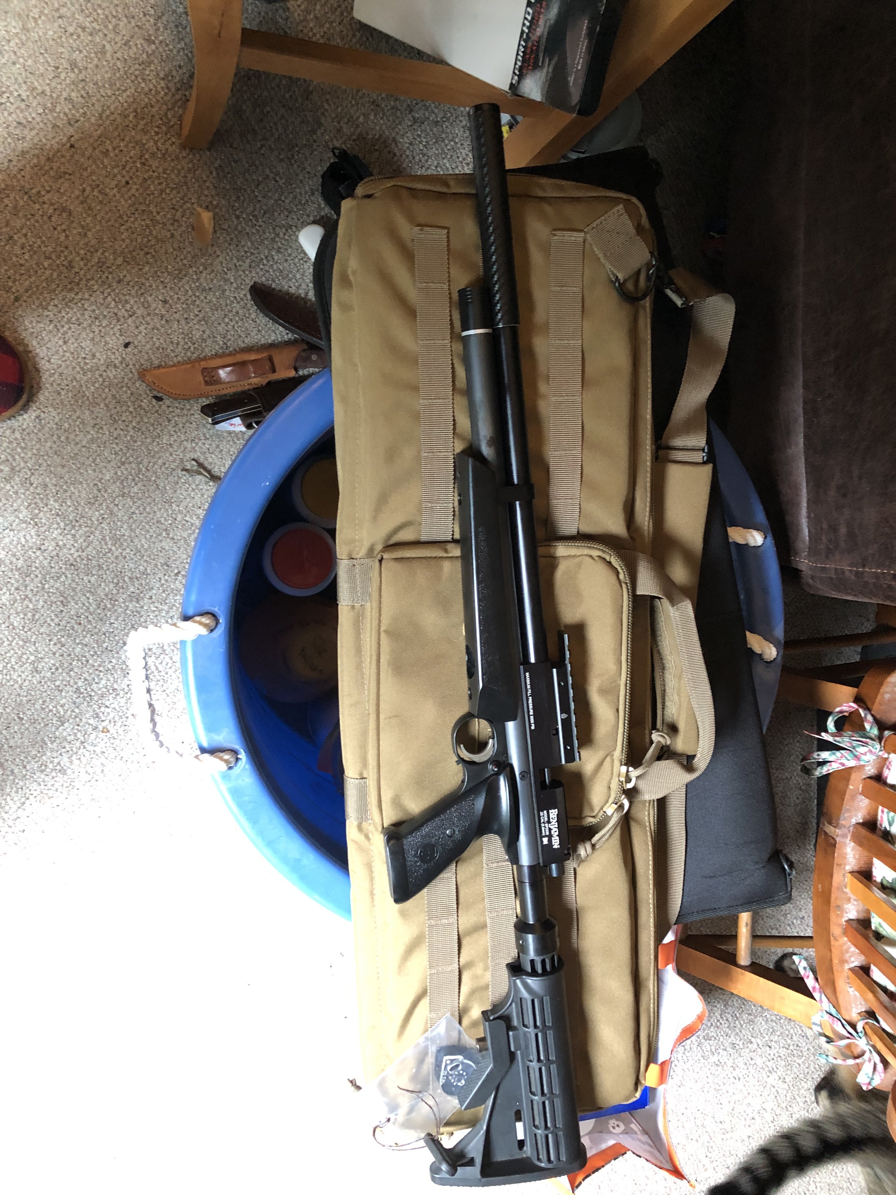

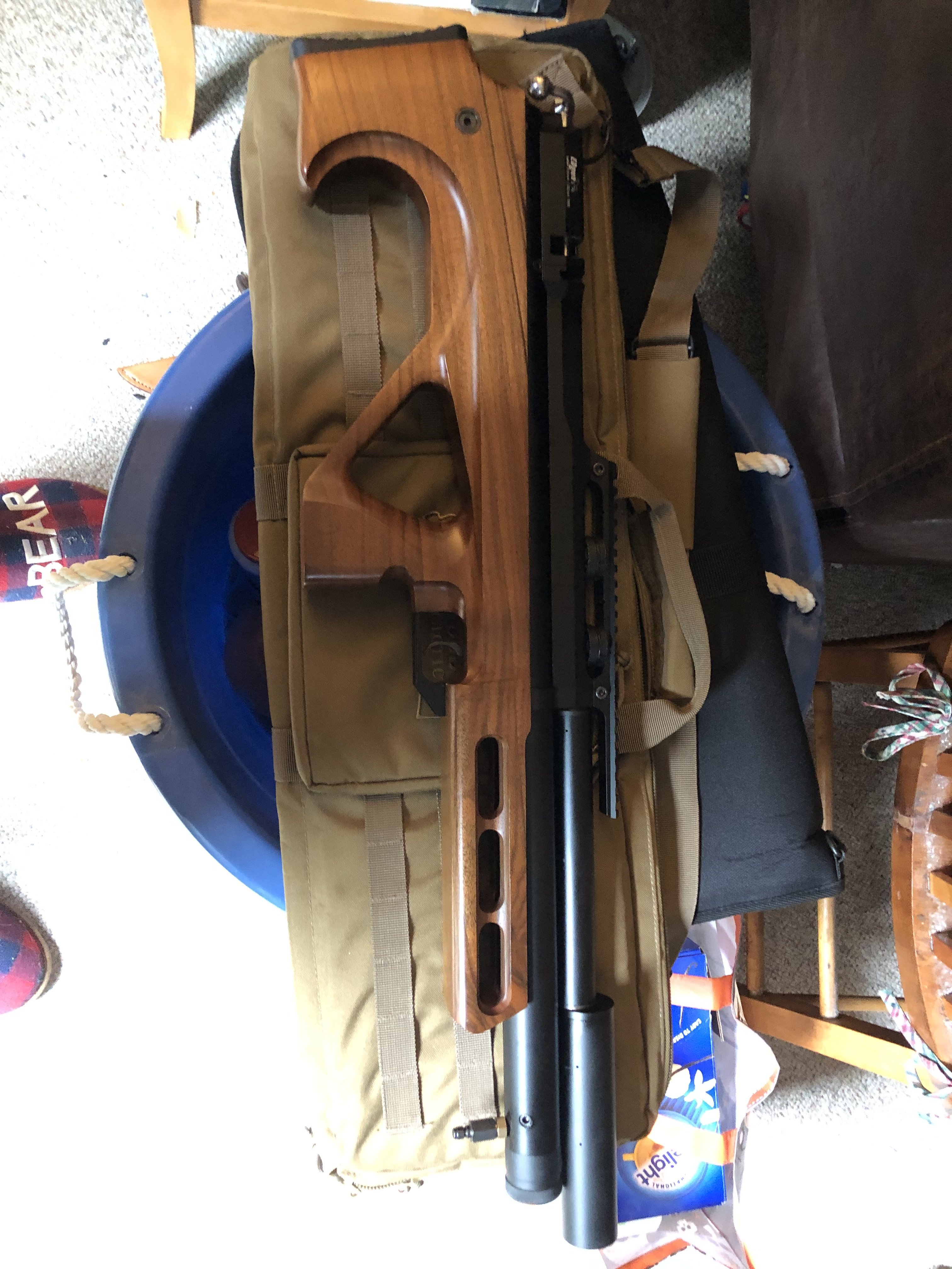

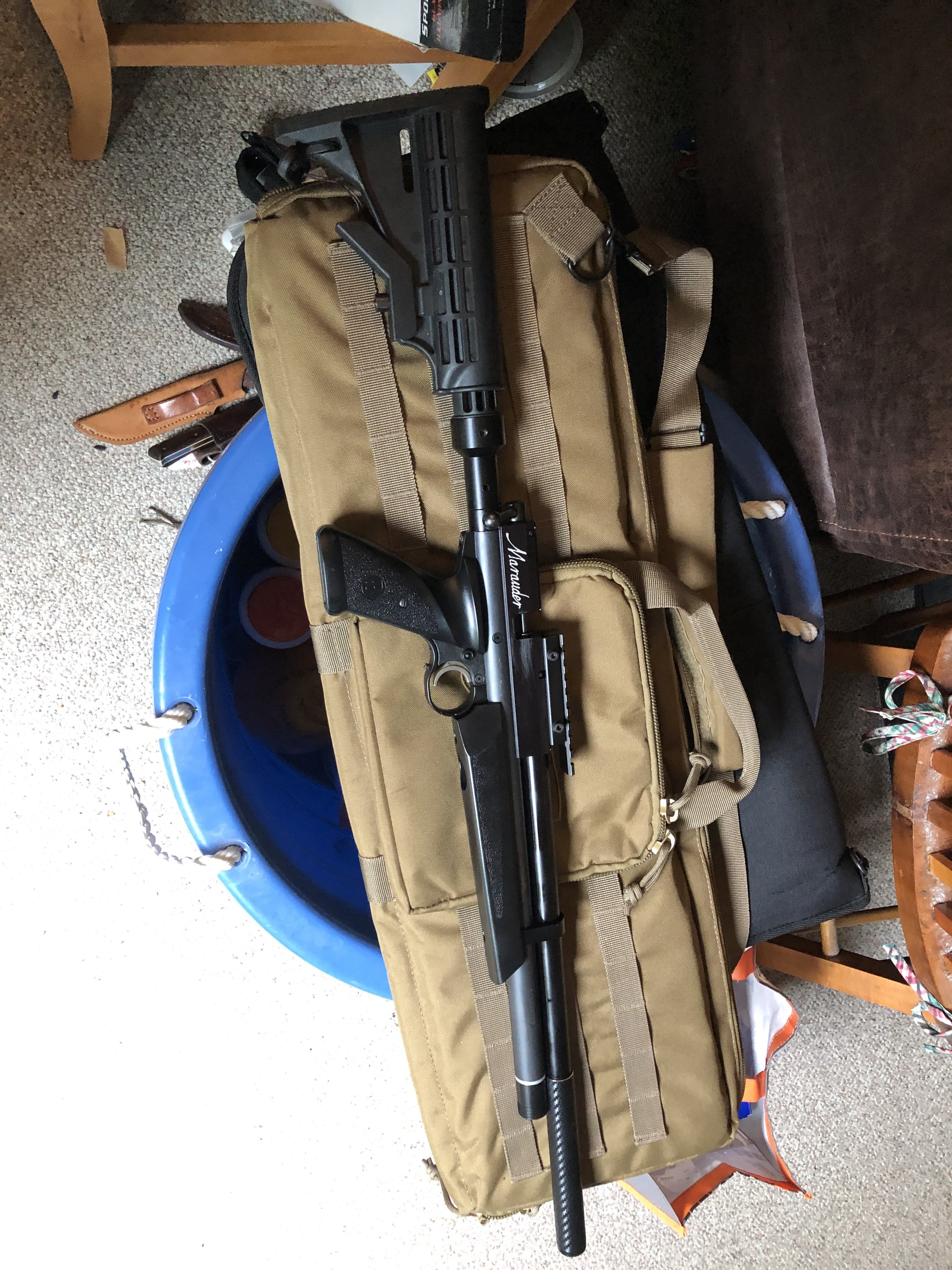

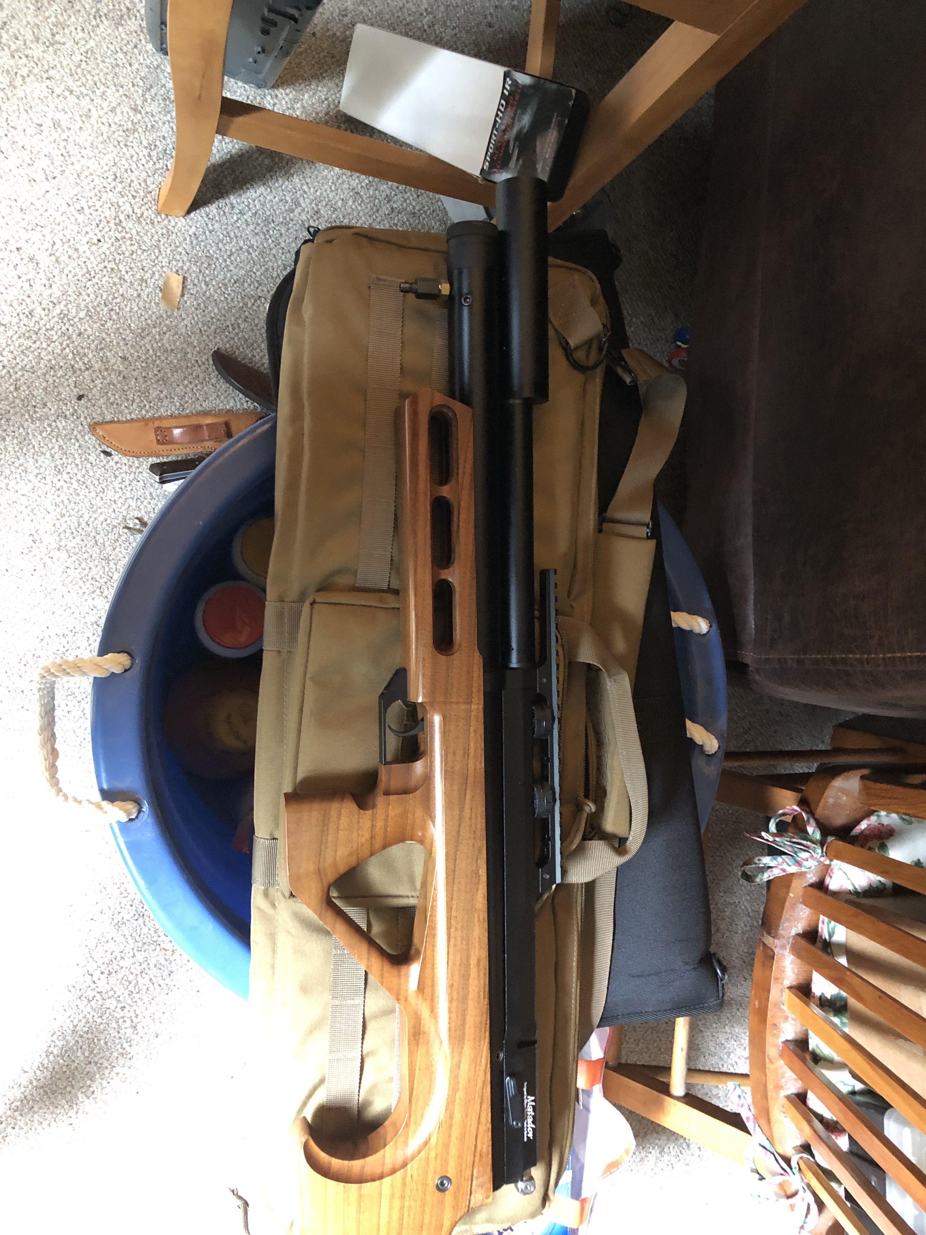

PCP Rifle  NLA Ed Gun Matador and Crosman P-rod carbine
Ed Gun Matador .22. Has 2 Ed Gun magazines, Huma reg. The hammer spring was custom made by John Hagan out of evergreen Colorado, making it possible to us a wrench to increase the hammer tension. 775.00 shipped Sold pend funds
Crosman P-rod carbine. .22 has a new pop it valve and reseal 7/24. Shooting 14gr at 750 to 800 fps fill to 2000 psi. Has TKO. has factory box shoulder stock and all things to turn it back into a pistol. It also has the same finish issues that seems to be common on the air tube, rest of the gun is prefect. 400.00 shipped P-ROD sold pending funds

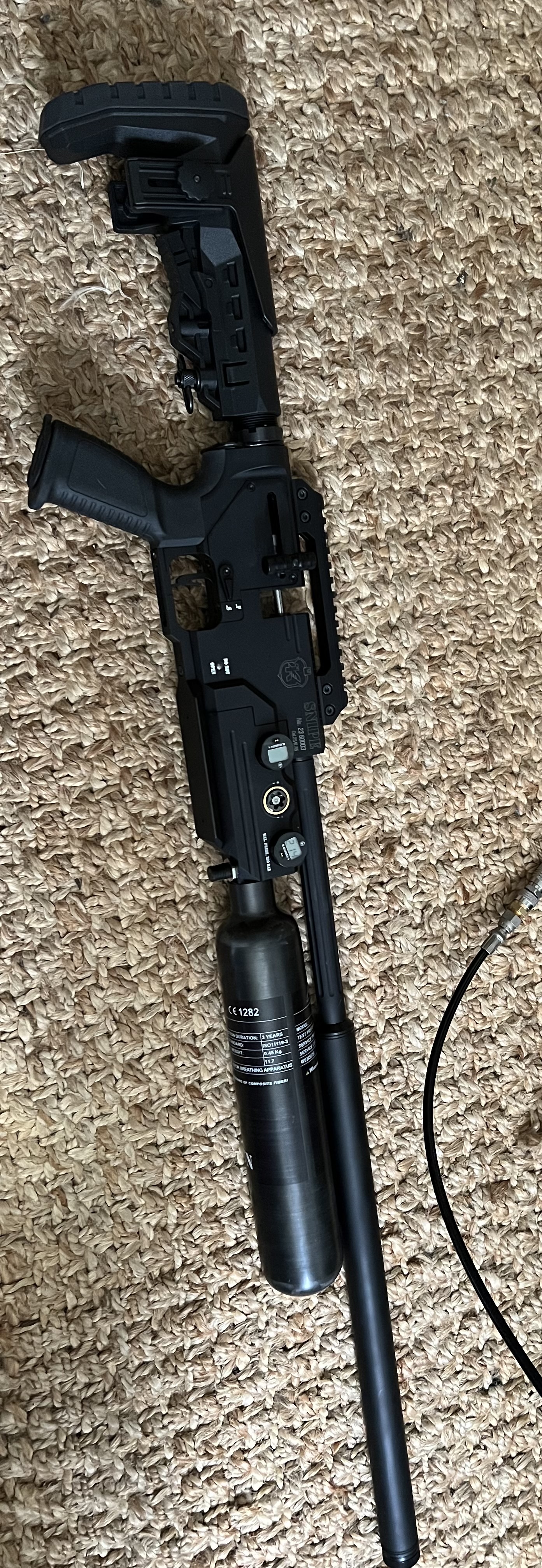

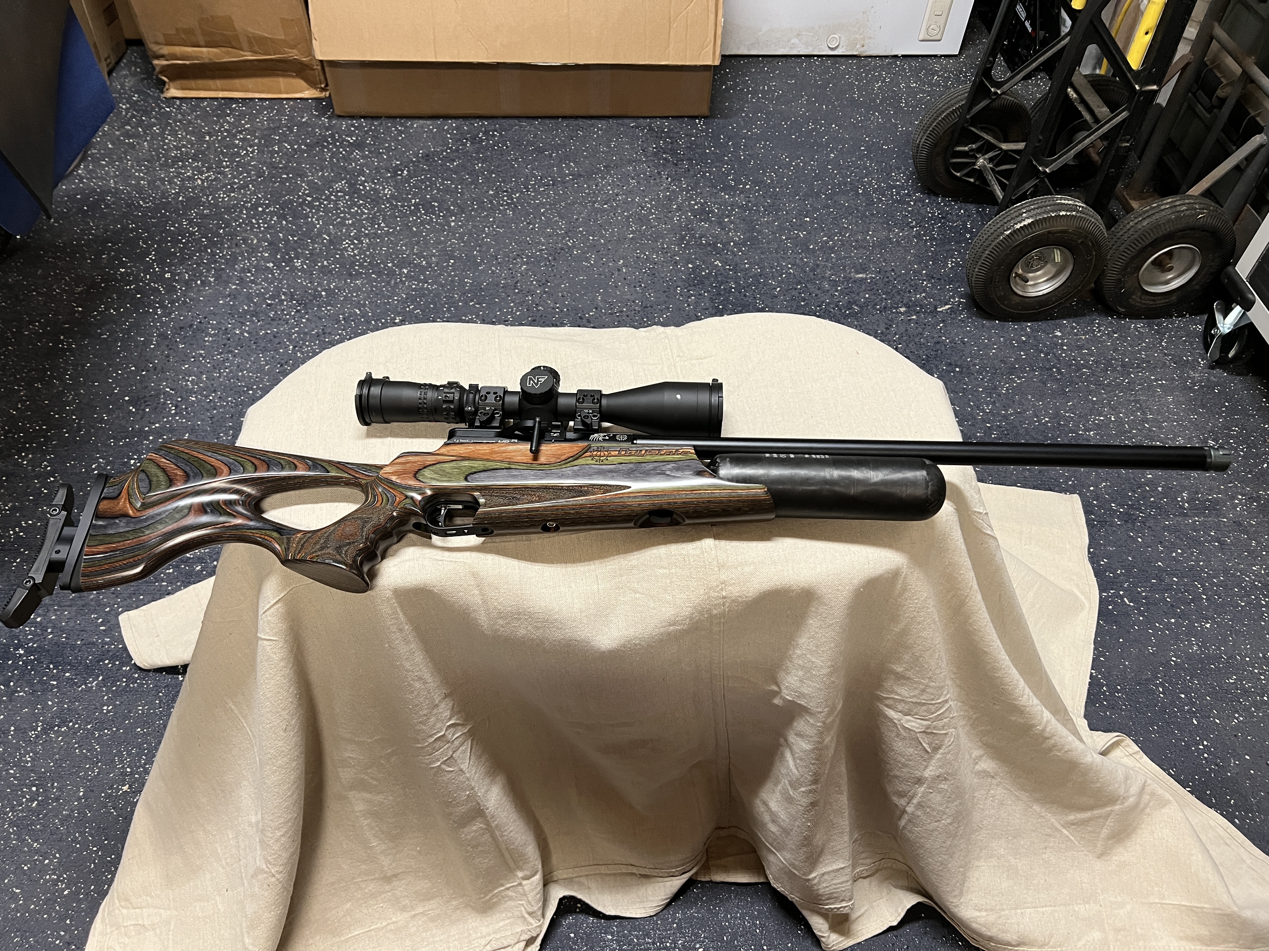

PCP Rifle  NLA Cool gun
I’m selling my almost new gun that’s barely shot. No time to shoot. This has the new REPRX regulator. Comes with original box and everything it came with plus an Edgun pellet loader. This has the grip with the tools inside. I’ve changed the gauge to a Wika analog gauge because the digital one was crap. Bought originally from Edgun west couple months ago. I’ve shot maybe 100 pellets. With the current tune as it came from Edgun west she’s shooting about 880 with the 10.34 pellets. No leaks no problems. Please watch videos of this gun if you’re not familiar or have never owned or handled the L2 platform. Asking $1900 shipped. PayPal f&f only please. I will send UPS within CONUS and an adult signature will be required.
