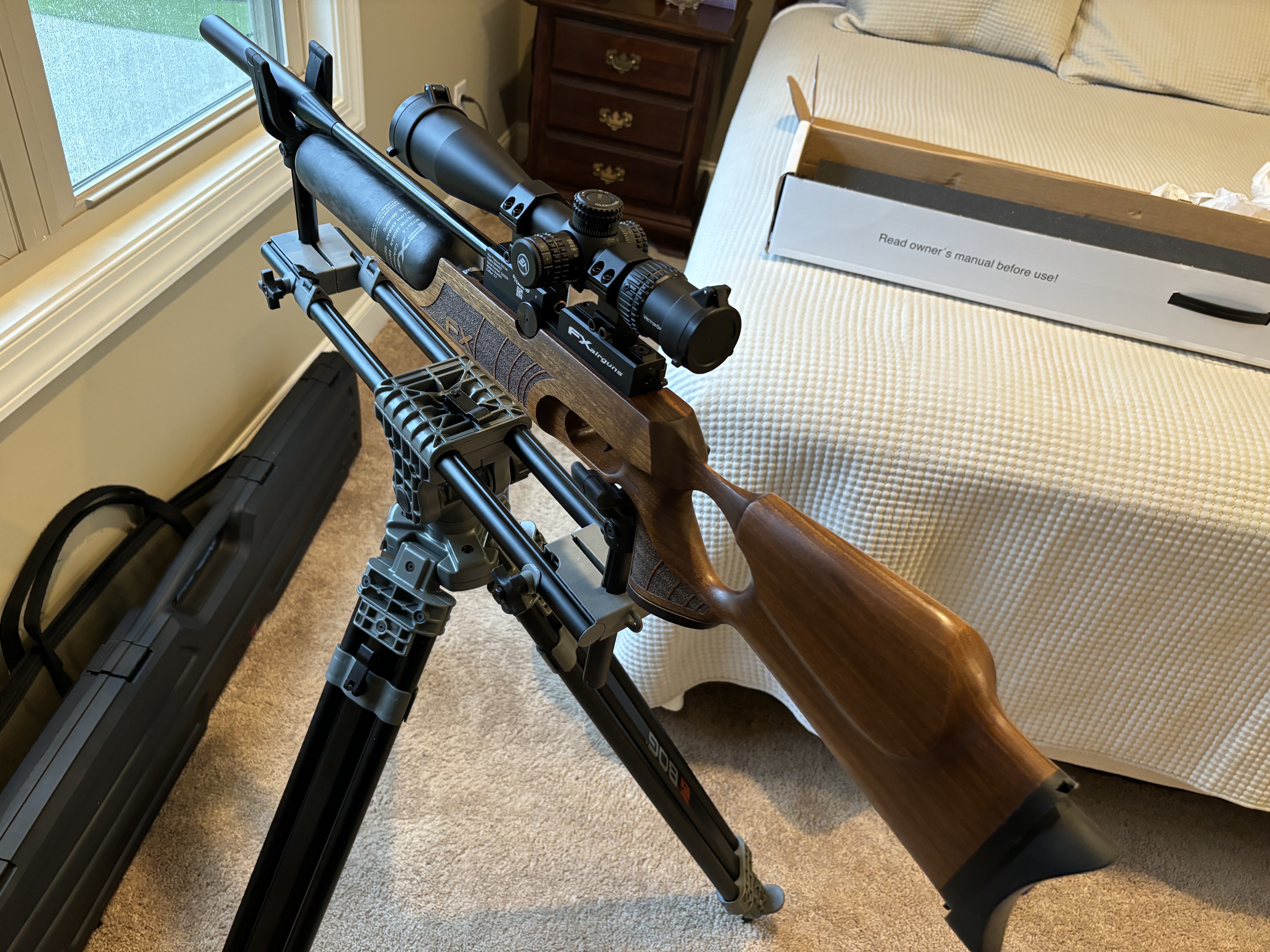

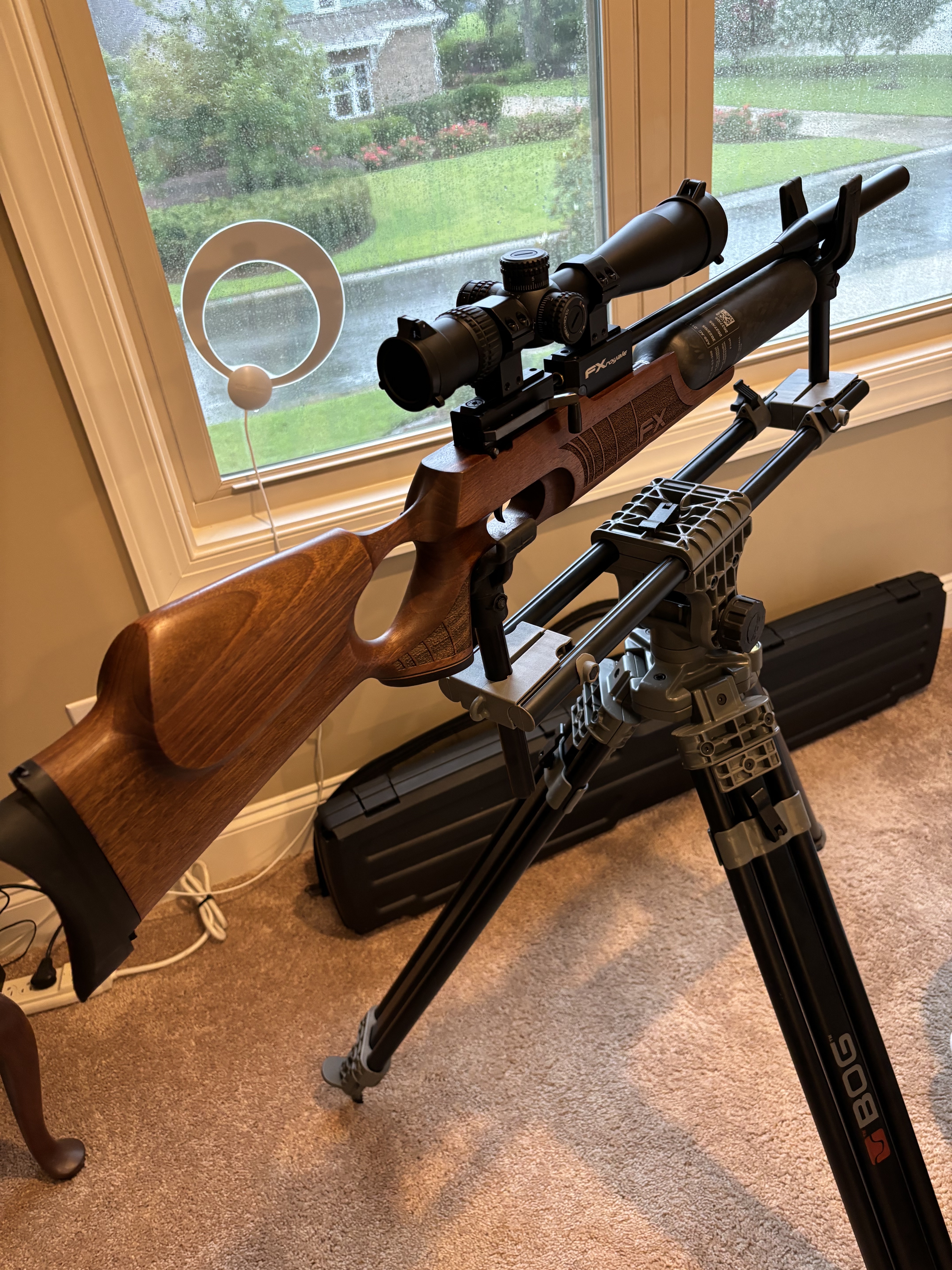

Introducing my Bro-in-law to airgunning!
After about 7 years of relating airgun stories to my brother in law he finally accepted my invitation yesterday to see what I've been talking about. He's very recently retired & looking for things to fill the hours. I loaded up everything we'd need for some target shooting & took him to one of the permissions I'm privileged to have. I set up targets at 50 & 75 yards & decided to let him start off with my FX Royale 500 (.25) knowing what an easy gun it is to shoot ACCURATELY even for a novice. Had 4 guns with me thinking he'd want to try all (FX Bobcat .22, Royale .25, Boss .30 & a borrowed Edgun Matador .22). I sighted in the Royale for him @ 50 and, as always, the 1st shots were straight through the dime sized bullseye. Showed him how to load magazine & how to make sure he didn't double feed pellets. The rifle was on a Caldwell dead shot pod (makes it easier for a newb). Within the 1st hour he got a great feel for what he & the gun could do. After that he only wanted to try for the 75 yd targets (paper & 3" steel gongs). He had an absolute blast, went through more pellets than I think I've EVER gone through in one sitting but refused to try any other gun. He was thrilled sticking with the Royale. All in all it was a great 2.5 hours & the smiles, laughs & male bonding was priceless! I think we just might have another airgun convert!

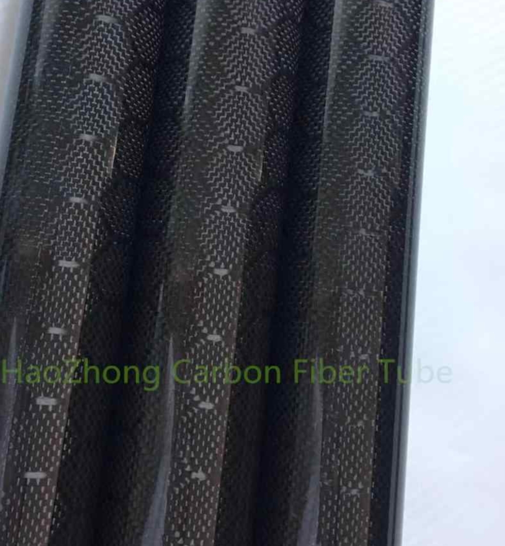

FX liner system is made up of a number of parts i. e. Liner, rear retaining part having transfer port, front retaining nut, outer shell of liner and O rings. These were the parts when the liner system was initially introduced.
Later Ernest Rowe started inserting a carbon fiber tube between the liner and the shell and epoxied it. Definitely this had been done to fix some inherent issues of the liner system which is most probably POI shift.
Later FX also started selling carbon fiber pipes for this purpose.
Even later Ernest Rowe and mny other tuners started tensioning the barrel in FX Impact.
Later FX also started offering it.
So the improvements in the liner system went on and on.
In my experience, the free floating barrel keeps the best POI provided the barrel is solid.
FX makes wonderful liners. When I convert these liners into a solid sturdy barrel, 95% of POI shifts are gone. But then I have to prepare a separate complete barrel in which I cannot replace the liner. For some other liner I make a new complete barrel using that liner.

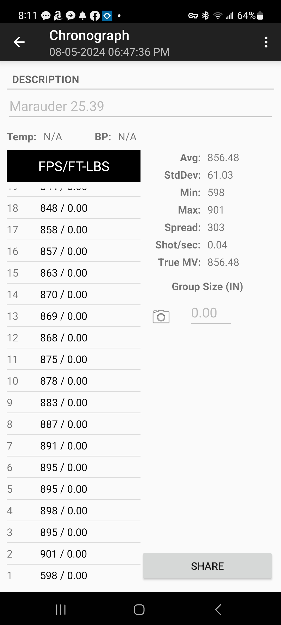

Benjamin  25 caliber Marauder Range Session

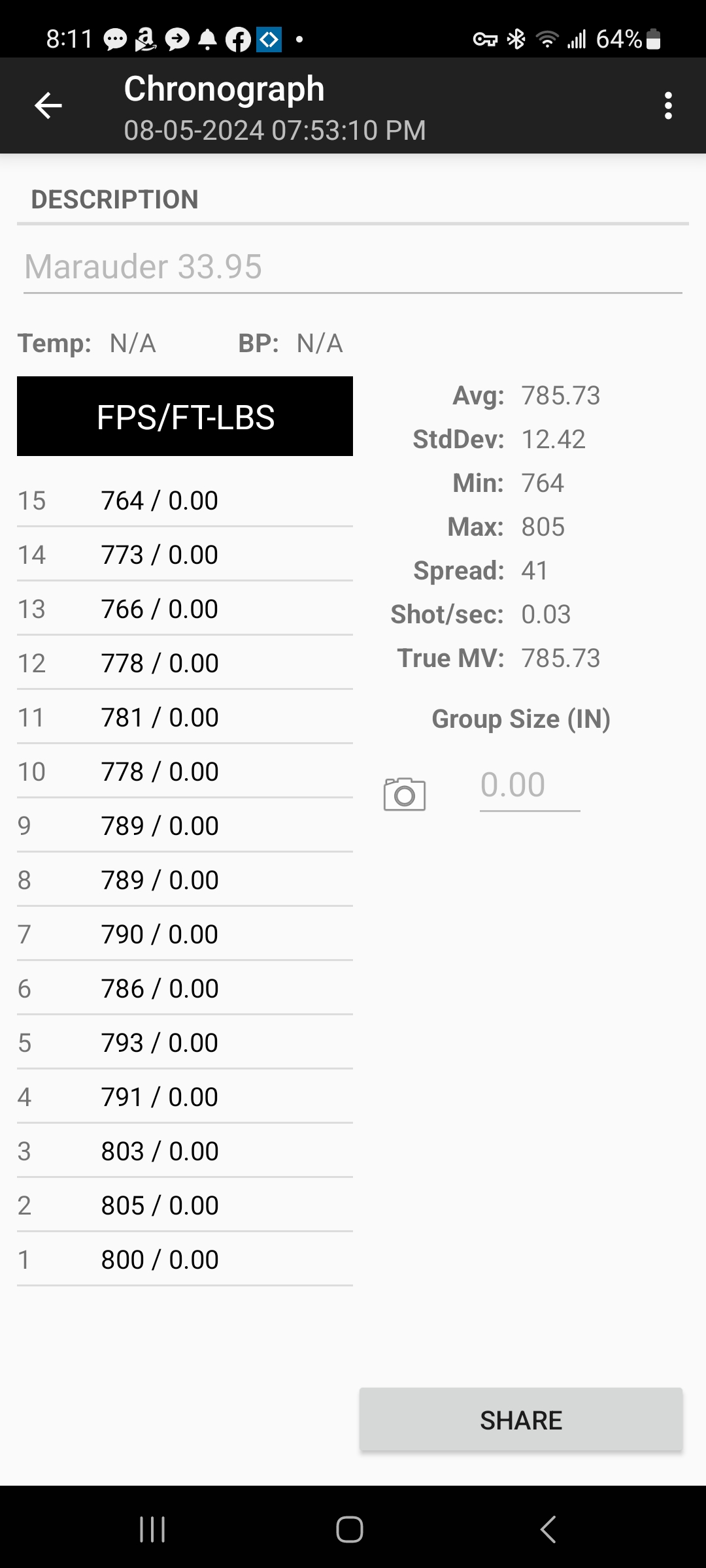

Hello, purchased my 25 Marauder back in February but just recently started to mod/shoot it a little bit.
I added an 18 lb hammer spring from Jefferson State and a hammer denounce device from AOA.
I got the following shot strings in the attached screenshots, using JSB 25.39 and 33.95 with four and a half or five turns in on the hammer spring (wouldn't cock with any more turns in).
Starting pressure was 3000 on both and ending pressure was 2150 on the 25.39 after 23 shots (first shot was a double load). Ending pressure was 2400 on the 33.95 (one shot was a duplicate (790) and was lost during an incoming call while using the chronograph app) so it only shows 15 shots.
Does anyone have shot strings using a bone stock set up using one or both of these pellets?

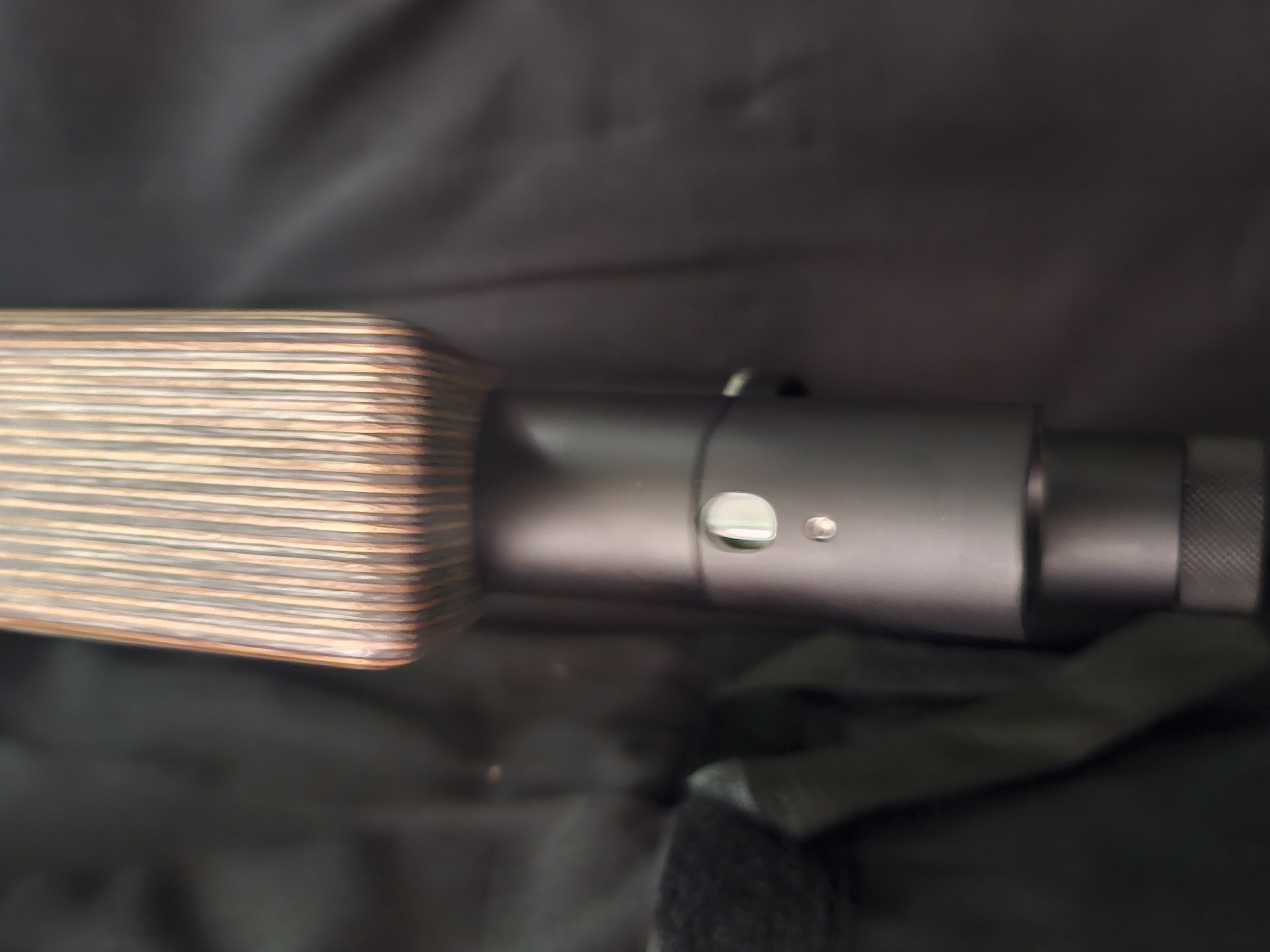

PCP Rifle  SOLD *SPF*Vet 1 standard 25 coffee laminate
Raising funds for a new alkin w31.
This is like new condition. It comes with 2 mags and a fill probe. Beautiful gun that can clear the KYL rack with ease at 50 yards. I've only shot jsb 25 grain through it. Scope not included but could be if the buyer wanted to work something out. Asking $1000 shipped and insured. I also have a new tactical chassis if the buyer wants that add $200. I prefer paypal f&f but I will entertain other forums of payment.

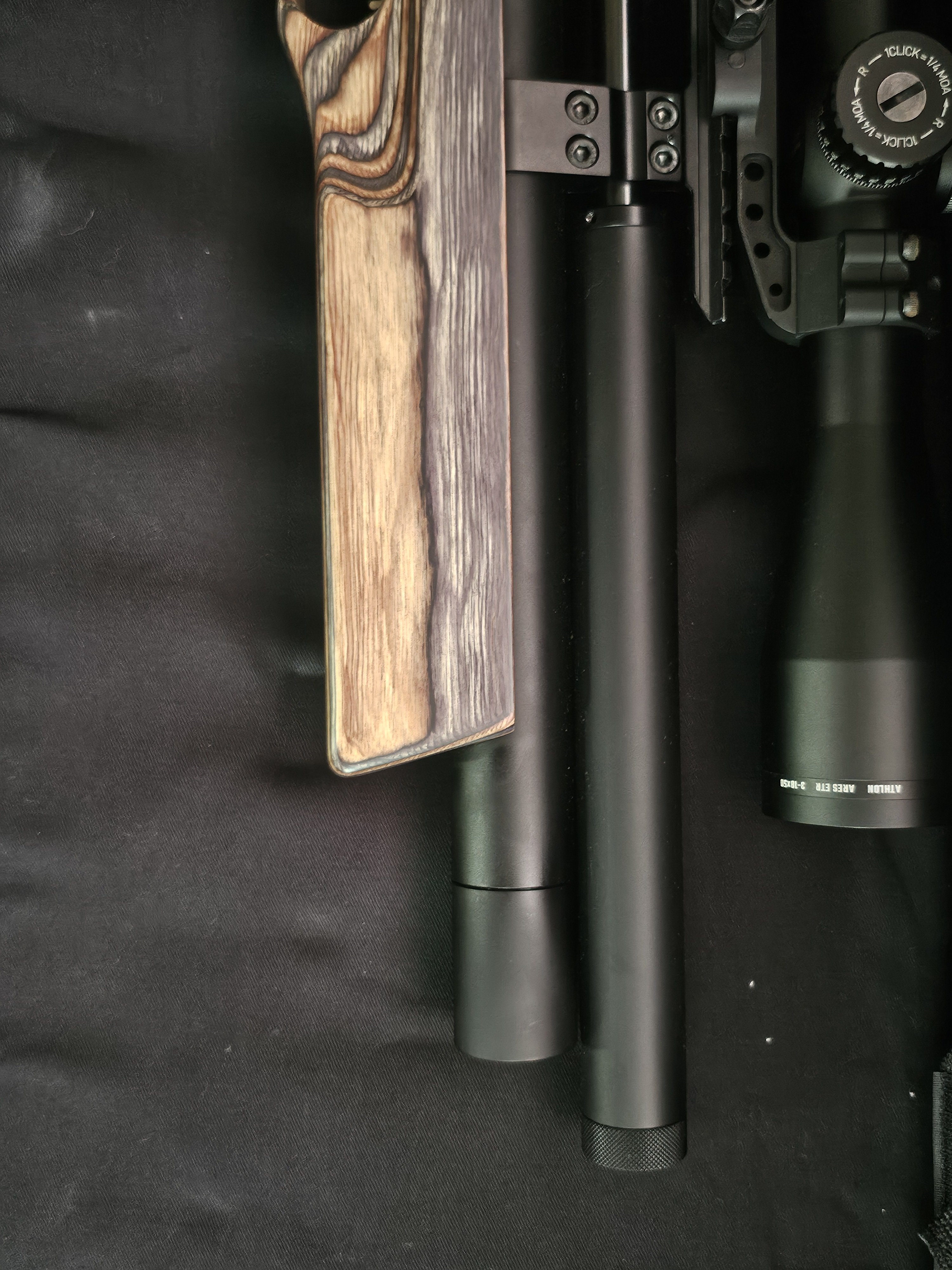

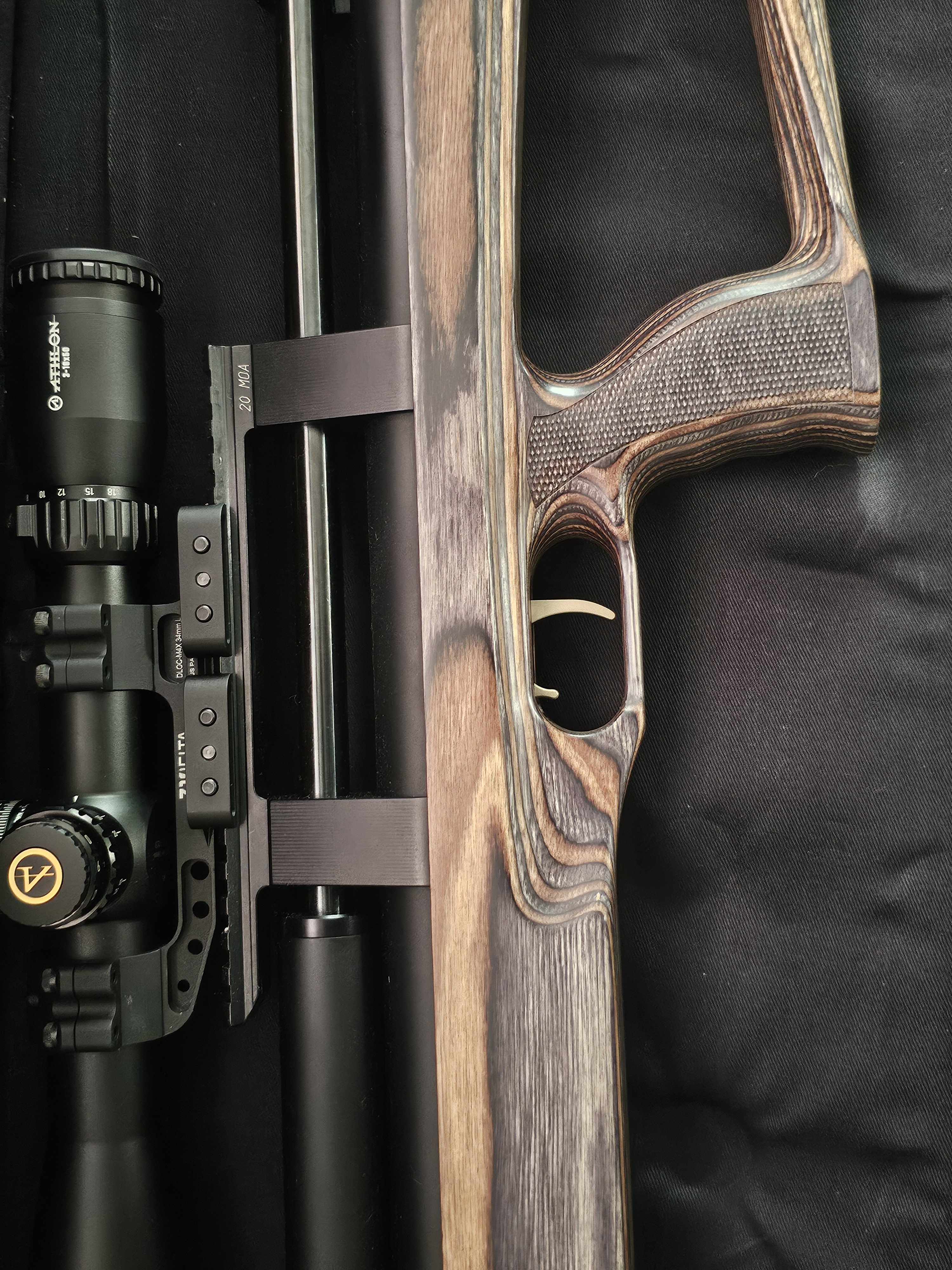

PCP Rifle  NLA .30 vulcan 3 700mm in a talon tunes chassis(includes 1000 avs slugs) $1650
Raising funds for a new alkin w31. Last price drop.
I'm reluctant to sell this one so if it doesn't go I won't be disappointed.
Like new 30 vulcan 3 power tuned in a talon tunes chassis shooting around 130fpe. It has a few marks on the arca rail from mounting a bipod and a mark of the scope rail. This it a nice setup that shoots the avs 62.5 grain dish and 60 grain flat base in .3063 well. Asking $1650 shipped and insured. Comes with 2 mags, oem soft case, 1000 avs 0.3063 62.5 grain slugs, double boxed.
I can add a silent thunder ordnance falx for an additional $80. I prefer paypal f&f but I will entertain other forms of payment. Let me know if you have any questions or what more pictures. Scope and rings not included.

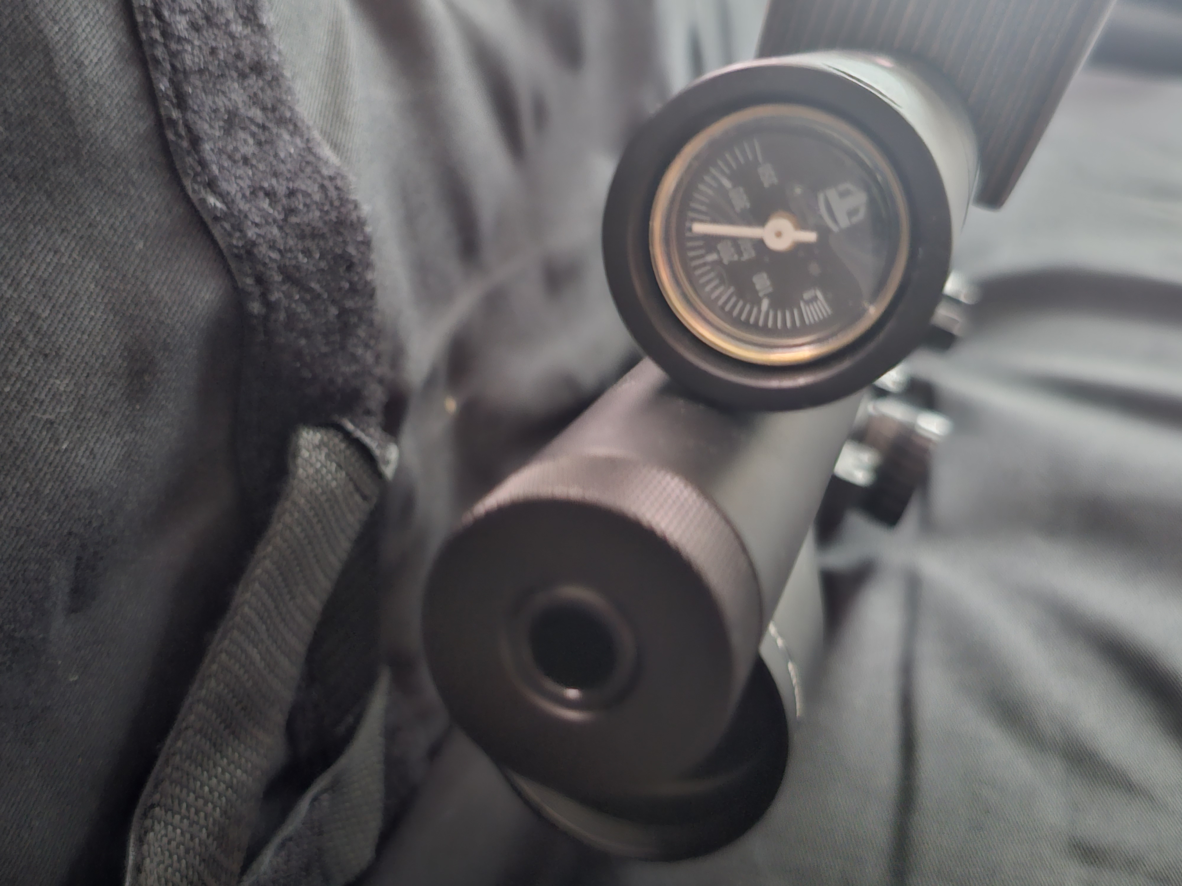

PCP Rifle  SOLD *SPF*Taipan vet 1 standard .22 black stock $750
Raising some funds for a new alkin w31.
this vet has some dings in the stock from use and a few scratches around the barrel from removal. It holds air and functions as it should. Comes with 2 mags, single shot tray, and fill probe.
Asking $750 shipped, insured, and packaged well. I prefer PayPal f&f but I will entertain other forms of payment as well. If you want more pics or have any questions let me know.
Jsb 16 grains at 975 fps
Jts 18 grains at 902 fps
10 shots took it from 160bar down to 138.5 bar.
Cocking is smooth, trigger is nice, and it's quiet at those power levels with the factory shroud.

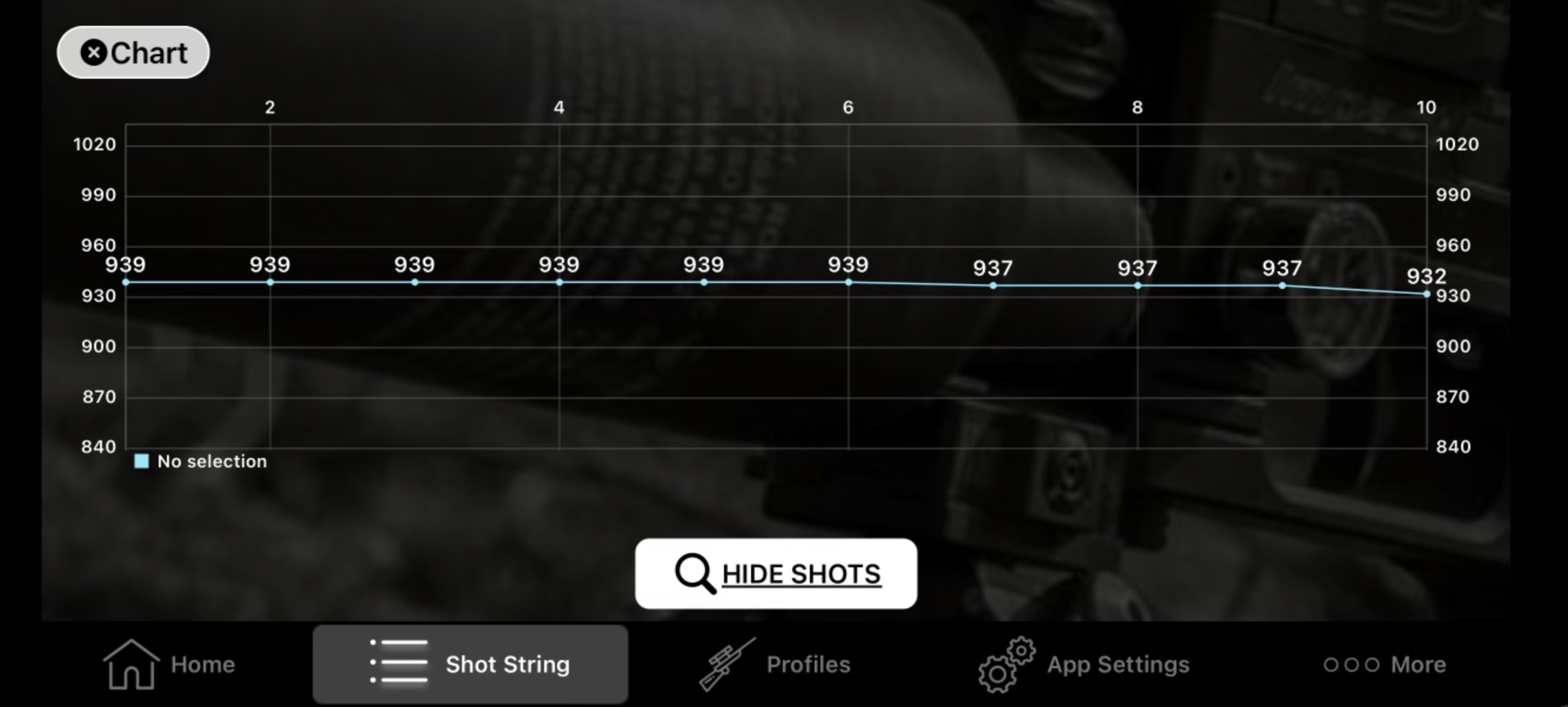

Tuning  JSAR Raptor shoots slugs and pellets

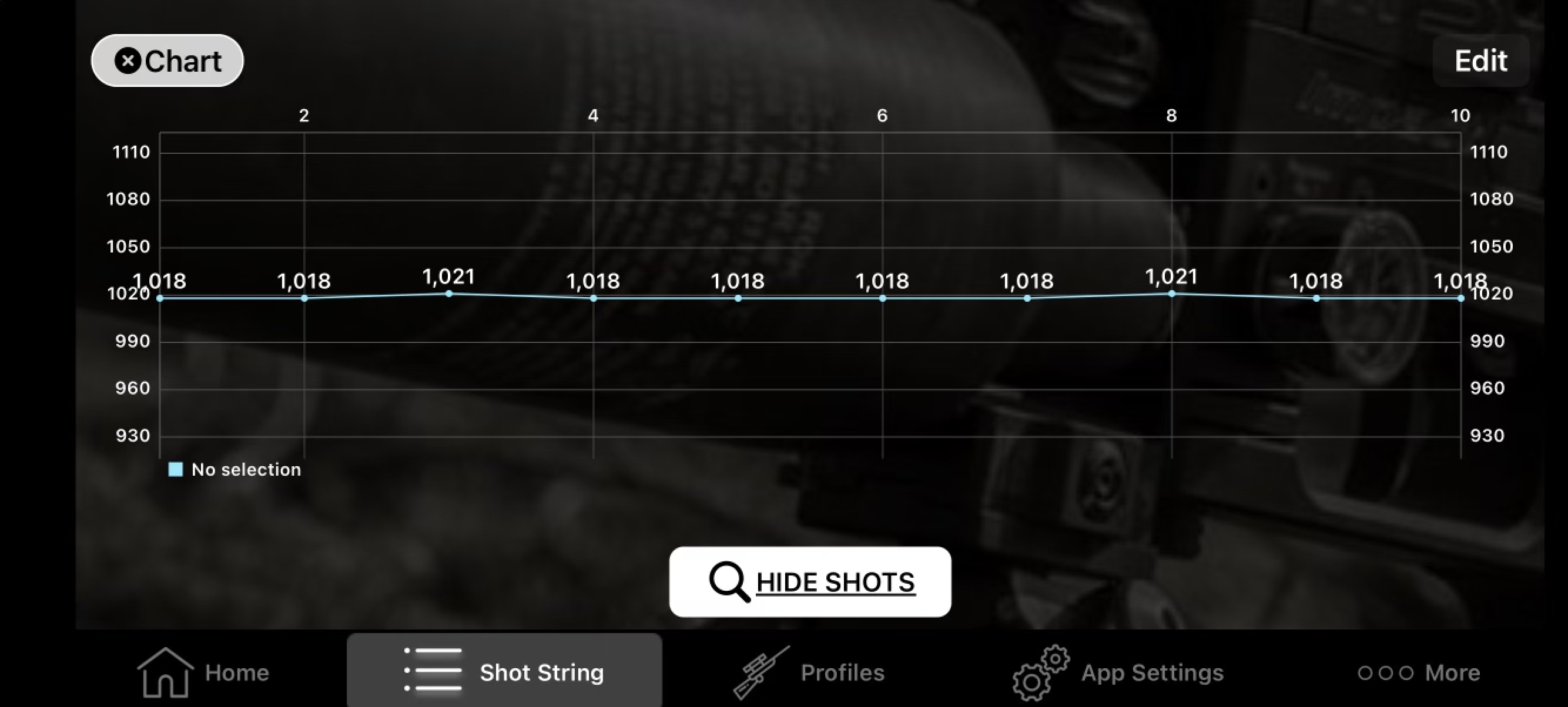

FINALLY found the magic combination for the Raptor .25, could never quite get it to shoot RMR/FX Hybrids well so I figured heck my Maverick VP sends them out at 1004fps so....WHY NOT? Cranked up the regulator a touch and only a touch and OH MY smaller than a dime at 25 yards at 1018fps , shoved in some 33.9 AEA's and they perked along at 939 and dime groups. The only reason the last one with the AEA's was 932 it was falling off of the regulator. Note to self, self...DO NOT MESS WITH THE GUN. Disclaimer, the first two shots in both strings were a touch higher then it settles down so I did cherry pick but still pretty darn awesome. And 60 Ft#'s with the slugs and 65ft#'s with pellets, at the muzzle.
