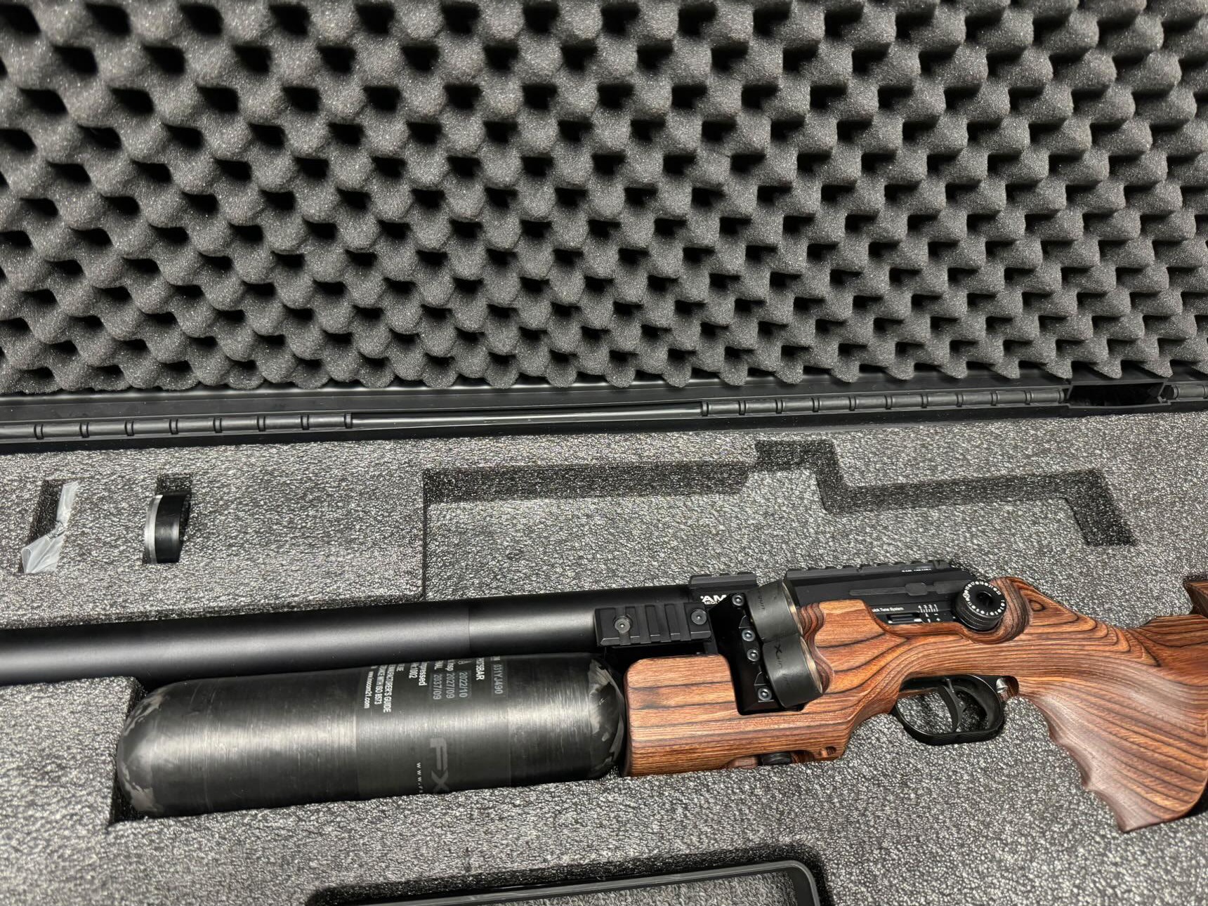

PCP Rifle  NLA FX Dynamic 700 30cal
Selling this gun for my friend who bought it not that long ago thinking to try bench rest but had an accident and need the money for medical expenses. He should less than 1 tin of pellets through it. Crazy power house with well over 100fpe.
This is the standard dynamic with 400cc aluminum bottle
comes with dynamic/panthera front rail as pictured
1 factory mag 30 cal
1 Carb single loader 30 cal
Will ship in original box as pictured..........$1250 shipped to US.
